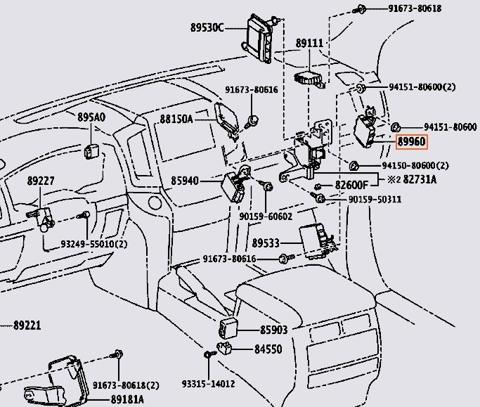

That part number comes up as "Computer assembly, headlight leveling : KAZAKHSTAN SPEC" in the parts diagrams. Not sure why I think that's so funny..
Edit: sorry, I had been doing digging on LHD headlights and had it set to RoW. That part does come up for US 08/2017+ URJ200s without any kazakhstan notes.

Thanks - im trying to figure out how to get to it. Parts guy made it seem like a footwell panel to the right of where the feet are. This diagram - in the glove box?!? I cant tell. Sorry....
Foot panel will need to come off. Probably also the panel under the dash to look upward.
Possible that you need to remove the glove box which means removing the knee airbag, and that requires pulling the knee pad on the side of the console, and the silver trim. All of which is actually pretty easy.. just go slow and careful.

Sounds like a lot to take apart with no schematics. Looks like it’ll stay broken. 😒

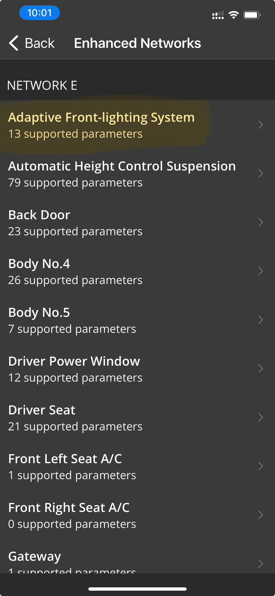

I went out and bought odb fusion. It doesn’t pick up any error codes. BUT, after I was unsure if I was testing correctly, I called them and was told it is not capable of testing for ecu for headlight leveling.

Sorry to trouble you. But is the anyway you could just list the buttons / choices to select on the obdfusion I should select to make sure I’m doing it (scanning) right?

Theses steps are for OBD Fusion on Iphone
Step 1: Make sure you are disconnected from the scanner. (Do steps 2-4 when away from vehicle if you like)
Step 2: Click the little vehicle icon to get to the "Vehicle Editor" (Bottom left corner) (Alternatively, go to "Settings - > Vehicle Editor"
Step 3: Go to "Enhanced Network" and select "Network E" (this is what it is on the LX, i assume the same for LC. Look for the network that has HL Autolevel ECU listed.
Step 4: Click "Ok". It should now say "Network E" under Enhanced Network
Step 5: Click "Back" to go to the main screen and then click "Connect"
Step 6: Accept any warning offered. If you have never done this before it will most likely prompt you to scan all ECUs for new PIDs. Also, if you've never done this, then you've never actually scanned for your HL Autolevel ECU. Let the scan complete (might take 10-15 min)
Step 7: Verification: Now you can go back to the Vehicle Editor and click the "View Networks" button under "Enhanced Networks" section. Scroll down to the HL Autolevel ECU and see how many PIDs OBD Fusion found.
Mine shows 13 for the AFS ECU. Based on the screen shot from the other user, if yours if functioning correctly it will say 9 PIDs, and if not functioning it will say 0.
I suspect that the HL Autolevel ECU probably has its own fuse, so i would suspect it's entirely possible that the ECU could have a blown fuse. But also, possible that the ECU has failed.

Sitting at dealer. I o ly have network a & c ??
