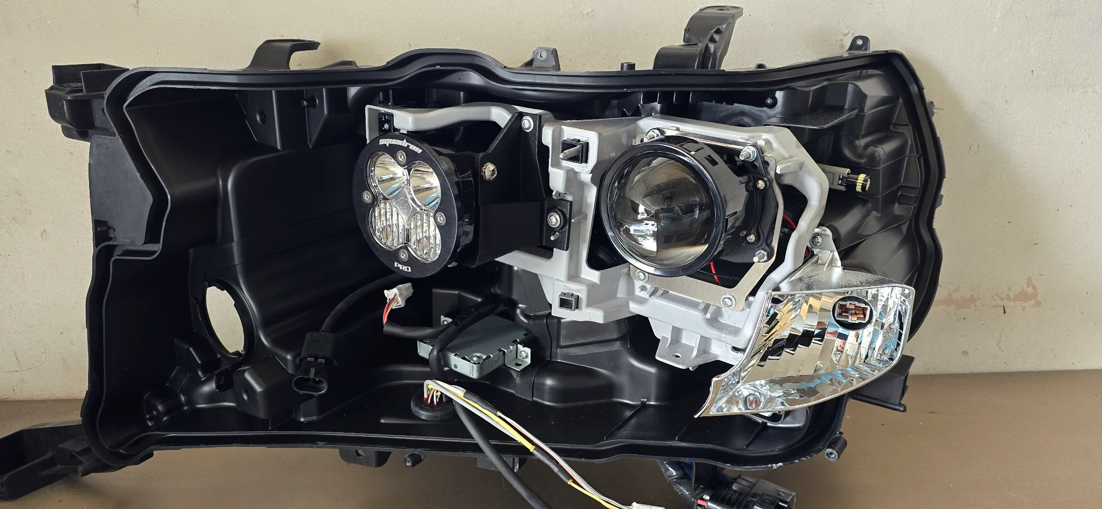

You can only run the adjuster off the screw trying to lower the lights, it would not make a difference if user did it or the system did it via bracksts in the rear since the ride height is staying where its at. To actually have that happen and drop the projectors, the vehicle squat would have to be nuts. I have a set of 16+ headlights open right now and there is plenty of adjustment screw left to lower the lights from factory base setting (see the top screw).
OP most likely does need to lower the lights, between the front having been lifted (without the vehicle knowing about it) and the rear sensor being dropped out from the lift, which the computer will raise the lights to adjust for.
