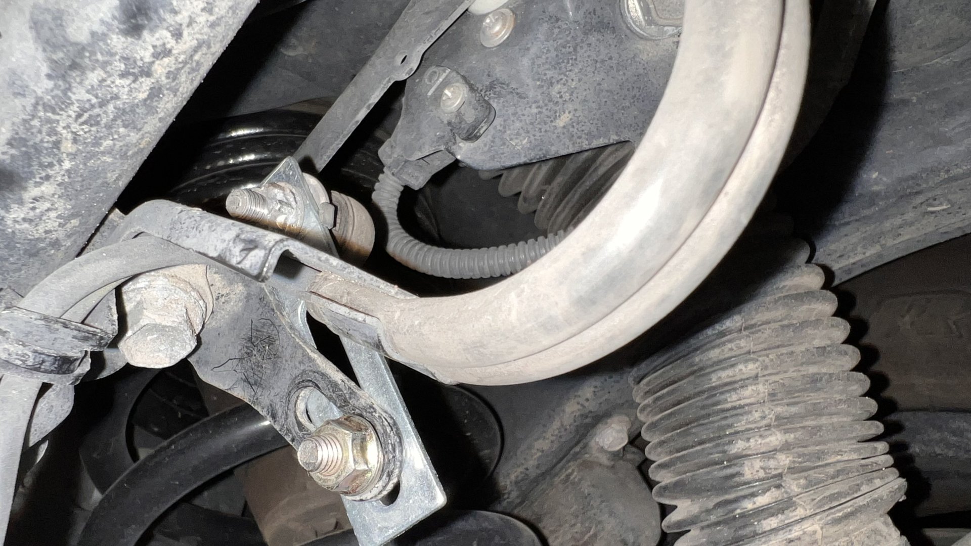

Is this our height sensor? If so, leaving this here for those who haven't crawled under the truck to have a visual.View attachment 2858954

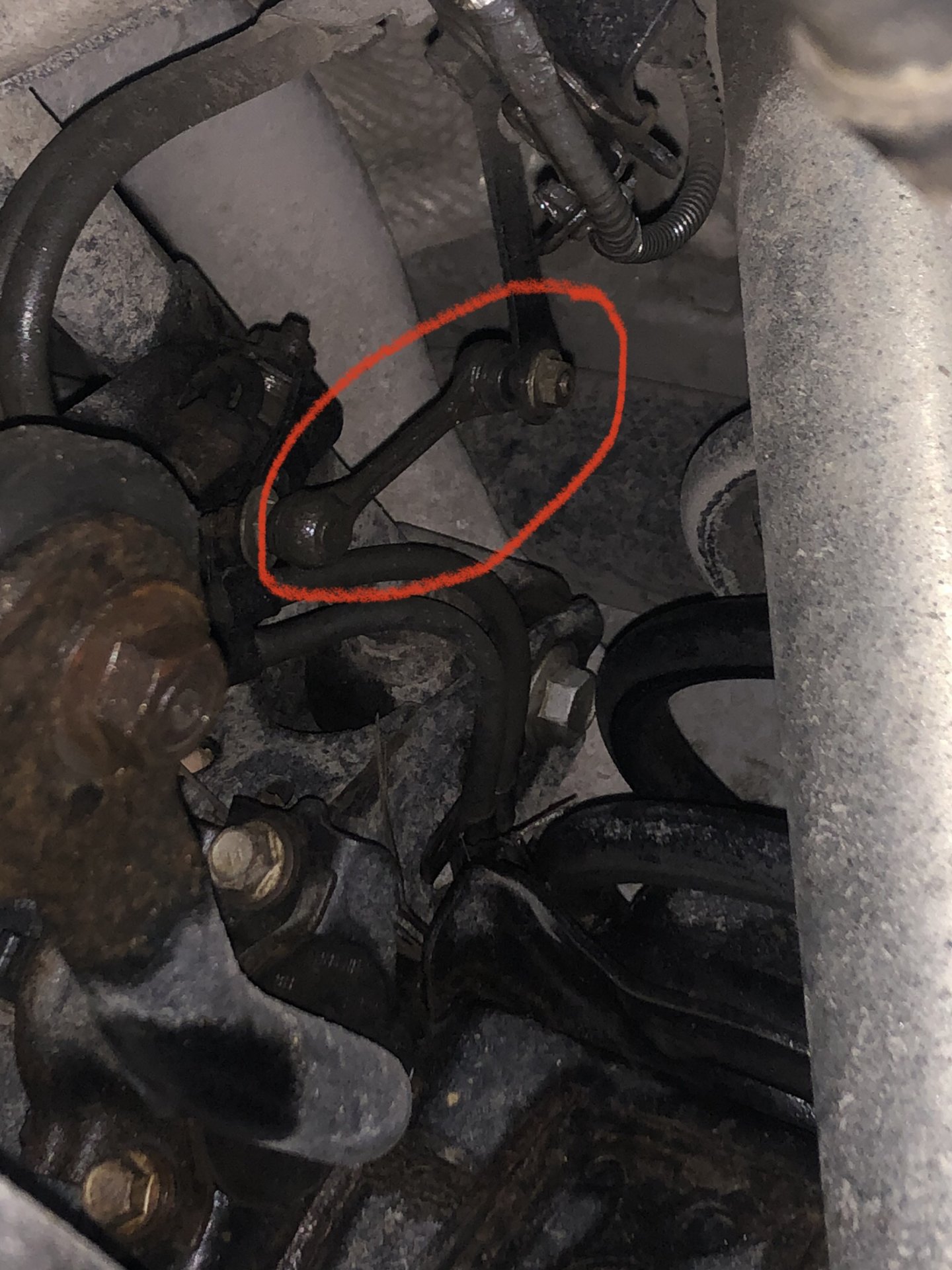

That is the correct part for my '16 land cruiser. The dog bone looking silver thing taped to the top in this photo (it isn't oriented like this in operation) is what TJM and others replace.

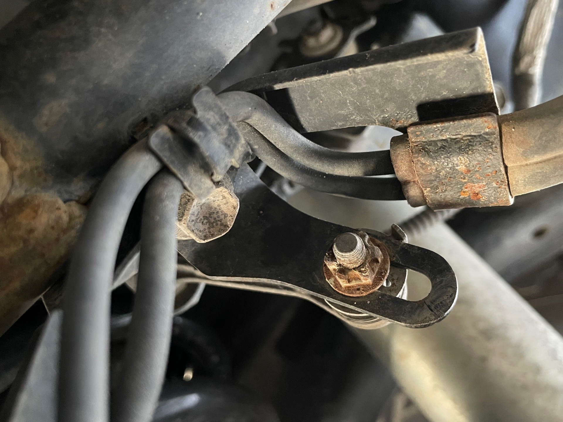

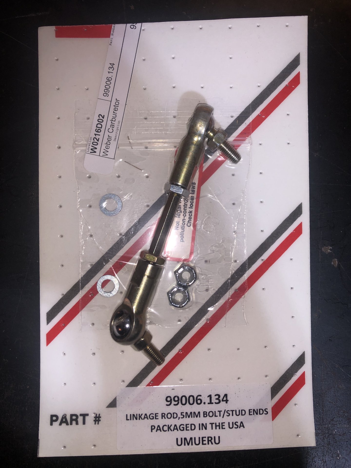

Here's what I have that I am going to replace mine with:

I hope it's adjustable enough to solve the issue. Is it rust resistant? It's going to get a lot of dirt and water on it.
Well, it was made for Weber Carburetors, which are exposed to the same kinds of conditions, so I hope so.
This specific linkage has a range of 3.5 inches (88.9mm) to 4.5 inches (114.3mm). TJM recommends that the spacing on their part initially be set at 90mm from pivot to pivot.

On mine, the height/load sensor is on the us driver side rear suspension (part shown above, and visible through the wheel opening - edit: you need to look from ground level with your head in front of the drivers side rear tire), and the motors are internal to the headlight enclosure.
@CharlieS did you get this carb linkage installed? If so, how did it work out? Thanks!
FWIW - I got the same part Charlie bought. Prior to installing, figured I would try adjusting the OEM part first. Did that, started truck and saw the headlights adjust lower. Have not been flashed since so maybe it’s good enough. Not the ideal test but they are now lower.
