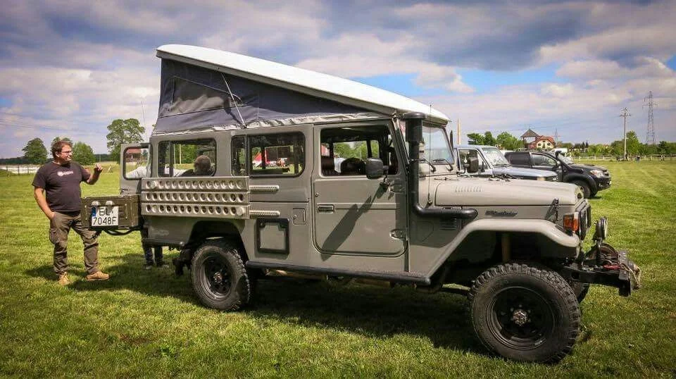

I stumbled on this pic when I was searching for a pop up tent, but can't make of the brand. You can see the patch left to the entry but when I try to magnify it's too pixelated
That’s Radio Dave, also known as Trona Dave these days. One of the oldest expo rigs out there. Custom water tanks on the front bumper, yada yada.

Very sweet rig! Similar how I would like to build mine. I agree with mrjordann, wouldn't mind getting some ideas from his build 😁

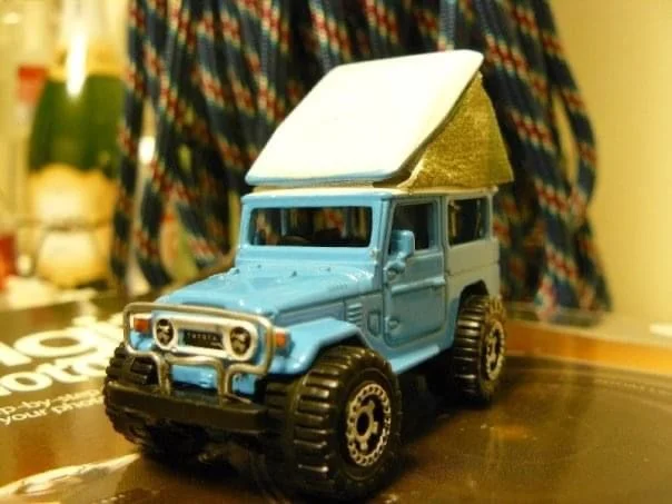

I was planning on trying something similar when I first got my 40. I bought a spare hardtop and sides and drew up some plans, even made up a crude model to see how it would look
There were a couple of reason I decided not to go through with it. One, the rollbar sits above the sides, so just to clear the main hoop would have required extending the sides about 6". If you just wanted to have a pop up to get standing room then it's not much of an issue, but I wanted to be able to sleep in there like a RTT. Once all the flooring and space was taken into account the hard top would have had sit about 10" higher than stock.
The other problem was mentioned above. After all that work you're still limited to a 5'x7' space, which didn't feel long enough to be comfortable. Unless you went with a vertical pop up design, or lifting hinge like the old VW's, the usuable length would be closer to 6' since the hinge side would be too low. Overall seemed like too much work for very little benefit so I just bought a RTT instead.

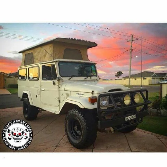

I've been tinkering with the idea of doing a poptop on the troopy.

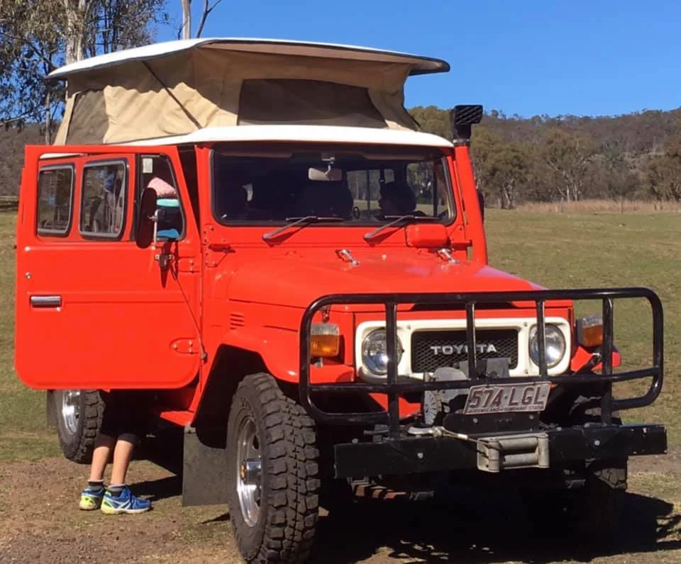

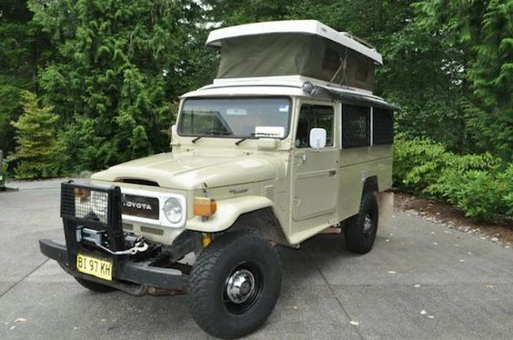

There was a company in Australia called Trakka that made the poptop for the troopy's back in the day. I had a chat with them but their mould was destroyed a few years ago so they stopped producing them (last pic)

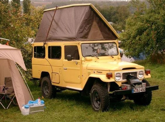

I've been looking on the net to try and find a company that may do a "kit" or the hinge setup etc but haven't found anyone....did find a few pics of different types of conversions (mostly in Europe).
There is a company over east of Australia called Expedition Centre that were keen on trying the conversion but they want around $10k.
I did have a look at the Alu-Cab company (originally from South Africa) and how they design their roofs and i think the easiest solution is to find a custom fibreglasser to get the roof done.

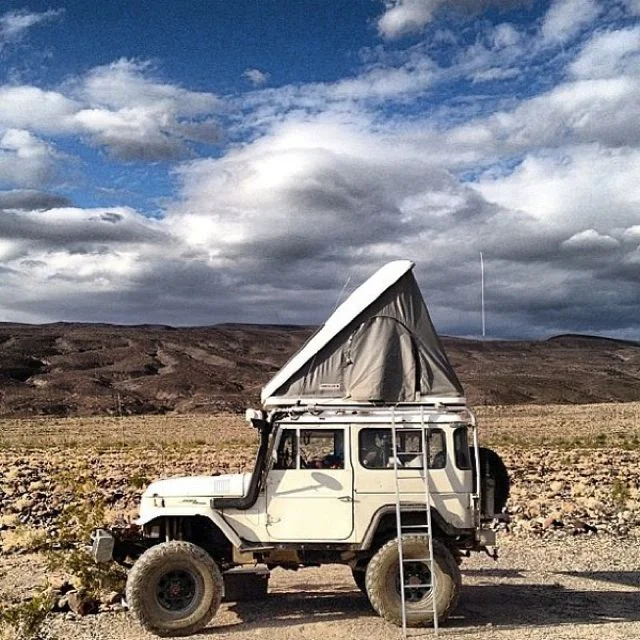

Id love to know who did the conversion for the 3rd pic (2 troopy's with the pivoting front hinge) and try to get in touch with them.
If anyone has anymore info or can point towards a company ......much appreciated! :)
Bump! Anyone know the company that did the conversion in the 3rd pic?
