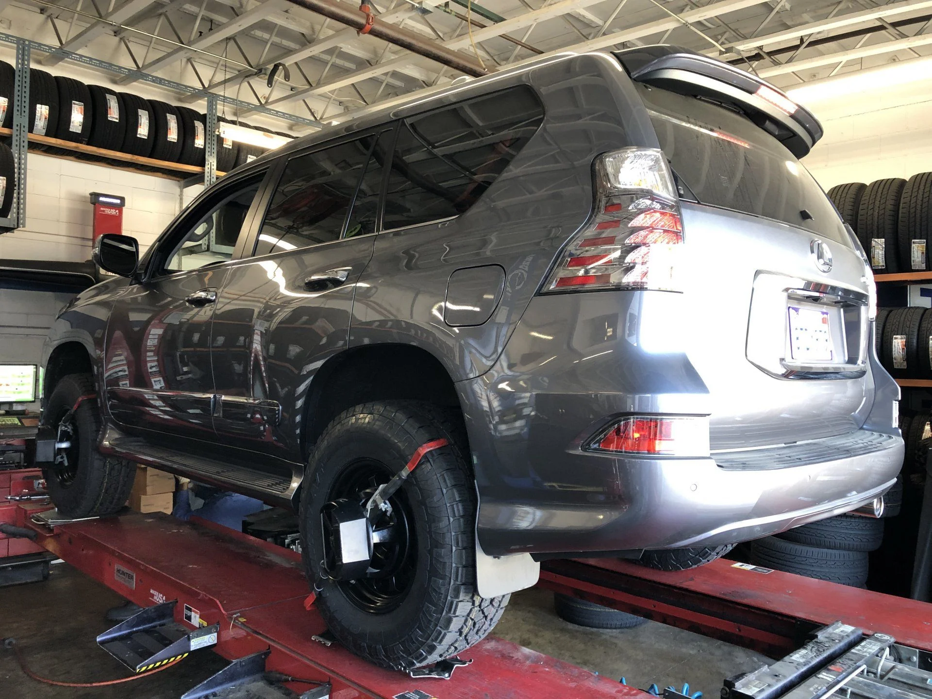

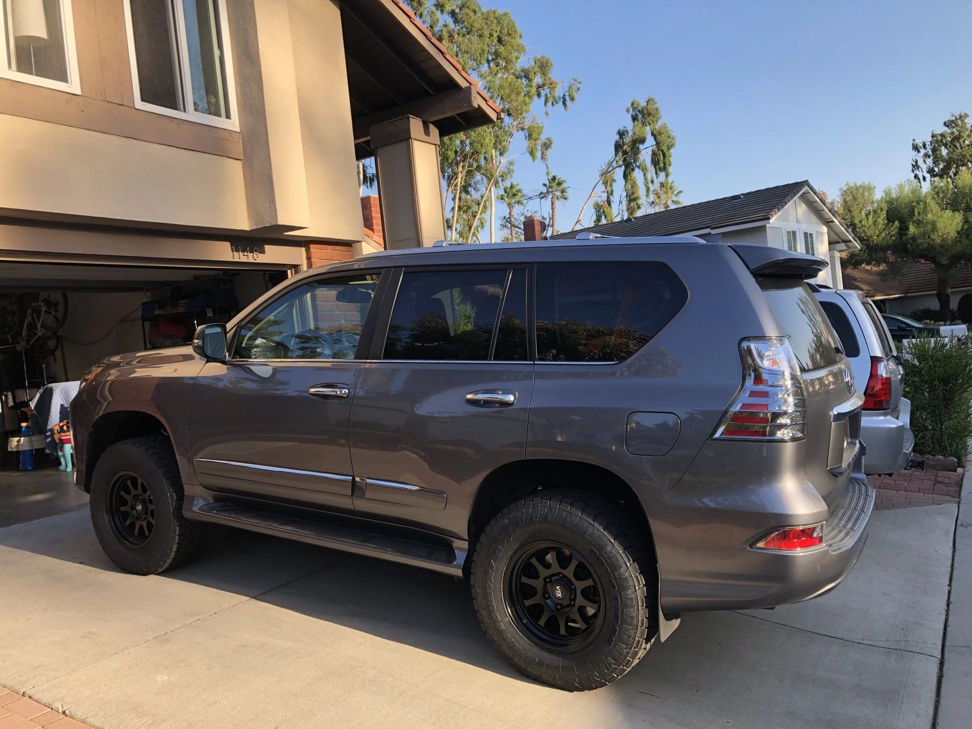

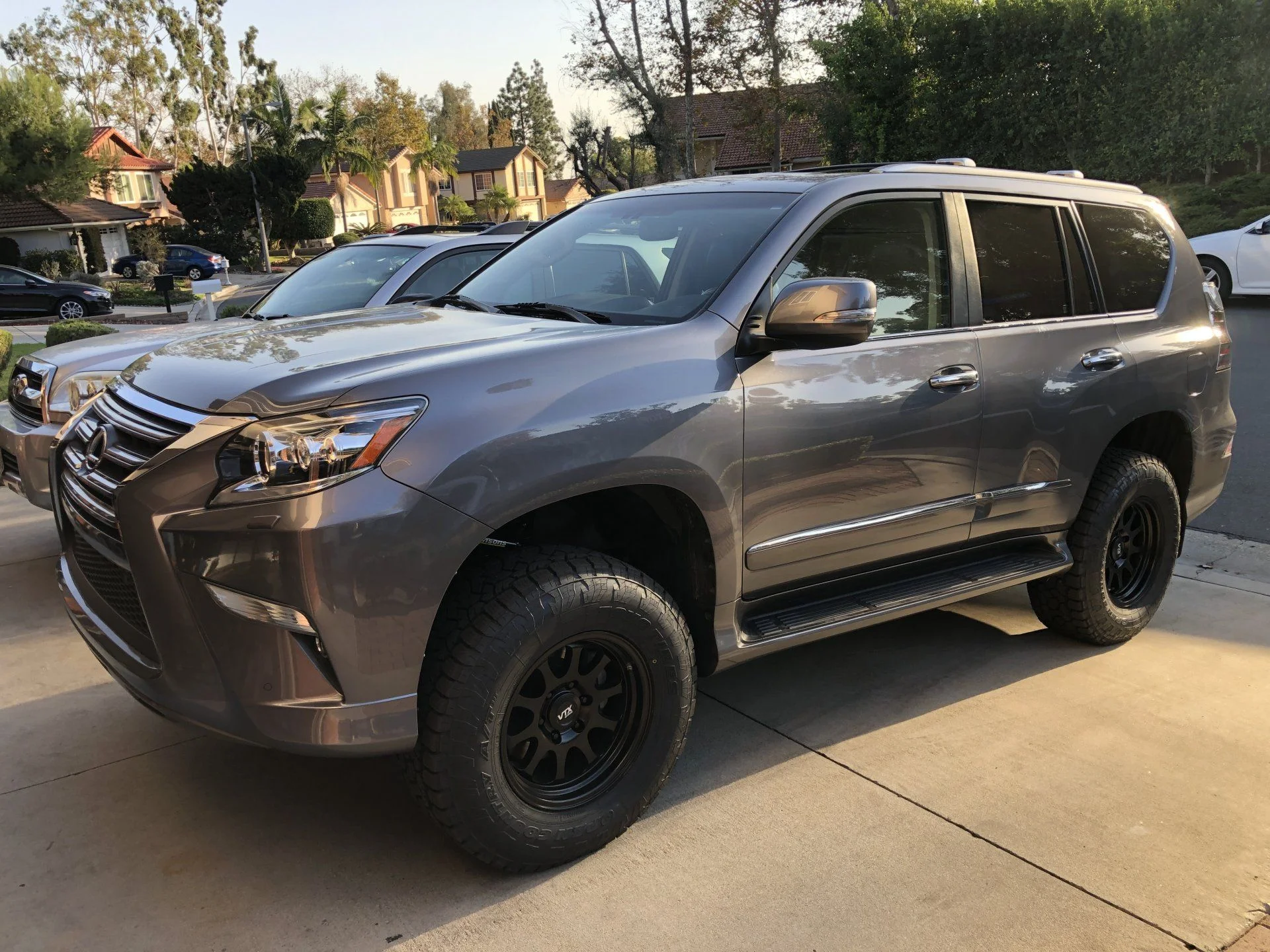

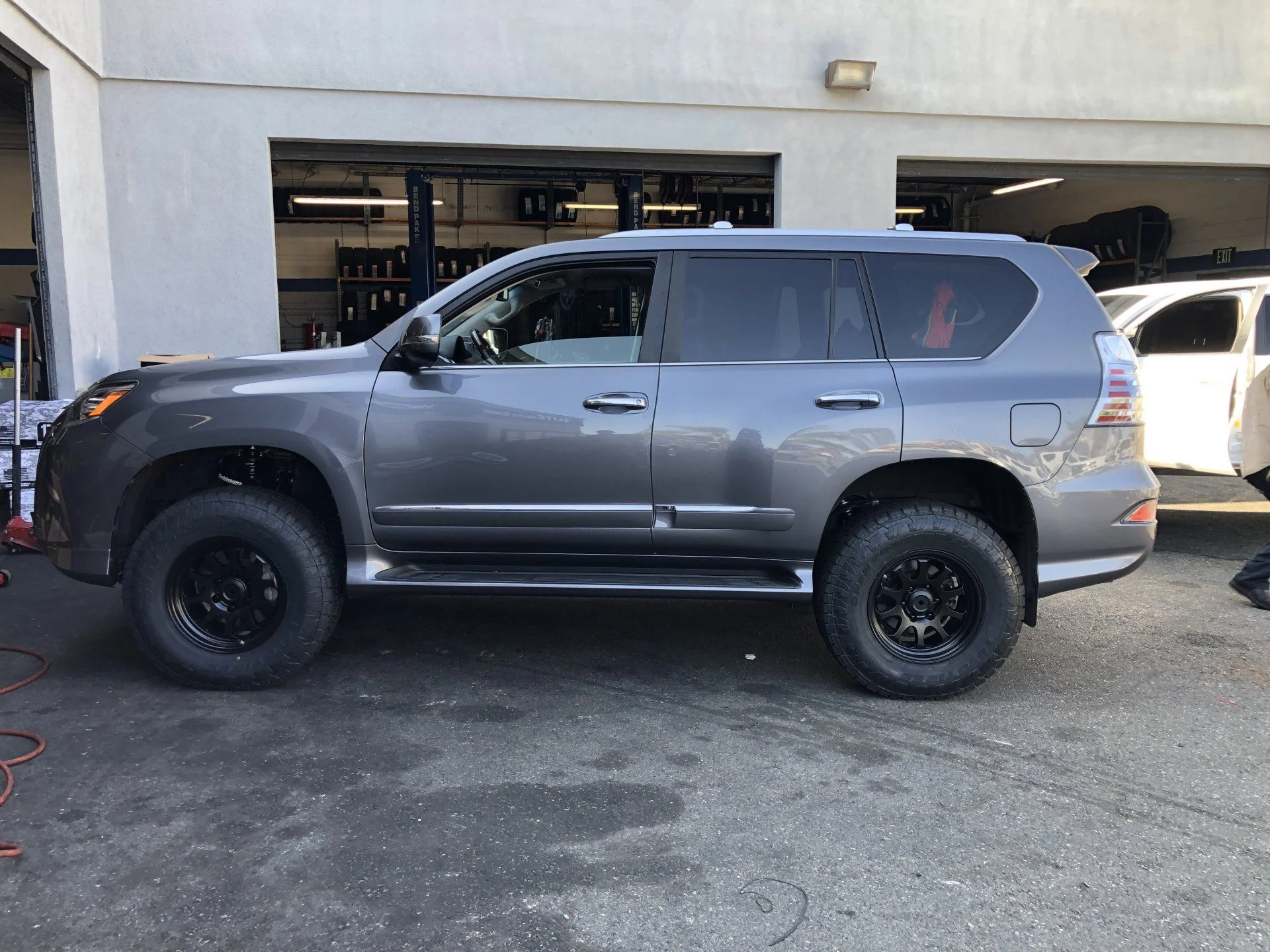

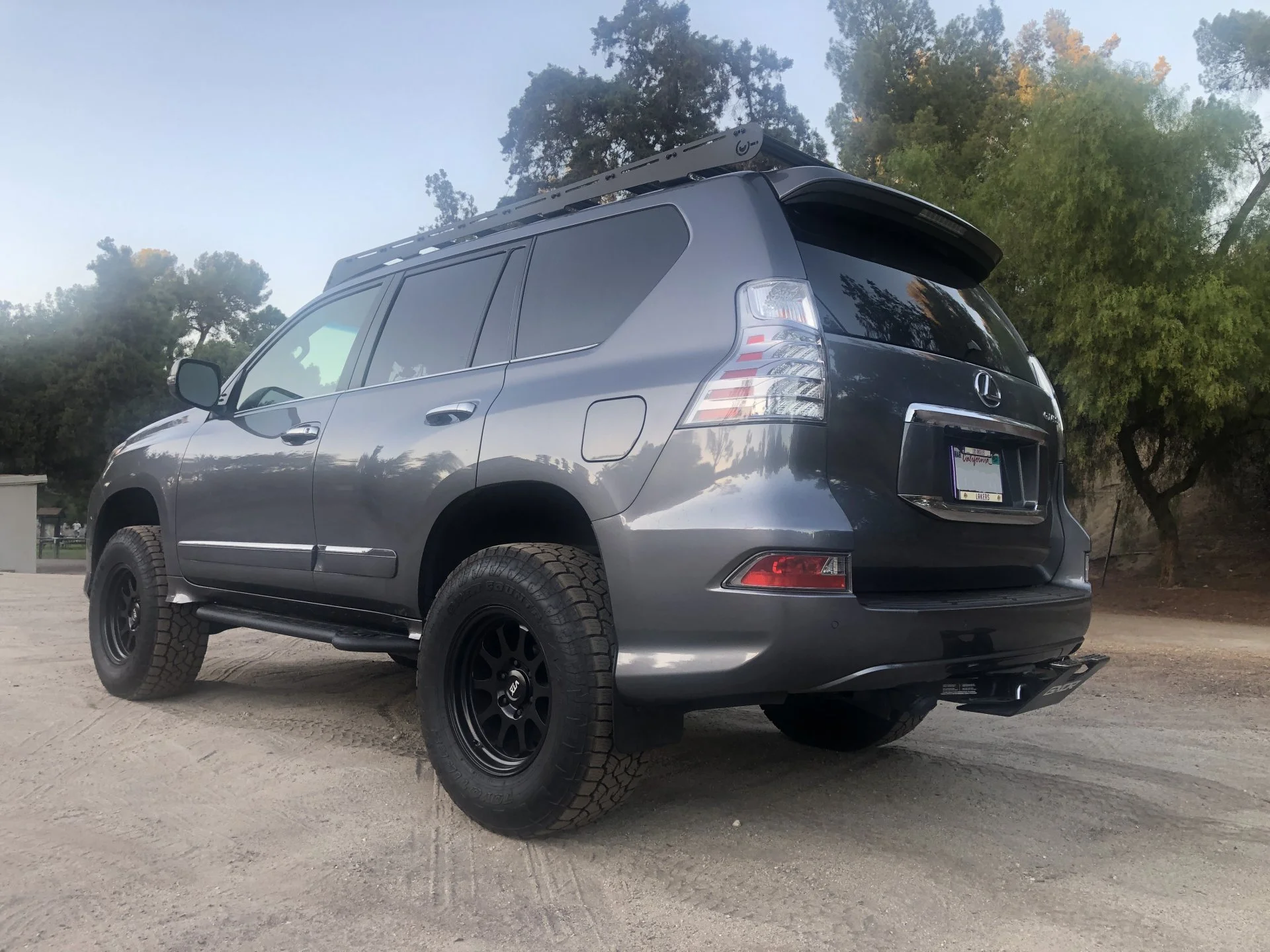

Guys, I just got lifted and put on some new kicks. I waited 3 months for Dobinson's which was on backorder across North America. I also got the Dobinson's UCA's which are built with Sankei 555 ball joints. This gives you 3 degrees of forward caster giving you the clearance to avoid dreaded body mount chop. I went with Dobinson's because they have KDSS specific springs which are offset from Driver side to Passenger. I believe this compensation is the reason why I am not detecting any lean at the moment. I had to do a little plastic trimming and heat gun massaging but other than that get great clearance all around.
Wheels are VTX Wheels Stinger SL Satin Black 17x9 ET 0 offset with conical spline lug nuts
Tires are Toyo Open County AT III Load Range C 285/70/17. Proper 33's

Ride is stock quality with bit more firmness. Tires eat potholes for lunch.
Overall very happy with how it turned out. Research pays off.

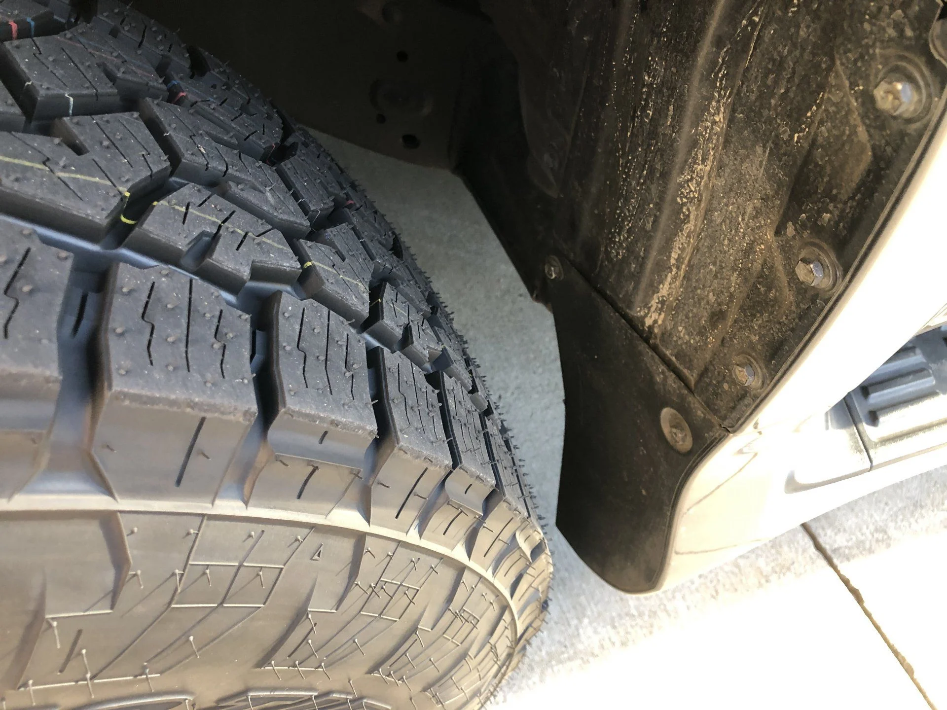

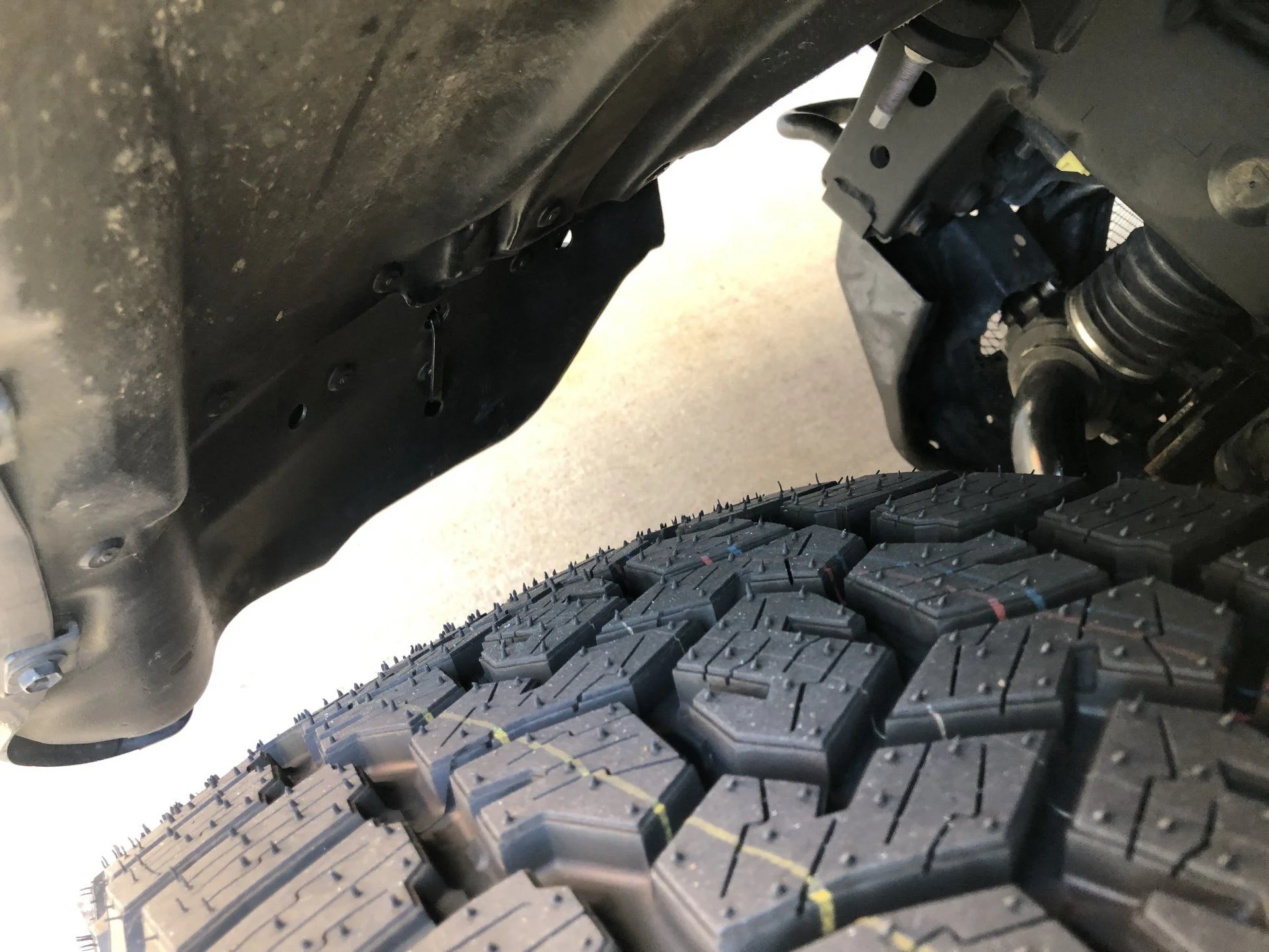

front of front wheel well:
- removed plastic piece
- heat gun massaging
- zip tie to keep it forward
rear of front wheel well:
- razor knife trimming of plastic at side step

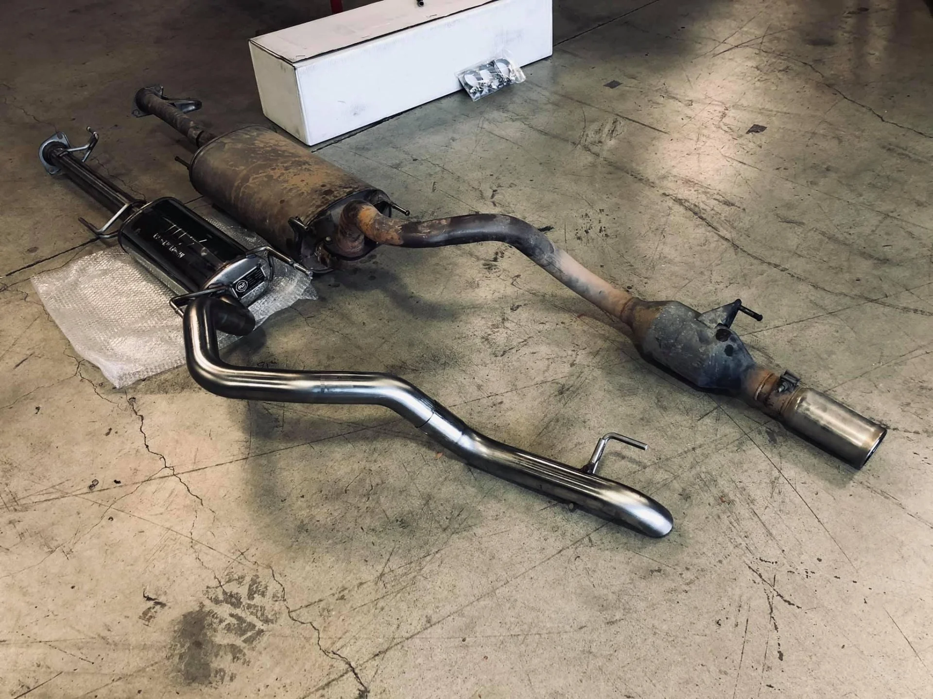

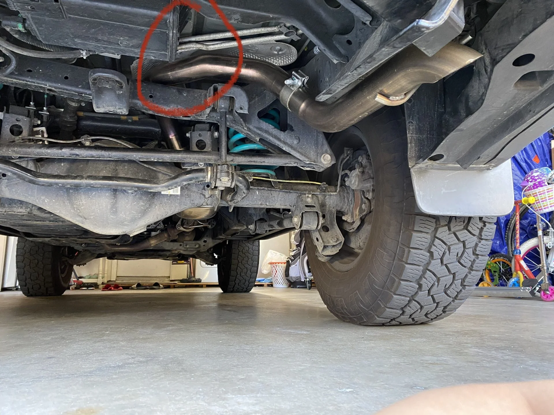

Added Magnaflow Overland Series catback exhaust. The stock hangers have quite a bit of flex. So even though you have clearance all around at install, you will hear some metal clanging as you drive. The culprit is a heatshield bolt with some extra threads hanging out (circled red in picture). Just cut off the excess threads and good to go.
Sound clip:

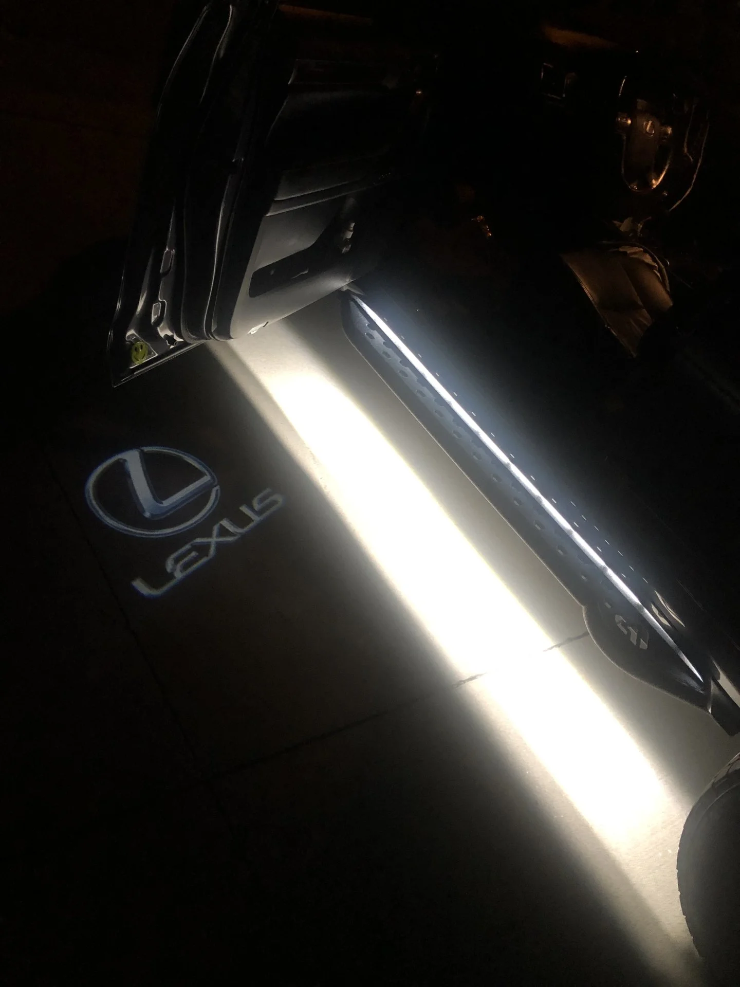

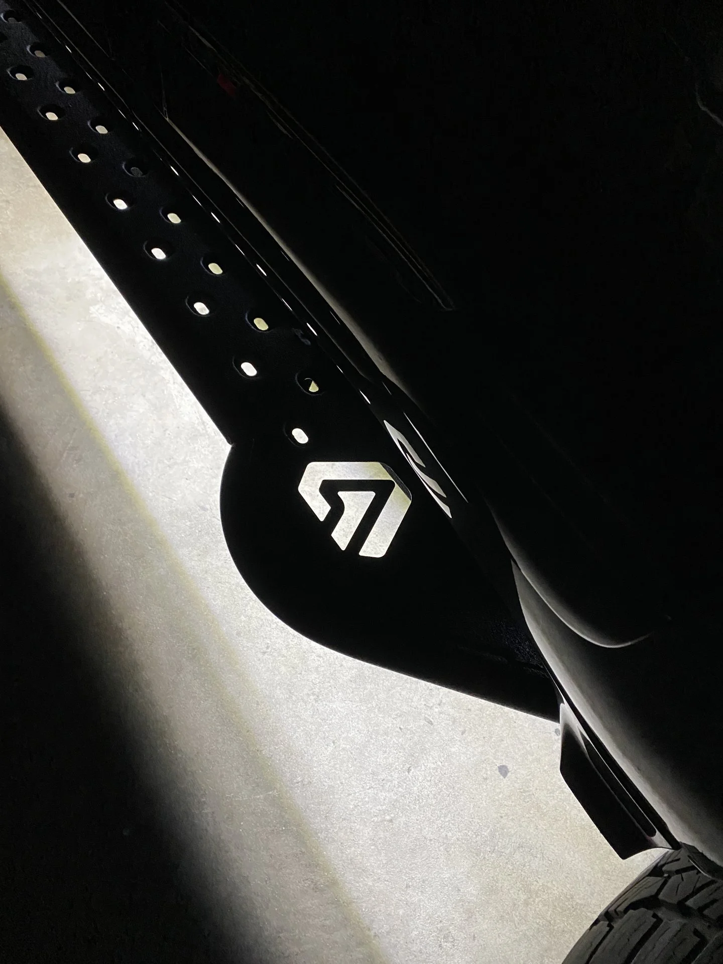

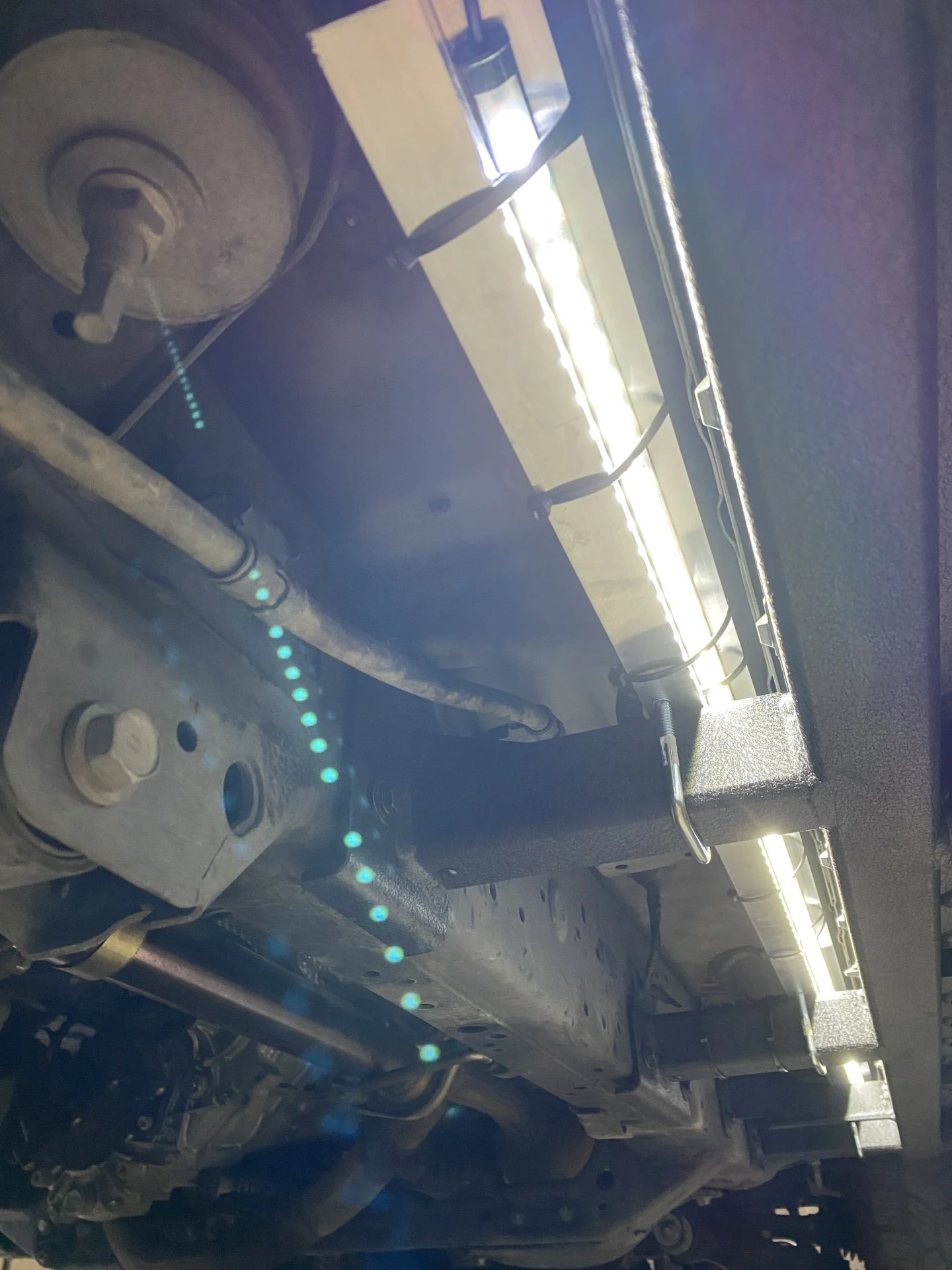

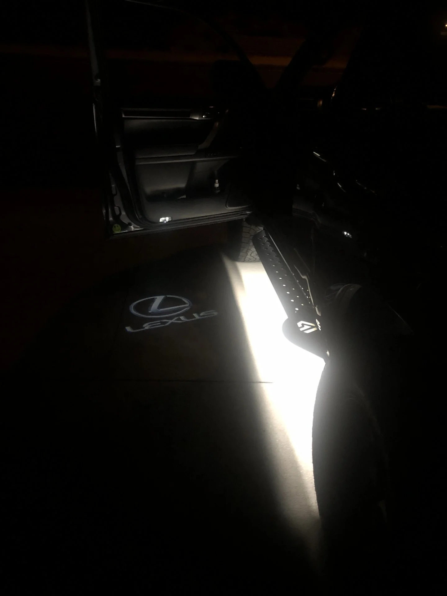

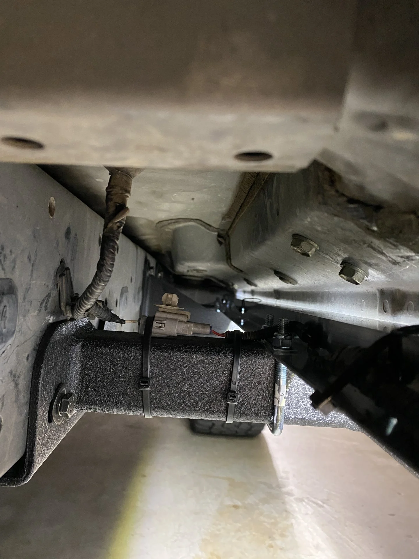

When you remove the side steps, you lose the step lights along with it. Here is a diy that I came up with to install lights on alphaEquipt sliders I got.

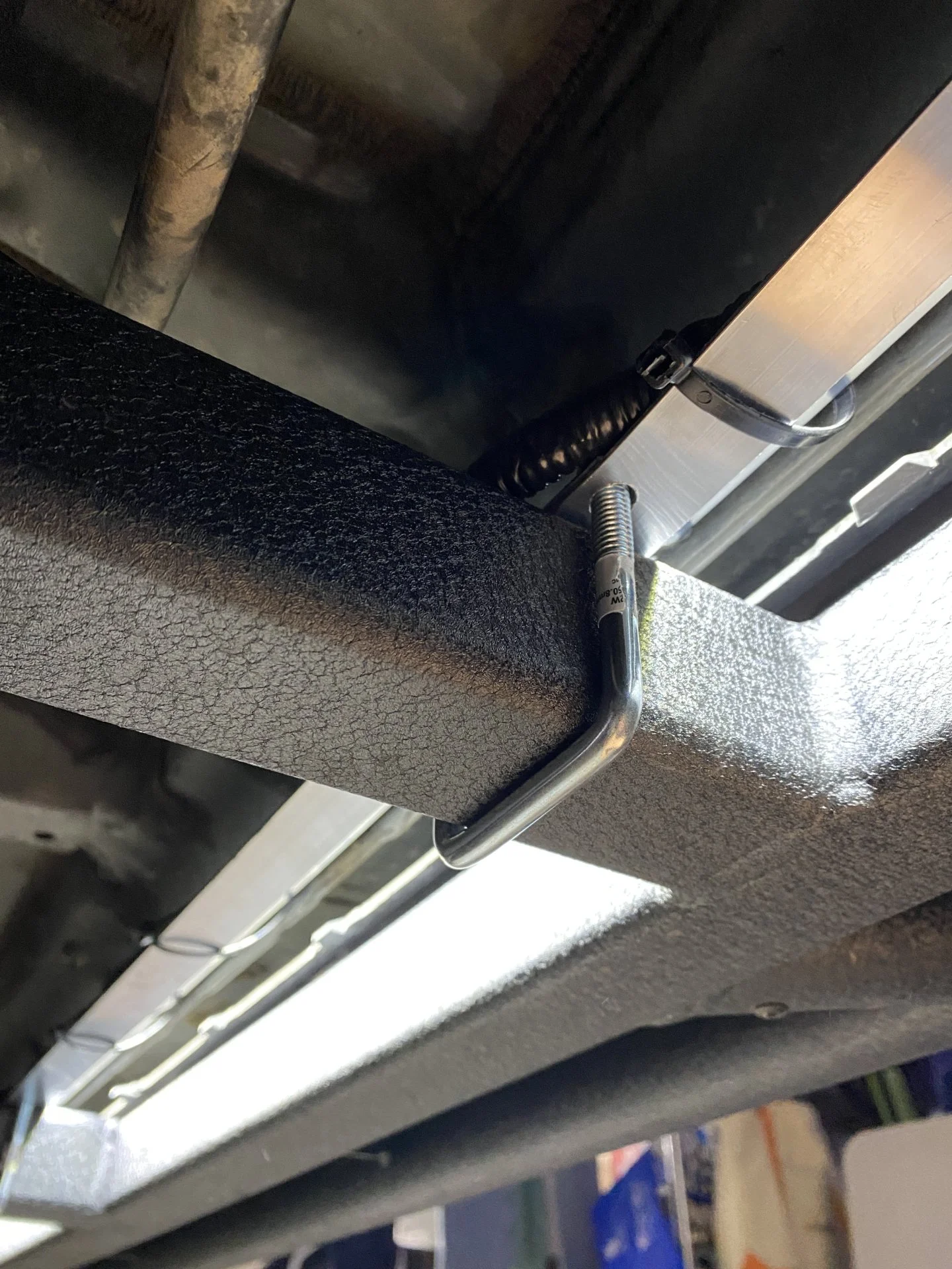

My criteria for adding anything exterior is that it has to withstand freeway speeds and has to be able to withstand a drive thru car wash (waterproof). Also I did not want the lights to be mounted underneath the sliders because that defeats the whole purpose. Also I did not want to drill holes. I realized most sliders on the market utilize a 2" square tubing crossmembers.
So with those criteria in mind, I decided to use a 2" square U-bolt to mount an aluminum Z bar directly above the sliders. Once you have the Zbar mounted, you can mount any type of lights on it. I decided to mount 60" truck bed waterproof lighting strips. Then I cut and spliced the harness plug onto the lighting strip and connected to the stock location. Used split loom and overlap taped electrical type like how the stock harness was built.
Result is very bright and even lighting which operates just as the stock lights did. I can also have the peace of mind that it is protected by the sliders and it is waterproof. May be a little overboard for just some step lighting, but this is the way I wanted it. Cheers!
