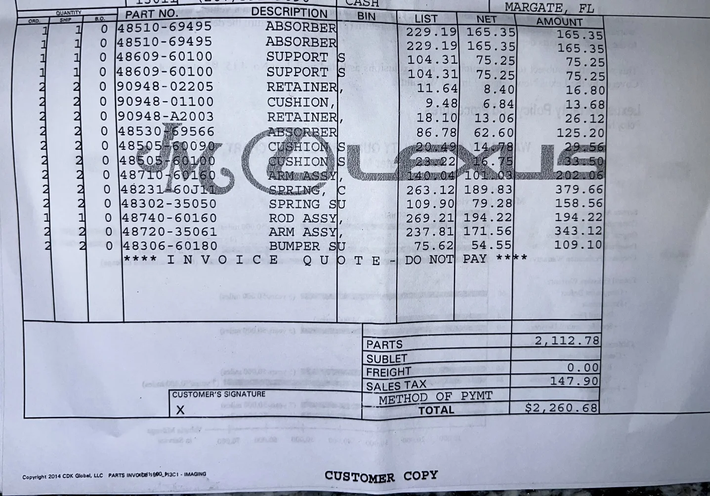

Got my OEM suspension refresh quote from dealer… Not really interested in aftermarket as my truck mainly lives on road.
1) Is part list correct? Do I really need to do all of these parts?
2) Am I missing any parts? UCA or FLCA?
3) what else would you do?

1. $2200 is not a bad price for all new, OEM suspension parts. You can probably beat that price if you order the same parts from either a local Toyota dealer (many of whom have 15% off sales on holiday weekends) or from Partsouq, where they might be 40% cheaper.
2. With 200K on the rig, IMO you should replace all suspension control arms. The rubber bushings are going to be pretty worn out and I'm betting several are torn. This includes the front UCAs and LCAs, as well as the same in the rear (plus the panhard bar). I've had good luck with aftermarket Moog LCAs in the front, but have ripped bushings in Moog LCAs in the rear. I'd go OEM if you can for all of the control arms. Aftermarket quality is just too hit or miss.
3. Since you are looking to replace the shocks and springs, I'd consider a buying a bundled lift kit with springs, shocks, and front UCAs. This will perform better than the stock suspension and might save a little bit of money as well, if you can catch it on a 4th of July/Labor Day weekend sale. I'd suggest an Ironman FCP kit (which I have) or a Dobinsons kit.
4. I would also replace the front and rear sway bar end links, front outer tie rod ends, and KDSS/sway bar bushings. The end links and tie rod ends can be found cheaply on Partsouq (555 components, which are made in Japan aftermarkets that are close to identical to OEM Toyota), or, at quite a bit higher of a price, from your local NAPA. You could also get OEM parts from your dealer. You can go OEM for the bushings.
For reference, I replaced all of these parts on my rig in 2021, using an Ironman Foam Cell Pro lift kit (with aftermarket UCAs) and all Moog control arms (lowers in teh front, all 4 in the area) and Moog sway bar end links and tie rod ends. It cost me around $3,200 in parts and I DIY'd the work in a weekend. The rig drove (and still drives) like brand new.
In the 4 years since the install, I've replaced the tie rod ends and sway bar end links with 555 parts (due to Moog being junk) and will replace the rear lower control arms with aftermarket arms, since the OE-style rear arms are weak and one has a ripped bushing. Had I skipped the Moog parts, it would have been around $3,500-$4K in parts. But, I have a rig that still drives like brand new :).
