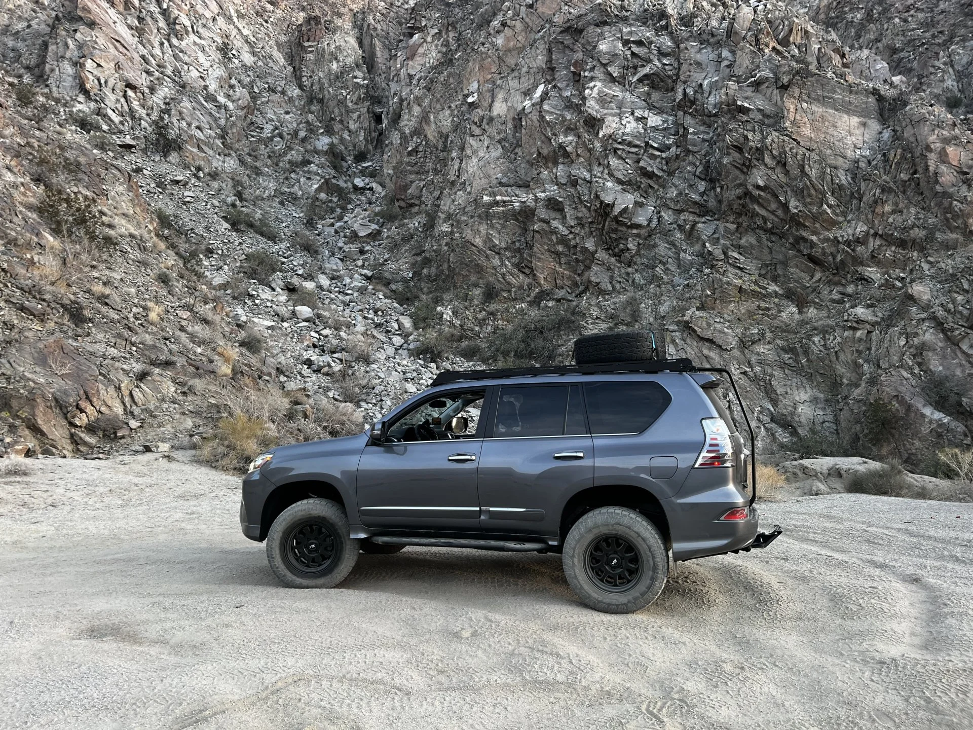

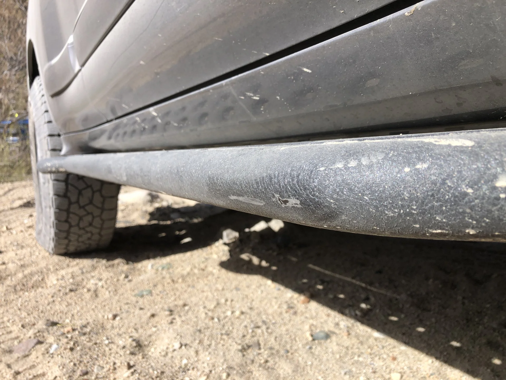

Sliders took first trail damage. Just a little nick lol.

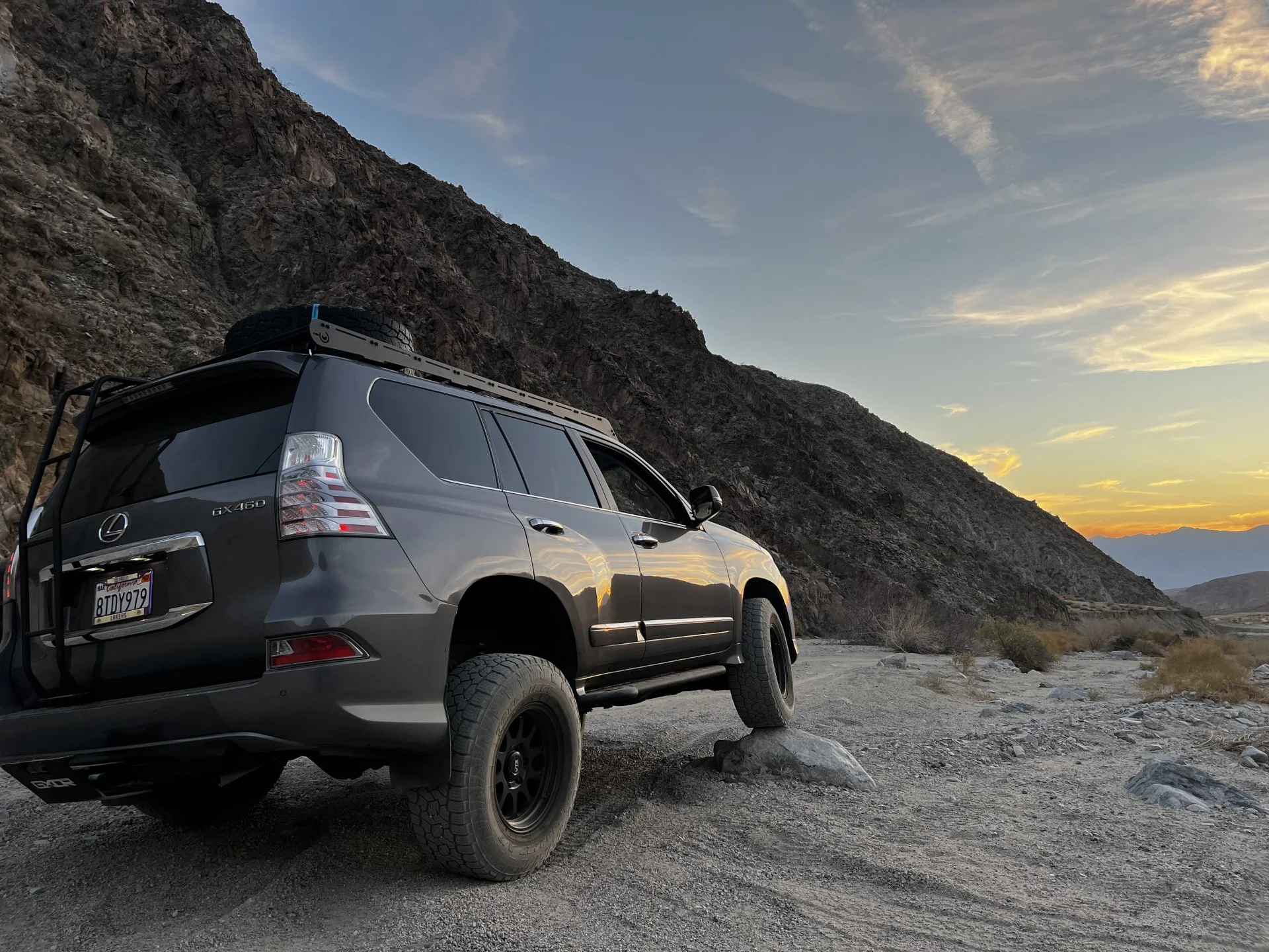

Added Magnaflow Overland Series catback exhaust. The stock hangers have quite a bit of flex. So even though you have clearance all around at install, you will hear some metal clanging as you drive. The culprit is a heatshield bolt with some extra threads hanging out (circled red in picture). Just cut off the excess threads and good to go.
Sound clip:
This... Now I'm sold on getting one. Sounds great. Thank you.
Nice work! curios what are you averaging on MPG after this setup?
