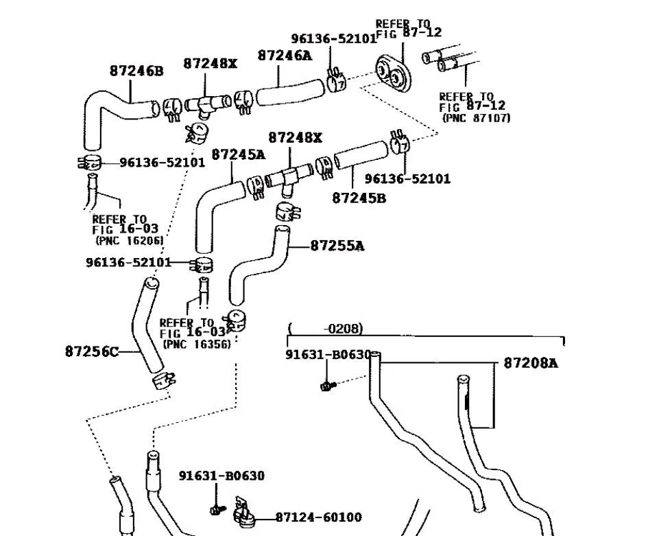

Does anyone have a diagram that shows the correct orientation of the 6 new hoses relative to the "T" so that I can pre-assemble those 2 coolant line assemblies prior to installation in the engine bay?
Specifically the part numbers:
87245-6A180
87245-6A210
87245-6A190
87245-6A220
87245-6A201
99556-20200
I'd be curious to know the correct OEM P/N for the hose clamps too if anyone has it!!!
-G
Is this what you need?
Oh HECK YEAH!!!!
Nice, thanks! I need to cross-reference some of those 6-digit alphanumeric codes to the more traditional 10-digit numeric part numbers but that should be pretty simple. From the looks of it, ALL of the hoses are clamped with the same part number? (some clamps aren't called out with a p/n in that diagram).....
I appreciate the help. Thanks!..
-G

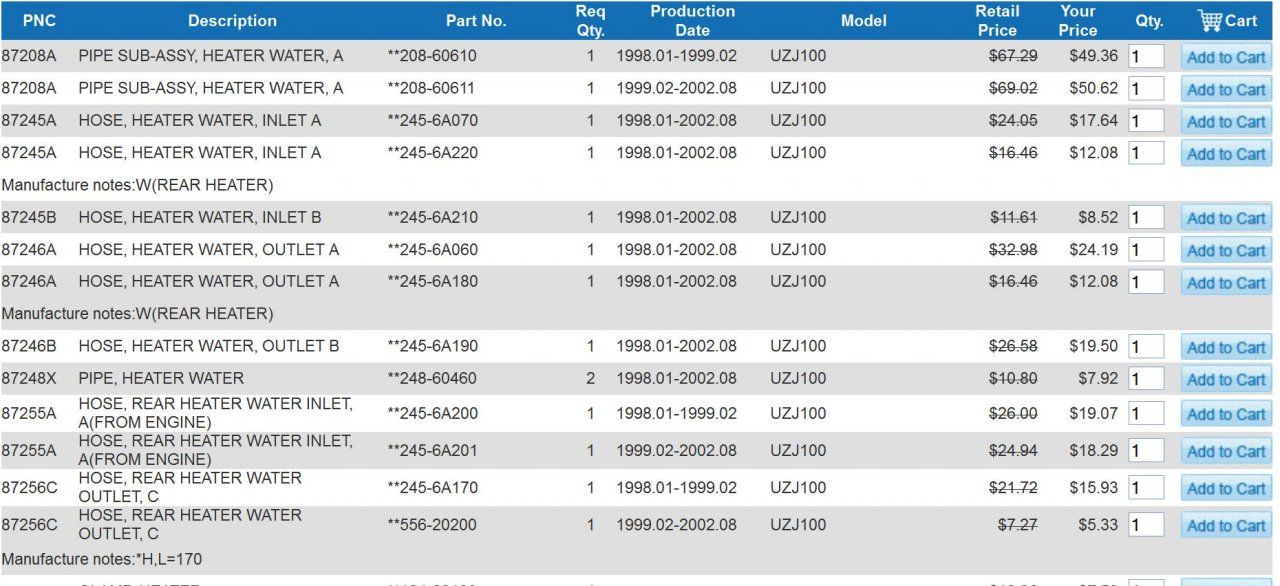

Found this on a website. Pay attention to where it notes "W/ REAR HEATER"View attachment 1057764
PERFECT!
Yes, I notice that there are two versions of some parts due to a manufacturing change in early 1999, and also the parts are a bit different if the LC does not come with a rear heater option.
I've annotated the first exploded diagram for my 2001 LC, so when all those little Toyota plastic parts bags arrive I should be able to assemble the puzzle!!! :)

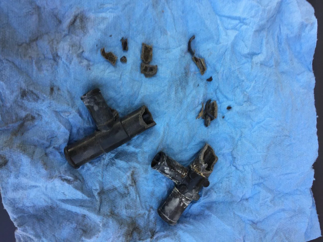

Here's mine after 105k; super brittle and completely crumbled as I was taking them out...anyone reading this should definitely do it if they haven't been done.
