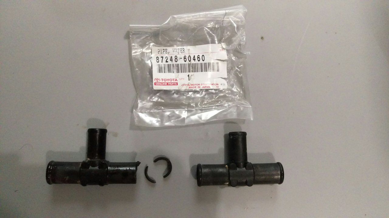

I just replaced my Plastic T's with more factory T's. My Original plastic T's looked virtually identical to Helm's, except one of mine is literally corroded away to almost the very edge of the hose where the clamp was. I can't believe that coolant wasn't leaking out of the worse T.... it is a miracle. The clamps still squeeze very tight and the hoses are in good condition, so I left them alone.
My rig has 134,000 miles on it and these should have been replaced at 90K........

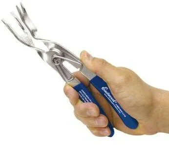

I've used this tool in so many random ways over the years and it bailed me out on the Heater T replacement too. Basically reverse pliers. You can put them on the heater T and squeeze them they'll push the hose off. Worked really easy on mine. No way could I get them off with just my hands.

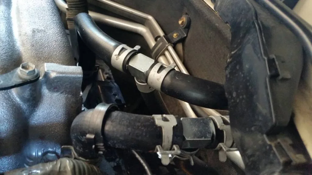

well, i just finished this project. it was one of my least favorite ones to do. even cutting off the old hoses was a pain. overall, it took me an hour and a half. i lost a bit of coolant, not a ton but enough to get the ground wet. i popped the radiator open and let it idle for a while to bump the system. if i can't see coolant in the radiator, should i add fluid until it's topped off? the coolant reservoir was between high and low, so i don't want to overfill.

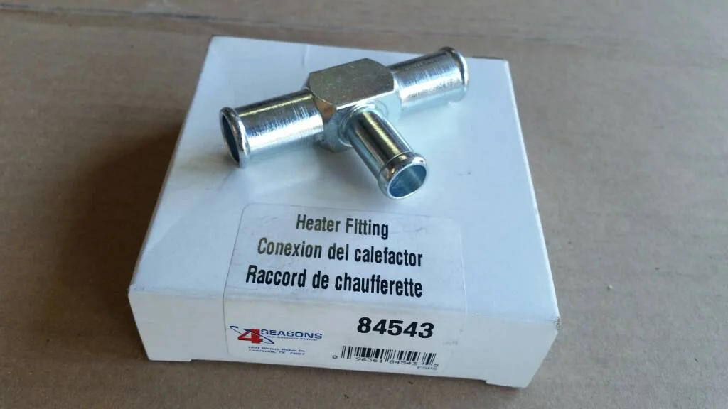

Are those exact fit or are they somewhat larger/smaller on any of the inlets? Do you have an installed pic?
I would say it is slightly smaller than the stock metric T based on the feel how it slides into the hoses. I got leaks when installed with original swollen OEM hoses. No leak when installed with new 5/8 and 1/2 Gates hoses.
