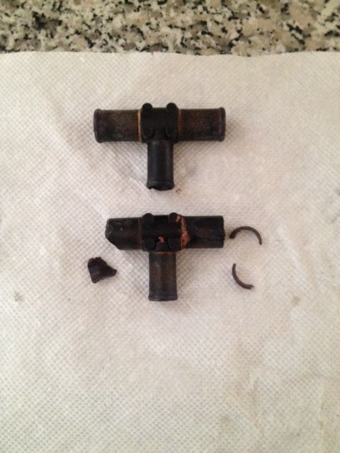

Don't let this happen to you... This original T only lasted for 213,000 miles... I should've replaced these already but at least mine broke close to home and I only had to wait overnight for my local Toyota parts department to get me 2 new ones... Pretty crazy how deteriorated the "hot - driver side" T was... It fell apart the rest of the way after disconnecting...

I replaced my T's on my 03 LX470 last month with 120k miles and the T's looked like new but the hose was compressed so much by the clamp that when I released the clamp it started leaking. Also there are two hoses under the vehicle that should be replaced at the same time. They were in need on my LX.
Saw all these broken T's here earlier this week, so made it a point to do this today as I'm now around 160k. Noobie tip: soapy water on the clamps. Use your fingers to twist them up for easier removal. The clamps towards the firewall were tough to get to. After about 1/2 hour of contorting every which way, I (painfully) twisted them right side up. Had I done this earlier, it would have been a 10 min job. One of them broke off (the lower hose pictured below, towards the engine). I tried to retrieve all pieces. Hope I did. Couldn't take the hose off, so hoping nothing got in there. Would it be a good idea to do a power flush? Coolant was done at 120k, so don't need it done, but I don't want to risk it clogging the thermostat or radiator.

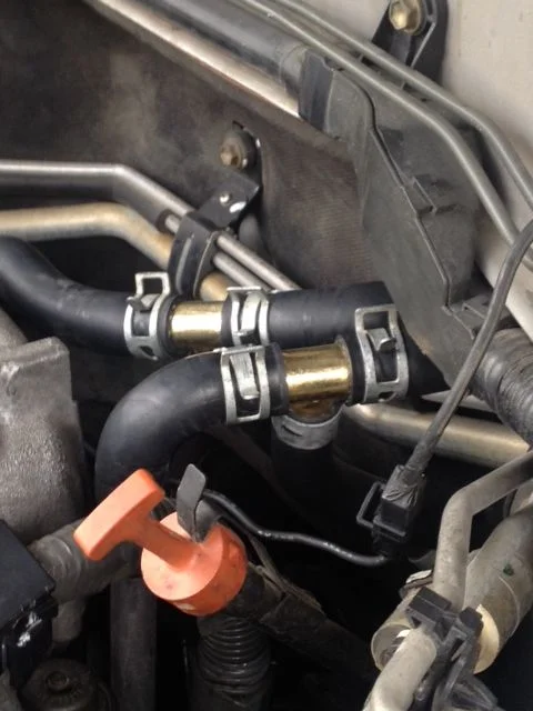

Just did mine yesterday. Replaced with brass. Also replaced the hoses, so as not to worry about those later. It was a real pain removing the rubber hoses from where they connect to the heater tubes and the top of the motor. I ending up slicing the ends with a box cutter and working them off. Surprisingly, the "T"s were not bad but the rubber hoses were hard, to the point where most of them could not easily be pinched. LC has 207k on it and they may be the original hoses and "T"s. I also did the TB, water pump, T-stat, tensioners, hoses, and serpentine belt. Glad that is over with. Thanks for the info.

My 2cents worth...Mine broke on a night ride last October and I had to leave the truck on the trail to make it back to camp. Went to lowes next morning and bought some PEX T fittings (brass) in the plumbing dept and buttoned it back up with compression clamps. The PEx fitting isnt as long as the original and the bottom diameter is a little smaller but it worked and has been working fine since. Good option in a pinch. ABout $3.50 for the T.
