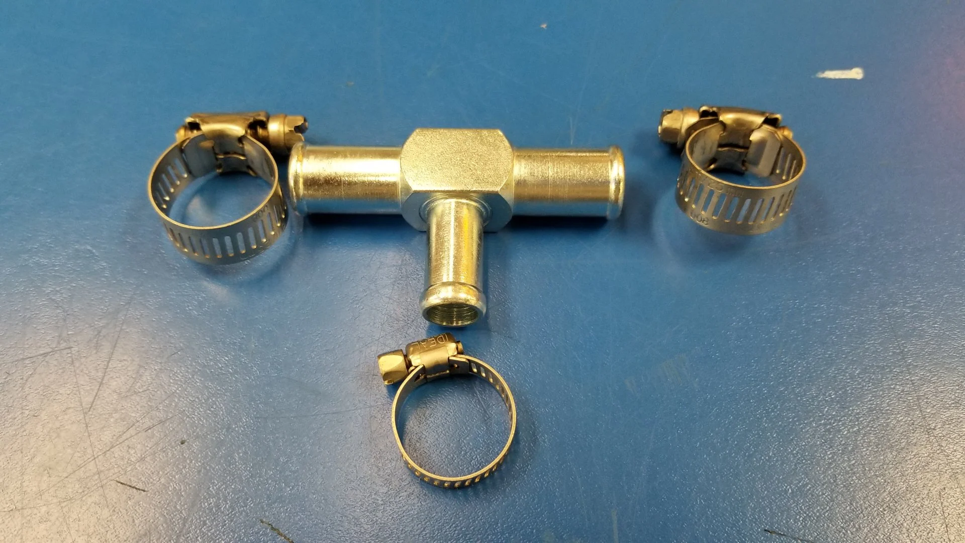

FWIW, if you decide to keep your metal T setup, you might want to look into some European hose clamps. They're also worm drive, but they don't have gear holes that go through the clamp band, and they have rolled edges to prevent the band from digging into the hoses like the ones in the photo can do (the "Breeze" type.) The brand I've used with great success is Norma (example: https://www.amazon.com/NORMA-01266704016-000-0539-Hose-Clamps-mm-20/dp/B06Y298TQ5/?tag=ihco-20 )
Thank you!
I will keep the metal Ts, but knowing what I know now, I would have just used OEM for direct fitment and they last 90k!! At 3k miles a year, it will take me 30 years to replace them 😄

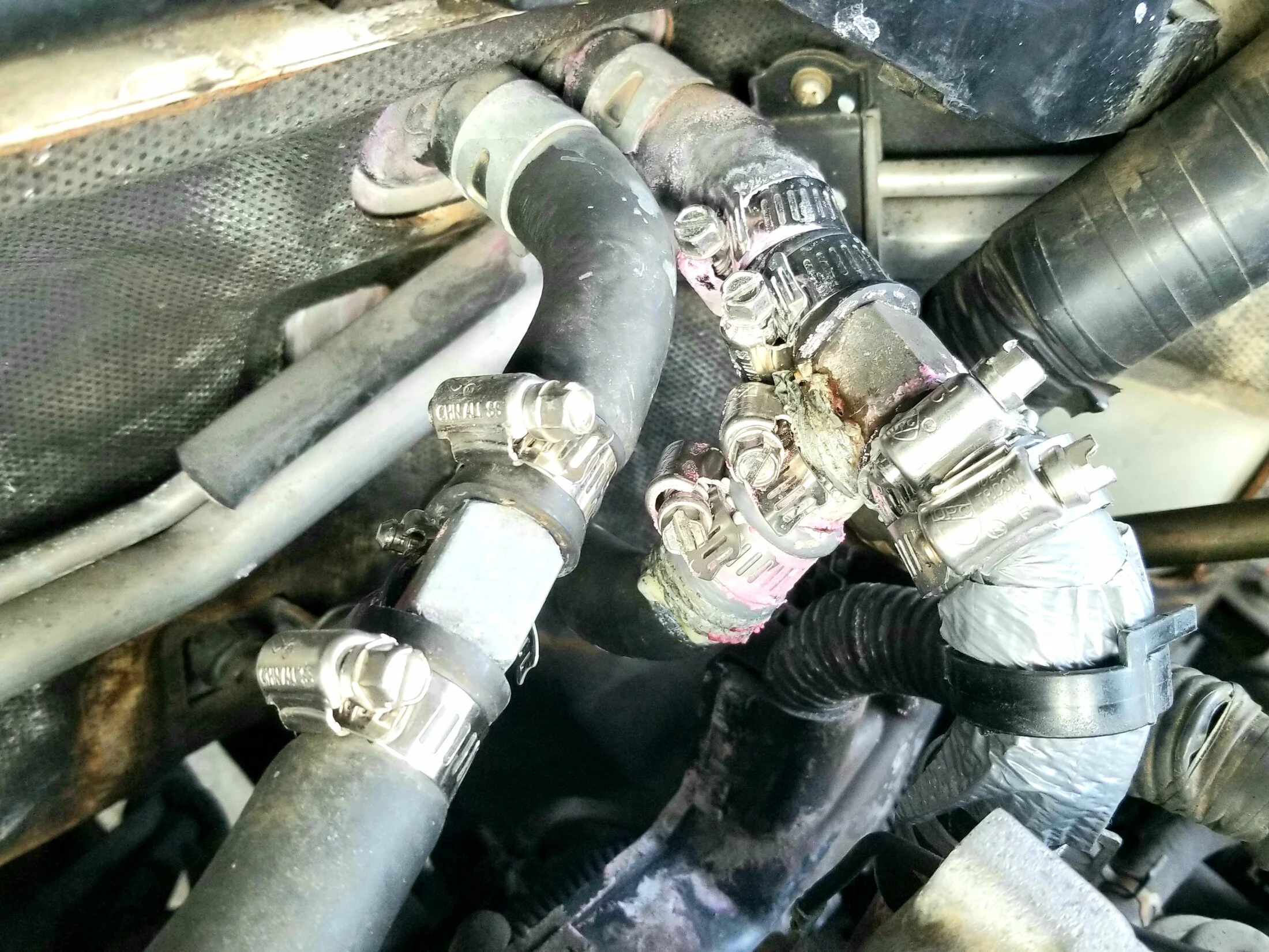

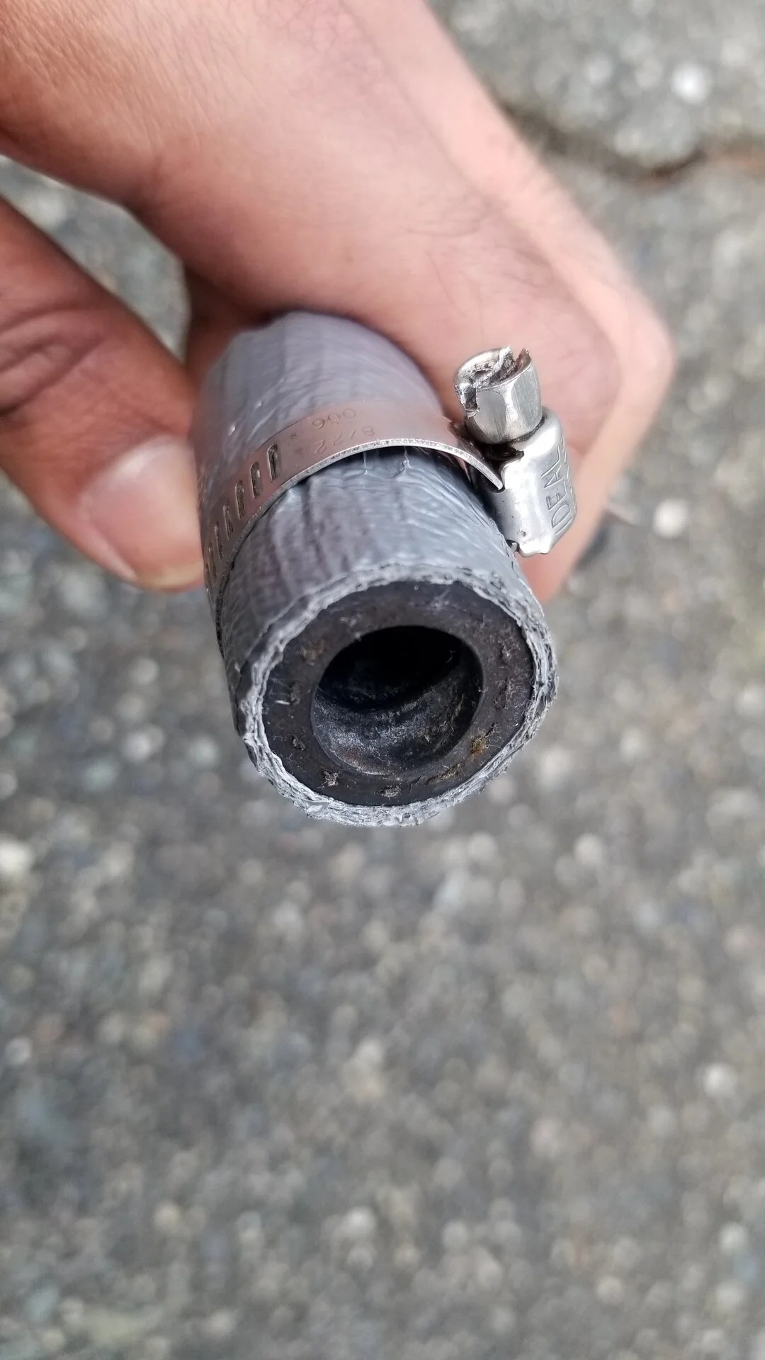

Took the hose out, looks good, no puncture, they are thicker than I thought, but it was loose so I put duct tape and retightened it.
I will replace all clamps with wider ones in the near future..

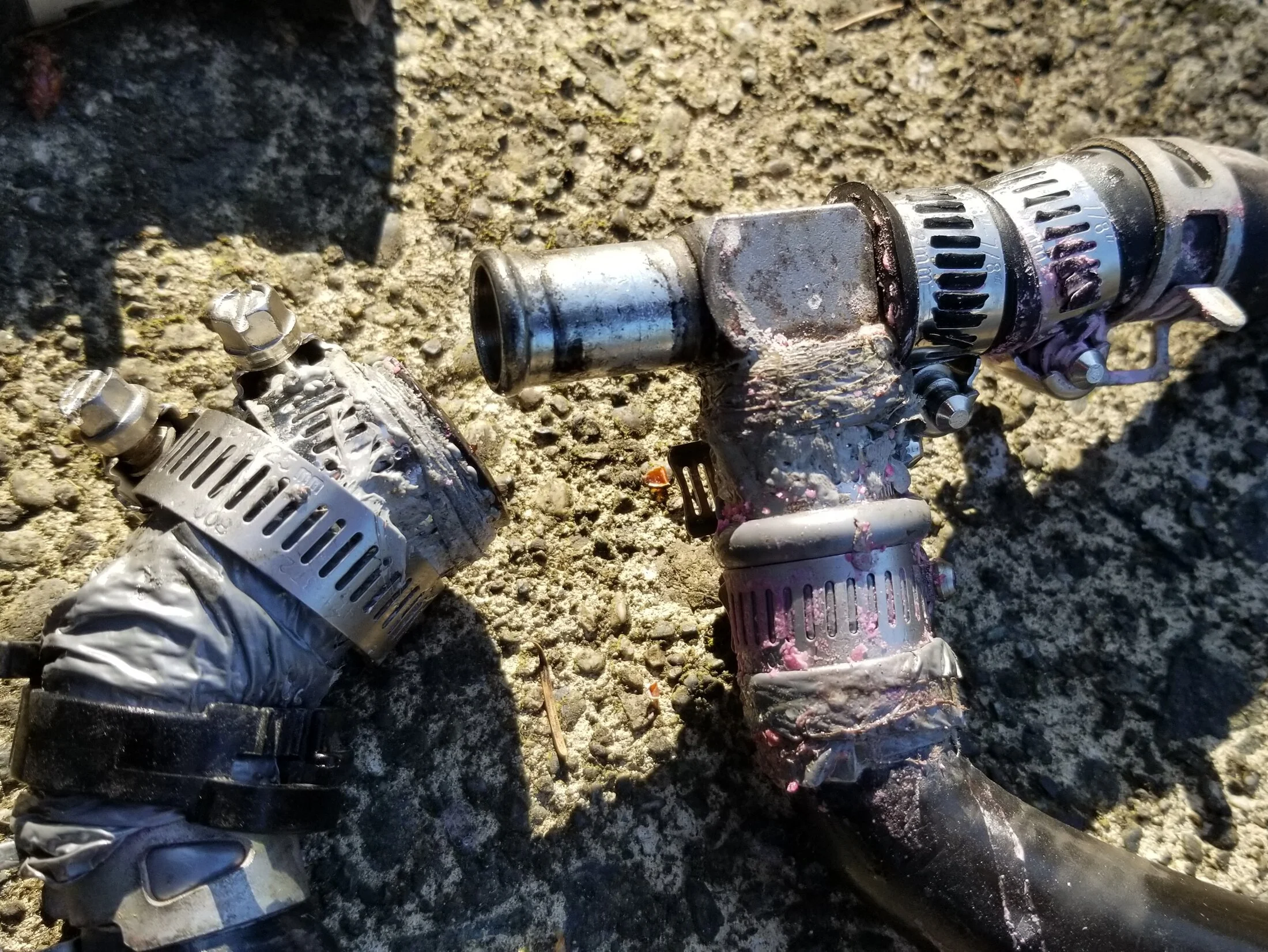

I used theses in 2019 and squeezed the clamps hard on the hoses.

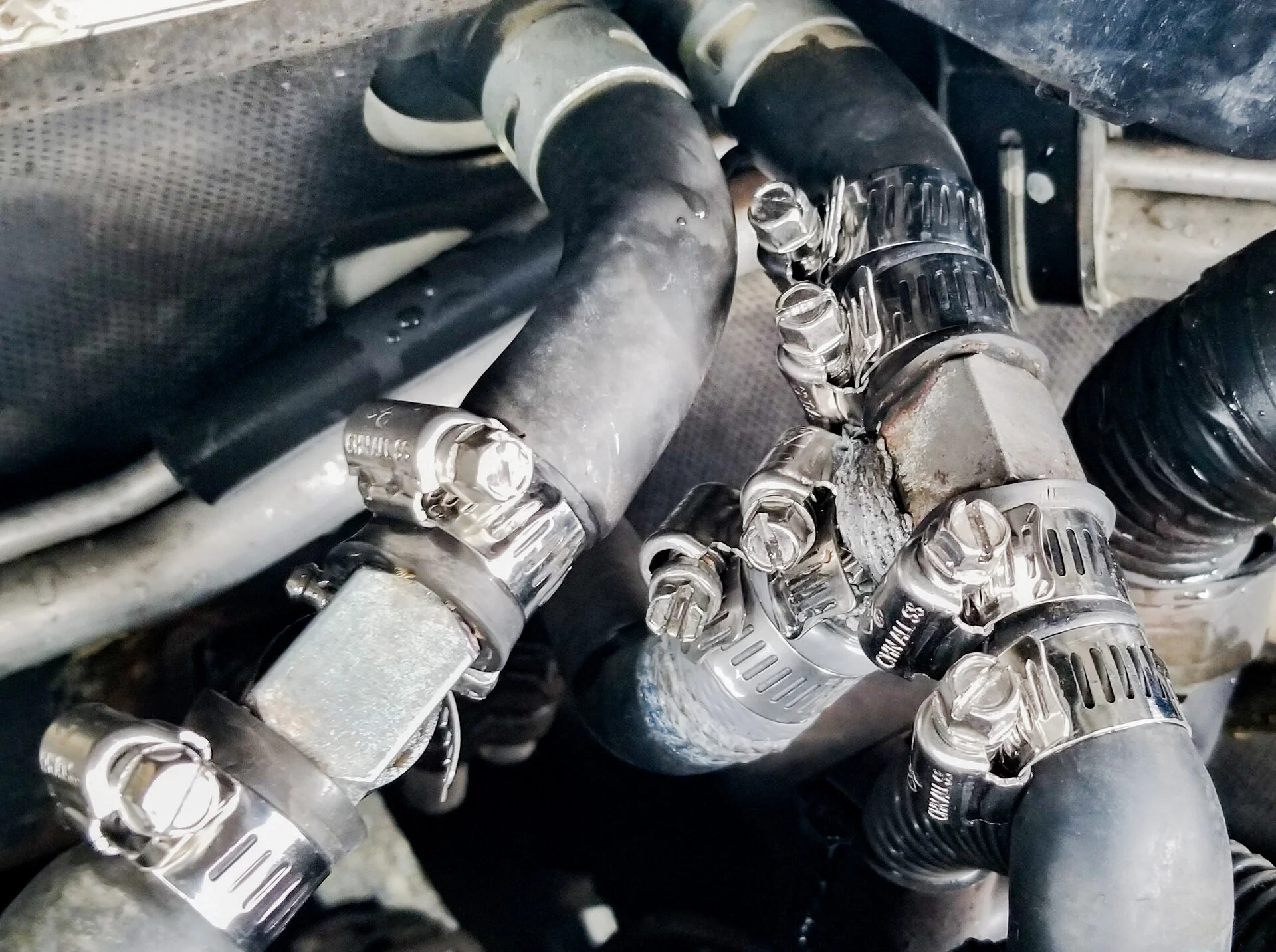

2 days ago i did a 3 gallon pink coolant drain and fill.
this morning there was coolant leaking under the car, later at the office too.
The bottom hose of the Ts (in the hot side) looks ripped under the clamp, even though I didn't squeeze it further since 2019.

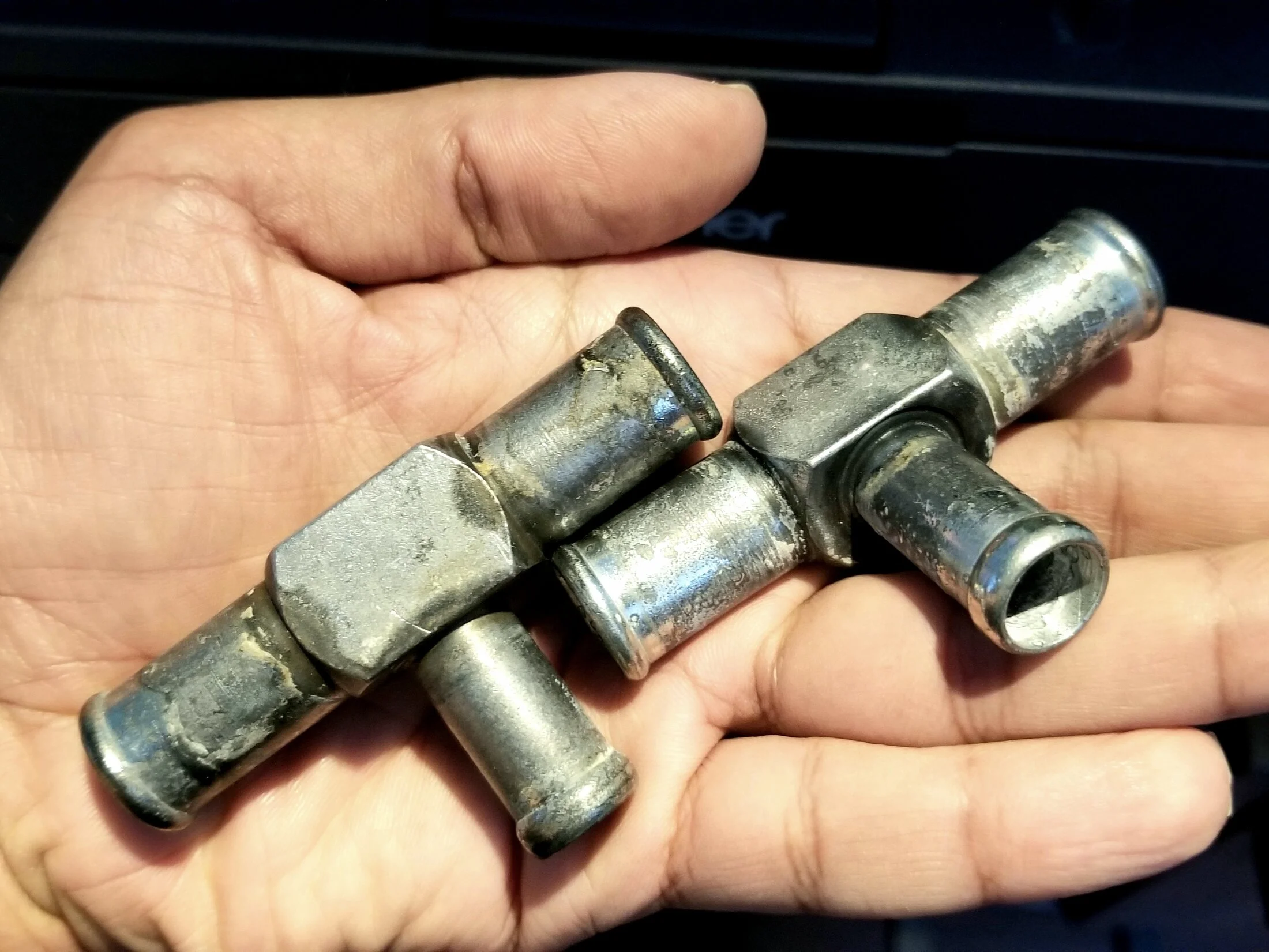

The hose might be deteriorating due to age, but anyone thinking of using the metal Ts, make sure you find a size matching the Toyota Ts so you dont have to over tighten the clamps.

looking back, I should have bought OEM plastic Ts or find the correct size metal.
I picked these SAE 8 clamps from HomeDepot yesterday and doubled the side that was seeping coolant slowly during the last 5 years.
It was drawing the equivalent of coolant in the reservoir from max to just below min.
That's approximately 20k miles in 5 years.

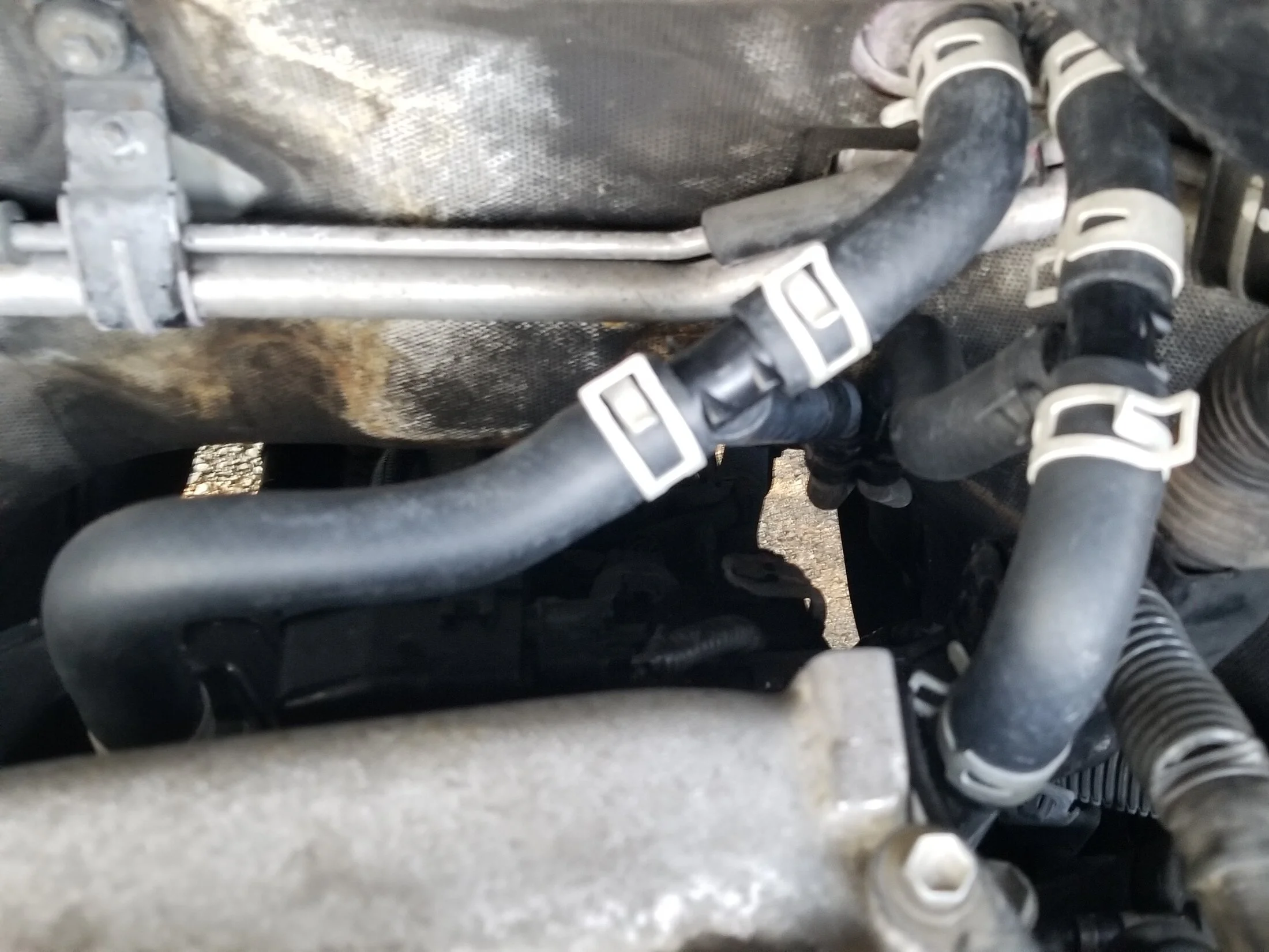

Replaced leaking driver's side tee this evening. With 235K, driver's side had been leaking. Based on all the stories, I decided to try an experiment. I replaced all 3 hoses and clamps; all OEM. For removal, I experimented and found it pretty easy to use a very sharp razor knife to cut through the 3 hoses and remove the tee in one piece; one near the riser off the block, near the firewall and near the down pipe to the heater core. As I was about to toss it into a bucket, the tee snapped so glad I dodged the bullet on dropping pieces of tee down the hoses. Put all 3 new hoses on to the tee, slid the constant tension clamps on (oem has a cute little red clip that's fun to remove), took a little dip of coolant for lubricant, and slid the whole assembly into place. Snapped the clips, put the little wire clamp back on, and cracked a beer. Easy-peasy. Going to do the other side same way, re-fill and try to burp the system. Hope this helps!

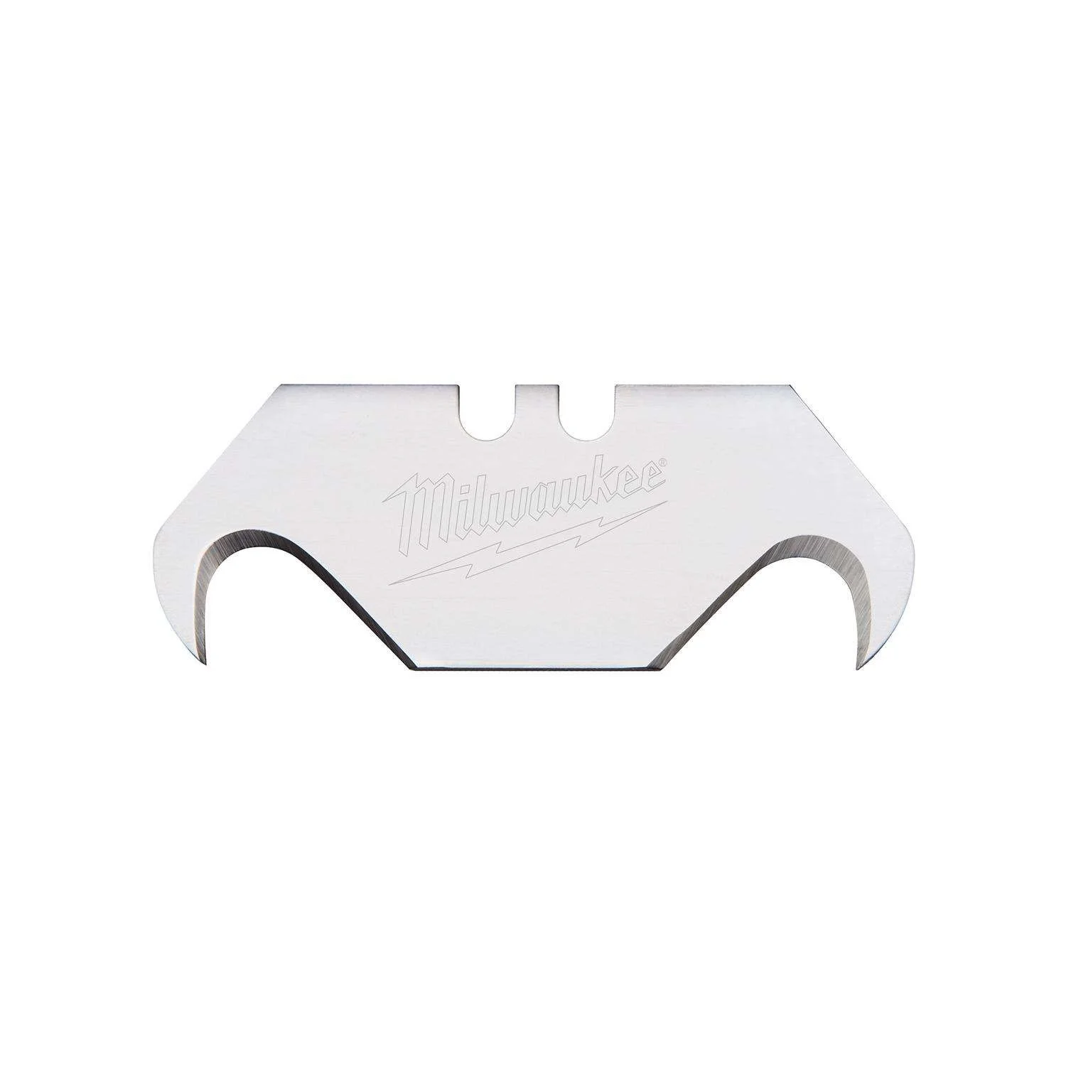

I use a hooked rasor, being careful to not nick, cut or score pipe. I replace only first (from water bypass out) short 90 degree hose that I cut off, unless other swollen. I use the old OEM clamps, replacing only non OEM.
I use a hooked rasor, being careful to not nick, cut or score pipe. I replace only first (from water bypass out) short 90 degree hose that I cut off, unless other swollen. I use the old OEM clamps, replacing only non OEM...
Lesson learned. I think I had noticed your comment on the hook razor elsewhere and wish my foggy memory had worked. I did, indeed, score the hose pipes. Dammit. The worst was the passenger side firewall pipe, on the top, but it fortunately doesn't go all the way to the end of the pipe. I played with the new OEM clamps and the originals for quite a while, trying to figure which was best. I ended up replacing them, but I'd bet a buck the originals have more strength than the replacements. Time will tell if I created leaks and will post back if I do.

Unfortunately with this setup, there still small leaks and 1 hose might be pierced from over tightening, not urgent, but might take at least 2-3 years to empty the coolant reservoir. However, I learned my lesson and got the list of parts to turn everything back to OEM and think might just replace everything as they are over 20 years old anyways

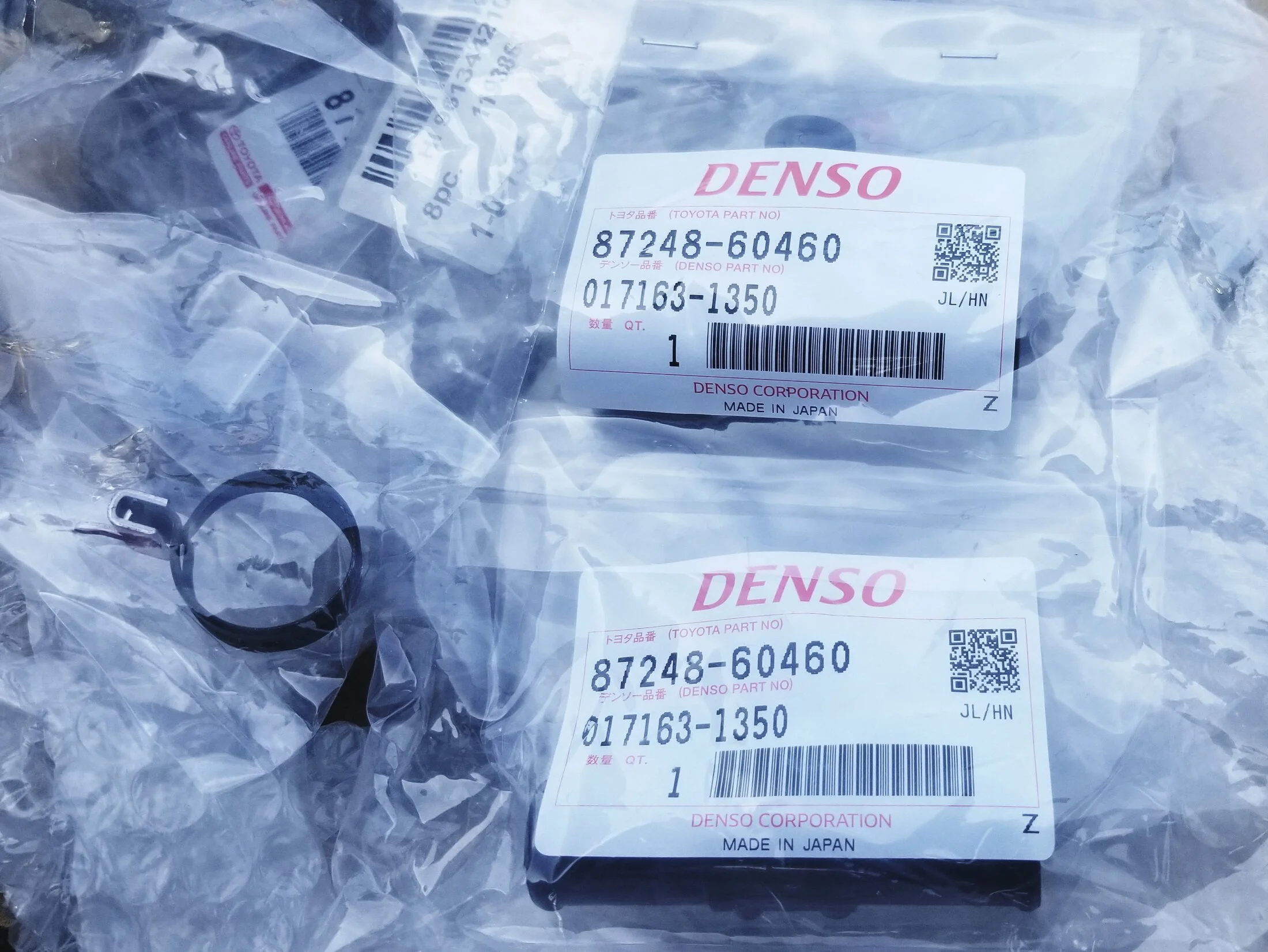

OEM heater tees (2x): 87248-60460
Local Lexus/Toyota charges around $318 CAD, but Amayama charges around $83 !!
Anyone ordered from Amayama can kindly share experience on delivery ? Thank you!

Cleaned the aluminum Ts, will keep them for emergencies, however, I was wondering if I could have used industrial sealant tape to make them leak proof??
>>> sealant tape
anything's possible but that's not necessary..... It's possible to just have the system perform with the proper parts..... The screw style clamps + those t's from your previous post seem to be a bad combo.....Stock plastic t's or the upgraded brass part that @cruiserpatch sell , paired with OEM hoses and clamps , won't leak and will last 150k or longer without any signs of leaking
Yes, I learned the hard way, so everything is back to OEM now, zero leaks, but I wish the sealant idea crossed my mind back then ...
