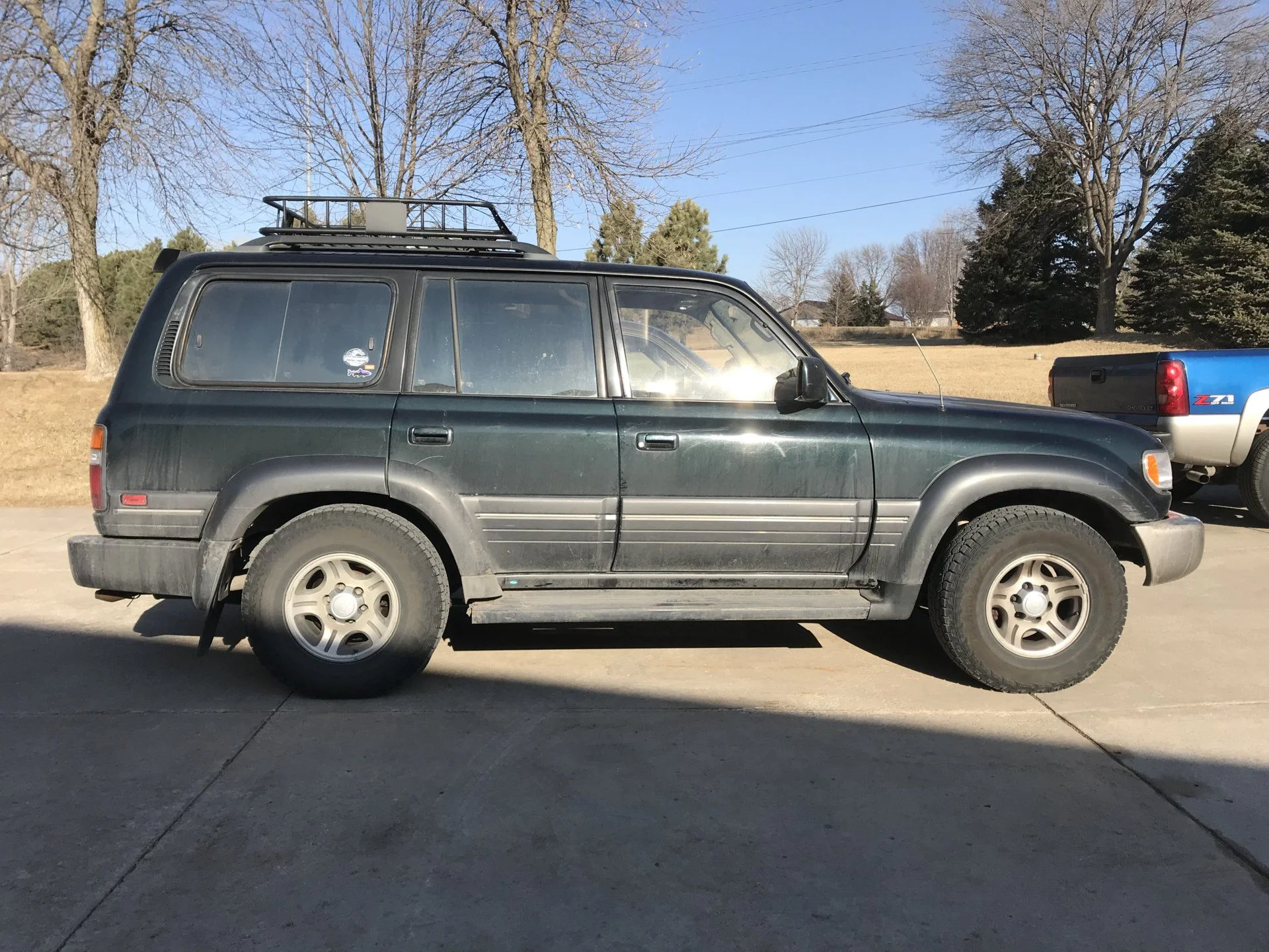

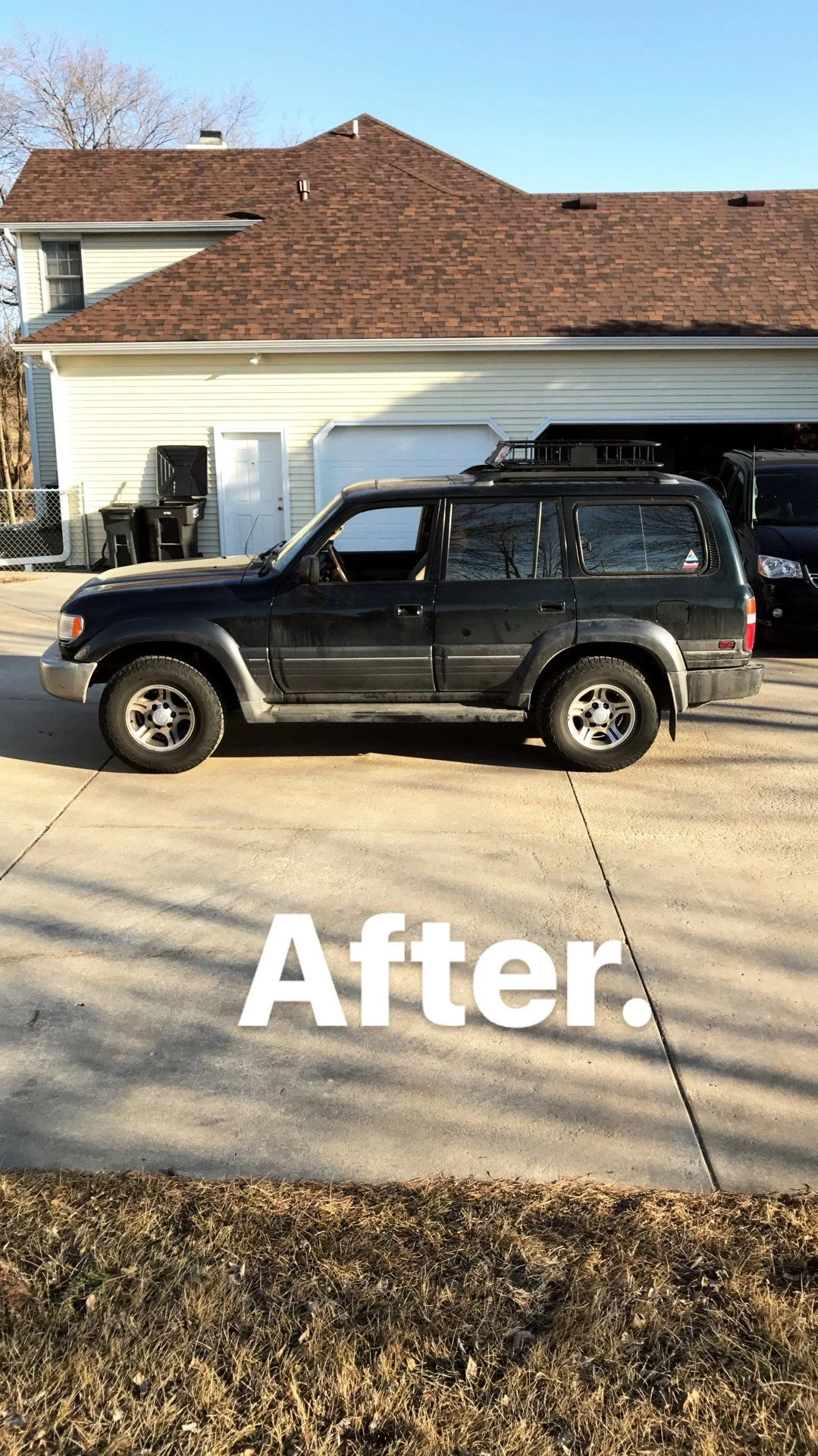

Saturday, I spent the day swapping out my saggy, worn out, 200k, OEM springs on my LX450 with OME 861/862 stock-height springs.
The springs were labeled A and B, as I had read they would be on Slee - OME Suspension Installation (Toyota 80 Series Land Cruiser) and many other forum posts. I knew that the A springs went on the Australian drivers-side which is RHD. So, for some reason, I completely disregarded the myriad of tutorials and figured that the A-springs would need to go on the US drivers-side because they're the stiffer springs. Since the weight of the steering components and the driver-weight would cause the US LHD drivers-side to be heavier, I figured the AU driver-side springs should go on the US driver-side.
Well, obviously, I was very wrong and now my LX sits a little bit higher on the passenger-side.
My question is why? Is the RHD Australian driver-side still lighter than the LHD US drivers-side? Is the LH side of the FZJ80 still heavier regardless of which side the driver seat is?
I know I installed them incorrectly and I know it was stupid, so please refrain from telling me the obvious. I'm looking for answers as to why the left-hand side of the vehicle is the heavier side and why it's sagging.
Gas tank and driver are both on the left.

Thanks for the responses everyone. As it sits, I have the A springs on the LH side and the B springs on the RH side, and I thought the A springs were supposed to be the stiffer/taller/stronger/whatever of the two.
Just so I have the correct understanding, the B springs are the taller springs that should have gone on the LH side (US driver-side) of my LX450?
I will also say that the unevenness is very slight, like maybe a 1/4" with a half tank and no one inside. I'm sure it's more-so while I'm in it and with a full-tank.

Yeah, it's not off by much when looking at it while not in the car. But I'm unsure how much it sags to the left while I'm in it (I weight 200lbs). I'll see if I can con a similar-statured stranger into sitting in my drivers seat for a few minutes while I test the angle haha.
