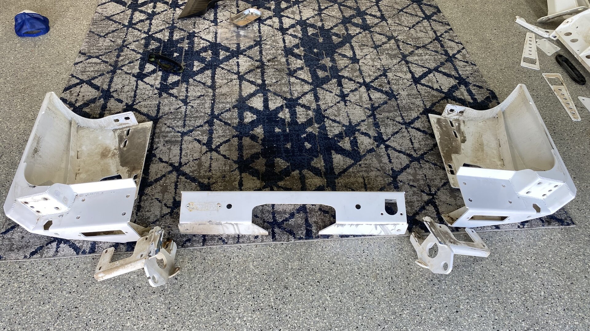

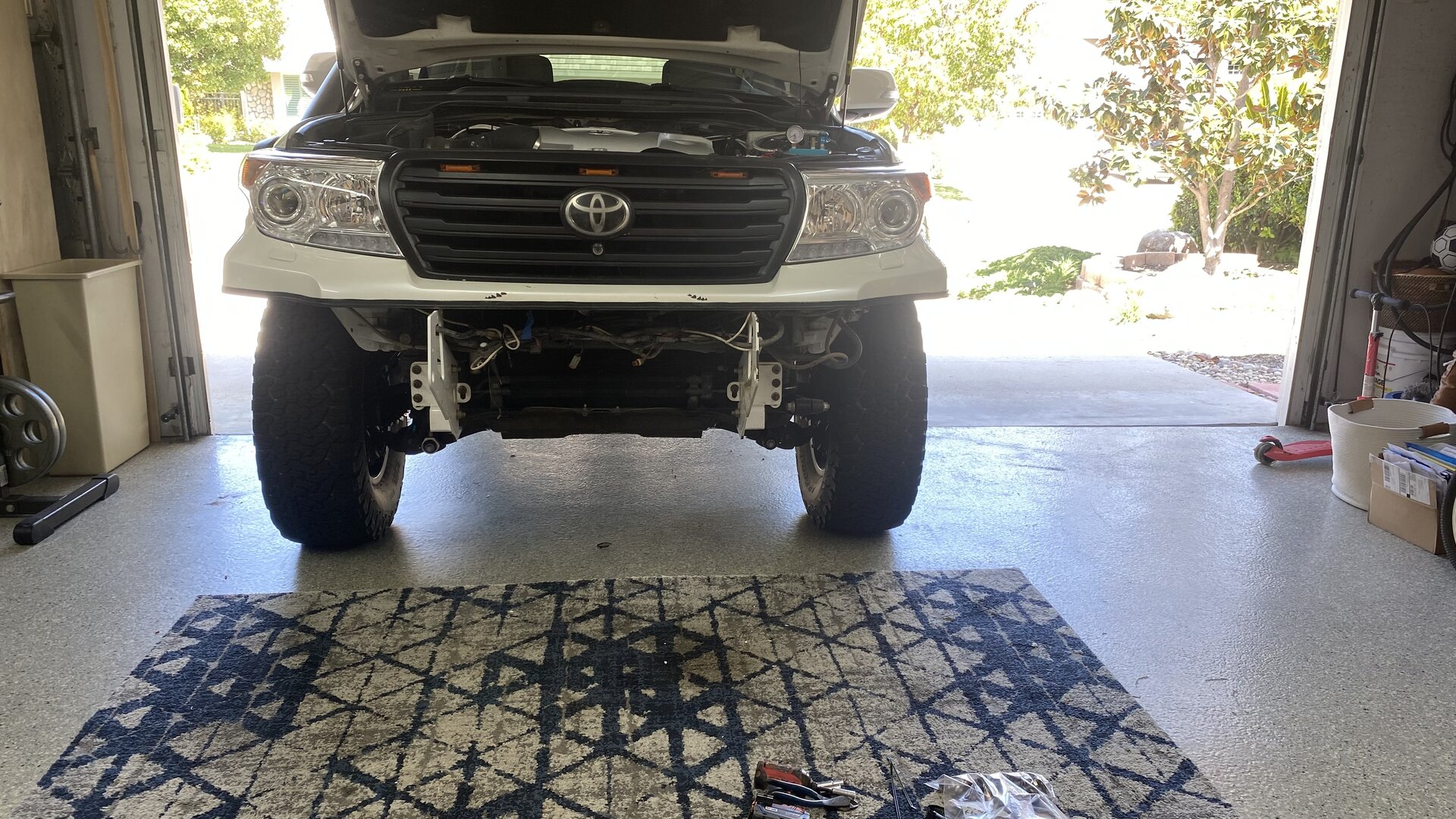

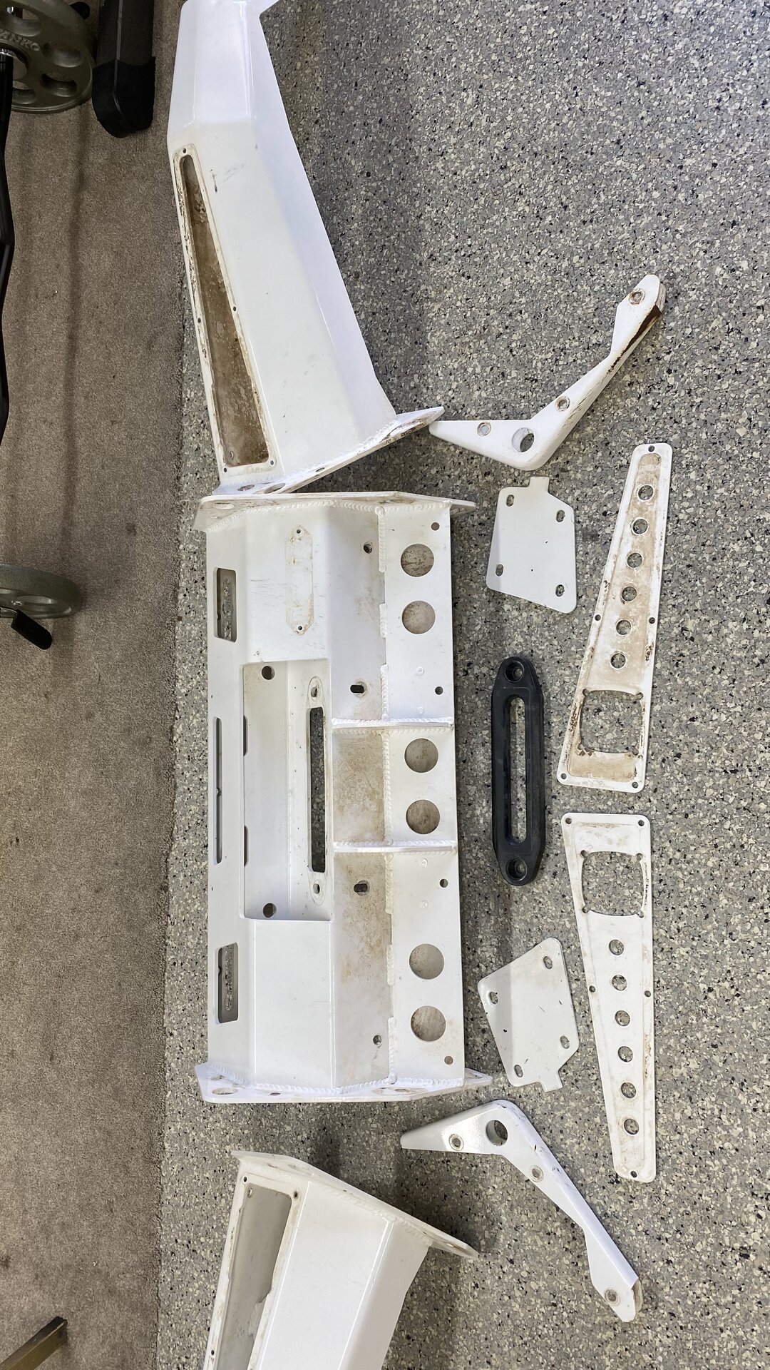

I just removed my front and rear bumpers yesterday so I can finally send them to powder coat to switch from white to black. It's been almost 2 years since I first installed. I am not excited about re-installing, but I have been talking about doing this forever! 2 years later and everything f is still in great shape! Just sooo much dirt trapped in every nook and cranny 😒. I was pretty happy to see that I wouldn't need to 💯 remove everything 😅

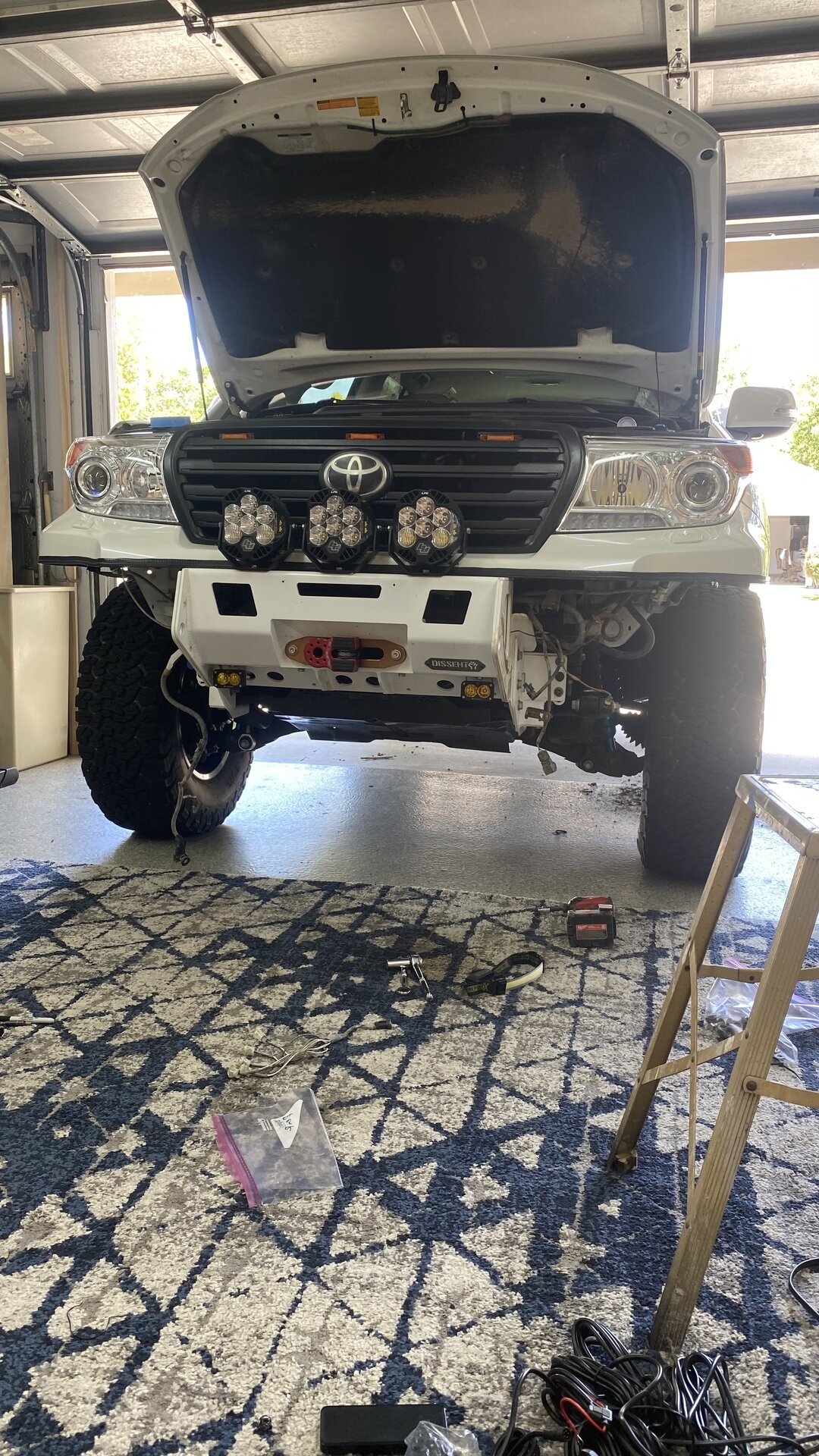

could you give a how to and details how you did the 3 lights by the grille?
