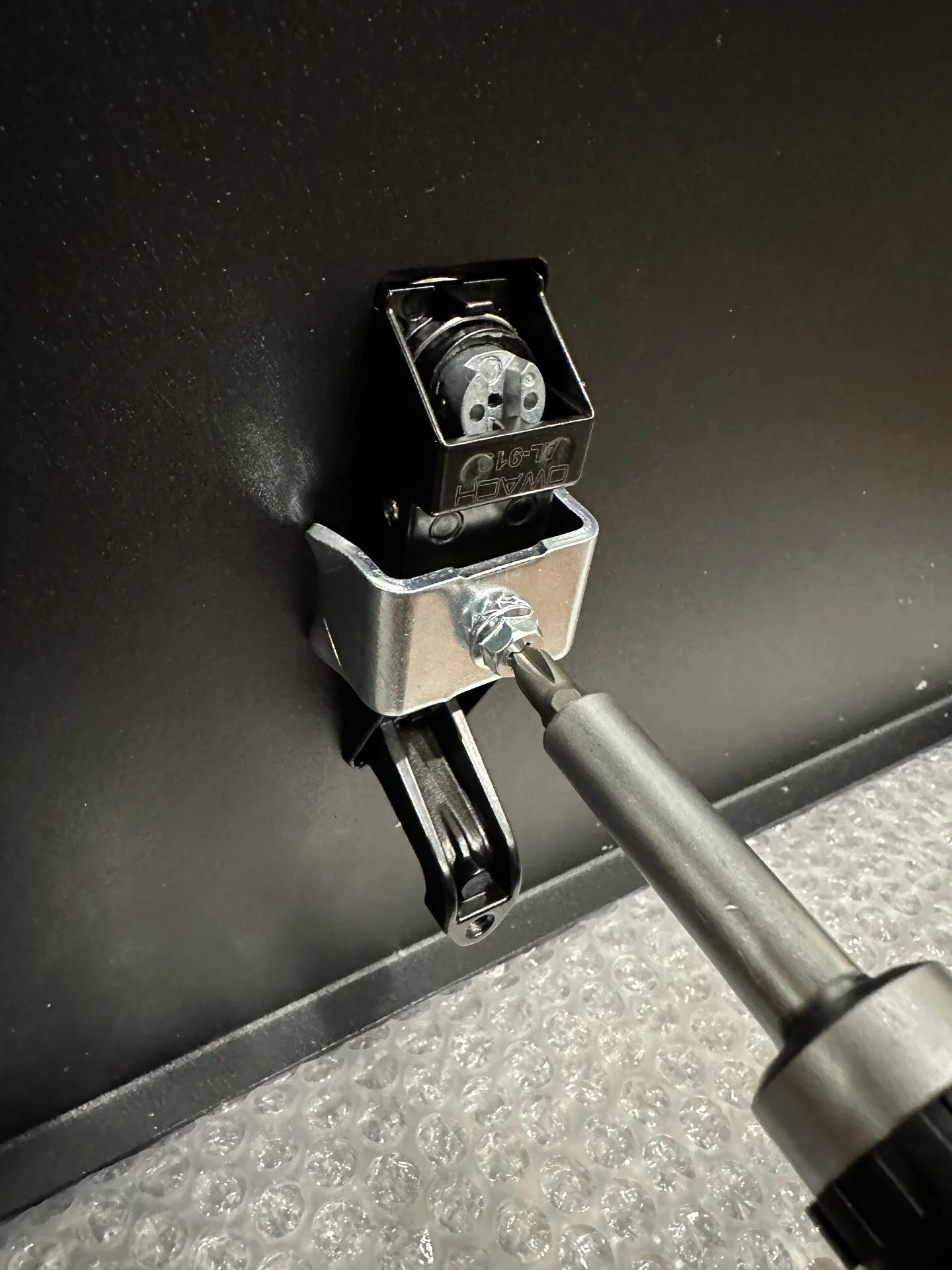

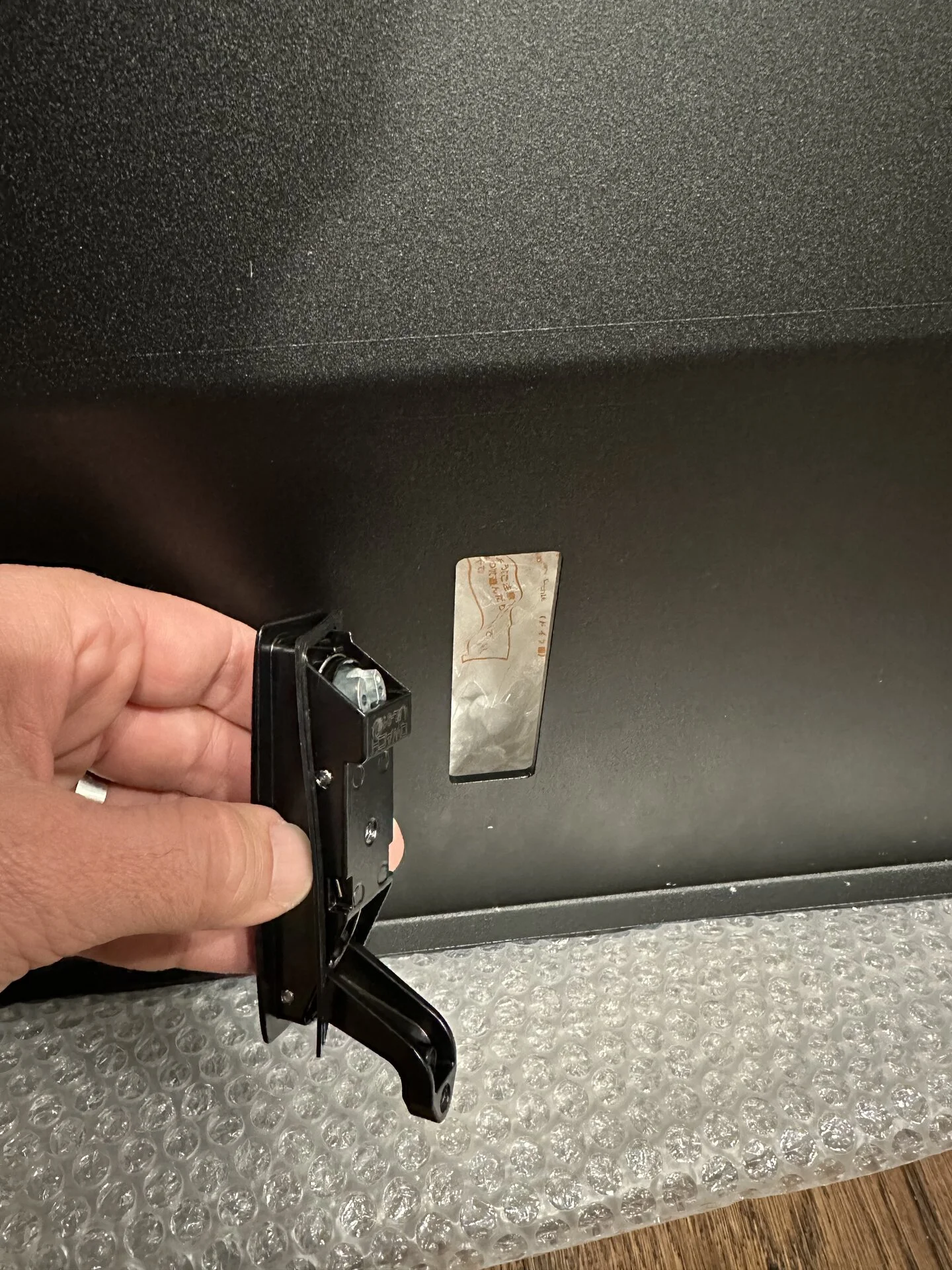

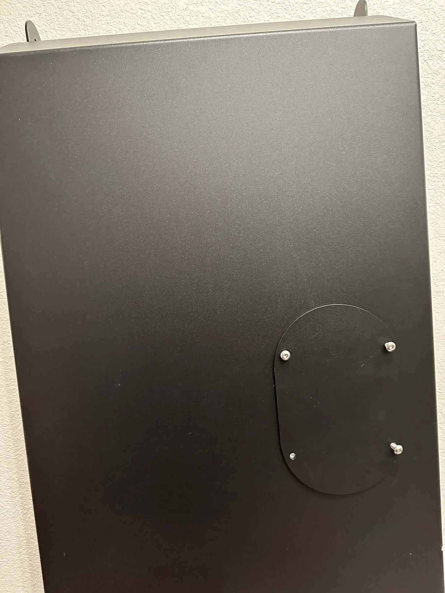

1) prepare lid by installing bulb trim, locking mechanism, and propane access door.

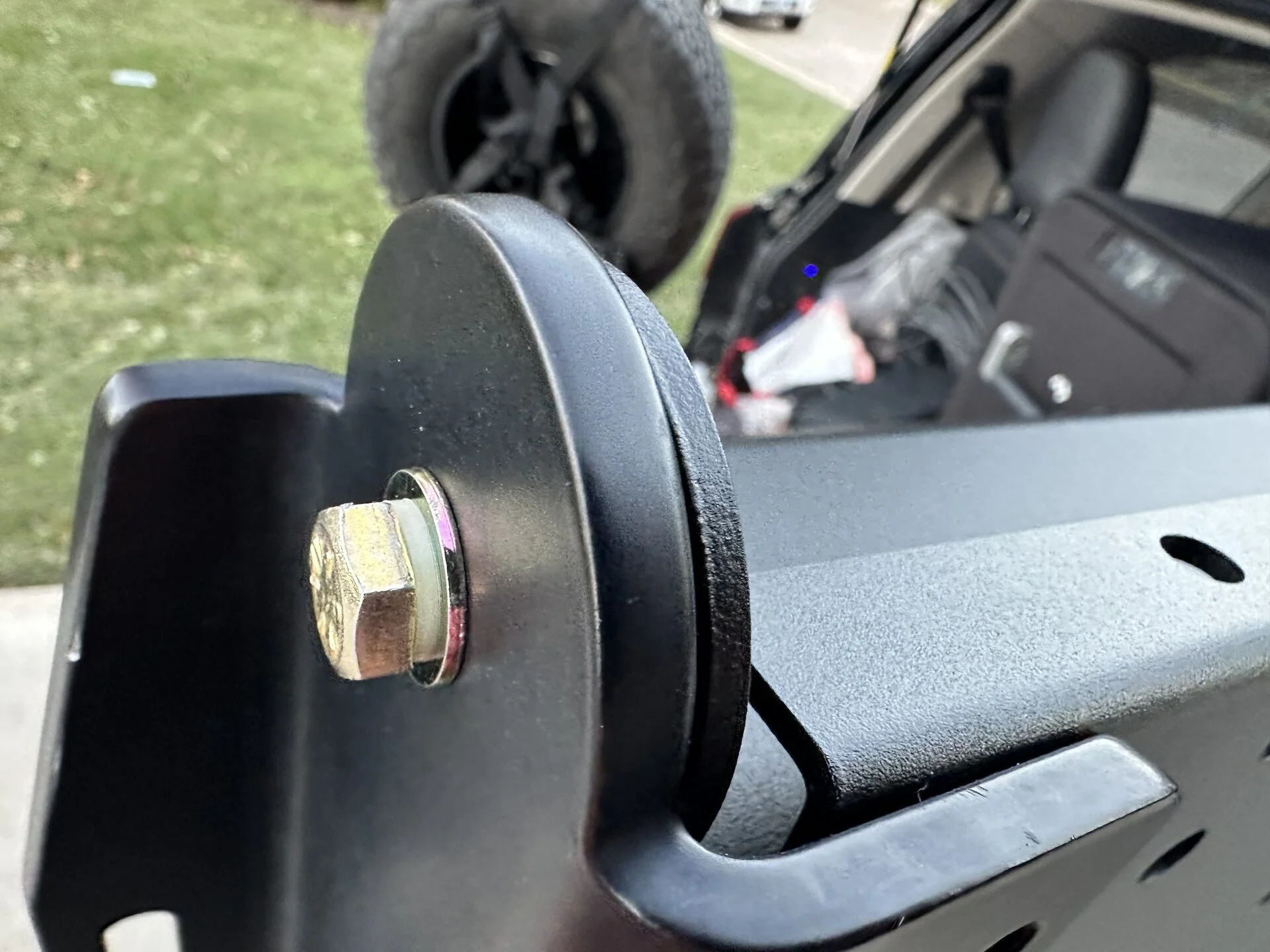

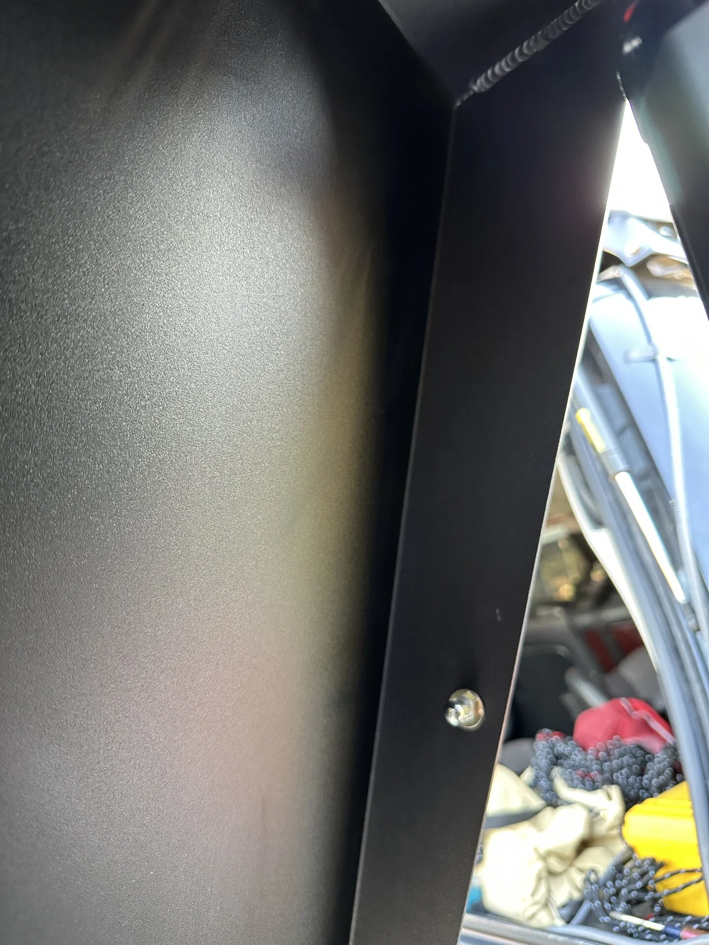

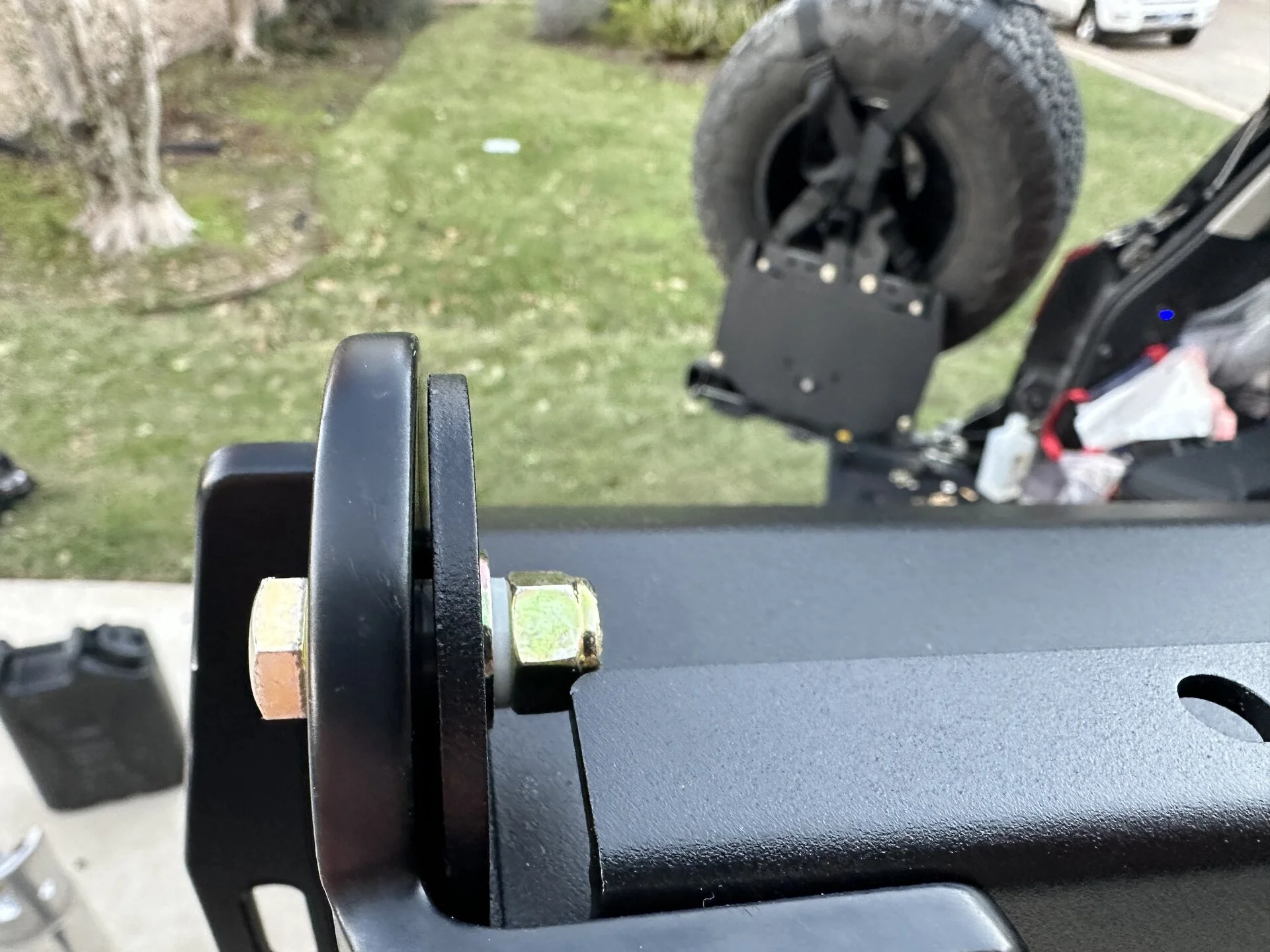

4) Install 2 bolts through the top of the lid to act as hinge points. Use a combination of washers and nylon washers in this order:
Bolt, nylon washer, metal washer, lid, nylon washer, riser, metal washer, nylon washer, nylock nut. Repeat for other side.
(Pictures below)

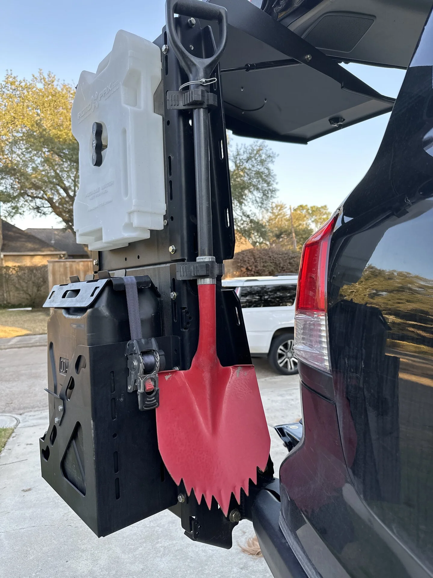

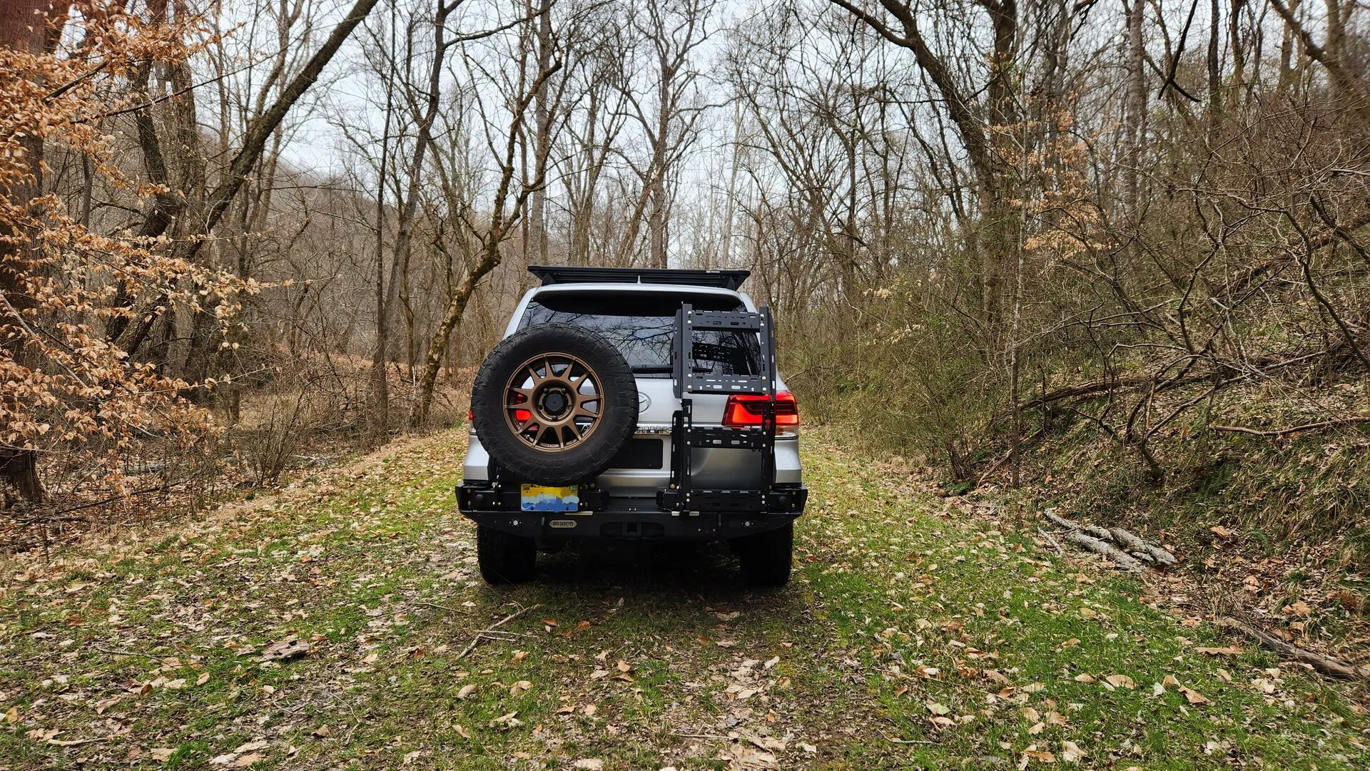

Yes. It’s a lovable cabinet you can mount stuff inside of or on the outside.
I like your setup!
Just fyi, the crazy beaver also fits perfectly on the other side of the swingarm as you have it
I like your setup!
That’s neato! We both have really good taste lol
With the shovel in the middle the shovel serves as a really good handle to help open or close the cabinet.

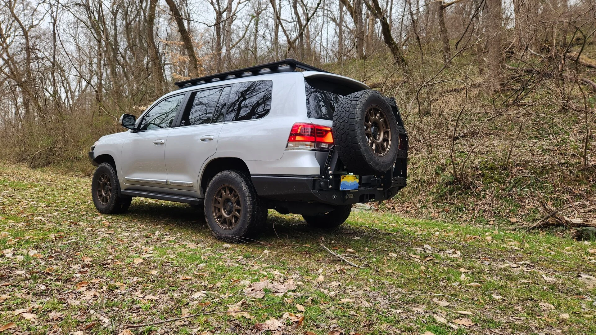

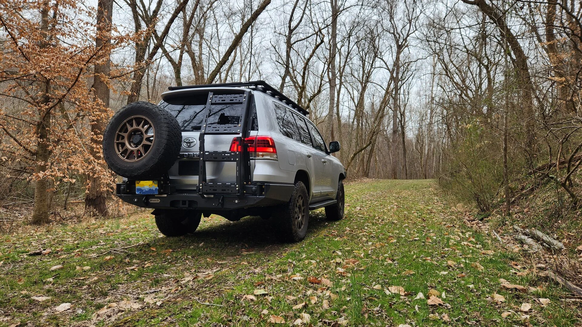

Many thanks to @radman and all else who've shared and posted their tips on putting the rear bumper together. Your help made my install much easier. I ended up going with the new ladder swing arm.
So fresh and so clean!

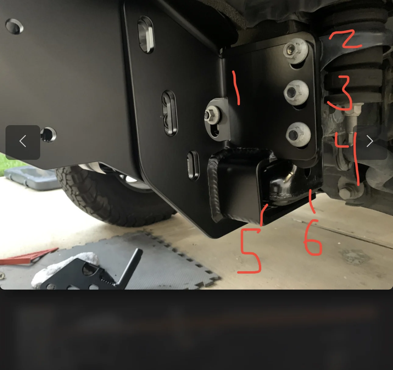

Yep, it has to come off.
However, if you get some help, you can remove the whole thing as one piece by removing the 2 tow point bolts, and 4 flange nuts on each side.
12 items in total.
I would put a jack(s) in the middle section and have 2 people hold up each wing while you undo everything.
