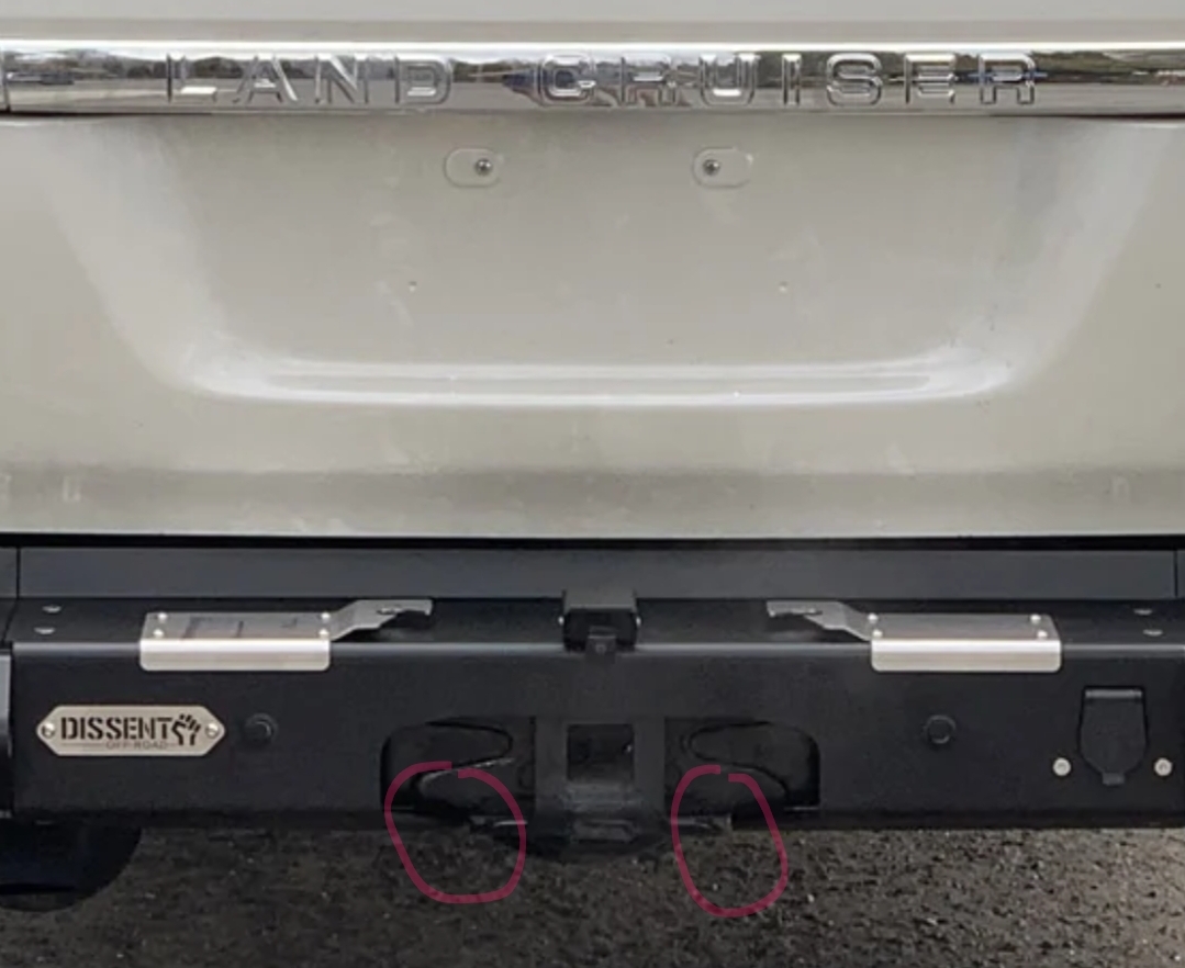

Why? Are people seeing widespread issues?It sounds like Dissent needs to find a different supplier for lights.
I did seal the wire entry point on mine with clear rtv prior to install, and haven't had any issues.

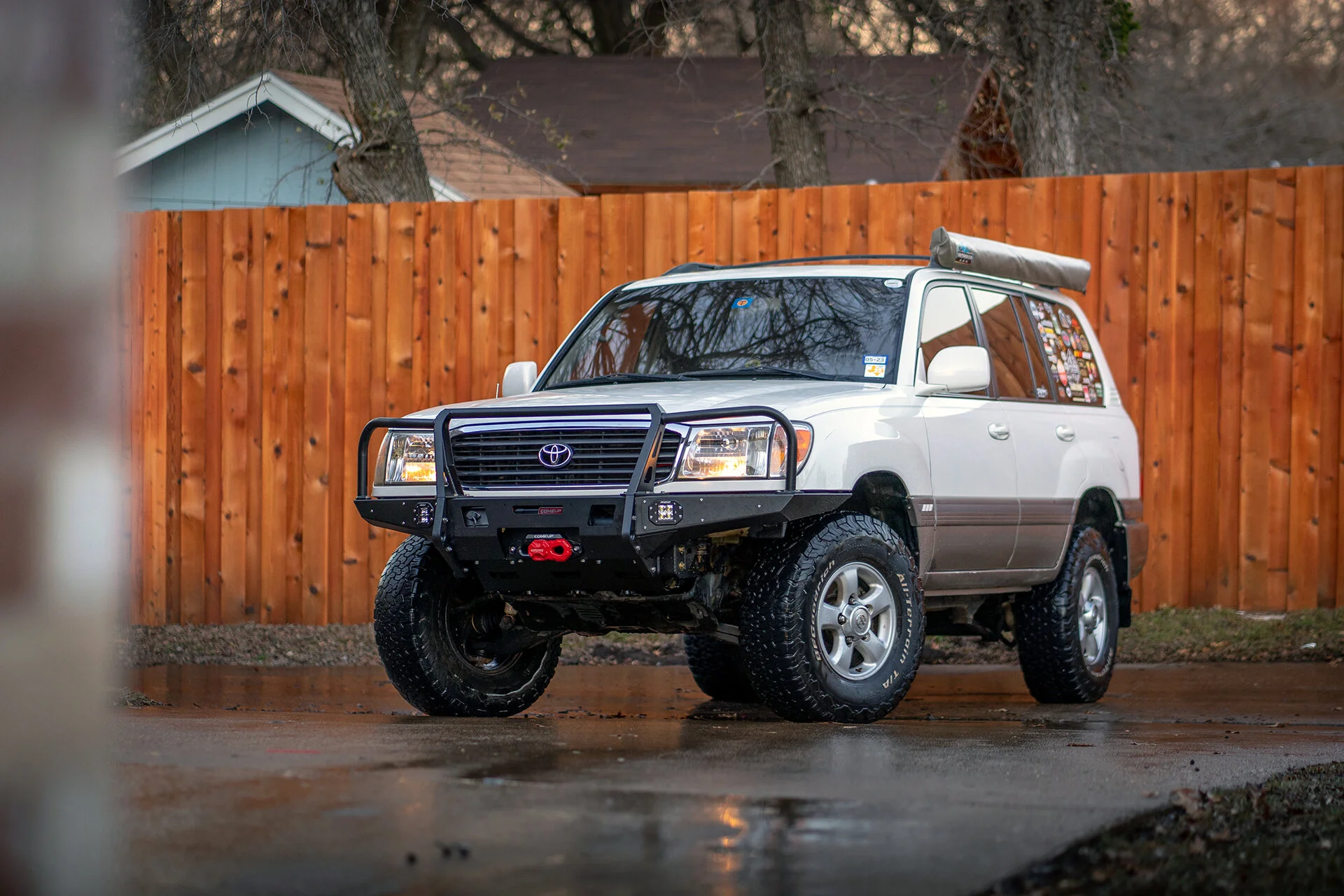

Wierd, makes your 200 look oddly like a 100 series.
My bad is this a 200 thread. I’m kinda new to mud still trying to figure out how it works.Wierd, makes your 200 look oddly like a 100 series.![]()

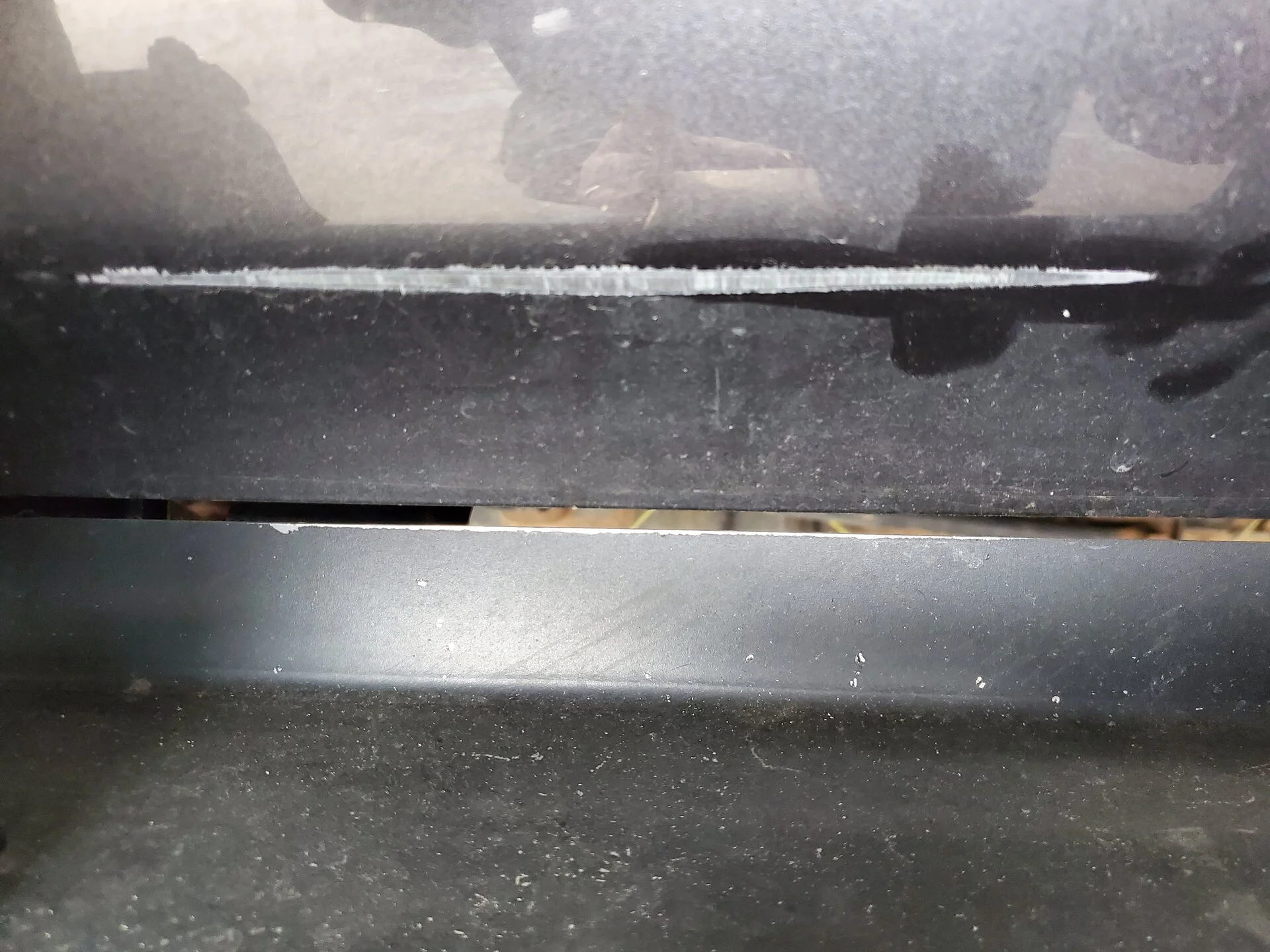

Is this caused from the tailgate open or what?
Bummer indeed. This has been reported by other users and seems to be related to the bumper not sitting flush with the hitch receiver (as far forward as possible) or weakend/stretched rubber tailgate retention straps.
forum.ih8mud.com
Thanks.... missed this issue.Bummer indeed. This has been reported by other users and seems to be related to the bumper not sitting flush with the hitch receiver (as far forward as possible) or weakend/stretched or the rubber tailgate retention straps.
Dissent rear bumper lower tailgate contact?
Have others with a dissent resr bumper noticed any contact with the lower tailgate? I saw a line in the road dust, so I cleaned it up and put a strip of blue painters tape to see if I could replicate it. I've been in and out a lot, installing a fridge slide, so probably more use than would be...forum.ih8mud.com

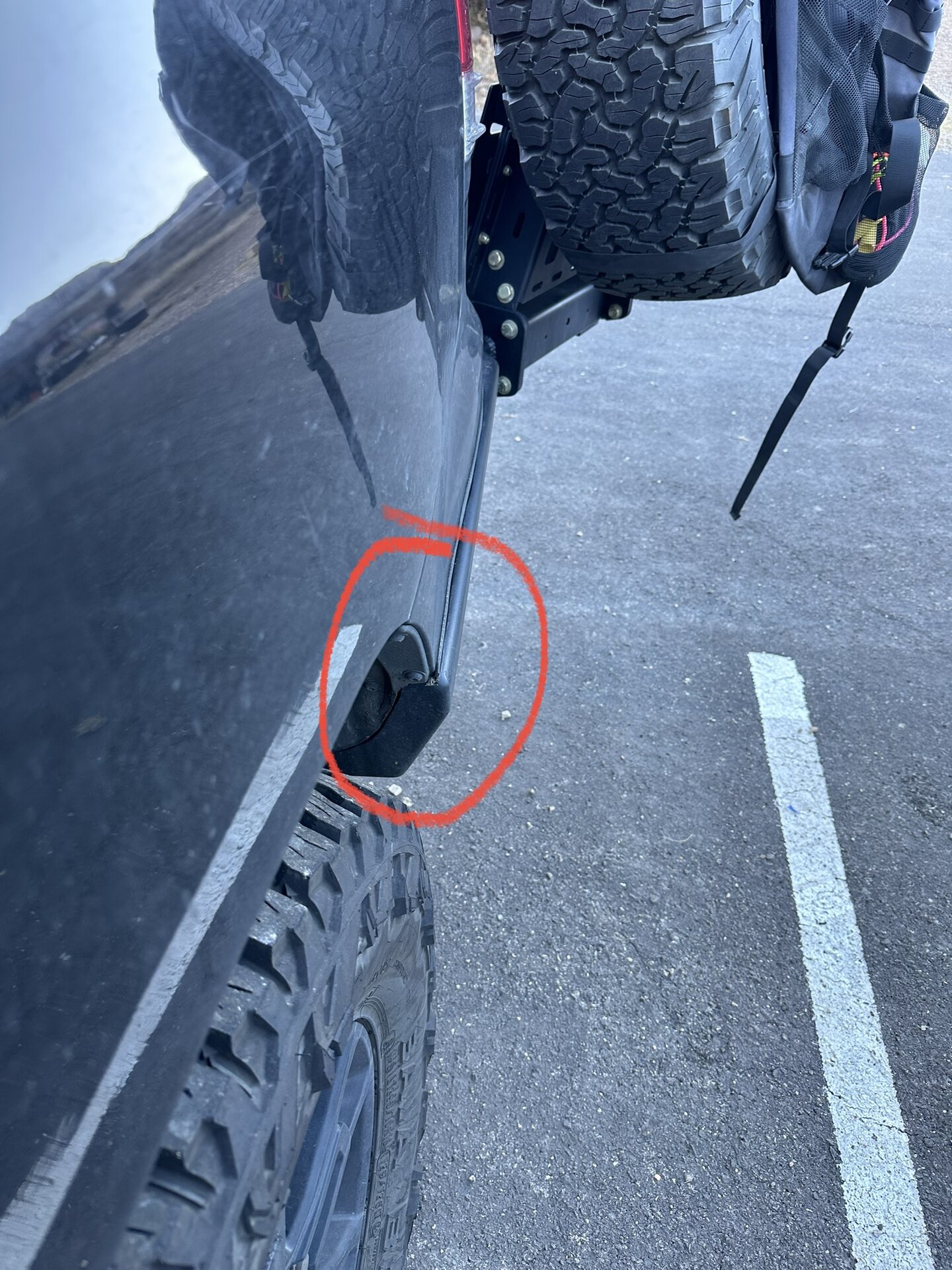

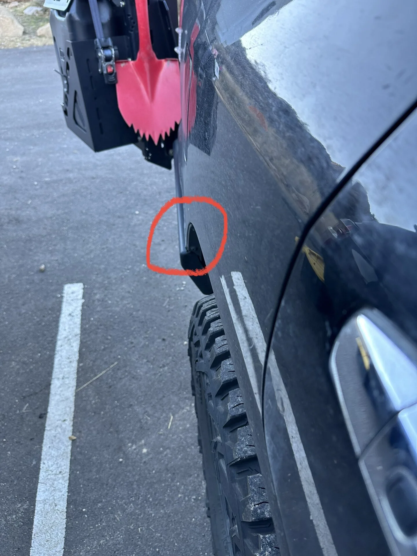

I don’t recall having issues there, but I’m also not surprised. There seems to be variances with the frame to body relationship.Did any of you run into interference between the rear passenger wing and the rear frame corner (red circle)? I am in the middle of my install and have to cheat the bumper a few mm off the centerline toward the passenger side to get a tiny gap. This also allows the lower part of the passenger wing to stay flush with the frame supports and not flare out to the rear (red arrow).
I was eyeballing the center of the hitch receiver and comparing to the middle of the camera relocation mount. I was also looking at the symmetry of the lower gaps (pictured).I don’t recall having issues there, but I’m also not surprised. There seems to be variances with the frame to body relationship.

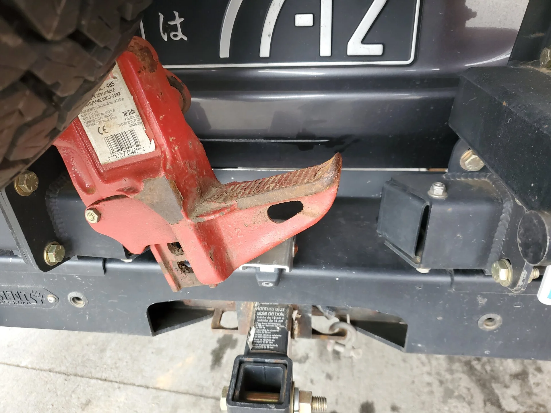

Yep, mine hits the lower tailgate too. Dissent told me to make sure it is pushed tight against the crossmember. Piss poor solution if you ask me. They should modify the top part of the center section by a couple of mm so it won't hit (and send owners that have this issue a replacement).
