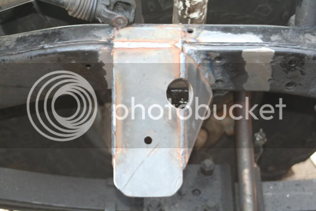

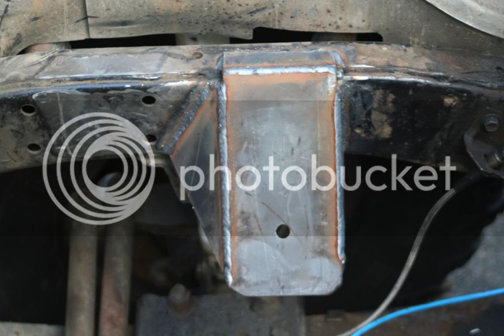

Anyways I have been staring at this truck for the last few days and after my last days work and post I have had a couple of things bugging me. The first was the clocking on the stock tranny. I know that the Isuzu was dead flat front to back and side to side. The 2F with 3F bell housing made the tranny and subsequintly the engine clock about 6 degrees to the passenger side. I spent the better part of 3 hours yesterday trying different options to get this flat but was not happy with any of them. I decided to sleep on it and re-address the issue today.

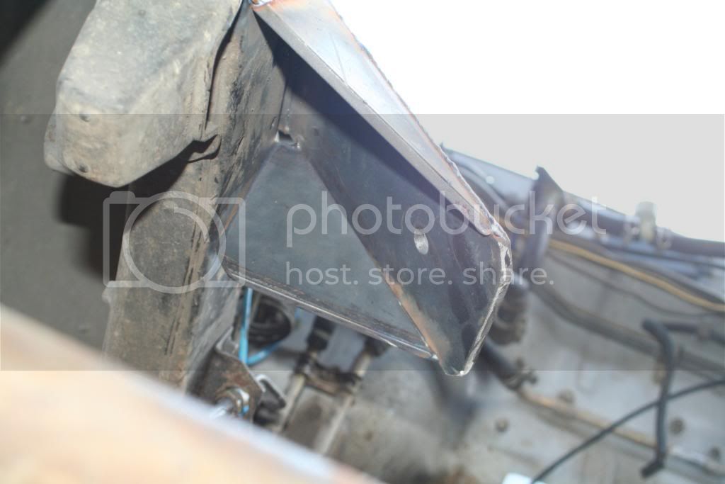

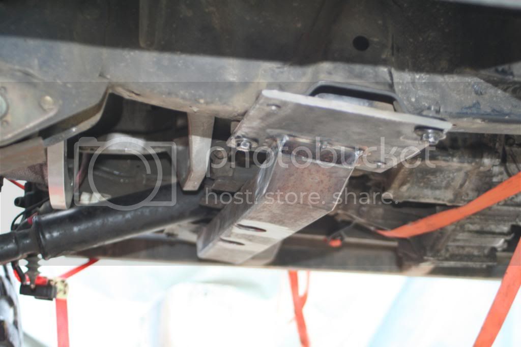

I bounced some ideas off of Mike when he got here and within a few minutes we were busy fabbing. Decided that it was now or never and went to work on a new tranny cross member. This allowed a couple of things. First is that we were able to get the tranny and engine flat side to side. Next wes that I was able to suck the trans and transfer case up closer to the body. Last was a beefier design to eventually build an actual skid off of.
Pretty basic design but it still takes time to do!
I will need to clearance for the front driveline and cap the ends. But, I am very happy with the results.

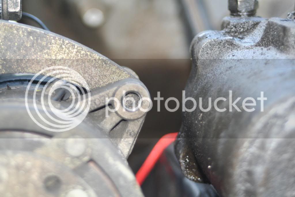

With setting everything flat it afforded some more room around the starter to frame and A/C to steering interference.

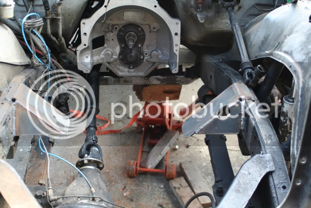

This guy gets more done on Cruisers than a full blown dedicated fab shop. Mike was eager to get started on the engine mounts. I bounced some ideas of of him and we had a plan. I was hopeful we would get some done today but what we ended up with was beyond what I had imagined! I am soo pleased with these and mad props to Mike for burning them in for me! :grinpimp::steer:
Good shot showing the trans centered in the bay now.
passenger side:
drivers side:

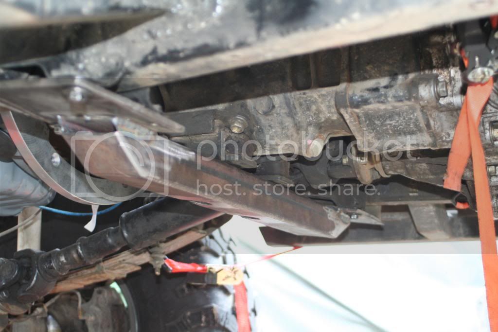

under shot:
And one more shot of the cross member:

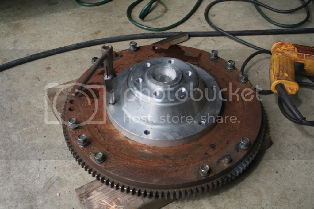

Started with the drill and tap on the Isuzu Flywheel to mount the adapter:
The new adapter is self centering so drill and tap is no big deal. It comes with the hardware you supply the drill and tap:

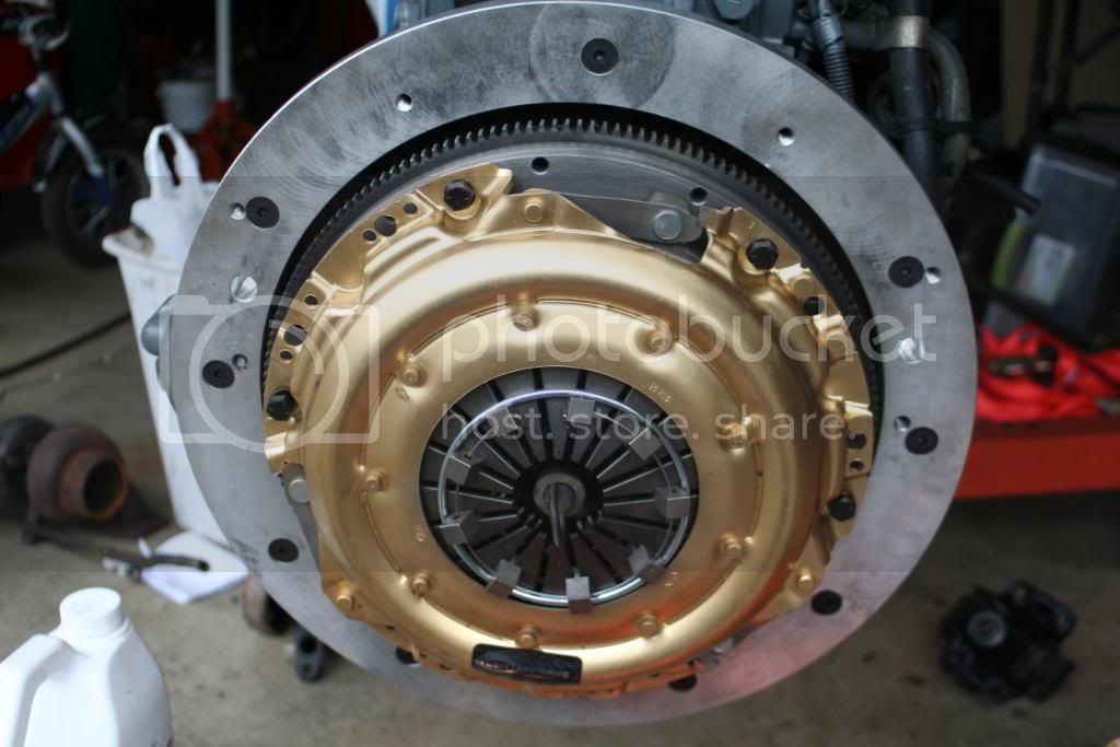

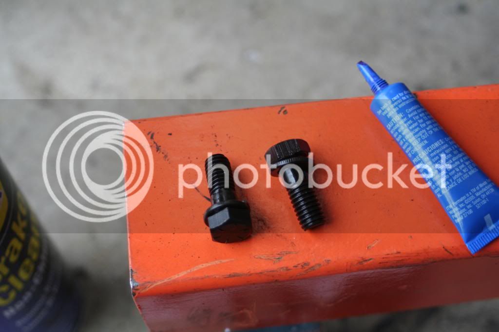

After that I got out the thread lock and went to town on all the adapter bolts both on flywheel and on bag of engine. Started to mount the kick arse Centerforce clutch and found that I didn't have the right hardware for it. Make sure you get the right ones as standard bolts aren't shouldered to align the plate:
Mr Gasket part #910
This killed almost an hour having to run into the next town just to find these bolts. No big deal and all was looking good. Then I found that I didn't have the right length bolts for the AA to Isuzu adapter and had to run back to ACE. I picked up the right bolts and back at it again. Got the clutch aligned and throw out bearing ready to go. Popped in the bronze pilot bushing and oh crap. Standstill....

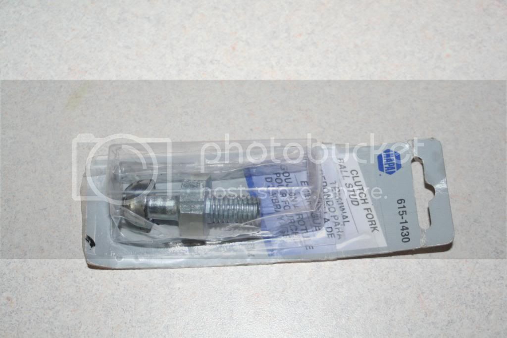

I went to put on the clutch fork and like a total duma$$ I forgot to get the clutch arm pivot ball out of the old housing!!! Man what a bummer. I called about 3 people in the area and no luck. Then I remembered back in the day that NAPA had blister packs of odds and ends and the pivot ball was also used on Chevy trucks in the mid 80's! Bonus! Off to the store only to find that they are out of "stock" Oh wait we have not sold one of those in like 7 years....
I went ahead and ordered it but it wasn't in till the 430 pm truck. By then I was needed at the field to coach T-Ball for my 5 year old and game done. I puttered around the engine for a bit and put some sound deadning in the drivers/ passenger side floor and called it quits.
In case your wondering here is the part. Dorman part # 615-1430. You will need a 27/64th drill and 12mm 1.75 pitch tap to install.

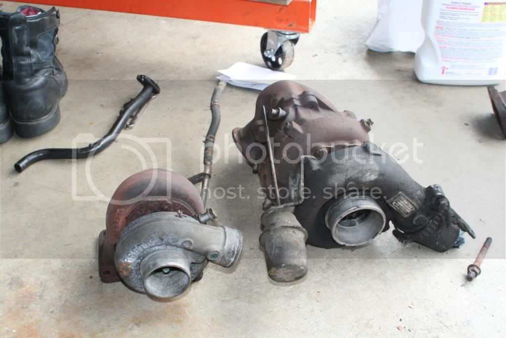

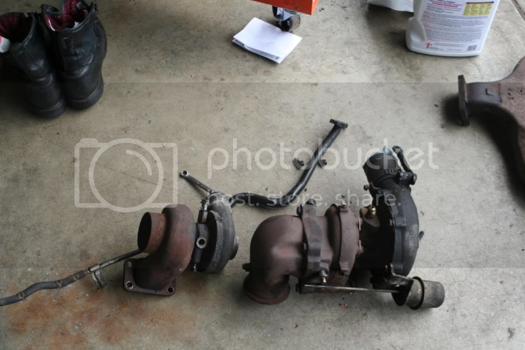

On a good note I did find the turbo I am going to run. Its an IHI RBC6 by Borg Warner. It originally came on the GM 6.5 diesels but was also run by 8.1 liter Hinos and a few 5.2 liter Isuzu's. I don't have the inducer/ exducer ratings but its a .70 A/R turbo good for about 350hp and 18 psi. Here is size comparison to stock:

Talk about a turbo!
That thing is huge.
Can't wait to see this finished.
Actually the stock one is really tiny so it's a perspective thing.
Clint that turbo looks like a much better size than the stock one, it'll be fun to play with it and it should give you growing room. I drove Chad's truck this week doing some research for tranny shifting and now I have boost envy. That thing is a monster! Makes me want to put my turbo swap higher on the priority list but really I need to focus on my axle first.
Soon enough sweet diesel particulate will be filling you nose and oddly enough, you'll feel more earthy.
Yeah I am hoping this thing works out. In my research there are some options of swapping the inducer to have it spool faster. I know there have been a few reports saying the turbo chokes out at 2500 rpm but that's on 8cyl. I think I will be fine with the 4 banger.

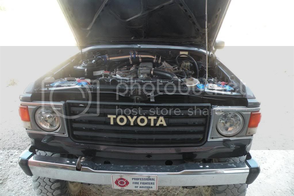

Here are a couple of photos of the air cleaner that you sold me. It worked great and the Isuzu is breathing nicely!
I love your motor mounts! Those came out sweet. I did mine out of 4" box but I wish I built them like yours. Nice!
Your going to need an AC amp from an HJ61 or FJ62 to make the AC work like factory, so keep your eyes open for one.
Also, I would go with the electric fan setup, so much easier to do and you can install a relay that turns it on when the AC comes on so your condenser will always be working efficiently.
