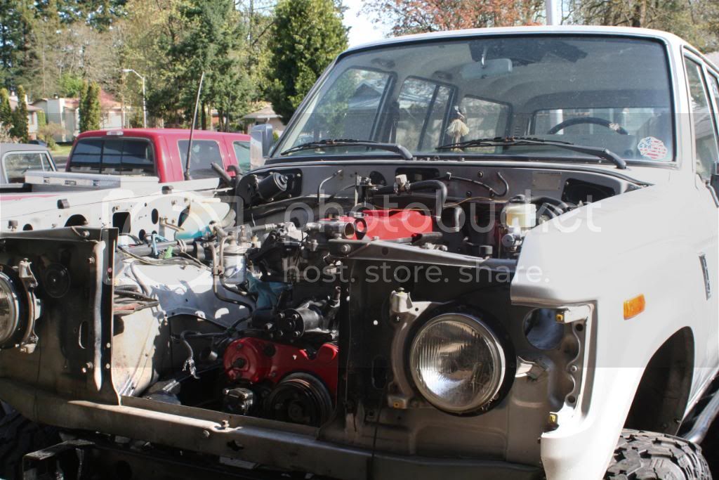

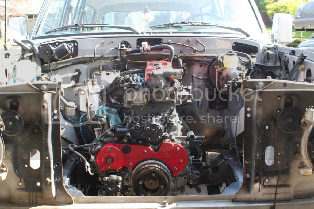

4bd1 came home today. Its in the final resting spot. Bolted up and awiting anxiously for go juice.
A few small details to work out with the clutch system but all in all a pretty tidy fit if I do say so myself. More updates on tuesday of next week. I am taking a few days off to go ride some singletrack.

Wow, you got tons of hood clearance. This will be nice with the weight down low.

Sheez... you have enough room in there for two of Em! Makes the 6BT look like a Fat Cow.....

That looks great! Your's is over to the left a little more than mine and that will be much better for your AC compressor clearance. You probably already know that and planned it that way didn't ya.

Yeah I am thinking it will be easier to route the intercooler/ intake stuff right over the top and not behind the head and firewall. Plus the low center of gravity thing will be advantagous for sure.

Yeah Don we worked through some fittment issues and I was happy that we set the engine and tranny flat instead of clocked. This allowed me to center everything and clear the A/C compressor and hopefully give me some more room for the bigger turbo. I picked up some T3 flanges and hope to do some mock up next week for placement.

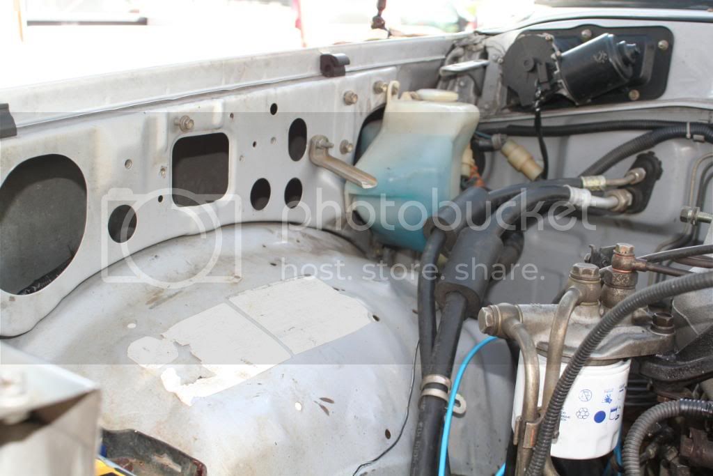

I pulled and drained the fuel tank and then ran new soft lines. I also pulled all the emissions crap as well as the not needed hard emission lines on the frame rail. No pics of this its boring stuff.

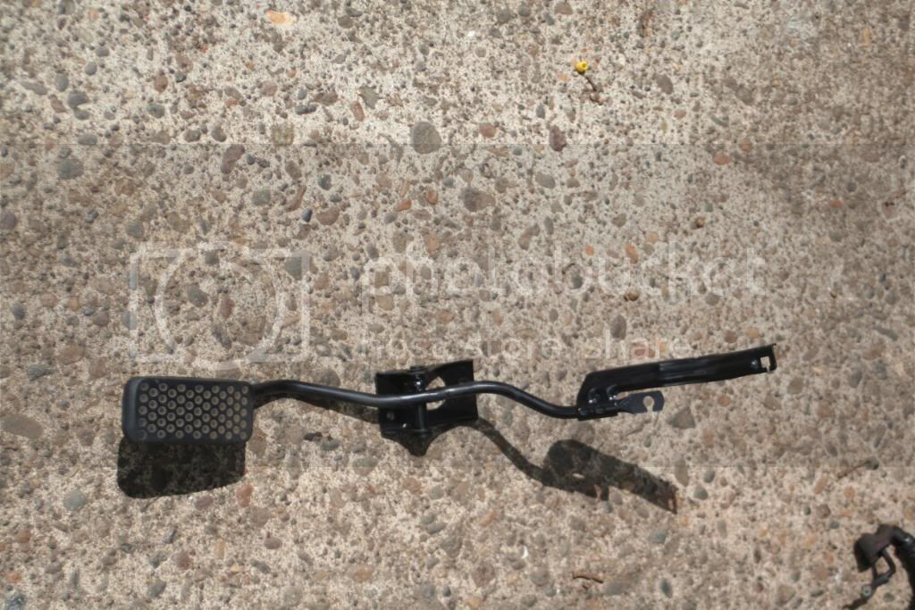

I turned my focus to the Diesel pedal and getting that going. I asked for in the WTB section for an FJ62 pedal and throttle cable. I paid a guy on here $60 for it and it showed up with no throttle cable. I was able to source on local for $50 but again time wasted. When I went to fab it all up nothing fit of course. The pedal was was from something else. I said forget it and busted out the die grinder and welder and went to town. This is what I ended up with:
$110 Diesel pedal cut up from what I got in the box and my old one! Not too bad but wasted time and money as I could have built the same from a junkyard for $10.

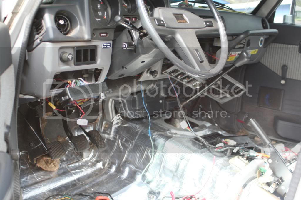

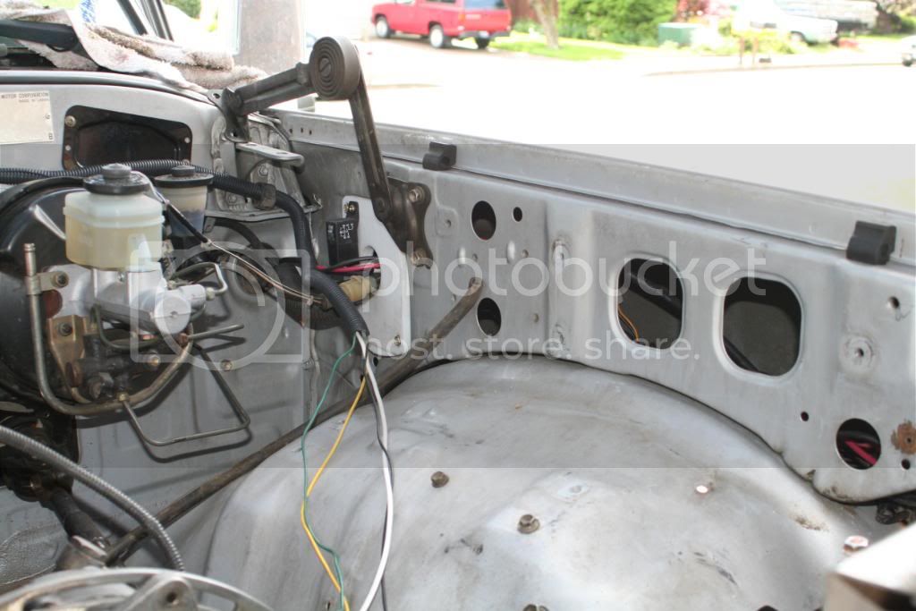

Next I jumped on pulling the dash and isolating the ignition system wires. I started to wire up the starter relay and glow relay but got sidetracked a bit. I hated my old set up with the ARB, dual batteries and all the extra uneeded wires on the fenders. It just looks cluttered. With all the spagetti mess gone I spent the better part of today isolating the gasser stuff I didn't need and plumbing everything over to the drivers side.
Look ma, no wires:

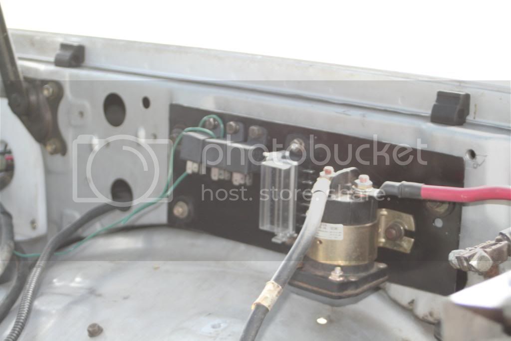

I pulled the carb fan and plastic intake and took an old cutting board to fill the hole and have a place to route wires. I also pulled the headlight squirter system and replaced it with an electrics panel. This will have my relays for starting, glow, dual battery and aux lighting. This is my start for now. I may change or add at a later date.

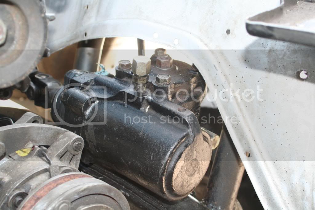

Prior to pulling the dash I did some initial sound deadening and put on my ported steering box (thanks manuchao!) for future hydro assist.

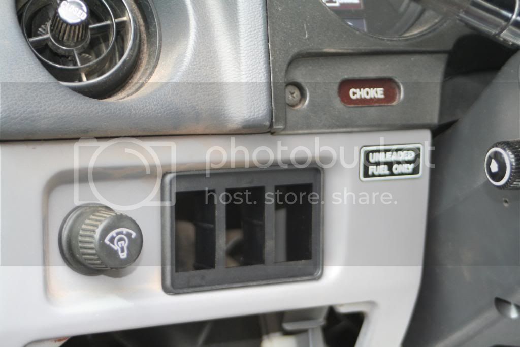

Heres my dash on left side of steering column. This is where my dual battery switch, inverter switch and bastard glow switch will go.

I had to laugh when I saw your fuse box hanging out. You have the same headlight buzzer I have. ;) God bless the "Best mods under $50" thread!
I like your 3 switch box on the left of the column. Is that a one piece or the 3 piece carling style? Where did you get that if you don't mind tellin'?

As far as the 3 panel switch it is a carling panel. The name was cast into the plastic. However I have yet to find an actual carling part # for it. With that being said I bought it on ebay from a vender in washington state. It was way too much money as I have found that the new carling inserts are like $1 each through waytek.
I also bought an 8 panel gang from the same vender and will be installing that where my ash tray is to hold my ARB switches and others.
