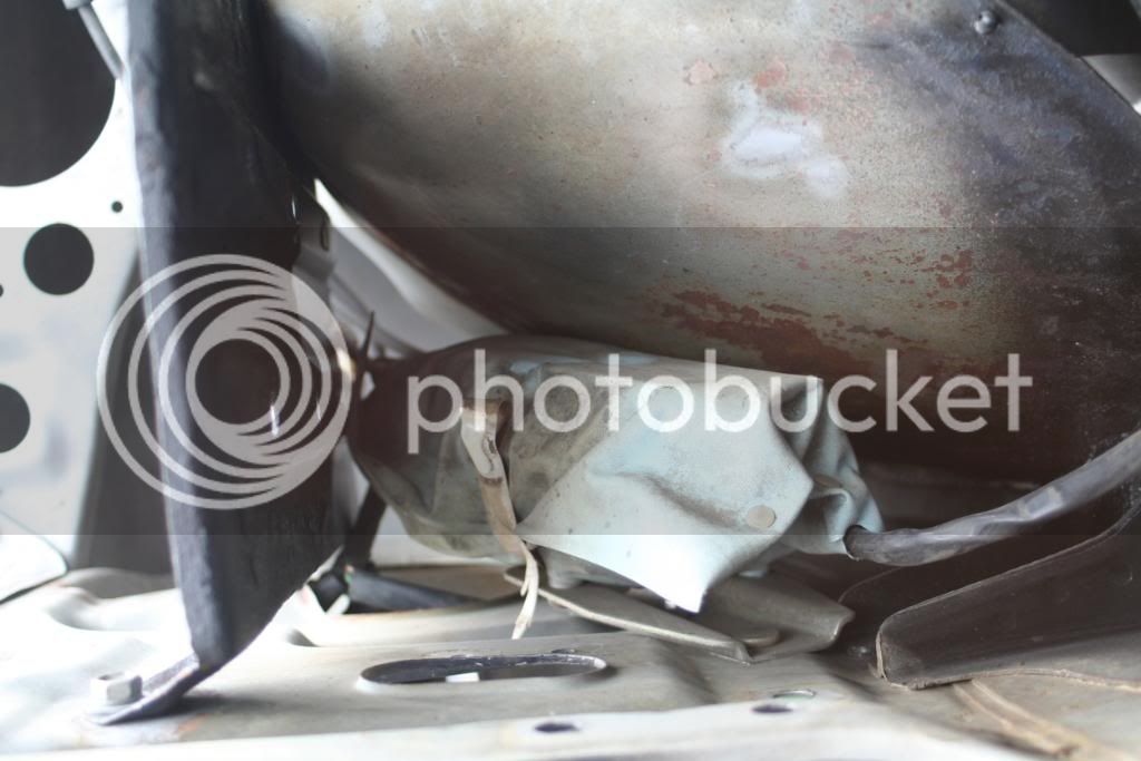

First up is the I/V bag. This is the stock Isuzu unit that is the electronic control for start/ stop. I really like the idea of being able to start and stop the truck without pulling cables manually. My wife likes the idea even more. Through some trial and error (read burnt wire harness) I was able to build a 5 pin relay that controls the unit off of the coil wire. (thank you ASTR you rock!)
This sits nicely under the passenger side battery tray.

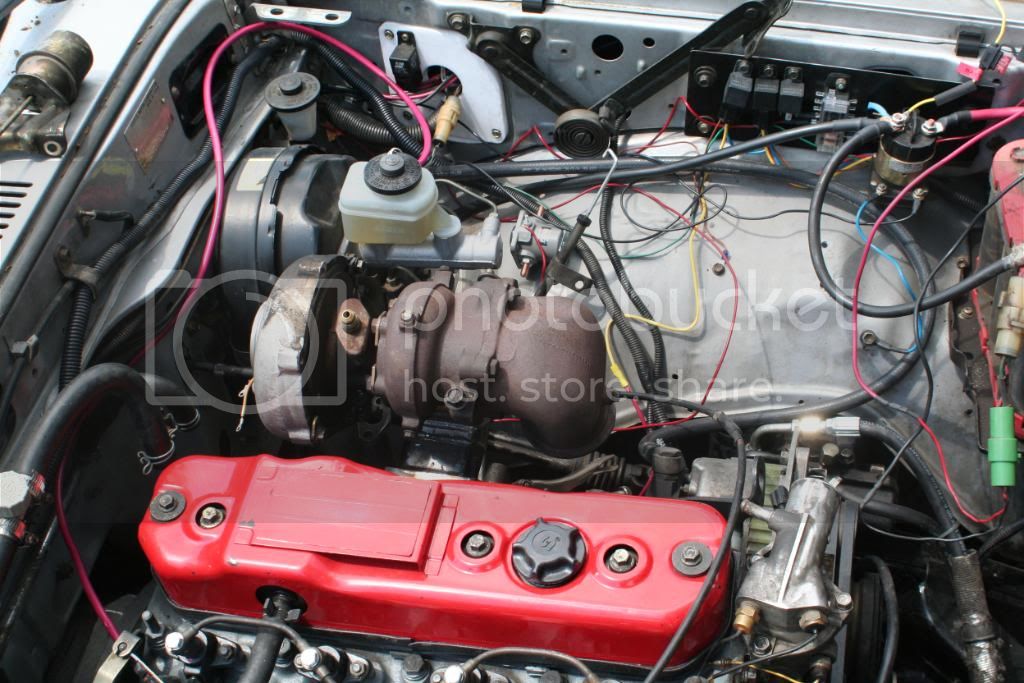

I worked through a mirad of electrical items and finally had everything wired. Dual ARB's, dual batteries, glow relay, starting system, oil pressure, charge indicator, dummy charge light, fuel cut solenoid etc etc etc... I really thought that diesel's had less wiring:
The engine bay is once again a complete mess but it's funcional with exception of the alt doesn't seem to be charging:

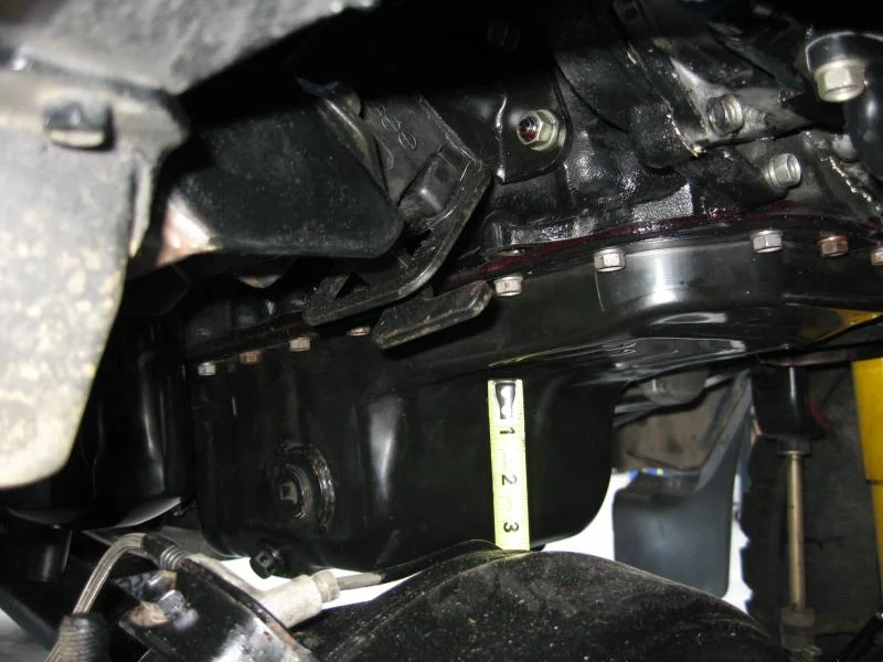

I can get a measurment for you but don't know off the top of my head. I do know it is shorter than the 4BT. I also do know that it can be done with a 4BD1 oil pan without much lift. The 4BD2 pan wont clear. Also you have to run a remote oil filter on these without SOA as the front driveline hits the oil filters.
If you want measurements let me know I can try to get some this weekend.

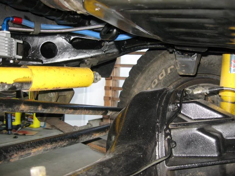

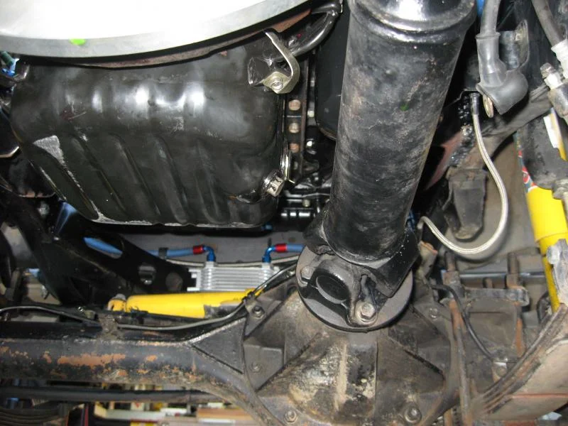

Here is a shot of my 60 with a 4BD2 and 2.5 - 3" OME. I'm loolking for the overall height, but it does work without a springover. The oil pan is stepped directly over the front diff., which helps alot.
Doug
