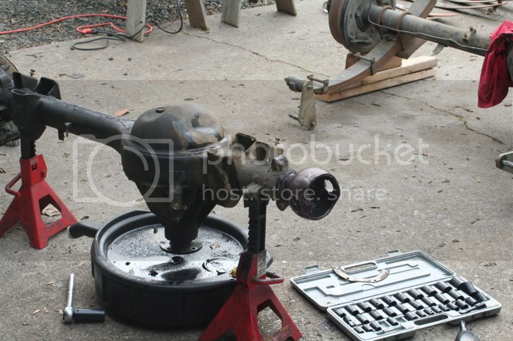

Well I started the SOA on the Silver Surfer. Didn't get as far as I wanted to this weekend but I at least got started. Both axles pulled, one diff re-geared and ARB'd, and parts laid out for tomorrow's work:

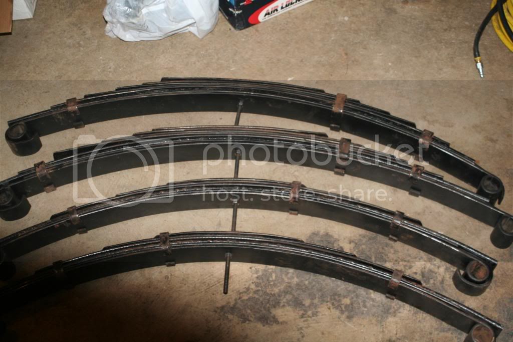

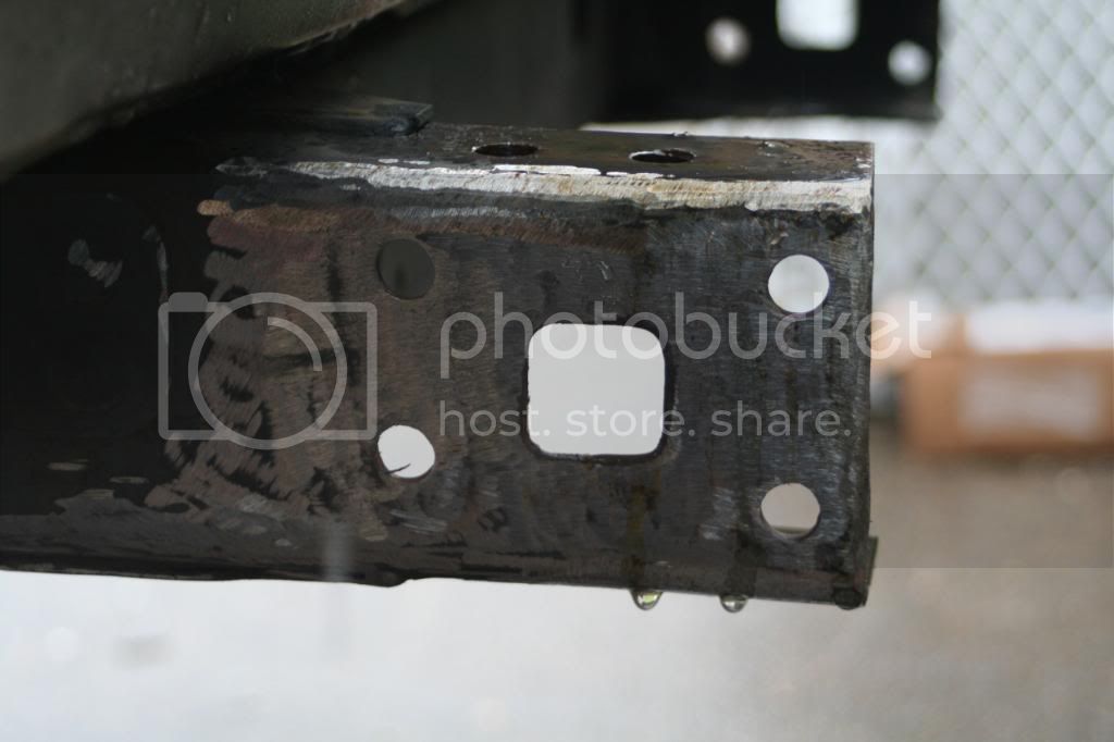

Stock spring packs and clearanced cross member ready for rebuild:
