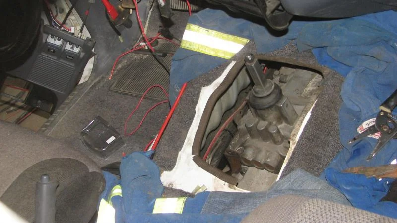

Got pics of how that NV sits in there??
Are you looking for anything specific? i.e. clearance on sides etc?
Yep.... was their any fabbing needed in the tunnel??
The only major "fabbing" of the trans hump was with a 4 lb. hammer for about 5 minutes or so, nothing major though, just smackeroo, see if the trans will fit, and then a little more fine tuning with the knockometer. The only spot I had to hit was where the trans hump met the firewall for the engine/bellhousing bolts.
I did cut out a fair bit on the trans hump to get easy access to the top engine to trans bolts:

Also interesting that you had minimal hump mods. My tcase seriously interfered on the pass side.

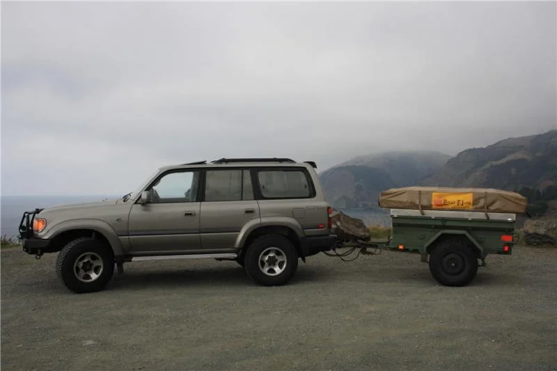

1. Year and model of the original truck.
97 FZJ80 Sage 40th edition from San Diego
2. Brief details of the Drivetrain that was swapped in.
Toyota 1HD-FT 24valve direct injected turbo diesel (Non EGR version) mated to an H151F 5spd tranny and HF1A factory part time transfer case.

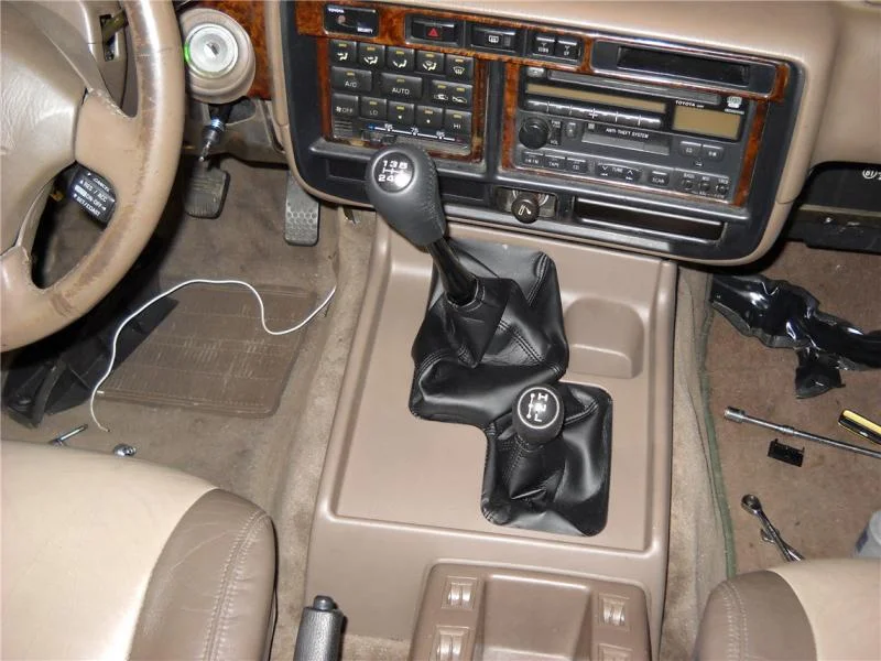

Everything, it helped that I had a complete 5spd HDJ81 to canibalize much of the 5speed specific parts from ie crossmember, tranny tunnel metal, misc brackets, etc.
Dave Stedman at Japan4x4 was able to get me all the new LHD 5spd parts I wanted to make the swap clean and factory like.

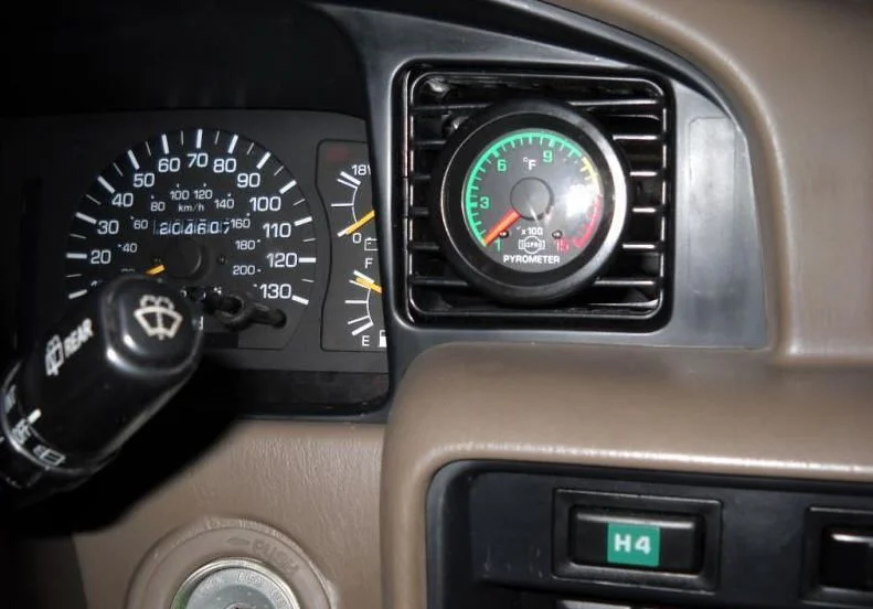

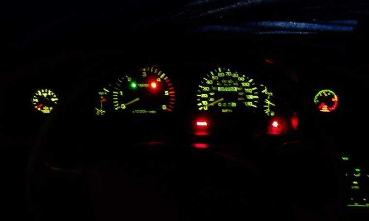

Rage Big bore 3" exhaust kit, Walbro FRB 5 fuel pusher, Emu 850/860, Slee blue bushings, 285 BFG AT KOs, dual batteries, ISSPRO pyro and boost gauges set into the vents, Hallman Pro manual boost controller (13 psi)

9. 2 to 3 pictures of your rig.
Some more pics...
