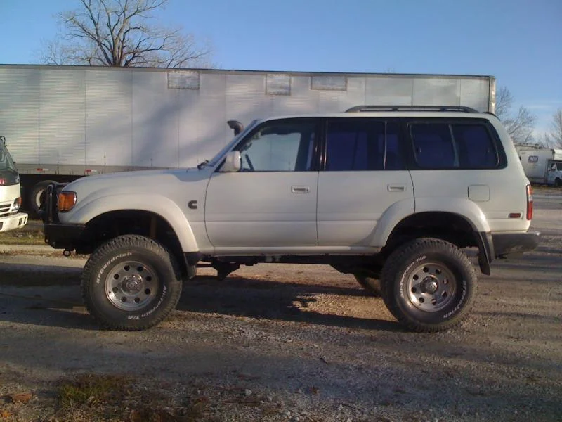

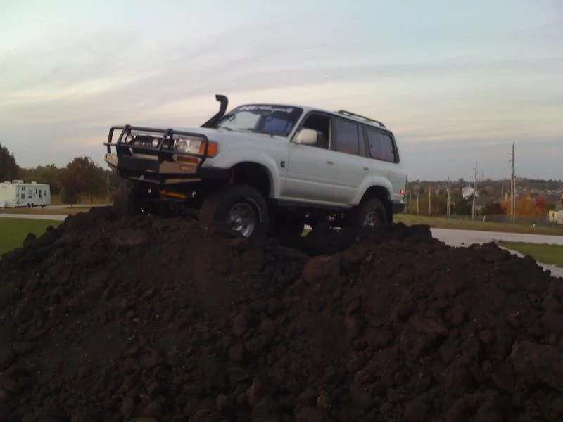

hey guys i've ran into a little issue with my 91 fj... i swapped in 12 valve cummins with a nv4500 behind it, behind that is a 19 spline split case.my problem is gear ratio... in 5th gear i'm running 2200rpm to do a little over 70mph. i cant find anyone that sells a higher gear set for my stock 91 fj80 axles. im thinking a about a 3.73 would be perfect. or i'm open to the idea of a divorced od but i'm having a difficult time figuring out which one would work the best.[/ATTACH][/ATTACH]
