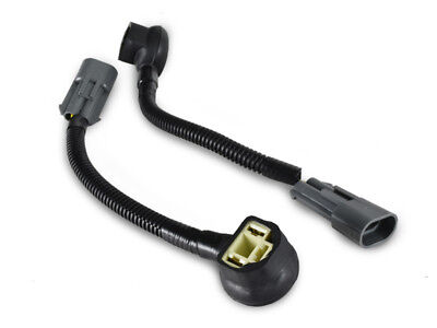

I have the depo headlight assemblies and I'm looking for the adapter plug and rubber seals that go on the back of the assemblies would you happen to have those being you have modified yours or know of a place to get them from . I have emailed one place with no response yet. I also started a thread asking about these here on mud.
Thanks
Tommy
Thanks
Tommy
Im hoping to reuse the rubber seals on the back instead of using universal caps.
I got these adapters before I decided to do the retrofit so I returned them. Verify but I think they’re the correct adapters.
