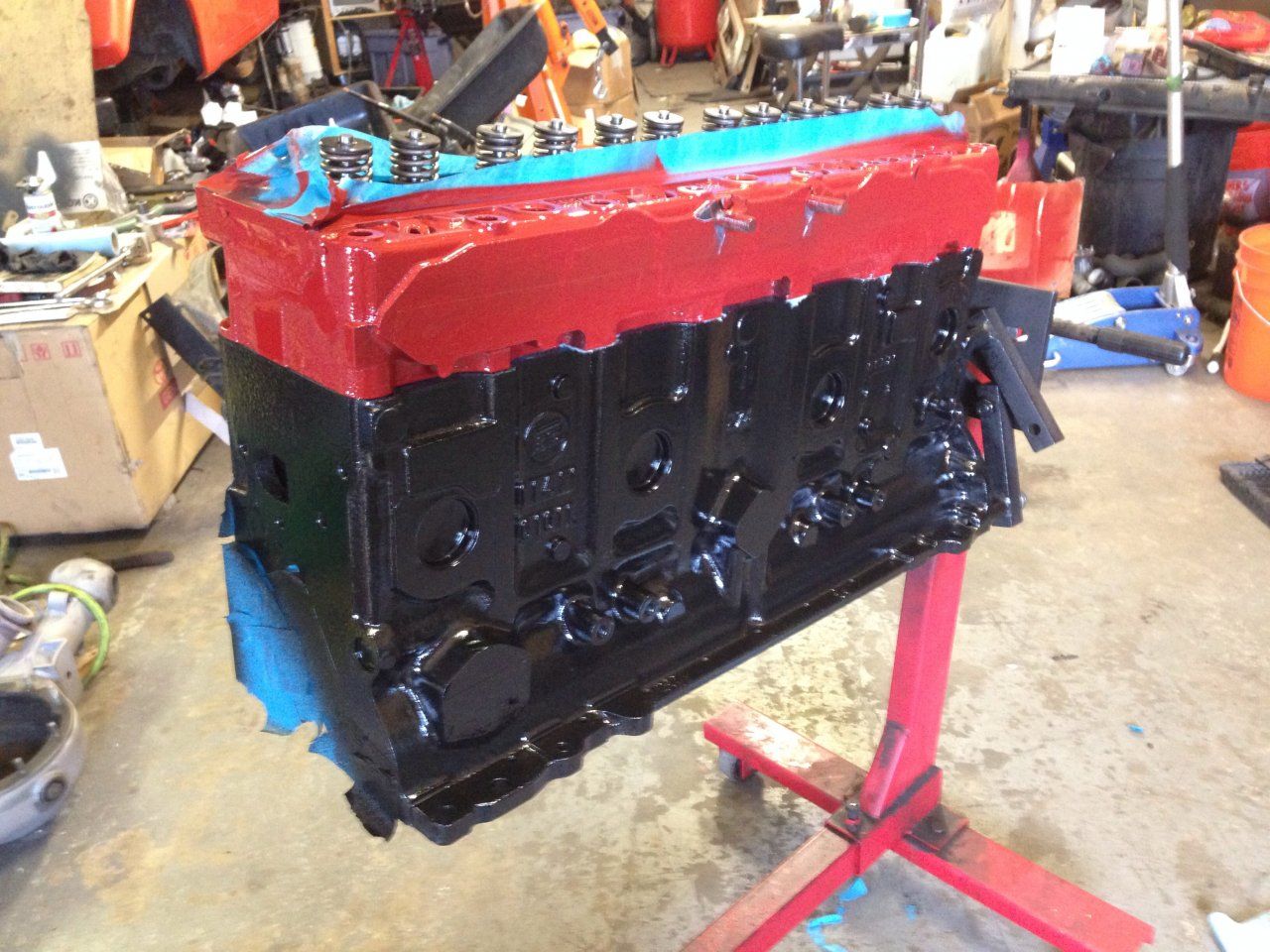

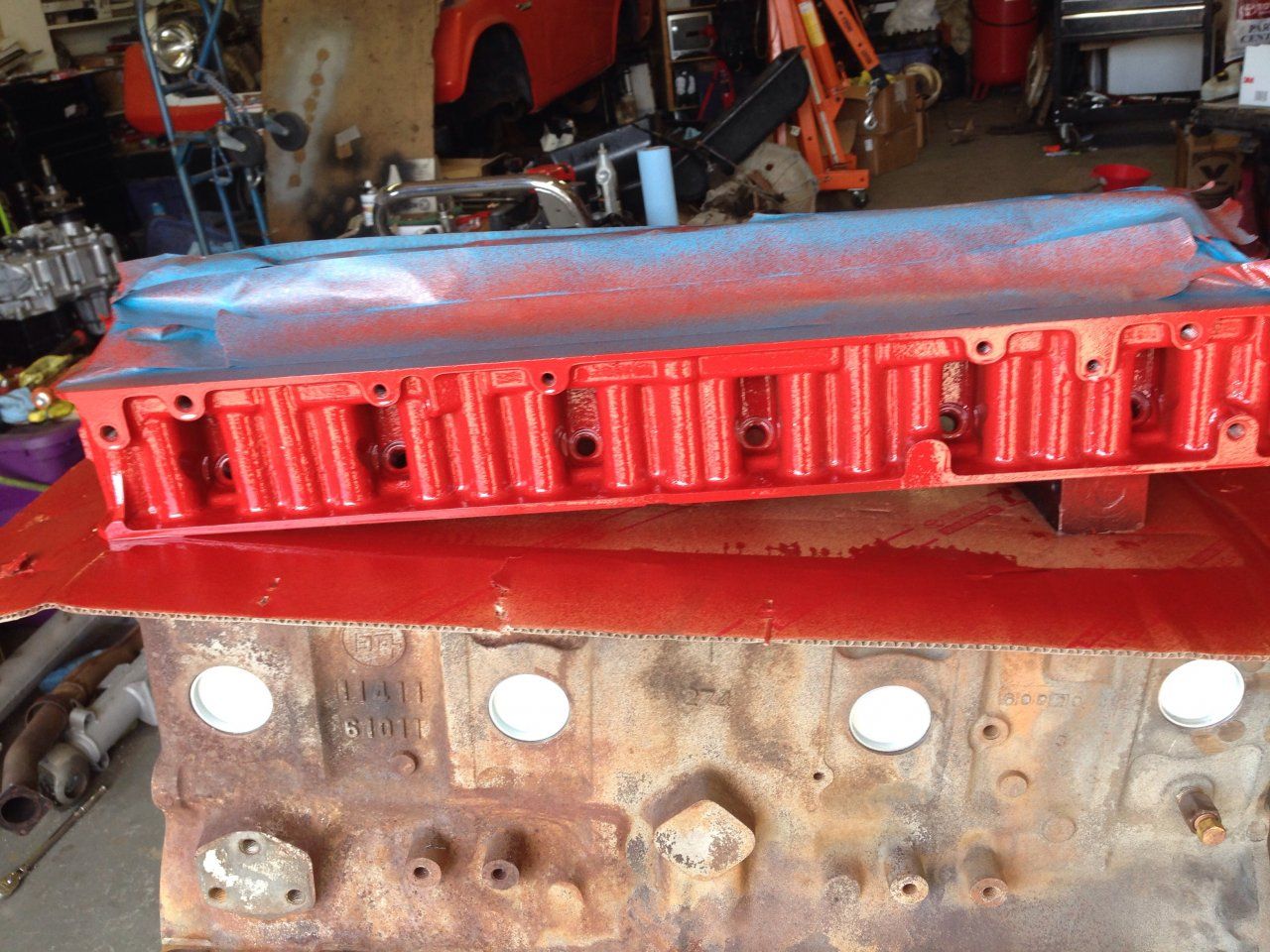

I has succumbed to failure on maintaining the "Redheaded 2F" motif (yeah. I said motif.... :flipoff2: ) since overwhelmed with the abounding issues on both builds and not finding a high temp , T -309 equivalent.
Gave up on it, since a mundane item to be mired down on, but Robbie took it upon himself to pick up the ball and had a can mixed that should be a very close equivalent.
Last I heard, today through Friday is being devoted to painting the block and head and initial engine assembly.
Should have pics of red head later today or tomorrow.
Block is painting with the same epoxy chosen for the balance of all black components.
Unsure in valve cover, as far as fit or color, yet, but glad to have something to think....
