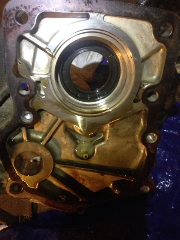

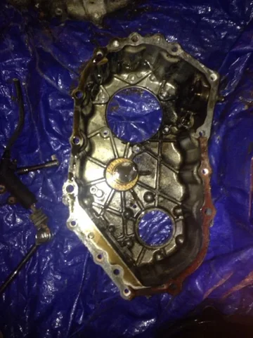

Looks like it's shaped different to allow for the oiler provision, I just installed mine to the same H55 so I know the later housing will work anyway. Sounds like you're getting the whole case, you can just use later both halves with your gears if there is a difference.
Tucker

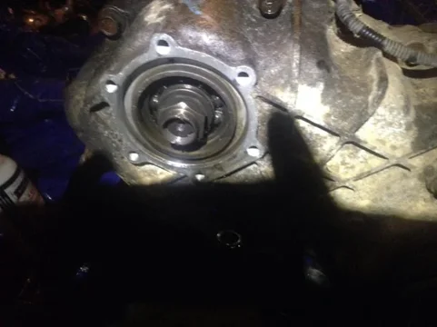

O-K, who was writing about a different seal used between the 2 different 34mm shaft split cases?
Will the different seal required for the new half case be compatible with his gears?
Is this the correct front cover and do you still need one?
If you end up requiring one and this one will work, send me an address to send it to and it’s yours.
Thanks again, J Mack.

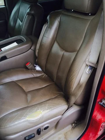

Going back to the seats.
Has anyone ever seen a rear bench in any vehicle that had ABTS at all three seating positions?
Thinking about finding means to integrate into the rear fold down.
Would powered front seats be that big of a deal?
I do not want them, but that appears the only configuration for the GMC seats with the flat railed base and ABTS. Can't find the same ABTS in anything but tan leather, either.
These seem a very viable solution, but they're not in line aesthetically with the balance of the planned interior.
Hoping to find in manual, black (for black belts. Thinking recovering wouldn't be an issue) but don't know if they'll aesthetically integrate.
Opinions?
Really not much to rebuilding a split case, just some bearings, seals and gaskets ... have to do most of the last two just to install it. Kurt & Georg had "kits" in stock a few weeks ago ;) Tucker
