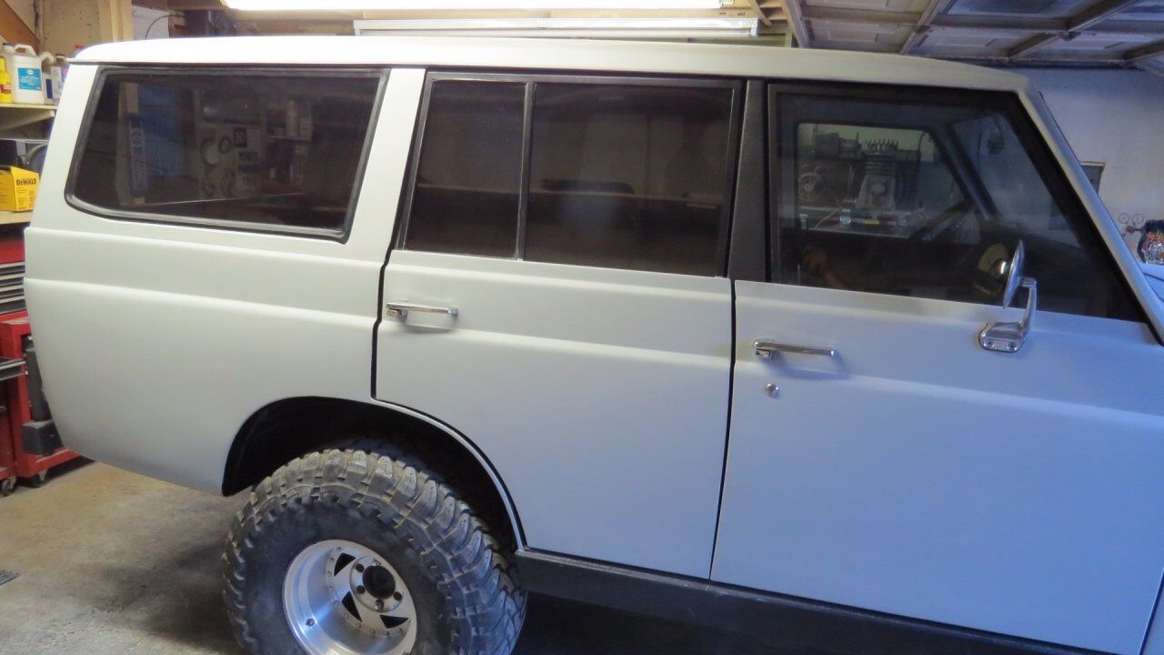

Like how it looks like an 80 and trying to think how it would look to mimic this, with Freeborn all the way to the gutter and white roof.

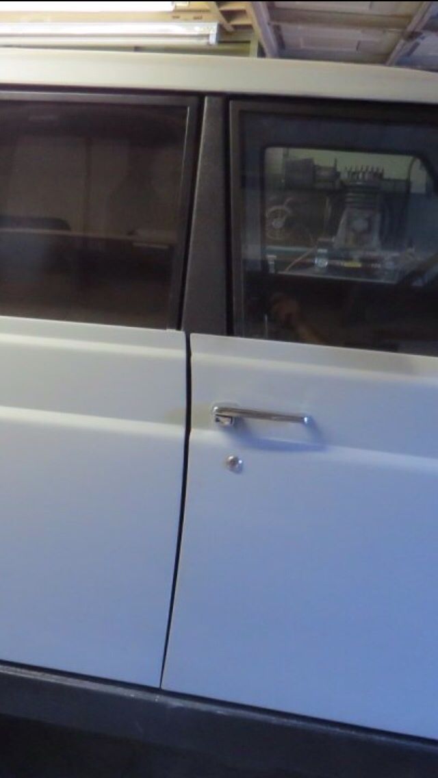

Not a resto ( just wait until you see the turn signals I'm planning. Gonna be tied to the stake an burnt....but they seem to fit.) and think it might look cool, still classic Cruiser.
It is a higher gloss than anticipated, but the claim is it'll continue to cure for several weeks, lessening the gloss.
As long as it's durable and consistent, I'll be good.
What kind of paint you use? Looks really goof
It's a two part epoxy primer from Southern Polyurethanes.
When researching, a lot of restorers and painters claimed the a finished product for applications similar, since exposure to UV is very limited, superior adhesion to steel, and very durable.
The company appears a family business and after describing the intended surfaces, they reiterated what I'd read.
Owner listed his mobile number on website to call with any questions or concerns, which sold me on customer service.
