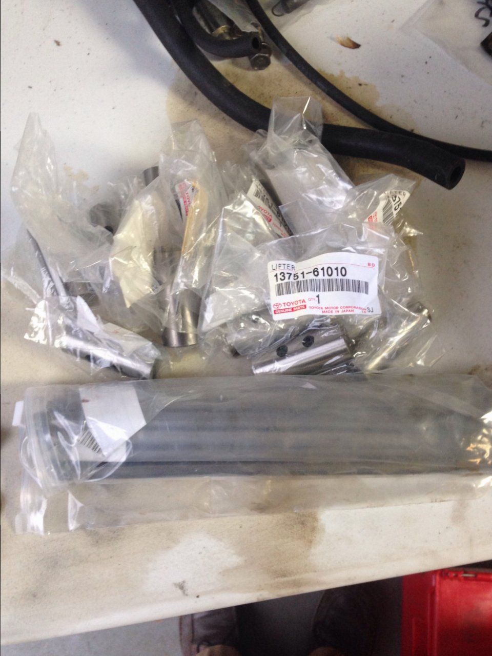

Mistakingly ordered 3FE lifters and pushrods, so....
NIB Cryo'd 3FE Pushrods and Lifters $300 OBO
Onur loaned the correct 2F parts, hoping to minimize delay, but the machine shop isn't running a cryo load until next weekend, so dead in the water on engine reassembly for a couple of weeks.

The rocker supports and springs from the early 2F head won't fit.
When Jason asked if I wanted used rocker assembly, when I bought the late head last year, that'd been disassembled for testing, I said I didn't.
Didn't think to order rocker supports or springs.
Difference in thickness was noticed, but mocked to check clearances at valve cover.
Not more parts ...

Rocker supports are on the way, although I don't know that it's been confirmed that the 6th is the oiler variety.
Springs are NLA, so hoping Jason has, or they can be sourced to replenish what's being pulled from another 3FE head.
Edited: All supports are now the oiling variety.

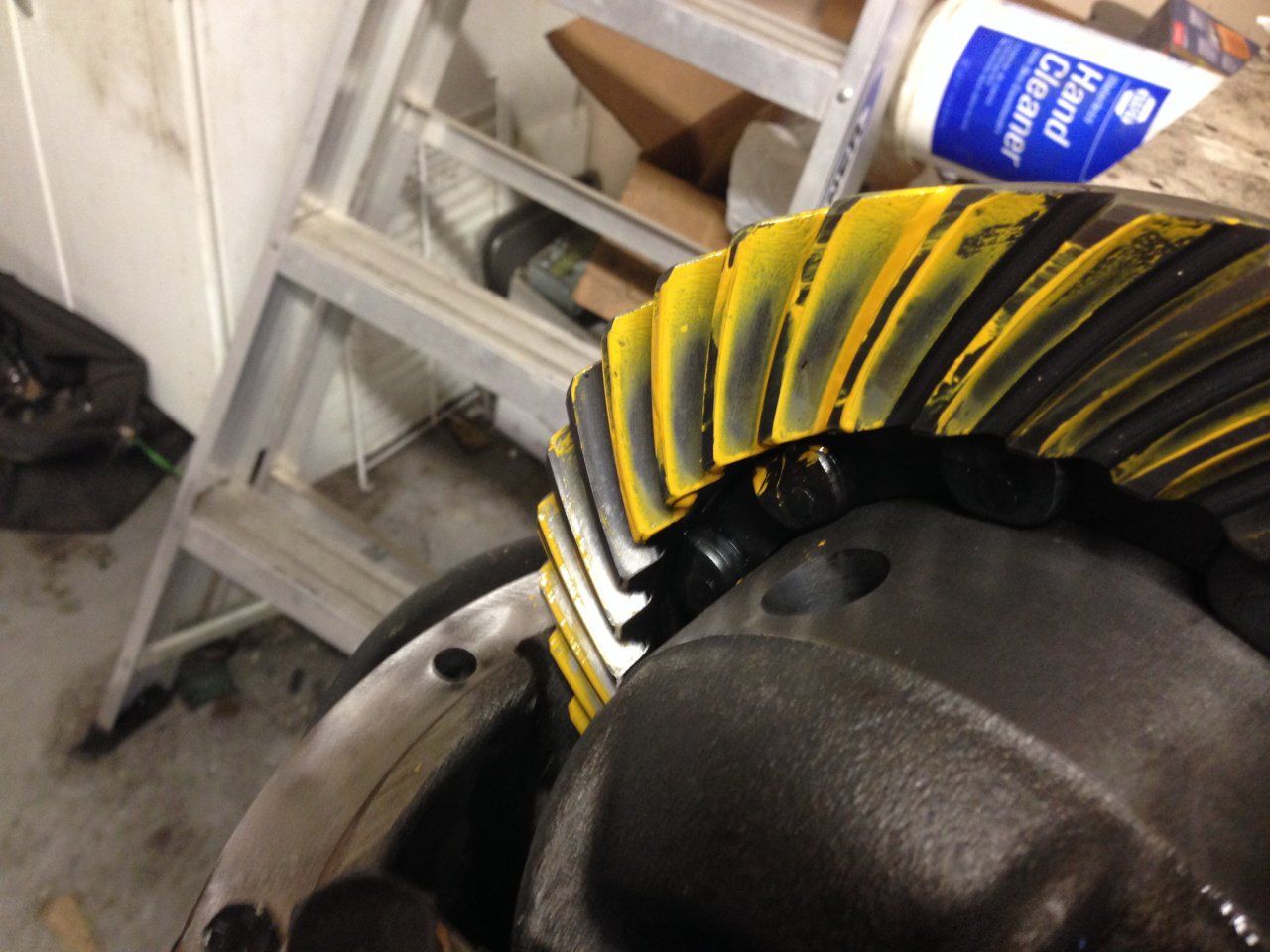

Tell me again, Those are new gears or no? 4.11's. Pattern looks right on.
Original 4.11 rear.
Had to pull to swap OE spiders in for locker, plus replaced bearings in both front and rear, as a preemptive measure and to appease the voices in my head.
Going to swap front for rear, after refreshing both, regardless, but they the gears looked good enough to run.

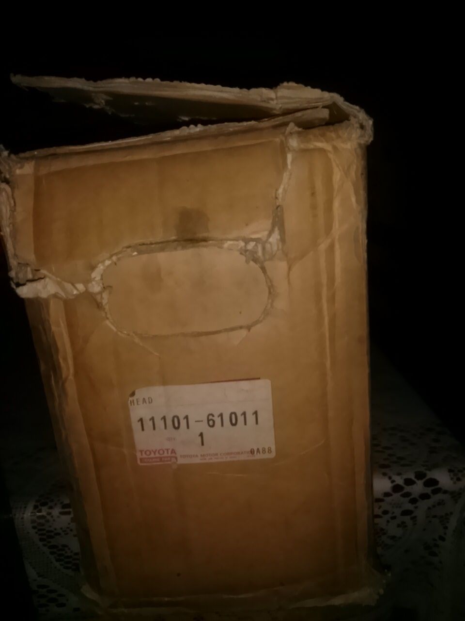

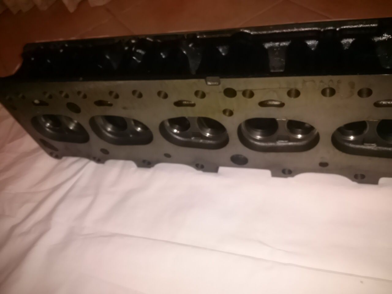

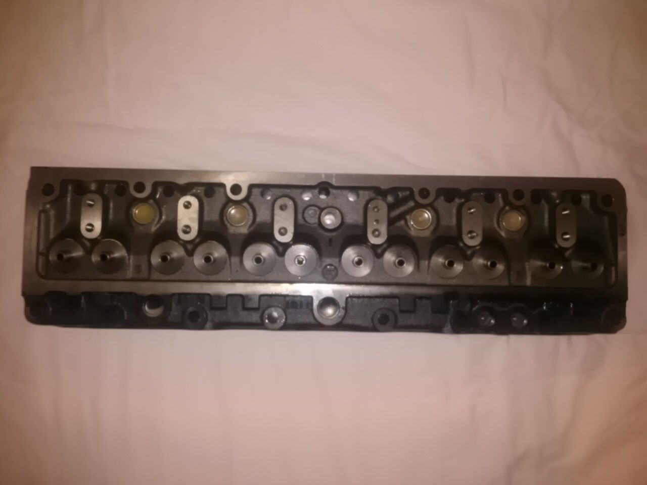

1986 NOS ME spec 2F (3F) head, the non-US no smog variety.
Found months after I'd given up on it being buried in the container.... Has an 2F NOS block, too.

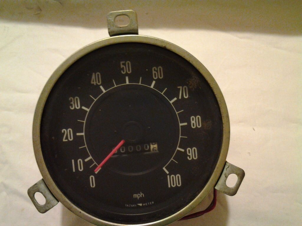

Did score a speedo....
