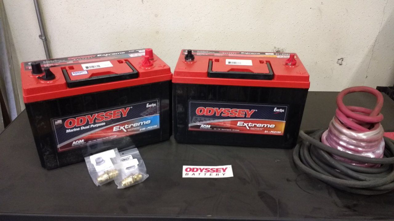

Odyssey batteries are indeed hardcore. Still, I'm worried by what I read that said automotive alternators don't charge them correctly which shortens their life. Maybe that's just a ploy to get you to buy one of their chargers, though.
Has anyone tried a pair of 6V golf cart batteries? I was even thinking about having a smaller starting battery dedicated to nothing but the starter. Something like a smaller odyssey, isolated from the rest of the 12V system. Then you could forget about any need of CCA on the "house" batteries.

AGM's do have several advantages but they do not handle overcharging well. With good charge controller they will last a long time. However vehicles charging systems are nothing more than a poorly regulated power supply. In a daily driver you would not see as many issues as a part time vehicle.
biggest concern is keeping them charged. agm or flooded. use a trickle or solar if not being driven often . this will ensure the life of your battery. as for agm or flooded. flooded gets the vote for most applications that don't have high vibration.. RVS for one. crown makes some grear 6v that I considered for my lx450 Chinook but after talking with many folks the performance gains vs. the additional upkeep of the flooded didn't warrant me moving away frim agm. flooded batteries need maintenance and given how much mine sits it didn't make sense for my application. I run a Morningstar dual battery charger. been working flawlessly for the last year. batteries topped up when I finally drive it. freezer went for 2 weeks and no issues.
Bingo! The two biggest concerns are not keeping it charged and overcharge. Flooded handle overcharging with ease, just top off and go. Overcharging will kill AGM's fast. Even with a good charge controller keeping your vehicle charged you run the risk of overcharging it from the alternator once you start driving it. The maintenance of adding water to a flooded battery is simple and the frequency is usually overstated. I run two 6v flooded golf cart batteries in my trailer. Over the past 3 years I haven't had to add much water to keep it topped off. Another issue that isn't talked about but happens more with AGM is cell imbalance. With AGM it is a narrow line between fully charging all cells and over charging. Of the AGM batteries I have seen fail a large portion are due to a single bad cell. Many think it is a manufacturing defect or just a bad battery. In reality the cell failed because it was the weak cell and not fully charged leading to failure.
All this talk about overcharging. How does one do that? just by driving it daily? Are we talking about too much charging at normal voltage or the off chance that the voltage regulator is damaged and is sending more amps to the battery than it should?
Both AGM and flooded can be charged safely using 14.4v or slightly higher. There needs to be a difference in voltage between the supply and the battery for it to charge. Once the battery is fully charged it should be held at a float voltage to keep it from self discharging. If it is kept too high the battery will gas. The higher the voltage the faster the gassing. Flooded that means it will need to be topped off with water, however it would take a lot of gassing before you notice a level change. AGM are sealed and can handle some gassing as it will recombine in the battery. If the pressure gets too high in the battery it will vent and that water is lost with no way to be replaced. AGM float is ~13.6v. My alternator output hangs around 13.8v to 14v with light loads. That would not hurt a charging AGM but it would be bad for a fully charged AGM.
