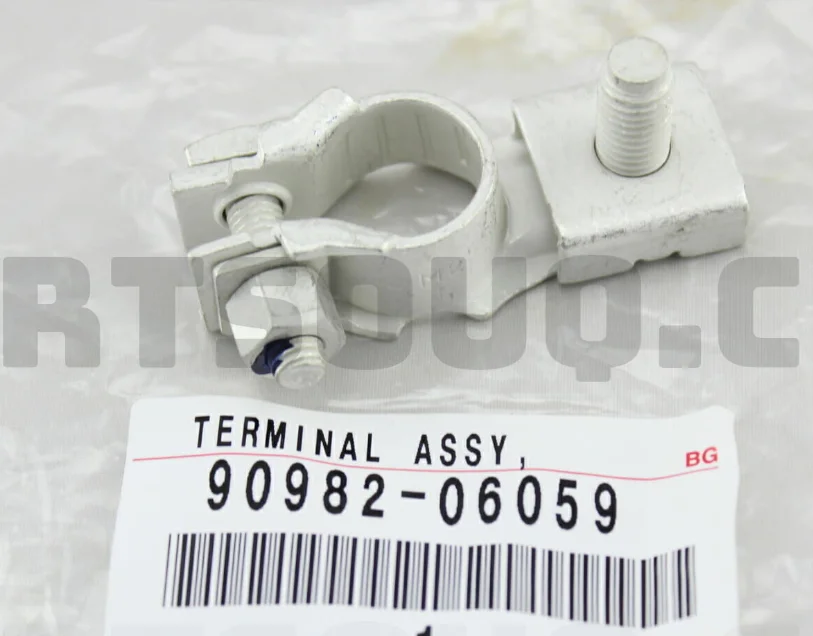

@OGBeno good to know. Which OEM connectors are you using? 90982-06059? (or similar)
The 80 series connectors appear to have been lead molded onto the cable ends and not available separately.
