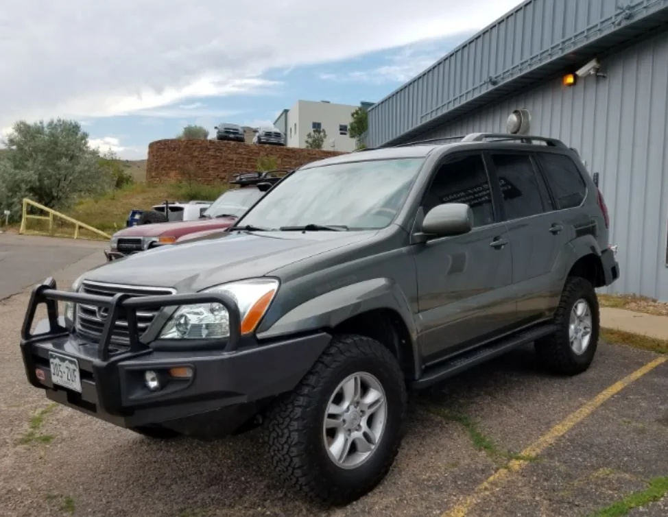

We finished the build for @daughterofromer 2007 GX470. All we need to do is replace the spare with a BFG AT KO and install Radios

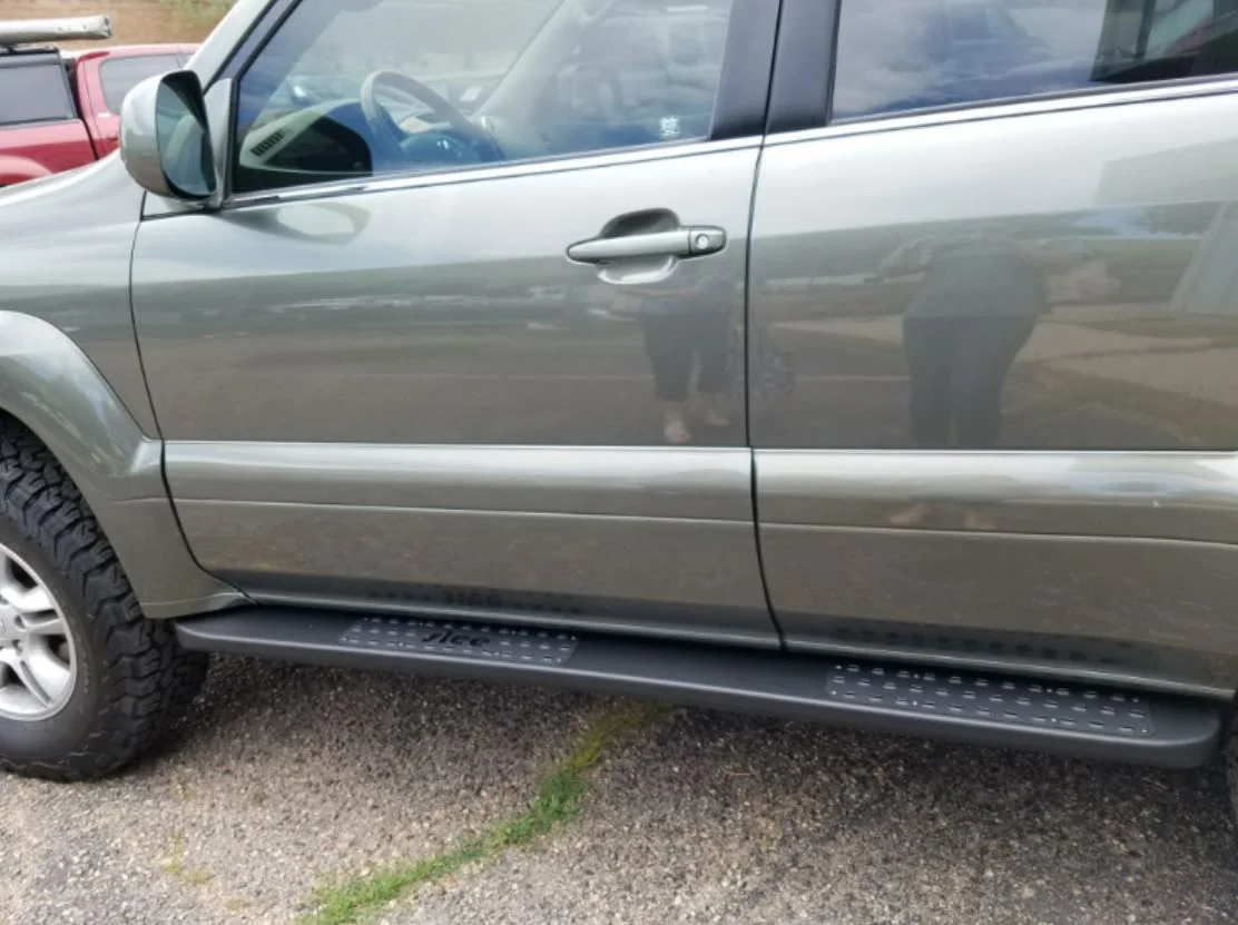

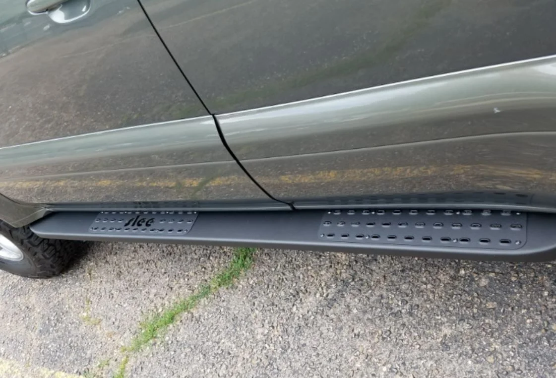

I was excited to get a prototype set of @sleeoffroad Sliders. They are pretty cool and have lights that you can see at night when you open the door
It has an OME 2.5" lift with:
  • OME 2885 Front and 2889 rear springs
  • OME N90000-S Front Struts and N60004-S sprot rear shocks
  • SPC-25480 Adjustabel UCAs
Rear ARB Locker with an ARB Twin compressor with Slee Compressor Mount and 80 series locker switch

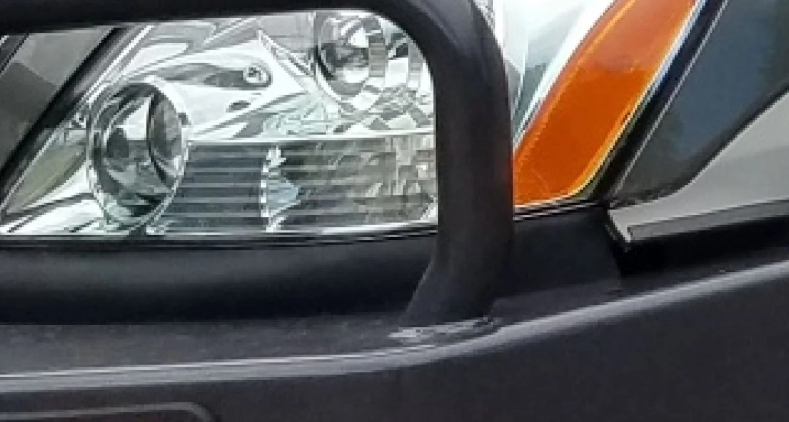

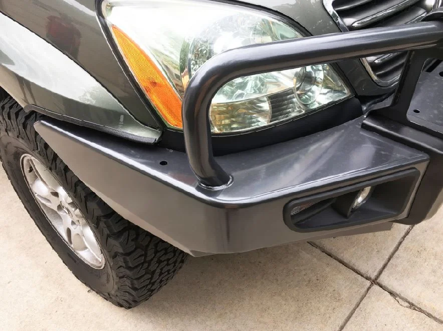

An ARB Bull Bar front bumper. We used the roll bar tubing for support covered by the Garage seal @Scat Adams talked about. I had the tubing left over from my 40 build. Its like the insulation for plumbing but with the diameter for a roll bar with better material. It came with the roll bar covers I bought from SOR. They dont have it separate on their web site, but if you call them they probably would sell it to you
This is the Trim we used on the fenders

Really happy with the Build

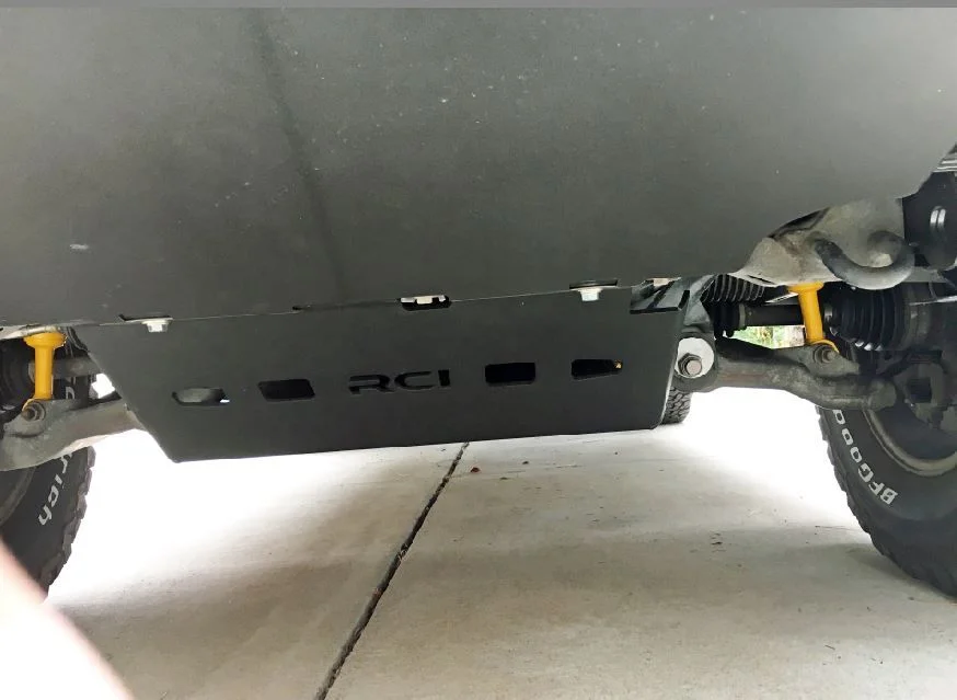

We also went with the full set of RCI Skid plates including the gas tank
A few more shots

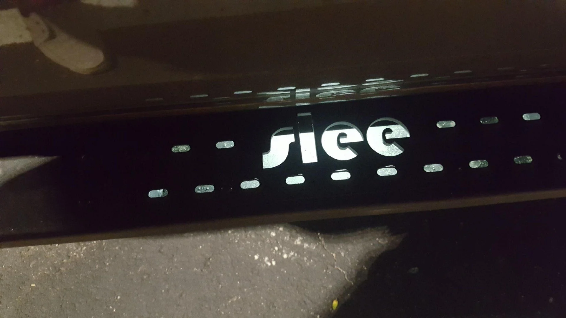

Sneak peak on the slider lights please!
Rachel will have to post them as I typically don't see it at night when you can show the lights

You totally lost me with the "roll bar tubing for support covered by the Garage seal @Scat Adams talked about" mention above. Got a link to @Scat Adams post? Sorry if I'm daft - just curious what it is, what it's for, etc.

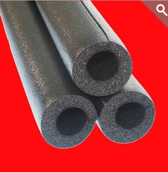

I took Roll Bar tubing from SOR, looks kind of like this

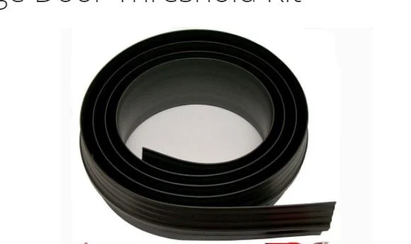

I bought Black shinny Garage door seal at Home Depot
I laid the seal over the tube and essentially shoved it into the gap between the headlight and the bumper. The tube gave it form and I also used dbl sided outdoor weather tape to seam it at the top. This way the tape isnt load bearing, the tube does that
It looks like this when done
I'll get some pics of the lights at night. Also I think the roll bar tubing fell out because it wasn't attached. So still looks good with just the garage door stuff to fill the gap.

Do you have any pictures of how the sliders mount? They look good.
Sorry I dont. Next time I see Rachel and her truck I will see if I can get better pictures. You can call Slee and ask any questions you might have. I had them install the sliders, Lift and Locker while we did the bumpers and skid plates

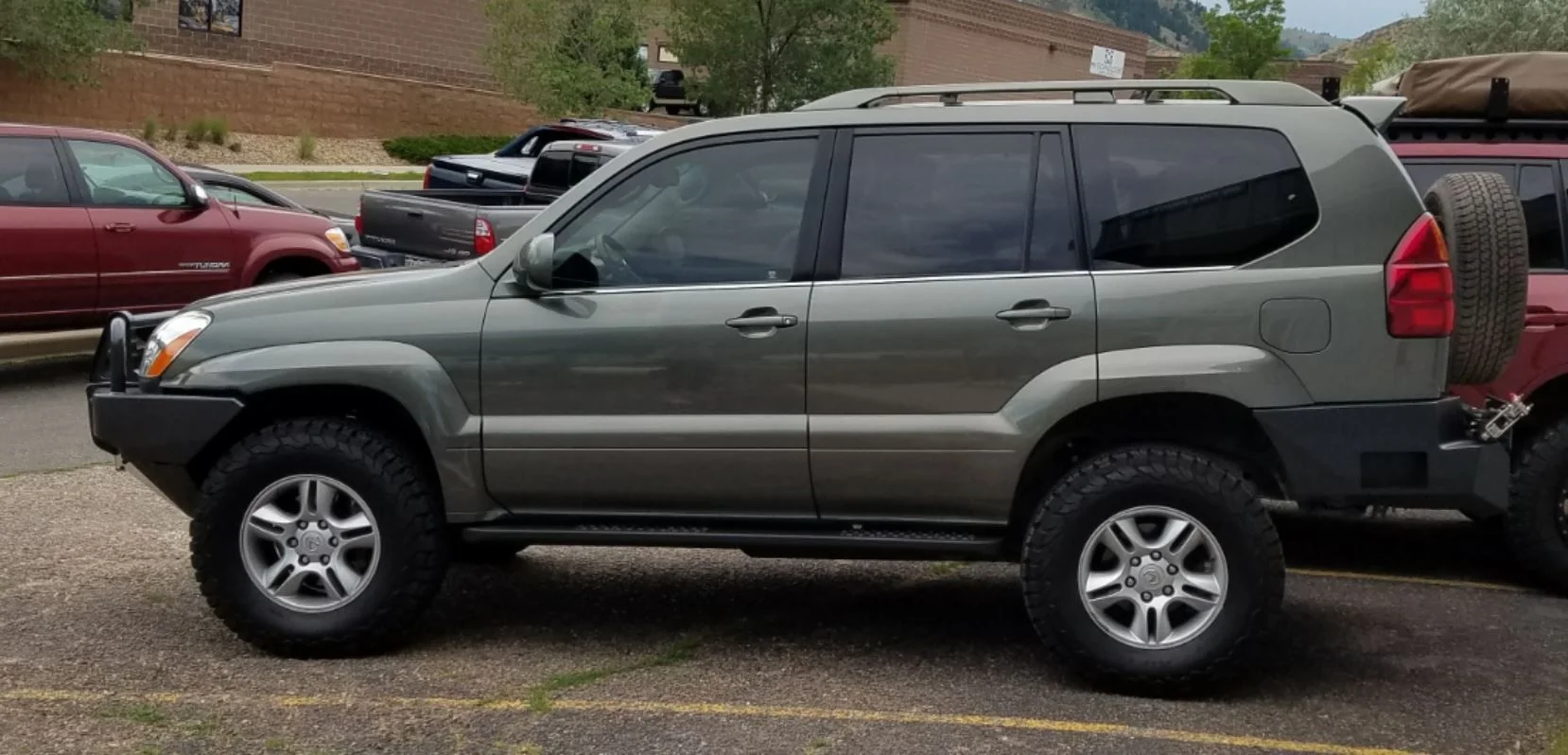

Rachel, how's the ride with that OME lift? I hear it's stiff unless you add some weight, which I guess you did... is it tighter feeling than your stock setup? Also did you leave the stock UCA's, or also upgrade the upper control arms?
Need to figure out suspension on ours, as our airbags are giving up the ghost. Maybe I should run down there and pull your airbag parts out of the dumpster :)
edit: ok saw that you got the SPC UCA's.. nevermind. btw Ken that's a 100 series locker switch, not an 80.
It was definitely tighter than with stock setup before adding the weight. I didn't mind it. I drove around for a couple weeks like that.. Plus I was really tall ;)
Now with weight it feels good.. balanced. I'm VERY happy with it. Dying to get it off road!!
