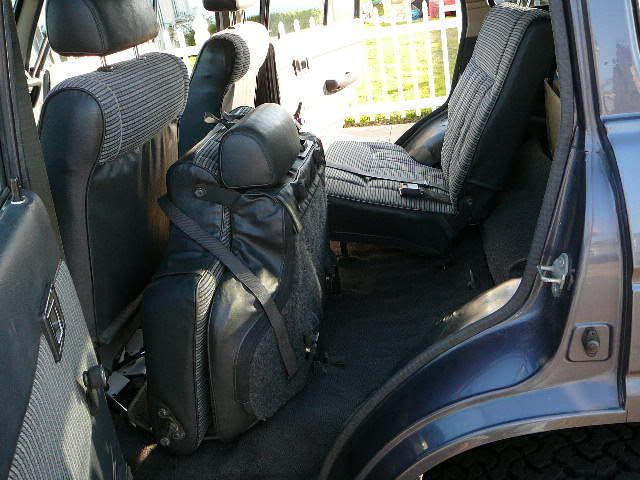

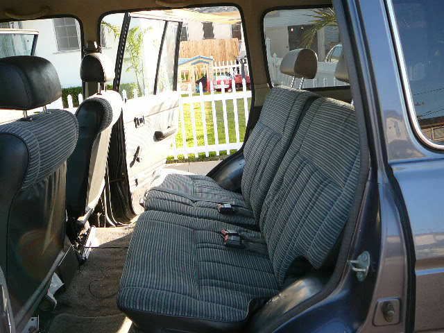

And the other is a rear split bench. I love how the older 4Runners have a fold flat rear split bench. So you can carry 3 people, and have one seat folded for more gear, etc... If you're going to reupholster the seats, you could have the shop cut the frame and make two seats, just would have to add another mounting hinge point on the inside of each seat like the old 4runners. I plan to also add head rests and rear shoulder harness belts.

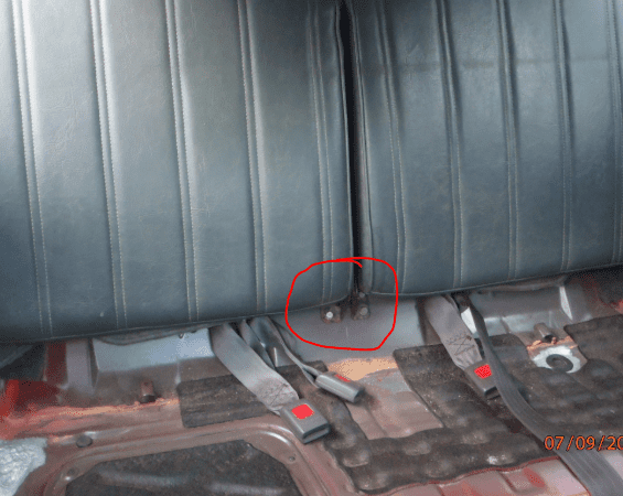

The rear seats on my old 4Runner had 3 connection points. The side hinge, and top pin connection (same as our 60's, and the center between the seats had a connection that held the seats together and bolted to the body. (see pic below). That's all that held the seat backs in place. You pulled the pin and the seat released from it's latch and folded down same as the 60's. I imagine the steel frames were built similar considering they are similar years of construction from Toyota. They were pretty stout. (sorry for the bad pics, I don't have the 4runner anymore and had to steal some pics from the web).
There is a center pin that connects the seats together at the bottom in the middle of the seats and bolts to the body:

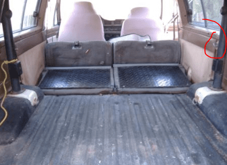

And they have the pin that you pull to release them from the side of the body (same as the 60).
Showing the pull pin and 2 hinges per seat
You looked into using HJ61 rear seats? They are split seats to allow access to the optional third row due to the hi roofline model.
Down side is they don’t lay flat. But a duffel bag in the low part and sleeping pad can fix that.

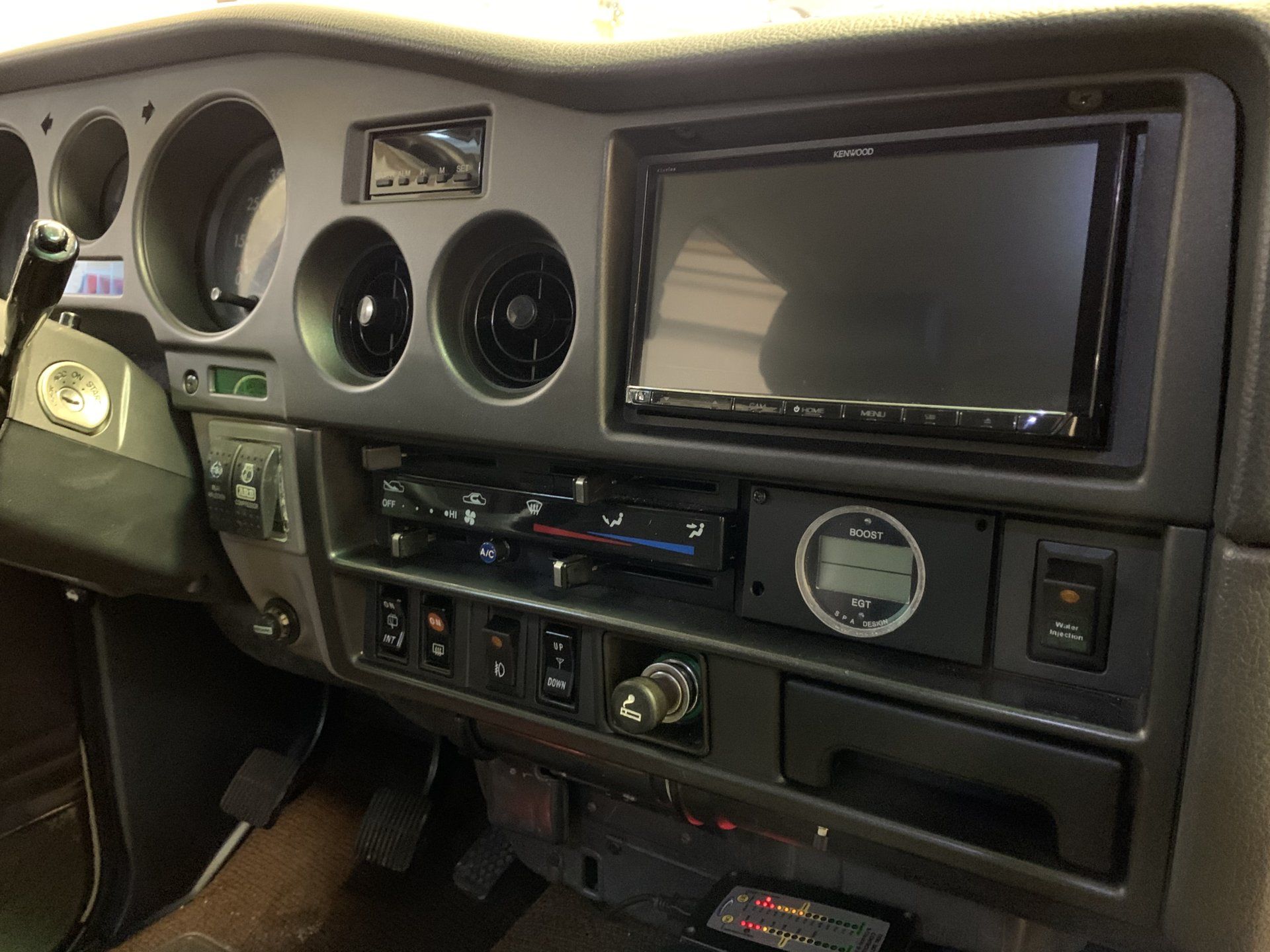

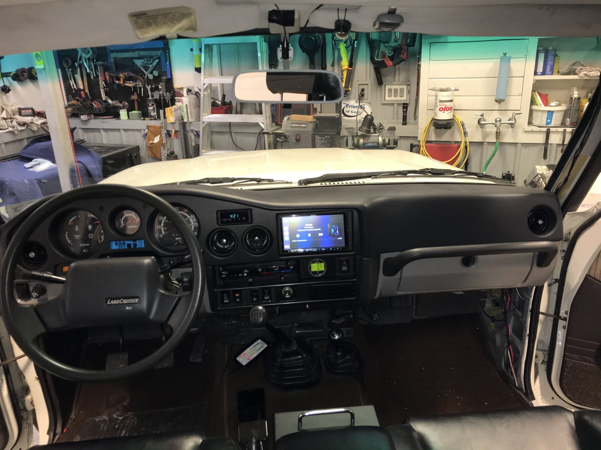

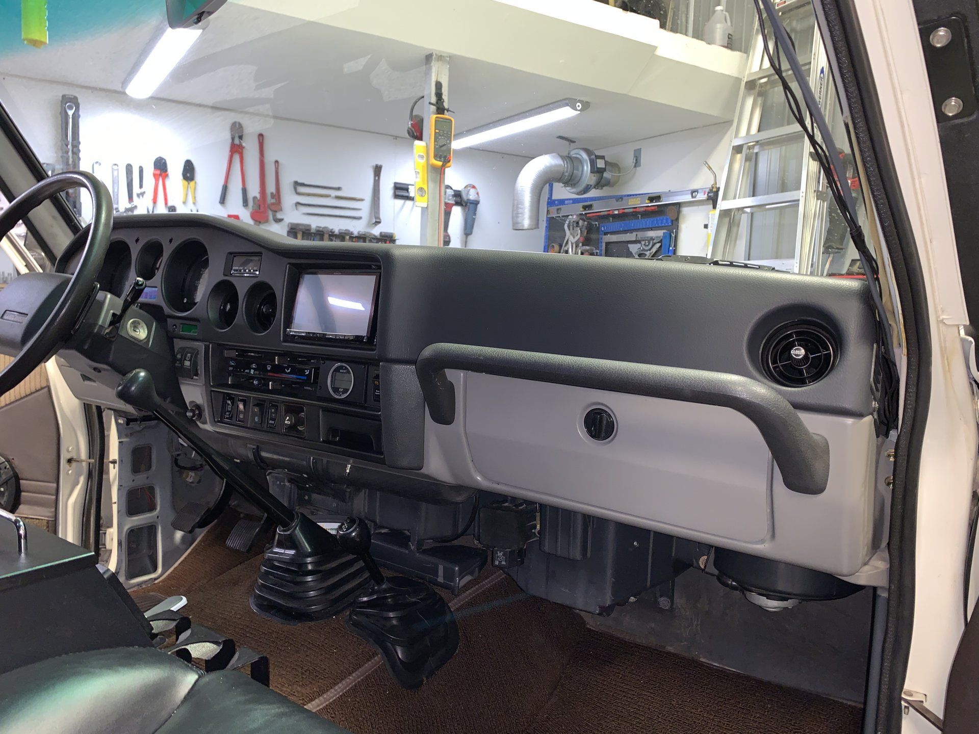

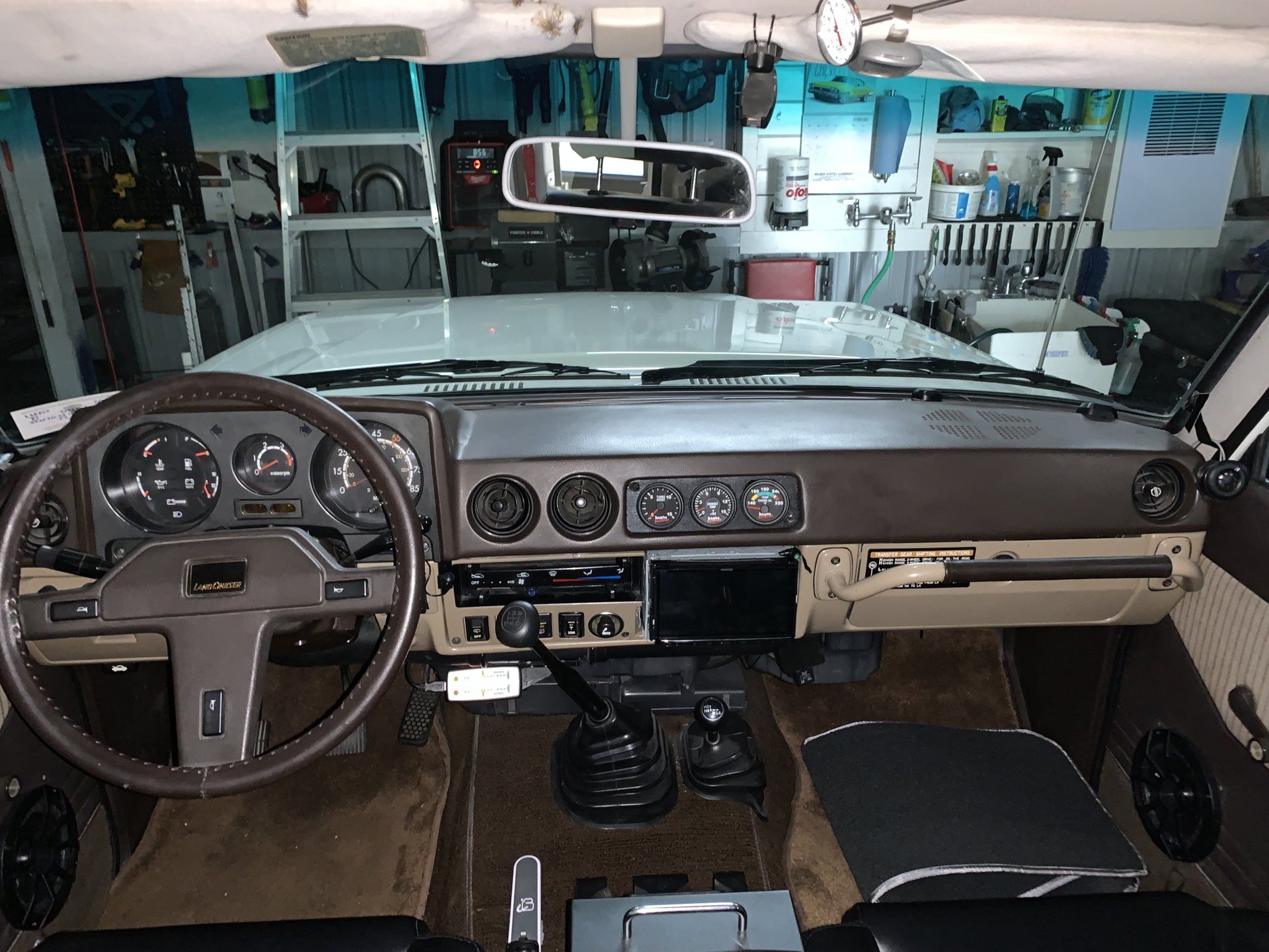

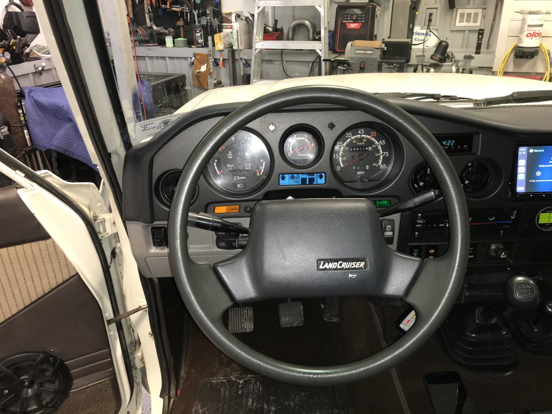

As typical, work and other “life” stuff prevents progress. However I have made progress especially withe the new 62 dash. I had to spend a LOT of time correcting my sins with the engine swap wiring. Start with the “Old Dash” to compare to the new one
Here’s the wiring mess (which is now straighten up, simplified and put in loom along the firewall)
I currently have the seats and door cards out and off to upholstery. Should be complete with this interior in two to three weeks - The functionality of this dash is SOOOO much better
View attachment 2180020View attachment 2180021View attachment 2180022View attachment 2180023View attachment 2180024
Perfect spot for the Redarc brake controller. Wish I'd thought of that before placing in a switch blank location.

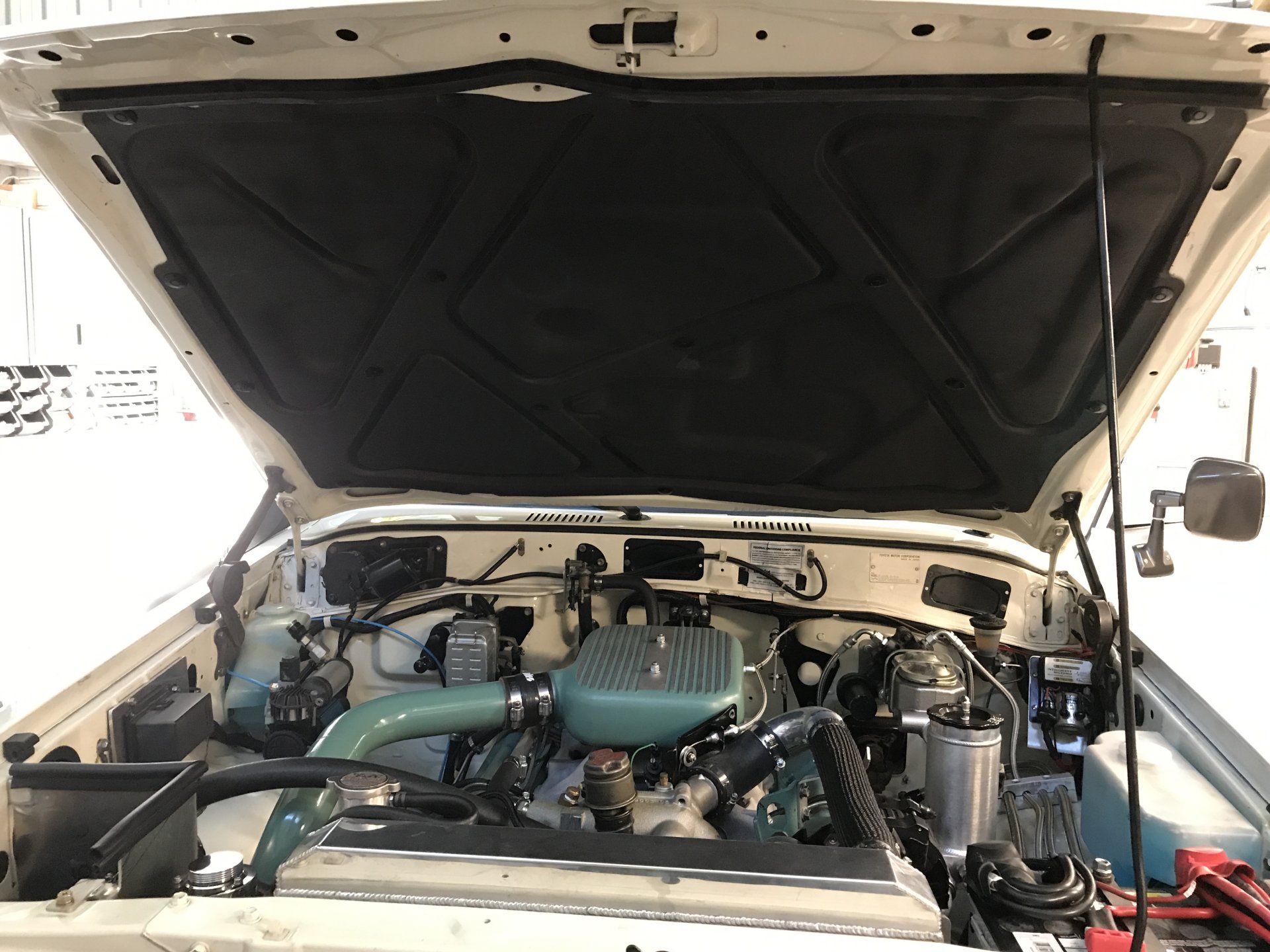

Its been a long but fun journey, but I am mostly complete with getting the Antichrist past all mechanical and exterior improvements in the vein of a resto mod. Gone through the drive train including a Detroit Diesel 6.2l Turbo Diesel, paint cushion tail gate, suspension, bumpers, Yady ya.
What an awesome hood insulator!!!
