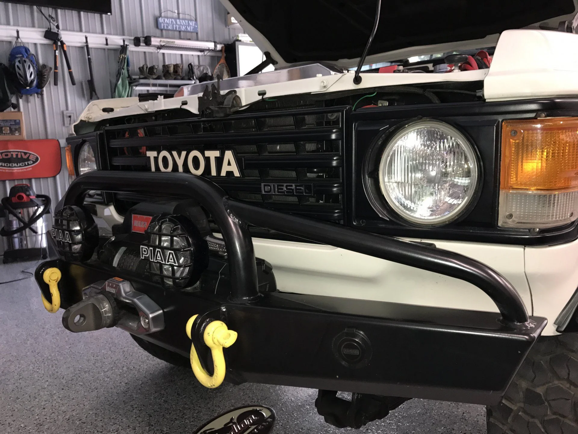

The 6.2 came with a block heater- I drilled a hole and used a marine grade water proof shore plug in the fron number to secure the 115v cord connection
That is one nice shop floor. Exceptionally clean.
Epoxy floor with color chips. God help you if you drop a washer or small part. But the oil leak on this floor is really really easy to clean up - just wipe up- not residual or staining. I do need to take care with sharp impingement items like uncovered jack stands

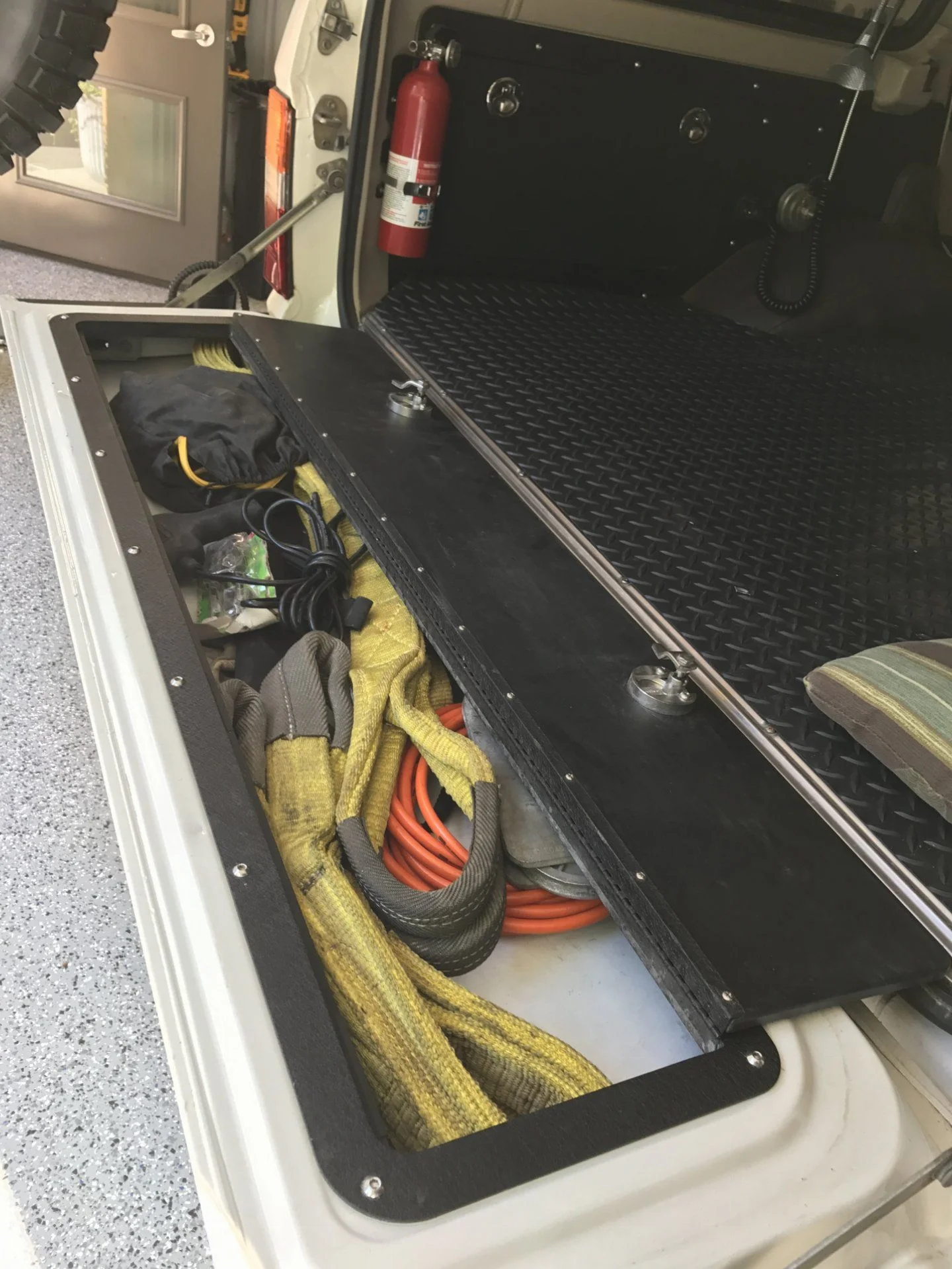

I had those done when I had the truck painted- sanded, primed & painted. All the trim was done - door handles, side vets, etc. The rocker panel trim piece was removed and the holes welded and filled. I also had the rear tailgate modified by removing the license plate inset to make room for tailgate storage using the WagonGear panel

What brand are the lights mounted in the upper hatch access panels? And did you run the power wire through the rubber elbow into the upper body?

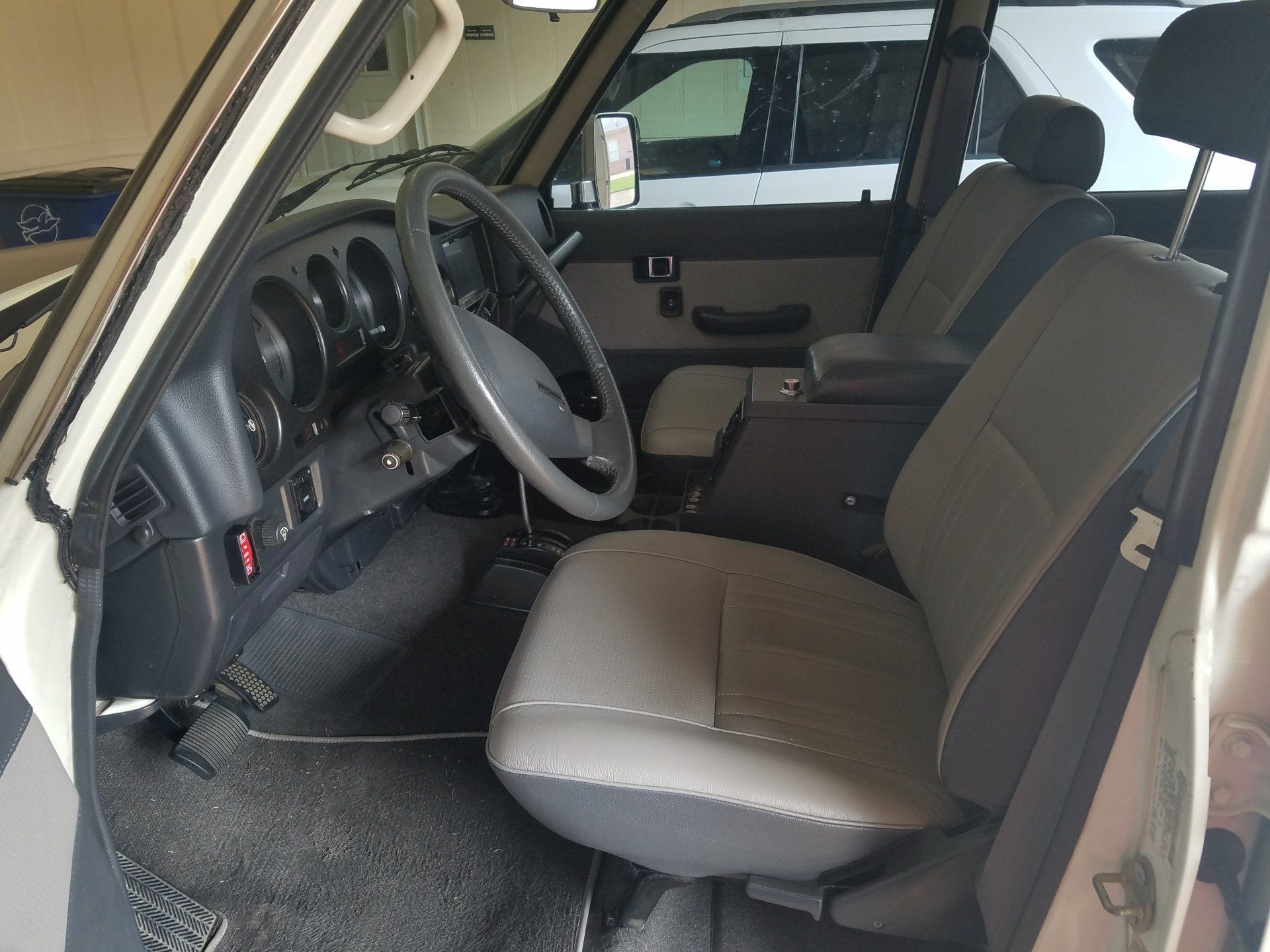

Here is what I had done on the front seats. Has held up well. Also has new SOR foam on the bottoms.
And added headrests on the rear seat. Funny how I can't find pictures when I need them. Wagongear seatbox and cruiser crap console.
Jfnall- i do not know the make on the lights. I think I got those from GAry at Mudrack. I did a number of variation back there before I land on this final version- I had a separate battery pack with, like 6 AA batteries, then I wired to the stock wire harness. Now I have them wired to the auxiliary power circuit through the rubber elbow up along the headliner and over to the drive side quarter panel aux fuse box on a "Light" circuit

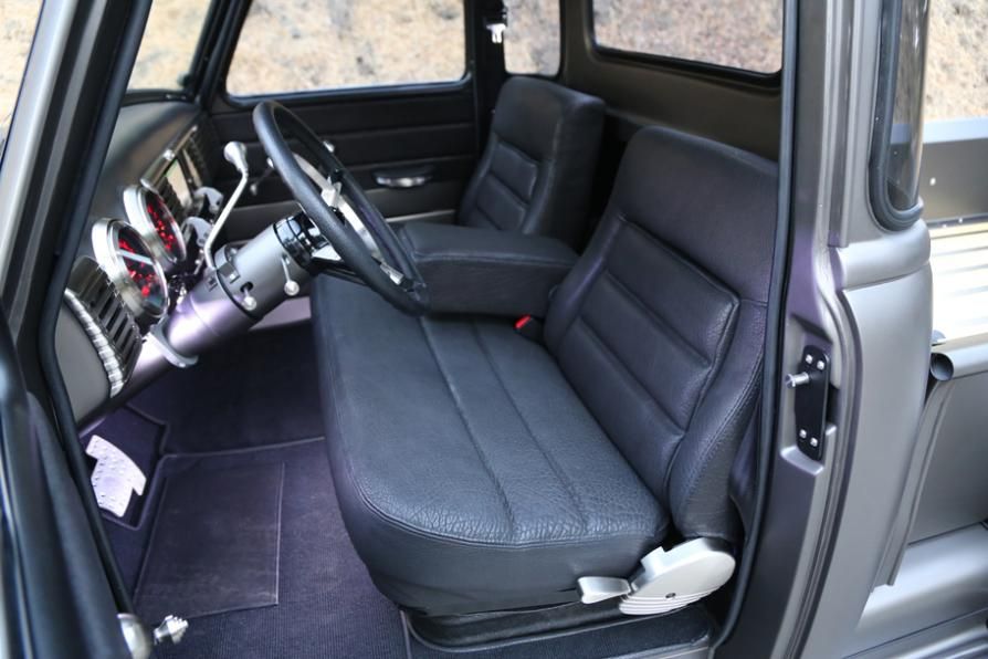

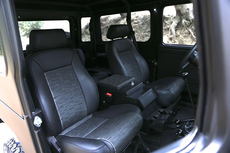

I also have been thinking thru ideas on the ol' interweb and went to the Icon website. First to just drewl, then I realized that the Icon approach pretty much encompasses the idea of modernizing classic vehicles- especially crusiers and was thinking this sort of thing would just be awesome in my own rig
I wonder how much of my right arm it would take to get this look going in the ol' cruiser. Or Icon has the schweeet '52 Chevy PU resto mod interior with the buffalo hide and aluminum thing going all on:
My interior was trashed when I bought the vehicle. I had to go completely custom, but I tried to match the "spirit" of the original interior. A few things you can see in the pictures:
  • Seats and door cards re-covered in leather, attempting to match the patters of the original cloth. They even covered the shift knob and the steering wheel. Also new headliner and ew carpet (they used glue-down carpet that looks nice, but I do not expect it to hold up like the original). I had this all done while living overseas, so it was much cheaper than if I had it done in the US I'm sure.
  • NOS OEM dash pad. This was a splurge, but made a huge difference in the "new" feeling of the interior.

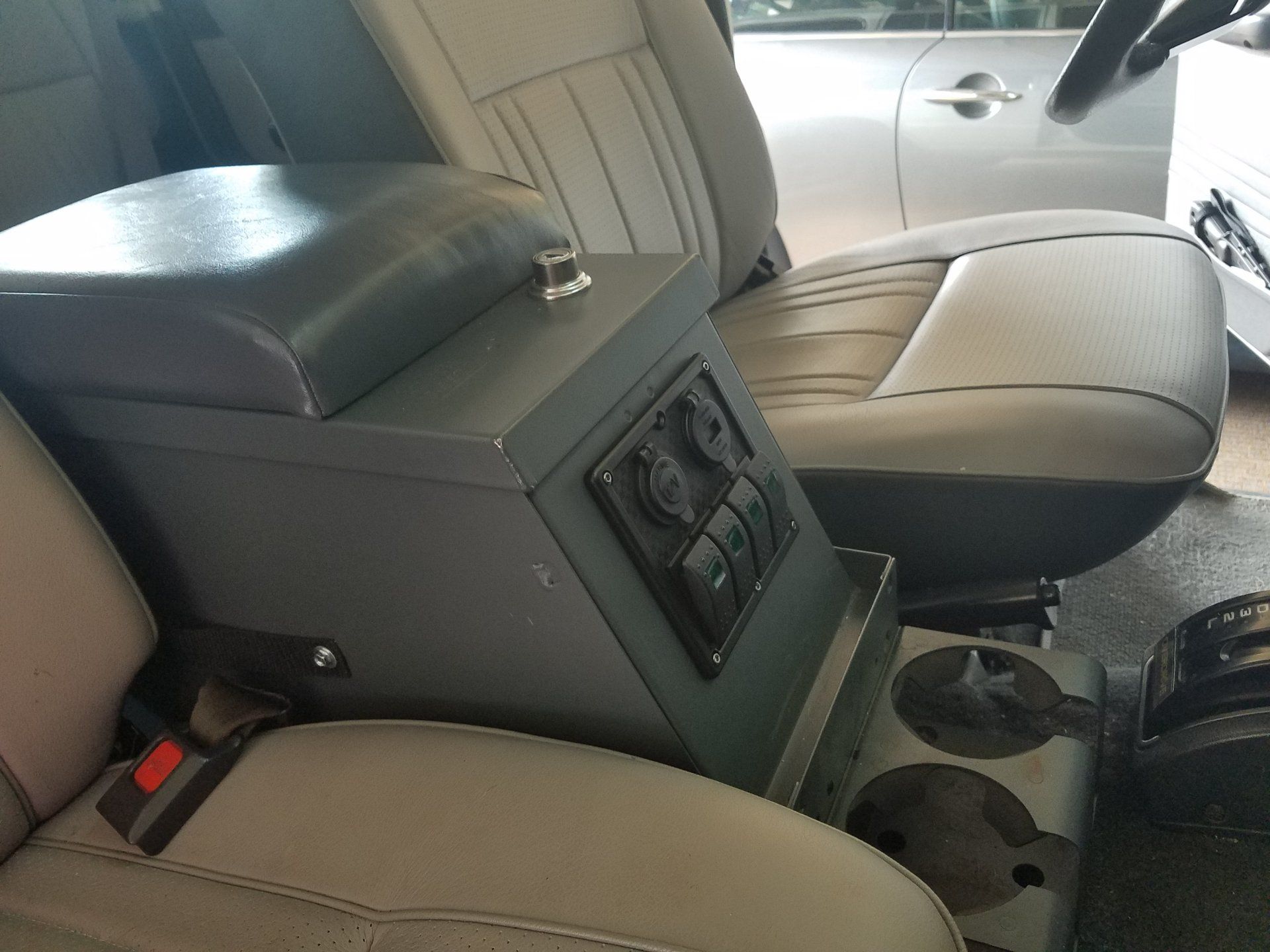

  • I replaced the center console with a Tuffy Box. And I know it is probably heresy, but I compromised the security aspect of the Tuffy by cutting a hole to mount a switch plate for my exterior LED switches and USB chargers. I mounted it on top of the heater using the existing brackets, and added an additional Tuffy cupholder on the back.

I really like the leather upgrade- this is sweet. Can you provide more detail on the headliner? Any shots of the plastic covers(i.e. Seat belt covers on the B pillar and the rear quarter panel "surrounds around the rear windows?
Thanks! There's really not much to share re: the headliner. I told the guys to find a headliner material similar to the original (which was still in place, but sagging and torn in some places), and they were able to match it pretty closely. Also, I used ALL of the original plastic bits-- if anything was cracked or gnarly looking, I just trimmed it up with shears or a file. With all the fabric/leather new around it, I really don't notice any imperfect plastic at all (and I thought I would).
