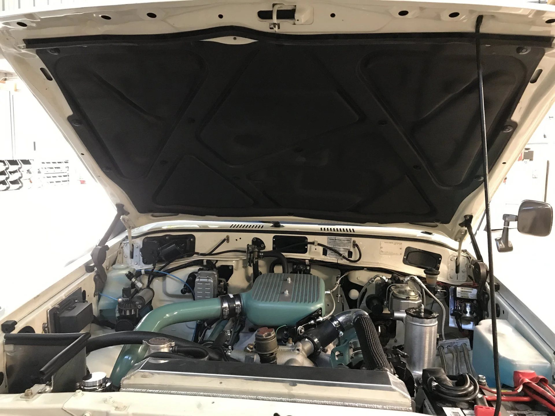

Its been a long but fun journey, but I am mostly complete with getting the Antichrist past all mechanical and exterior improvements in the vein of a resto mod. Gone through the drive train including a Detroit Diesel 6.2l Turbo Diesel, paint cushion tail gate, suspension, bumpers, Yady ya.
[Link to engine swap]

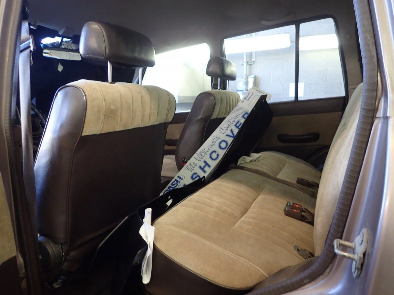

I pulled a set of seats and door and cargo panels from a part-out 60 that had had its interior redone. All the seats and panels are matching- they key to a clean interior, right? There are a couple sets of aftermarket seat covers being marketed right now, but nobody makes the door panels. your best bet is to take your upholstery to the shop and have the pro fabricate a matched set. IIRC, the seat cover guys have bulk fabric that your upholsterer can use to fix the door cards. I think Trail Tailor is working on repro door card backing...
Yup. I was considering a move away from the stock look and go to a fully custom interior. I do not own mad upholstry skills so this will be me finding the right custom auto upholstry shop. Not likely in Mountaineer state (custom upholstry has a whole different meaning in West Virginia). I was hoping to get some concepts from others if there has been any custom interiors done

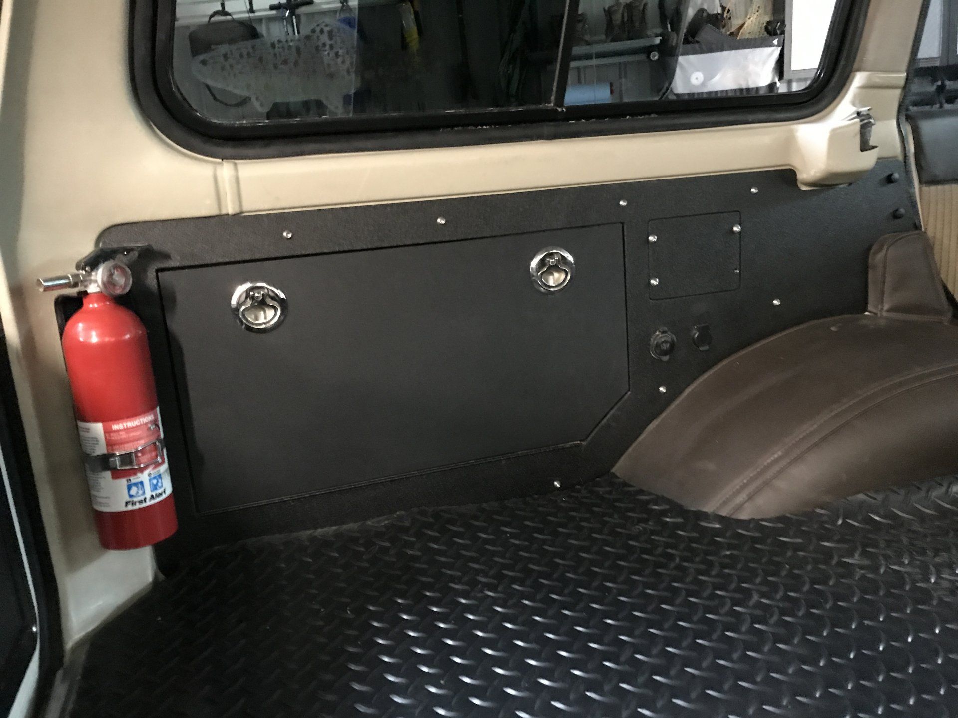

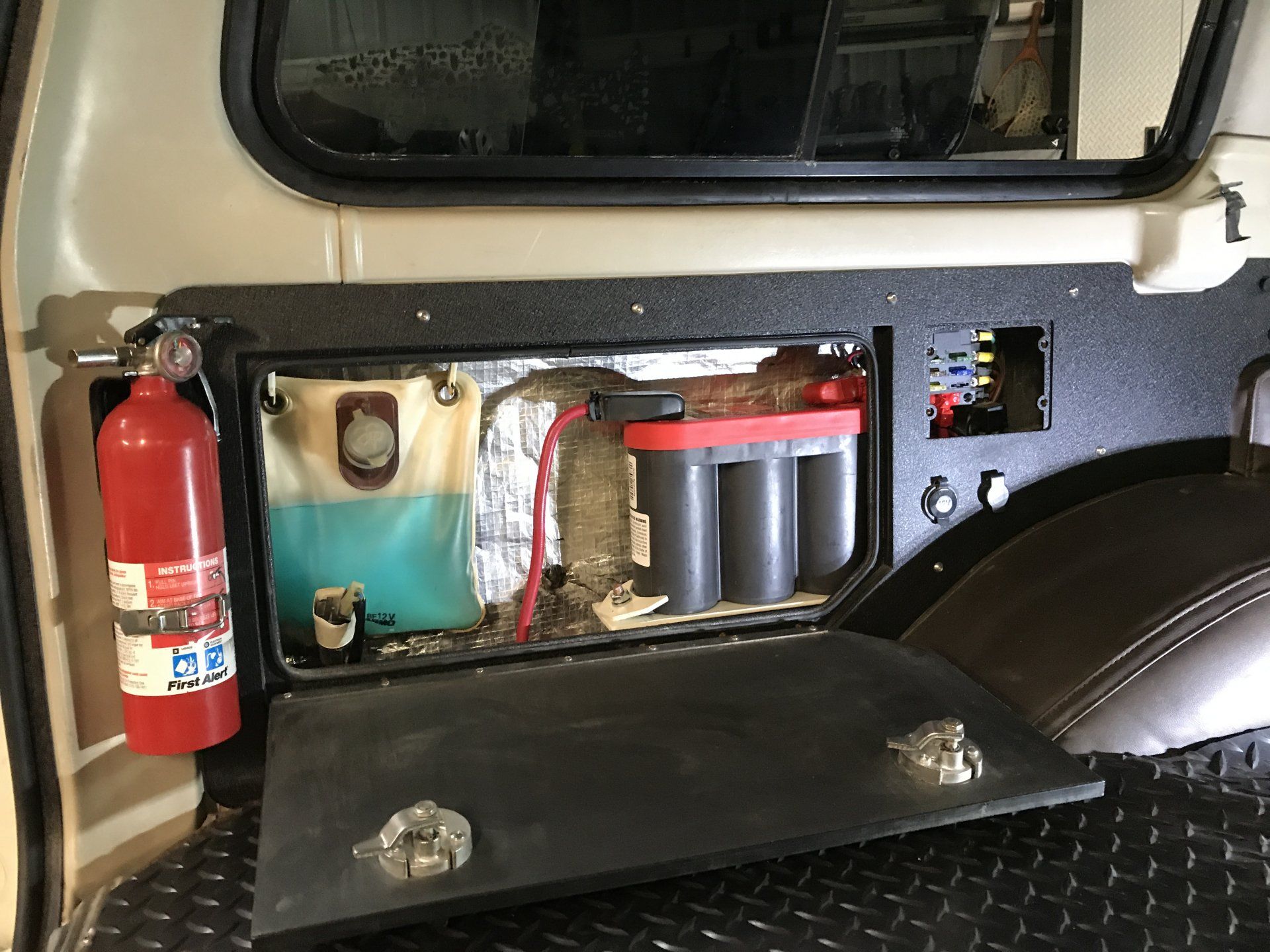

Because of the neat clean acccess for things like my auxiliary battery and the auxiliary fuse panels and plugs for portable LED lights and my fridge. I just think there are a lot of custom hot rod interiors with some very creative touches that could be brought into a cruiser

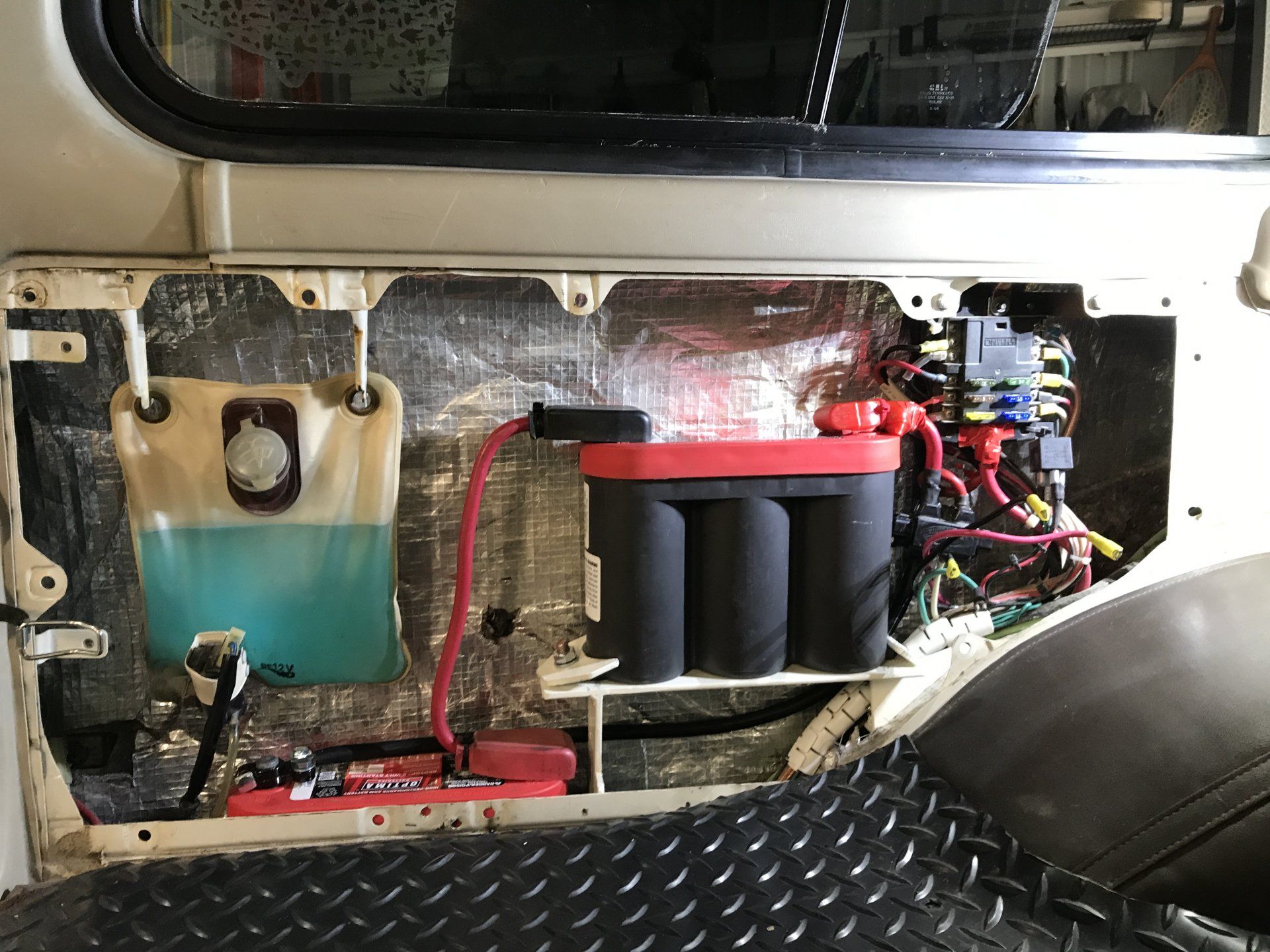

Awesome rear quarter panel! Can you give some more details on the battery, fuse panel, etc? I've been wanting to do a second battery/rear power and this makes a lot of sense! Thanks in advance!

Carp- I have a National Luna battery system to manage the two batteries. The main starting battery is placed on the drivers side under the hood (the engine bay photo above has the battery and controller placement shown) the controller has the NL fuses (80 amp) per their instructions I ran 0 cables (+ and -) inside the front inner fender then inside the frame rail on drivers side ( prevent accidental damage) then up into the rear quarter panel. These were wrapped full length in large shrink wrap and are softened at each bend to prevent insulation wear/tear and thus shorts. Installed a Blue Sea fuse block for all my Aux loads in the rear quarter panel and had Kevin at Wagongear customize my cover for the fuse panel access door. I used a Marinco (I should have bought stock in West Marine) terminal block at the Main battery to supply cleaner terminal connections. I bought a high output chevy alternator and ran a #2 cable from there to my main battery.
The Aux battery had to be two 6v optimas to fit in the confined space of the quarter panel. Wired them in series. I had to make a custom bracket to secure the two batteries ( Sorry didn't take a pic of that). They are solidly bolted in and both batteries can be removed in a simple straight forward method. I didn't really want to place these on the passenger side as that is the fuel filler/vent side of things. That said, this is a great place for an AUx battery as most my aux loads are in the back of the truck or off the rear bumper

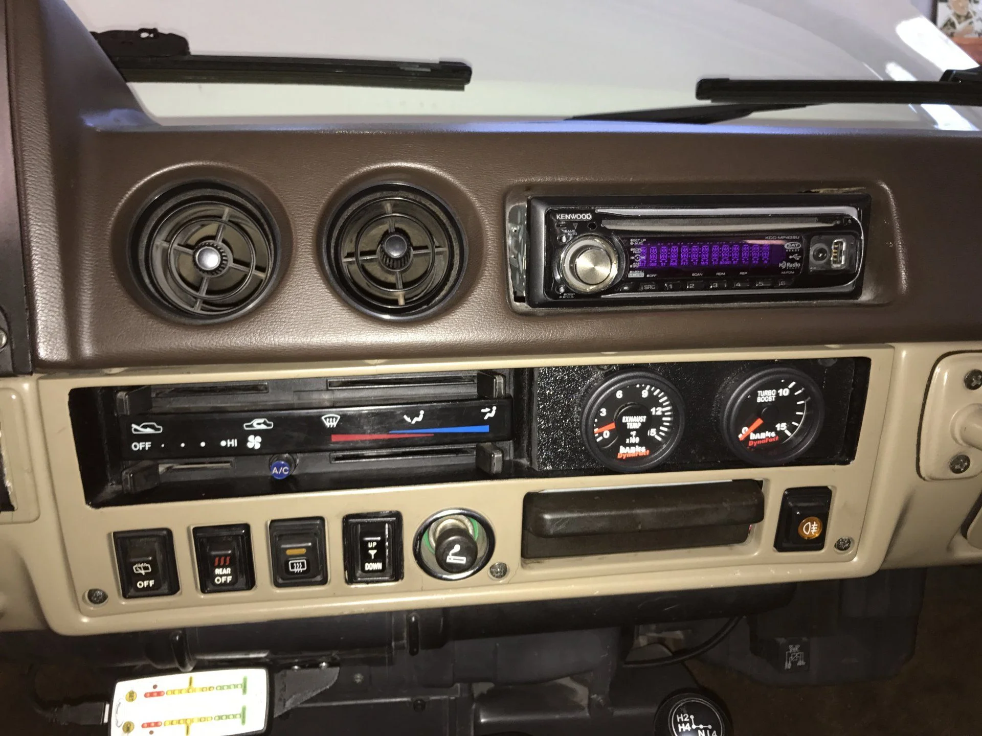

Having done terrible things to the dash of an fj55, just make your changes judiciously. I wholeheartedly support modernization; just offering up a thought that, based on those pics, is not foreign to you design approach. Aka: :popcorn:, carry on, good sir, carry on...

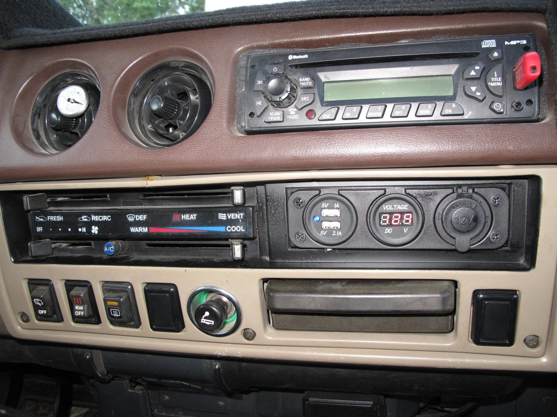

Nothing super special, just a slight twist on the original fabric and electronics.
