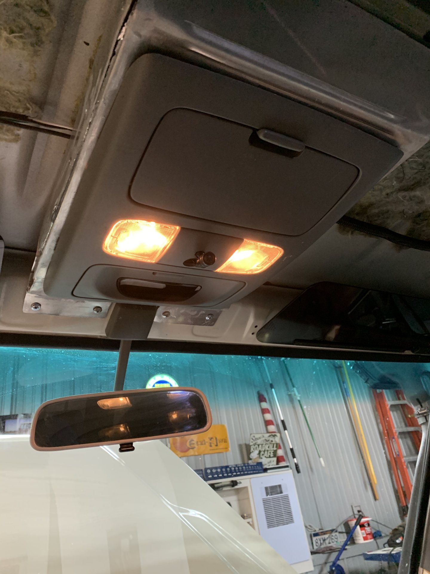

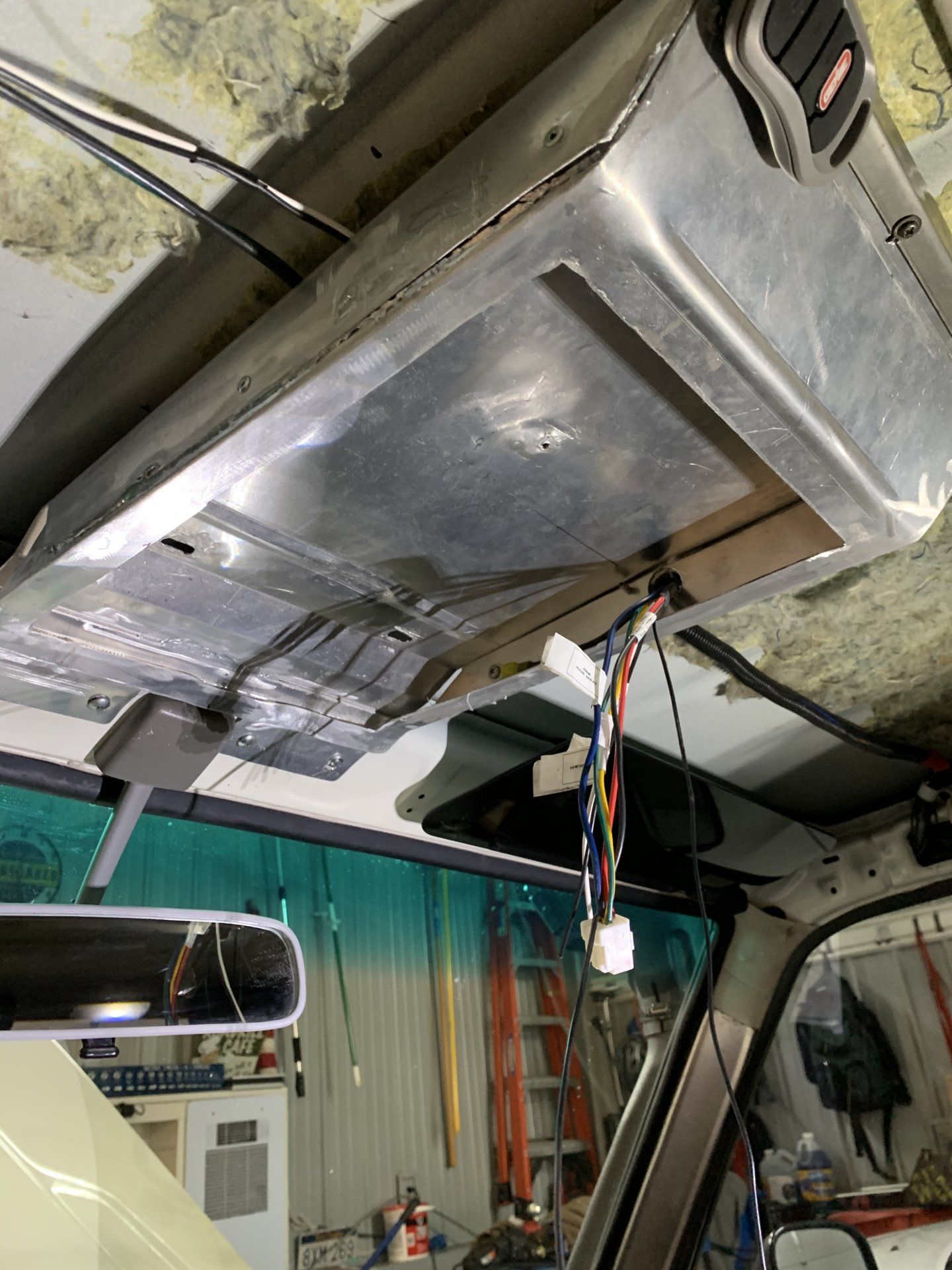

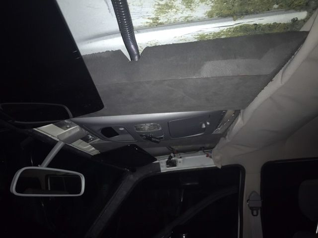

Wire up the overhead console for both lights and the Ambient Temperature and compass function. Just need to plug it ALL in and turn the ignition on
BIG Mad Scientist Laugh- Brahahahahah!!!!!!!

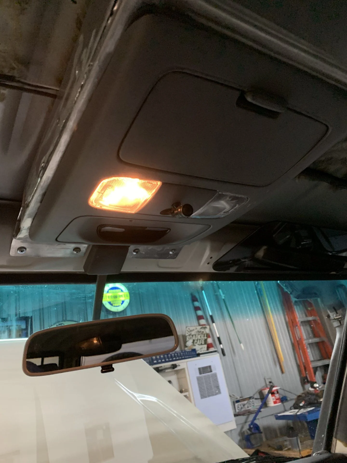

The two lights come on with the door switches on the Dome Light circuit, and
With the door closed, each light can be pushed for on/off individually and.....
Ignition on brings up the ambient temp and the compass.

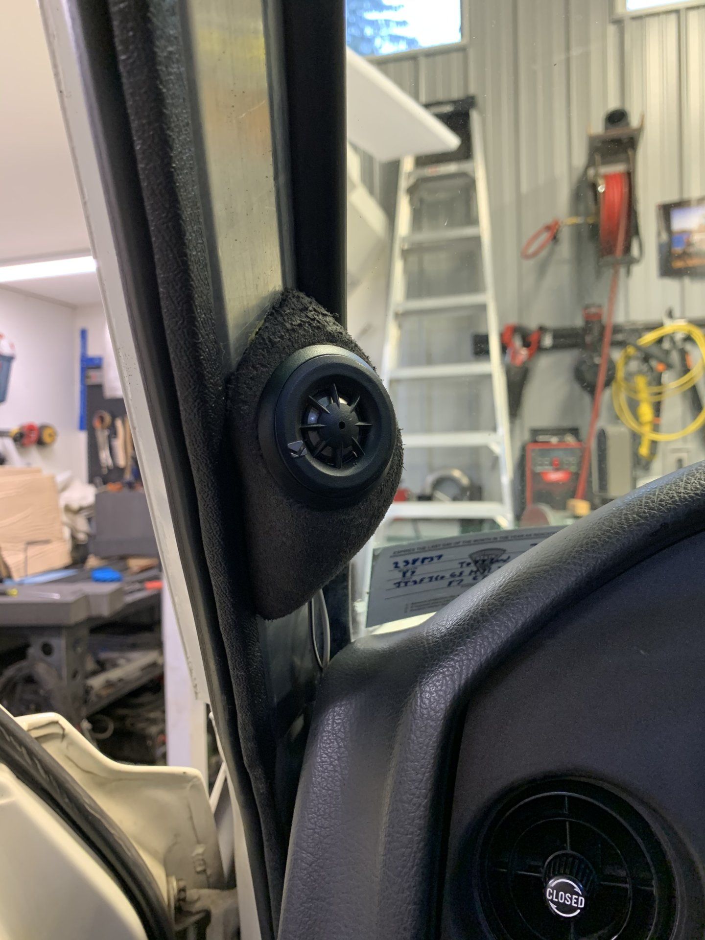

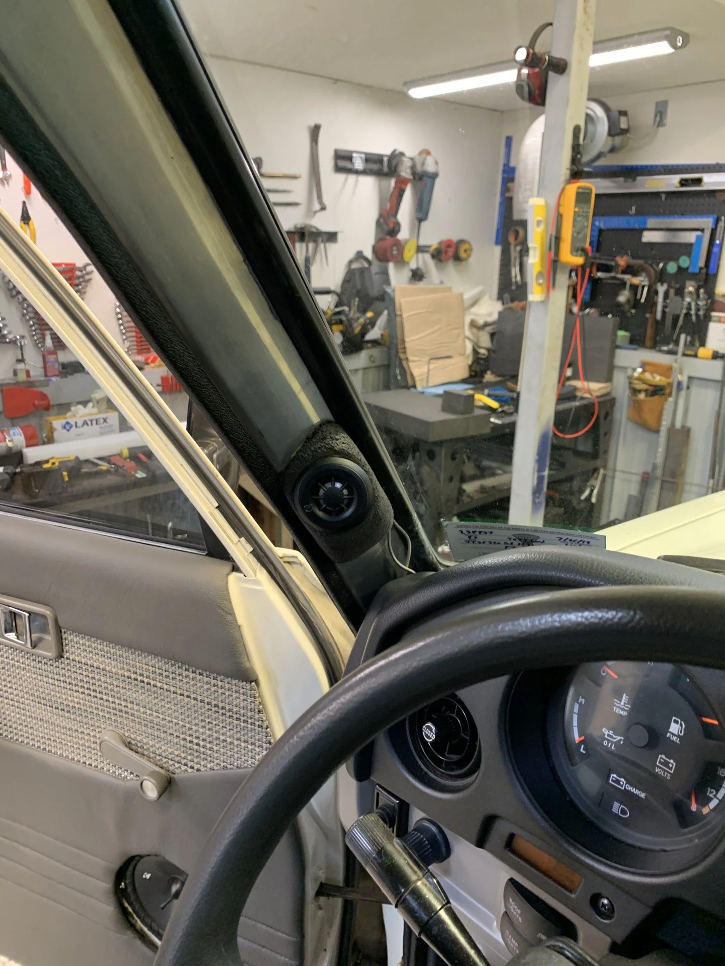

Next I need to turn to dabbing the A pillar covers to integrate the tweeters before the whole truck goes to the upholsterer for a cool custom headliner

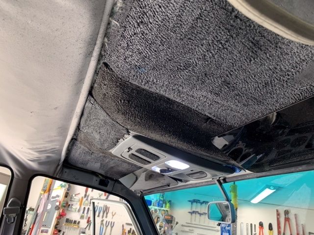

The Mini-cell foam arrives tomorrow. I’ll cut and shape that around the console to provide smooth functional contours around the console and the visors across the whole width of the truck’s interior roof. The upholstere can tack the new headliner to get an integrated finished look and for sound and thermal insulation.

Tweeter pods on custom formed A pillar covers using minced foam and a lot of hand shaping with a sureform
Looks great, could you please share more info on that foamy stuff ?? :cheers:
Plastic weavy stuff is from Chiliwhich (manufacturer of place mats/table runners } I saw it when my wife bought them and thought it was a great material then saw it used in the Icon FJ62 interior. Upholster complained about how stiff it is.
Foamy Stuff is Minicell foam- great stuff. Kayakers use this for knee pads and back rests. It’s semirigid and is very formable using hand saws and sureforms and sanders. I am currently placing blocks of minicell foam around the new overhead console and shaping it for the base for the new head liner
These minicell blocks will get glue in and glued together after fitting and rough shaping. I’ll remove the seats to avoid the mess and then I’ll shape and sand to get a multi curve shape that molds the new overhead console in and provides custom close fitting recesses for the Rosen sun visors. The new headliner will either glue or stretch over the whole new front configuration
