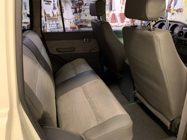

Which seat covers faded? I was looking at some of there's.
The front seats (SOR covers) faded pretty badly. the rear (which is folded down most of the time) are still good. These covers are being ripped apart by the upholsterer as a pattern for the rear seat

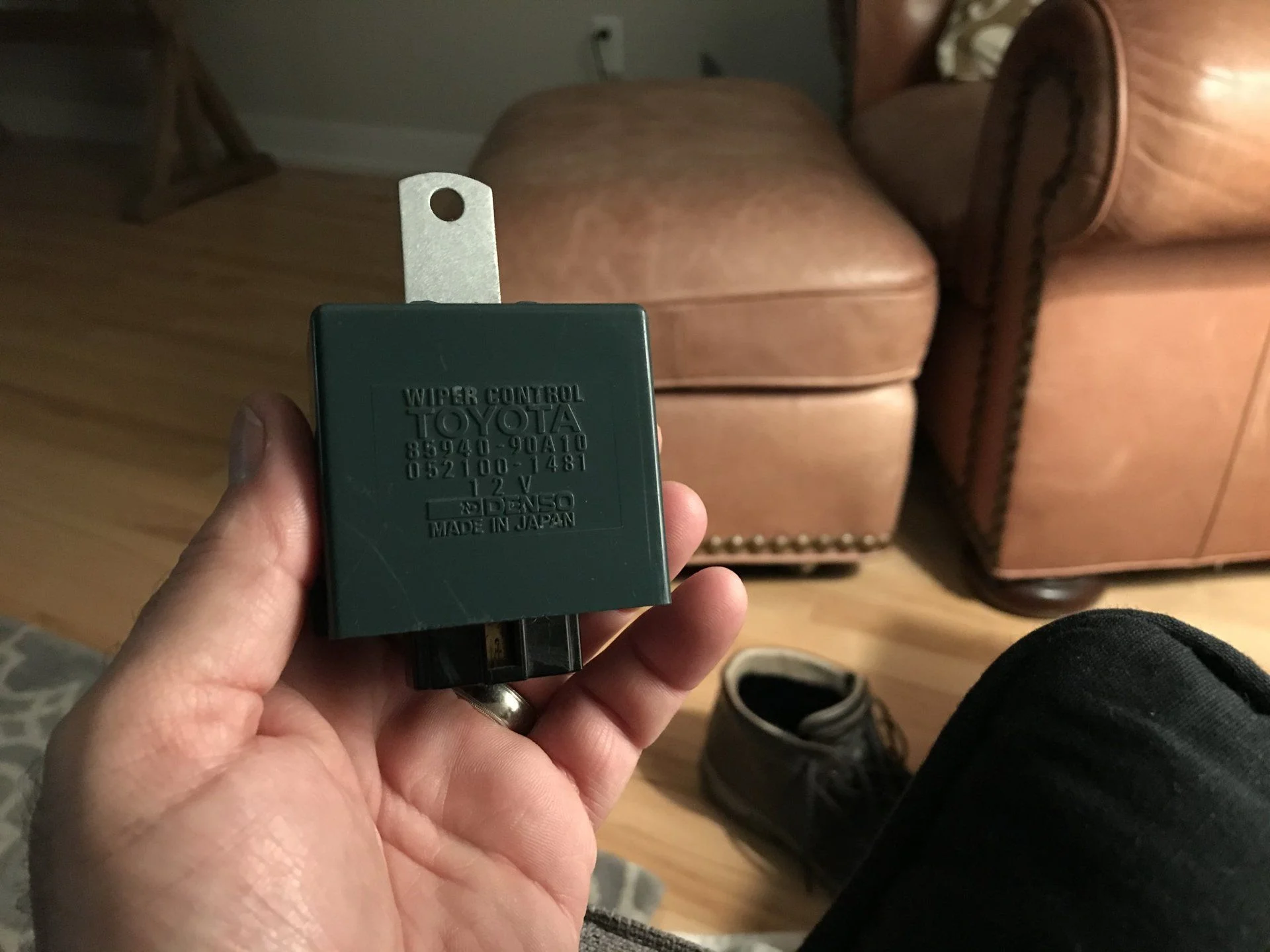

Any further information on the relay, or the process used to make the rear wiper intermittent?
YES! See this separate post
This took a bit to figure out but once one has the wiring changes, its a pretty easy mod.

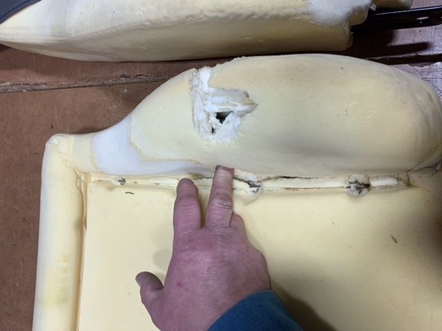

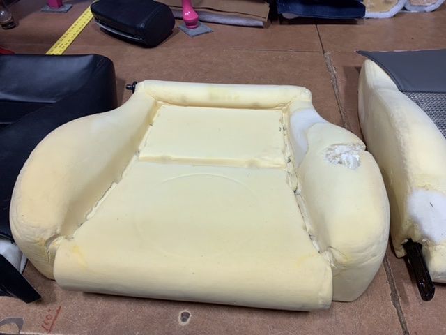

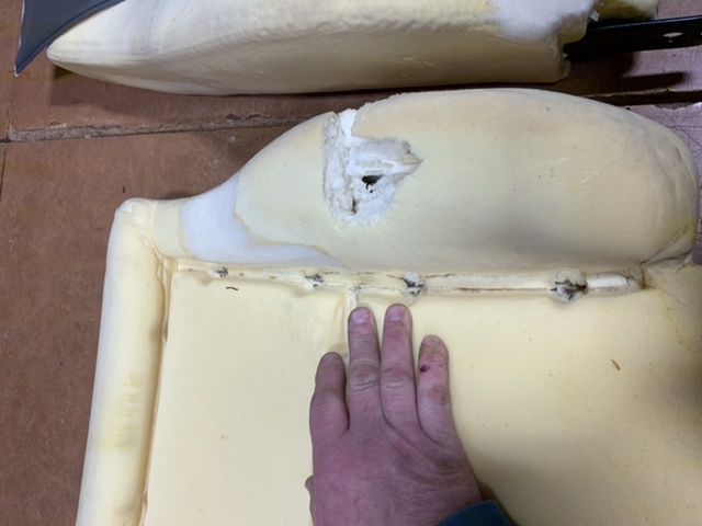

Alrighty - I bought the Procar seats because I liked the way they fit and the bolsters are very comfy and reforming- but
I am pretty disappointed in the durability of these seats - only 1 year old seats. The upholsterer is rebuilding the seats and re-enforcing the bolsters with a better foam and will wrap the springs. I would not recommend these seats. I wish I went at the BMW 3-Series seats

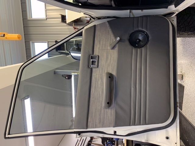

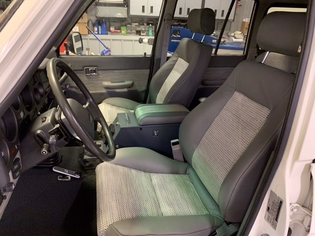

However, the upholsterer did make some great progress on the seats and the door cards

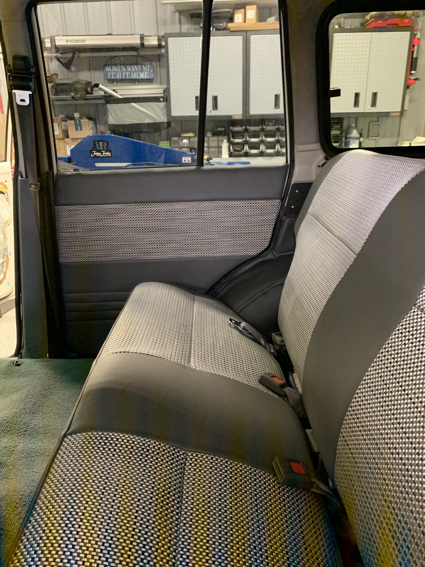

still need to fit and trim . And the front seats to fit but this is getting to look pretty nice. The Chiliwhich material with he leather is a great combo. the plastic weave breathes really well and is very durable.
It’s a local upholstery shop ((Smack, Jack & Whack). The whole thing is going to come in around $3k material and labor - door cards, all seats , A and B pillar covers and brake boot

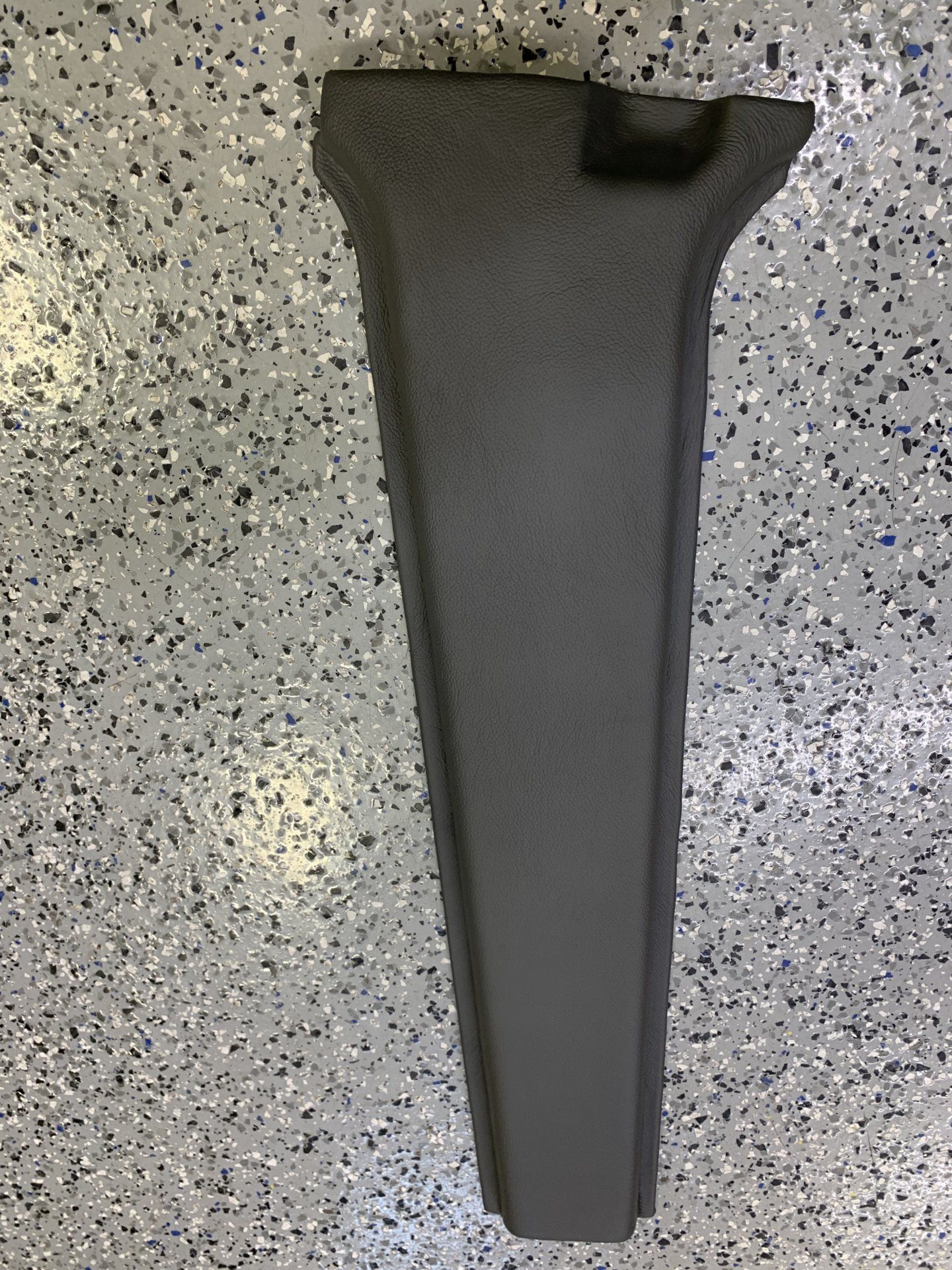

The front seats are being completed and I have all the final fitting to do yet. The B pillar cover turned out very nice

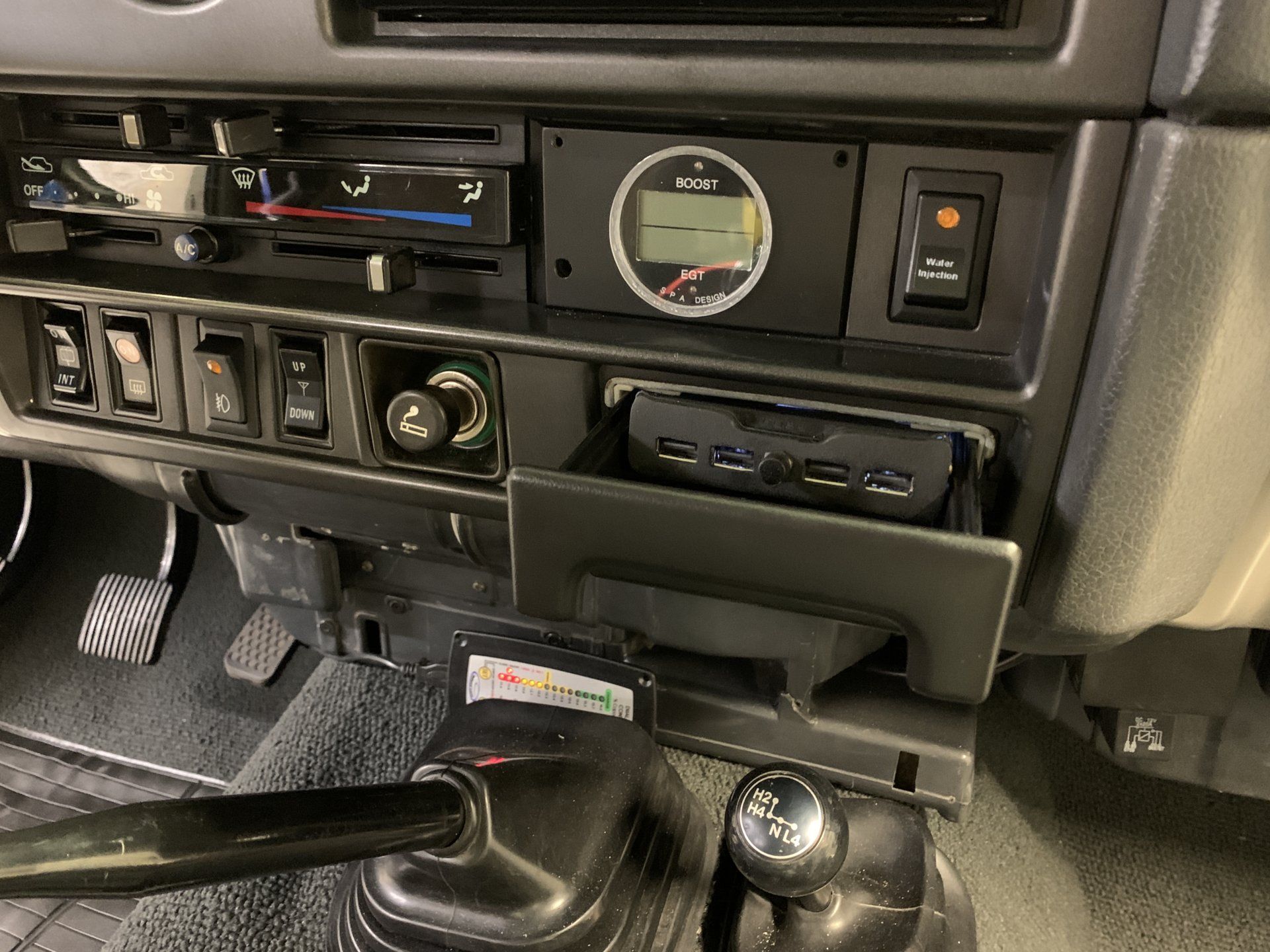

I also finished the ashtray USB power conversion too

The ‘62 dash was a great addition. I tried to upgrade the 60 capabilities to the 62 functionality as much as possible like converting the 60’s rear wiper into a 62 intermittent wiper ( its always been a little peeve of mine that the 60 rear wiper was “all on” or “all off”). The clock is something of redundant feature as the Kenwood -“everything in a double din” stereos certainly displays the time. But the original LCD clock preserves the style and original functionality .
I used the original 62 engine/seat belt warning lights and reprinted them with “Water in Fuel”, “Filter DP” (change fuel filter indicator), “Compressor”, and the Water Meth injection status LED. I converted the “Choke” Light to now read “Glow Plugs”. The 4WD light is now pared with a “Diff Lock” light - all within the stock 62 dash. These were the hard things to really integrate in the 60 dash.

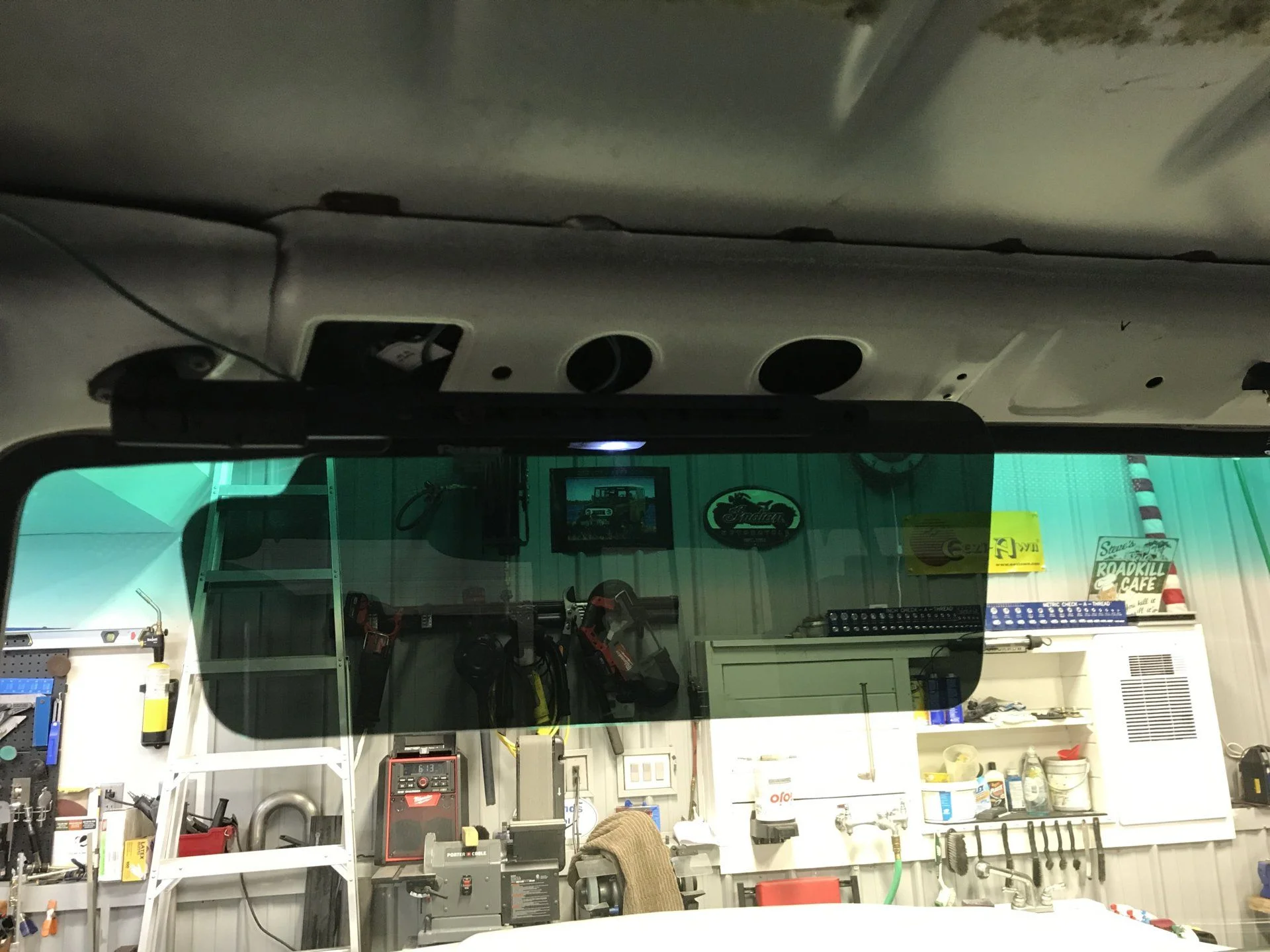

Also scored on these very awesome Rosen Sunvisors
They extend and are infinitely adjustable. They have been producing these for 40’s for awhile

Looking great. Those B-Pillar covers especially came out terrific looking. Did your shop just cover the plastic with the vinyl or leather? Or did they remake the entire thing?
