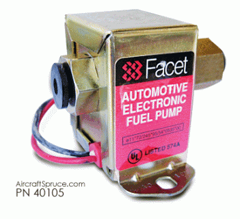

The pump that comes with the LRA is this style of micro electric pump. Can't remember the brand, but it was a legit made in USA pump.
And about the size of a D battery, as Tony mentioned. My pump is a little fatter, I think...but not big. Nice thing about the LRA is the pump is external and in a spot that’s easy to access. Thinking replacing the pump would be pretty straight forward.
Interesting. I'm almost positive LRA tanks used to come with a solid state pump. Maybe they changed it up?
If that's the case, the one I posted is essentially the same as the one supplied.
Looks like it is a solid state pump.
Facet®/Purolator® Posi-Flo® Solid State Electronic Fuel Pump Kit
I thought they came with square, solid state, pumps?
Cole’s looked similar to my pump (below), but maybe smaller diameter:
Edit: I could swear Cole‘s looked more like mine that the one in you posted. Hmmm...
Cole literally had the first one they did on a 200 here. Wonder if they switched since then?
Weird. The pump I had pictured was like this but with a different name/sticker on the side. I'm almost positive they changed the pump then. Which is good. Which also means forget everything I said above as that pump is pretty much the same as the one I linked. :D
I believe it look used to look like this:
