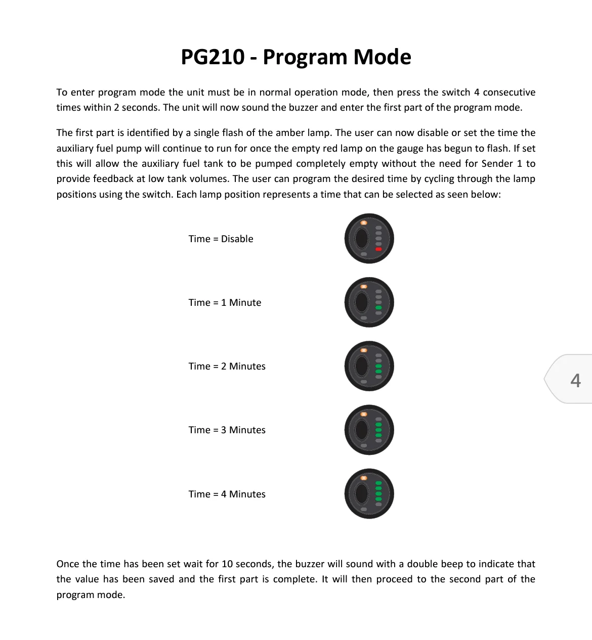

For programming the after run, here is a screen shot from the manual. It only takes a minute or so. Once you select your after run time, just leave it alone and it will beep a few times and return to normal running mode.
You can program this switch to do all sorts of stuff including turning on and off automatically based on the level
of the main tank.
Could you say where you are seeing this?
It isn’t in my manual or one I just found on-line?
But it would be wonderful if I could set a timer on the pump! Or if I could base anything off of the main tank.
Until recently when I forgot to do so, I had always set a timer on my phone to remind me to turn off the pump, but it would be wonderful if I could just get it to run in 5 or 10 minute intervals.

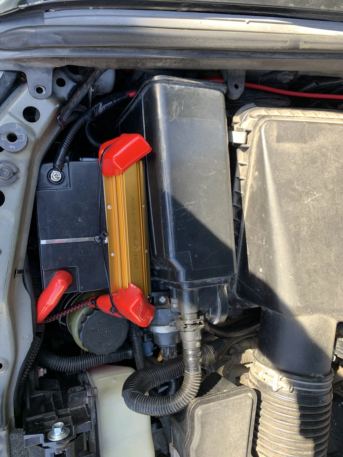

Both @grinchy and I have relocated our charcoal canisters to the engine bay. However, as long as you have space in the original location above the aux fuel tank, I recommend to leave it there. Relocating to the front is a lot more involved than dropping the aux tank.
As was previously mentioned, dropping an aux tank to replace the canister really ends up being less of a problem than it initially feels like, but only as long as you're already familiar with how everything was installed. Using a shop (or yourself) that has done the install before is the best idea when you need to drop the tank and replace the canister.

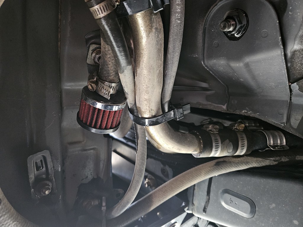

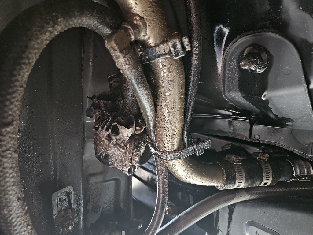

I've had my 12.5 tank for a little over a year now and just experienced my first minor issue, which is 100% my fault. My wife went to fill up and said neither tank would take more than a few gallons, even though both were empty. I also got my first CEL, something about insufficient "evaporative device orifice flow." We just had some snow and the 200 was parked outside overnight so I had a feeling it was the vent filter. I had not changed/cleaned it since install, but still had no problems filling either tank until this incident. Pulled the cover and saw this...
The slush/spray from the snow on the road had frozen around the filter sock, which was fairly caked with mud and dust. After a rinse and reinstall, both tanks filled fine. I reset the CEL and no codes since. It takes all of 5 minutes to pull and rinse this filter, so I should probably just do it with every oil change, or after extended wheeling in dusty conditions. I don't think the prefilter did much as the main filter was still absolutely caked, so I am going to try not running the prefilter.
After my original install, I noted that I cracked the little charcoal filter and decided not to run it. Someone asked for a long term follow up and I have not had any issues, other than the above. Probably safe to say it is not necessary.

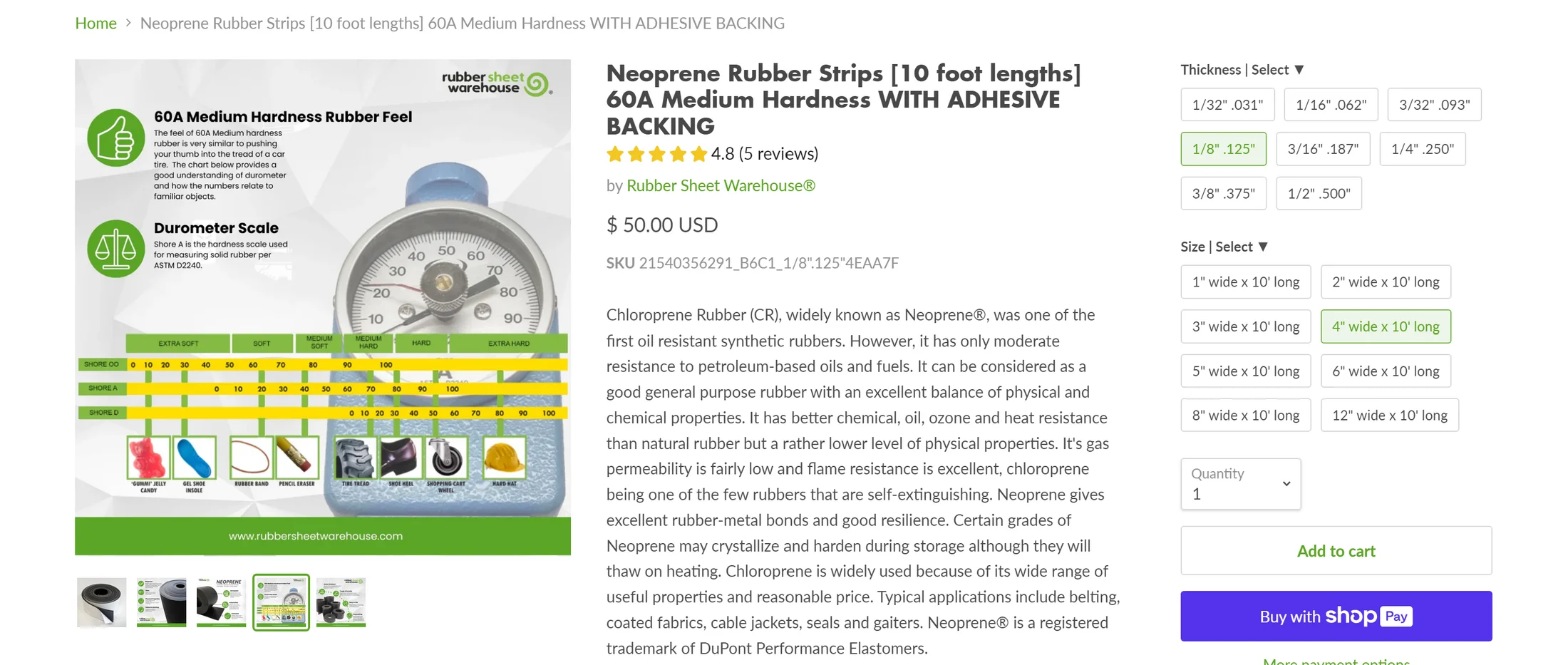

anyone know what size this is supposed to be?
The link doesnt go straight to it anymore and the part number isn't recognized on the web site. I am guessing it is the strips with adhesive backing in this link, just need to know the size
Neoprene Rubber Strips [10 foot lengths] 60A Medium Hardness WITH ADHESIVE BACKING1/2" .500" / 3" wide x 10' long - https://rubbersheetwarehouse.com/products/neoprene-rubber-strips-60a-medium-hardness-with-adhesive-backing?variant=21540360387

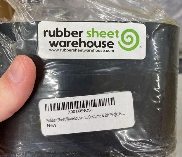

Based on Eric's advice, here is what I used (from my receipt in 2020):
  • 1 x Neoprene Rubber Strips 60A Medium Hardness - 1/8" .125" / 4" wide x 10' long for $17.00 each
I didn't purchase longer bolts, it is all pretty tight...
Yeah, I am going with the adhesive. Here is highlighted what I am ordering. Thanks again!
