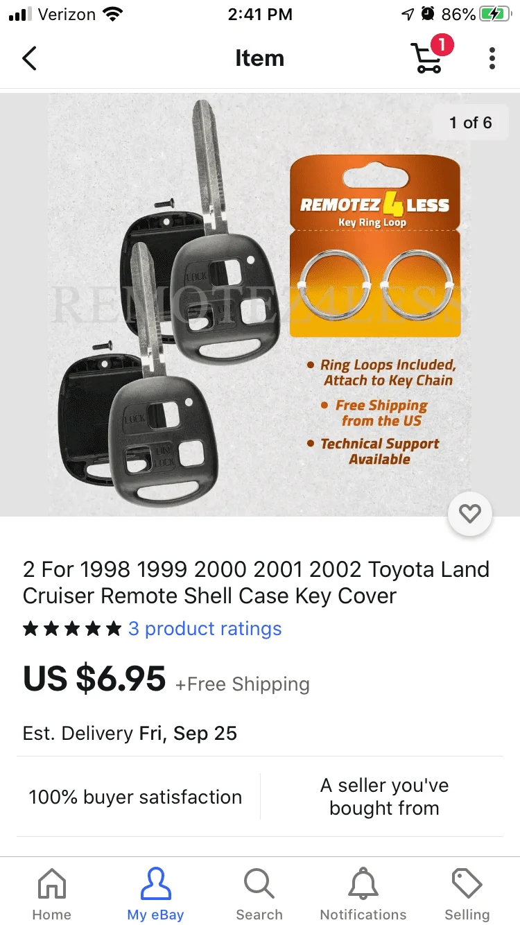

I've got many keys . . . or parts of keys . . . the way its designed, they fail where the metal meets the plastic after a bit. I've always ordered the blank keys which will hold the remote (still have the 2 remotes that came with the truck when I bought it in '04) through Ebay or the like and a local toyota dealer cuts the keys for me. Is the chip in not part of the remote portion?
I had this issue as well. Cranks and all seems good by wont turn over. Sometimes there is nothing wriong with the car. It is a LC100 ya know! My issue was with the key fob. Either the battery is dead, but more likely the chip inside the fob has gone bad. Dont ask me how or why??? Try a different key if you have one or else get a new key at Home depot. Cost about $80 just for the chip key, no remote. I now carry 2 keys with me at all times. A month ago the one key didntt workj and the other did. Usually they both work. Frustrating as you can imagine.
i have many keys … or parts of keys … with the ways it’s designed it like to fail around the screw that holds the cover over the remote. I actually just bought 2 more but haven’t had them cut yet. I still have the remote components for the 2 keys that came with it when I bought in ‘04 and just install them in the new case - have experienced this with both keys. So your saying the chip is part of the remote, but can get a key with just a chip that works and just not have a remote?

Stachecki - I found the key with programmable fob for $28 on remotesremotes.com so I've ordered one and we'll see what happens . . . if nothing else I'll have a third key/remote.

Well it doesn't seem to be the key - got the new key with remote cut and programmed it. It will start the LC and open the doors, but I still experience the loooong crank periodically. My mind keeps going to it being a fuel issue - maybe what Medtro described he experienced or injectors leaking and flooding it out. Guess I need to find time to leave at a shop so they can have a fuel pressure gauge hooked up while the start it periodically - and pray that it acts up while they have it - buy one to have or see if Autozone has a loaner. How difficult is it? Having flashbacks of shadetree mechanic trying to help with with an old S-10 Blazer when I was in high school and him pulling the fuel line and starting a fire when gas fell on the hot engine . . . main wiring harness and a couple of hoses later . . .
