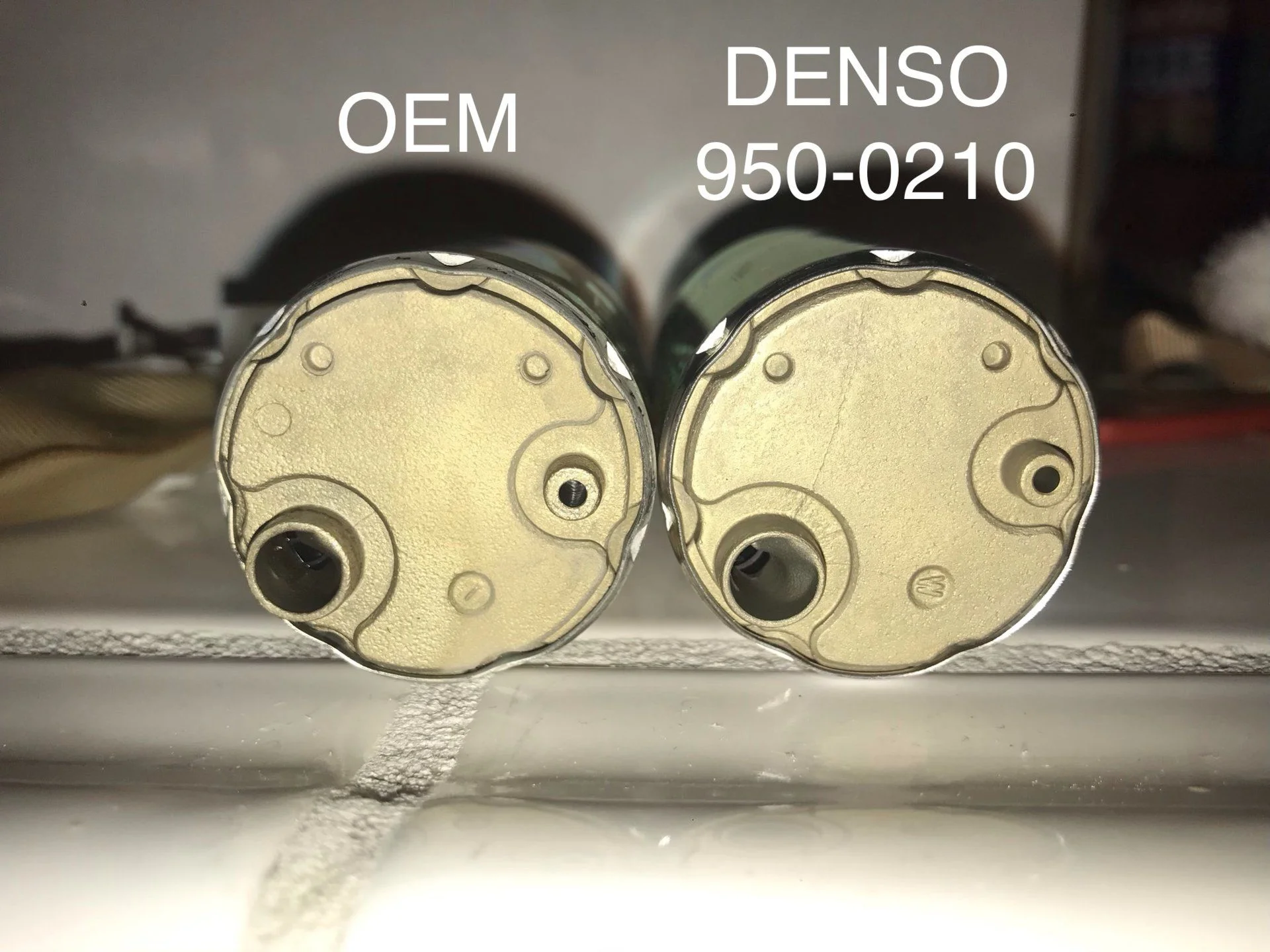

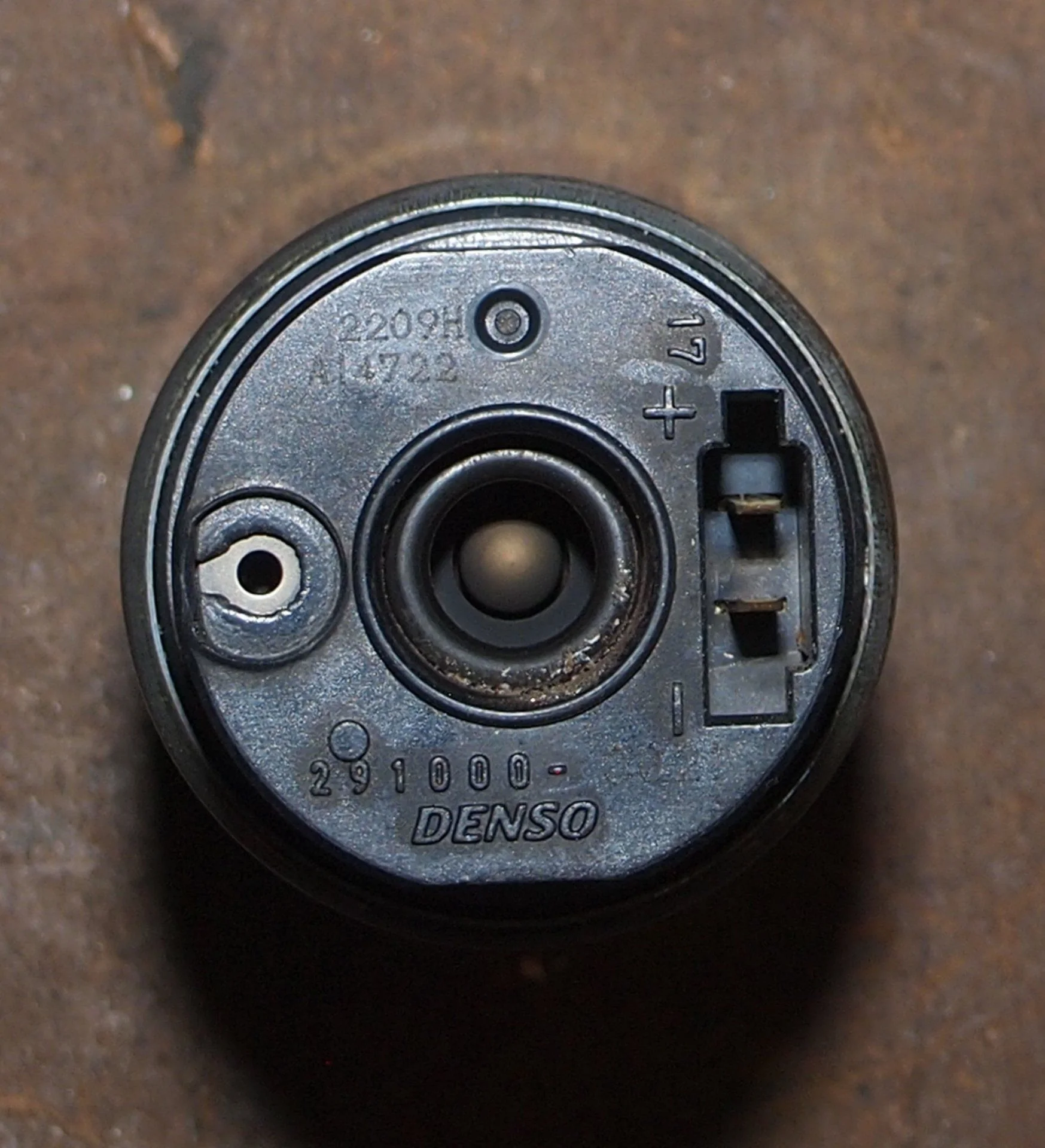

You have the wrong fuel pump. The taller pump is for 98-05.
In 2006 Toyota changed pumps in the 100 series with the VVT engine ship to the USA. Note you must insert the new O-ring.
OLD OEM factory pump
Thank you, 2001LC. I’m glad you have an eye for this. I was a bit frustrated yesterday trying to get it to fit and search the internet for a matching plug for the pump. I wouldn’t have expected NAPA to send the wrong pump.
Is the black shroud around the fuel pump in the photo stock? Or is that a completely different pump?
If you buy and use the 950-0210 fuel pump I posted a picture of. Than you'll reuse the cage (black shroud) and sock from your old fuel pump assembly. You'll only use the new fuel pump and O-ring, throw out the new sock.
The fuel pump came in yesterday. When I initially bought it off amazon, it said it wasnt for my 06 LC, so I was a bit worried. Once I pulled everything apart, it was An exact fit.
