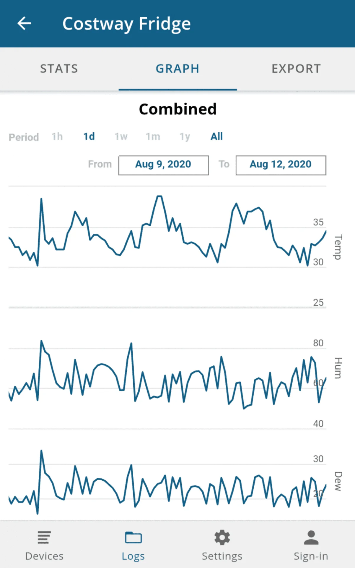

During the last year, I always set the temperature somewhere around 34 degrees. Items on the sides or bottom of the fridge would tend to get frosty after a few days. This year I stuck a Blue Tempo Disc wireless thermometer at the top of the wire rack and set the fridge to 36 degrees. It now takes almost a week before something touching the side starts to get frosty. Below is a screen shot of the fridges behavior, only about 30% full, in the back of my Land Cruiser:
