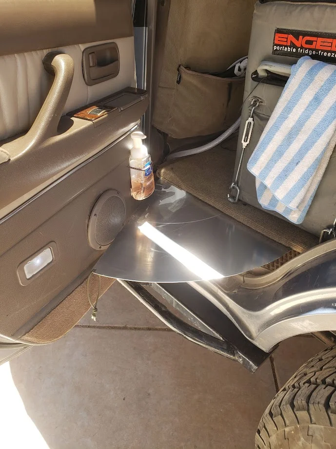

Looks like you have an 80. My Engel has been living in the 2nd row behind the driver for the last 18 years or so. Not sure if this is an option for you, but here are some pics. Lifting that thing empty out of that space is awkward, and I can't imagine doing the same thing with a full fridge!
That Swing out Table 😍
We have 2 Boys so we use Backseat, but Appreciate the Idea.
