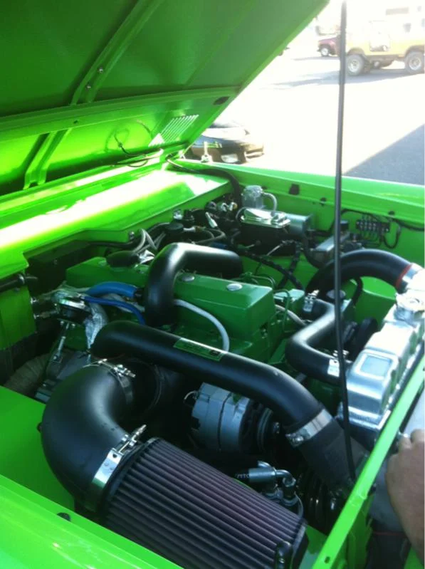

Here's one some of you fellow diesel enthusiasts might appreciate. Belongs to a very good friend of mine. He's pretty much a diesel guru. John Deere version of the 4BT with his home-brew twin turbos. It's counterbalanced and good for 3200RPM so it's actually got a useable powerband, unlike the "normal" 4BTs.
Yes, I like the truck. But I'd never want that engine in any of my vehicles.
:lol:
Classic dude.
Classic..... and correct.....
