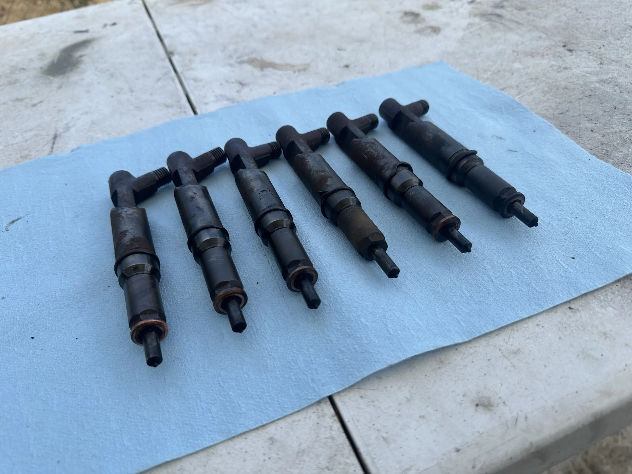

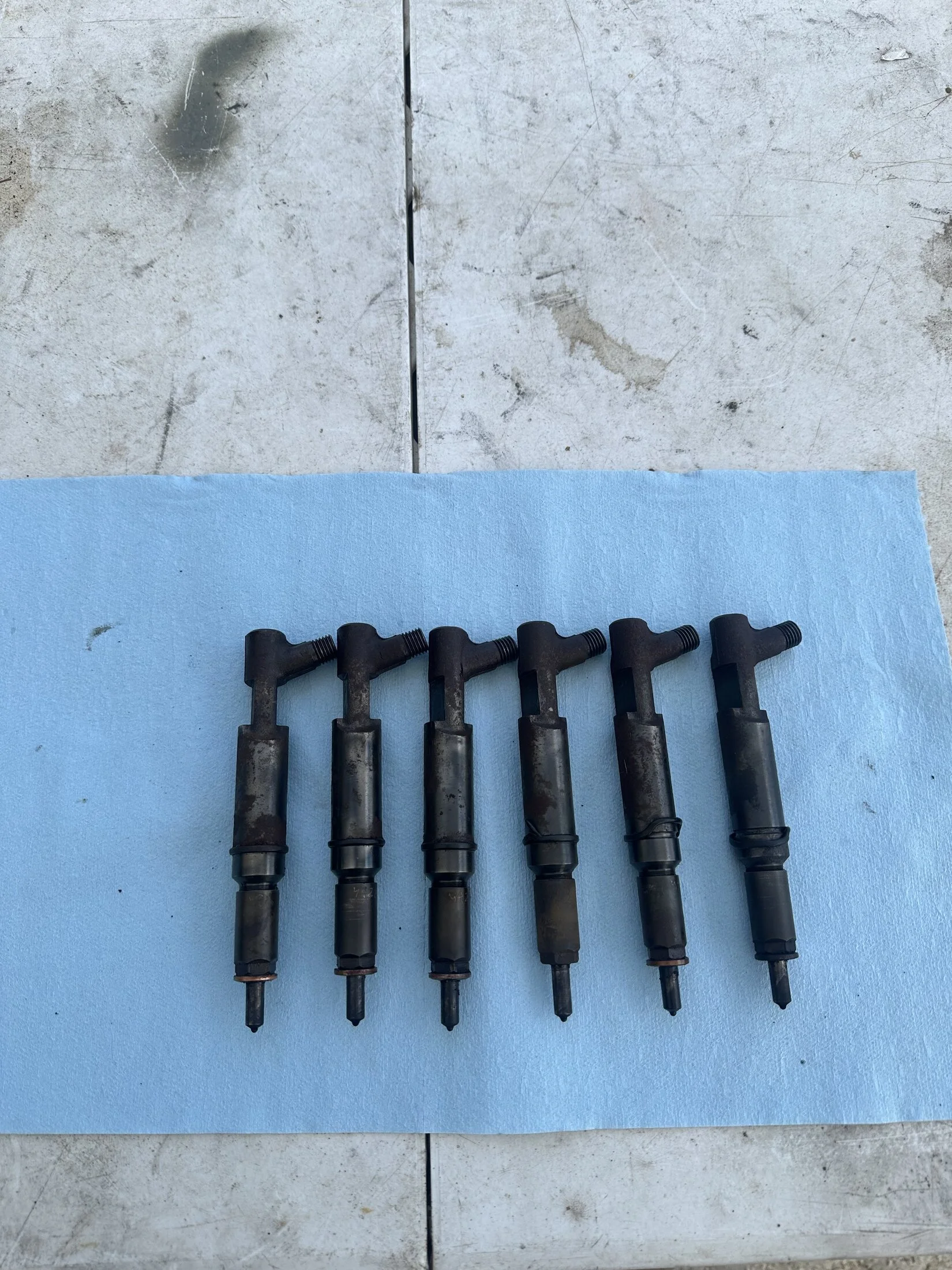

I've been busy with work but finally got around to working on it. Cant get that damn solenoid off, already ordered a new one. Considering ordering a new pump and just getting that purchase over with for piece of mind from Gturbo AUS. I decided to do a compression test before pulling the injectors. I used a tester from Harbor freight (Maddox) but due too it being a right angle, it was way to difficult to get it on with out removing the intake so i only got it around cylinder 1 and 5. I ordered a cheap no brand off amazon to redo all the cylinders and these were the numbers:
1. 480, (HF Tester 525)
2. 480
3. 460
4. 480
5. 480, (HF Tester 525)
6. 480
+/- 2-4 psi
Injectors are being sent to DFIS in Portland, Oregon to be service. Also here are how the injectors look. (1 to 6, left to right)

The FSM will explain how to set the timing when you reassemble the engine. I assume the camshaft and IP pulleys moved together, in which case there is no chance of any collision as the IP is hard-linked to the crank via timing gears. Even if the camshaft rocks one way or another passively, there is no way it will damage the pistons/valves. Just follow the FSM religiously when reassembling the engine.
