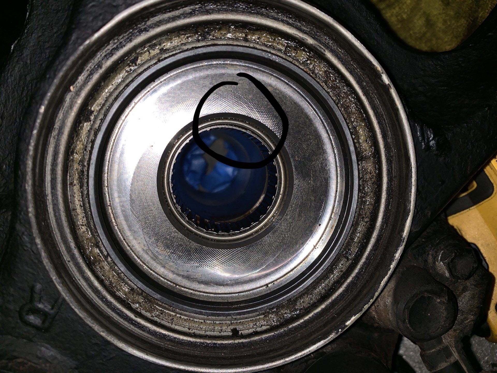

Also have these marks from the splines on this ring. Does that look like a one time impact perhaps or from on going contact. I've read about having improper snap ring gap causing scoring, is that what this is? It's only on one spindle.

Brass axle bushing is notched from teeth on axle. A few ways this could of happen, non good. Since you pulled out consider replacing it and the needle bearings.

I believe I’ve found the cause of the marks on the axle bushing. If you look in the circle, the bearing is a little deformed. Could the cause of this be snap ring gap?
