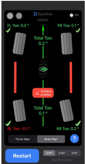

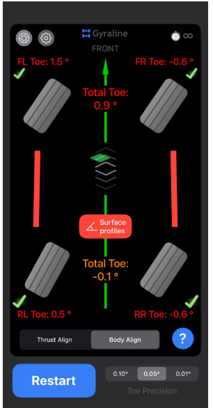

If you're going to need more than one alignment and have an iPhone you might want to consider this:
Below are the screenshots from my buddies pickup. First is after the specialty shop's alignment (which was causing significant feathering on his new Ridge Grapplers). And the second is after performing the alignment himself using the tool.
The spec wanted total in of 0.2 degrees and he was able to get it spot on.
View attachment 3850694 View attachment 3850695

If that really works, at that price, I want one.
