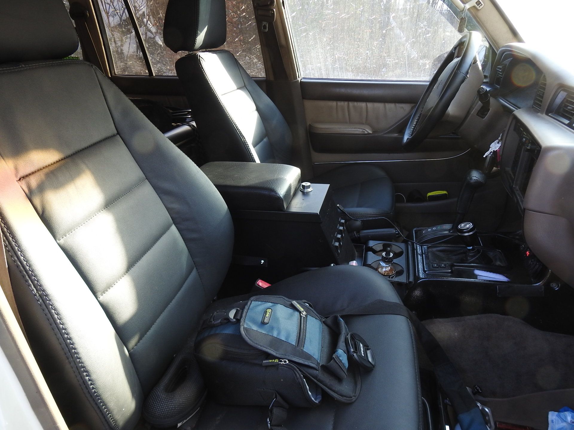

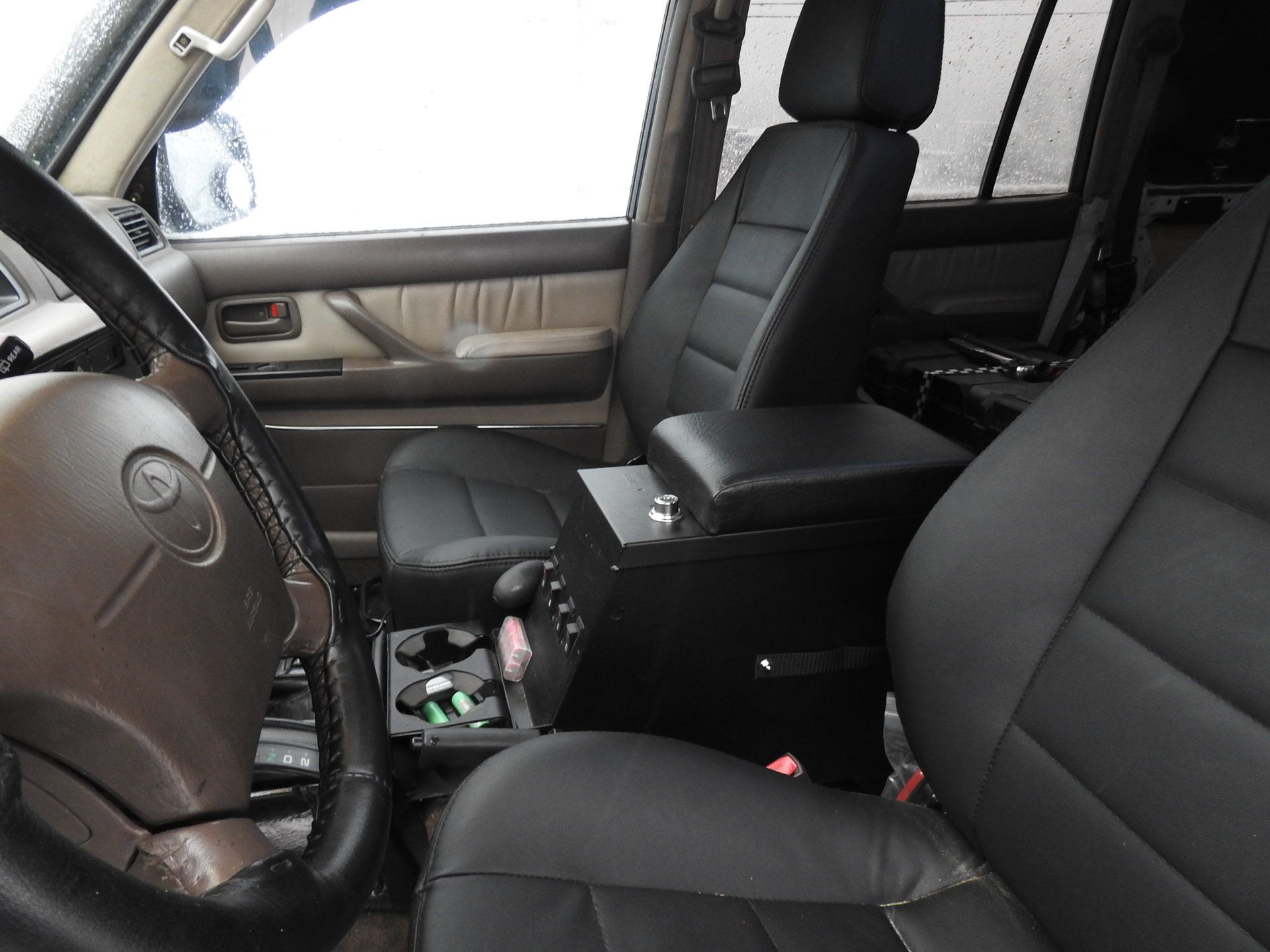

Land Rover Disco Seats
20160830_120018-jpg.1314010
what seats can I put in my Landcruiser

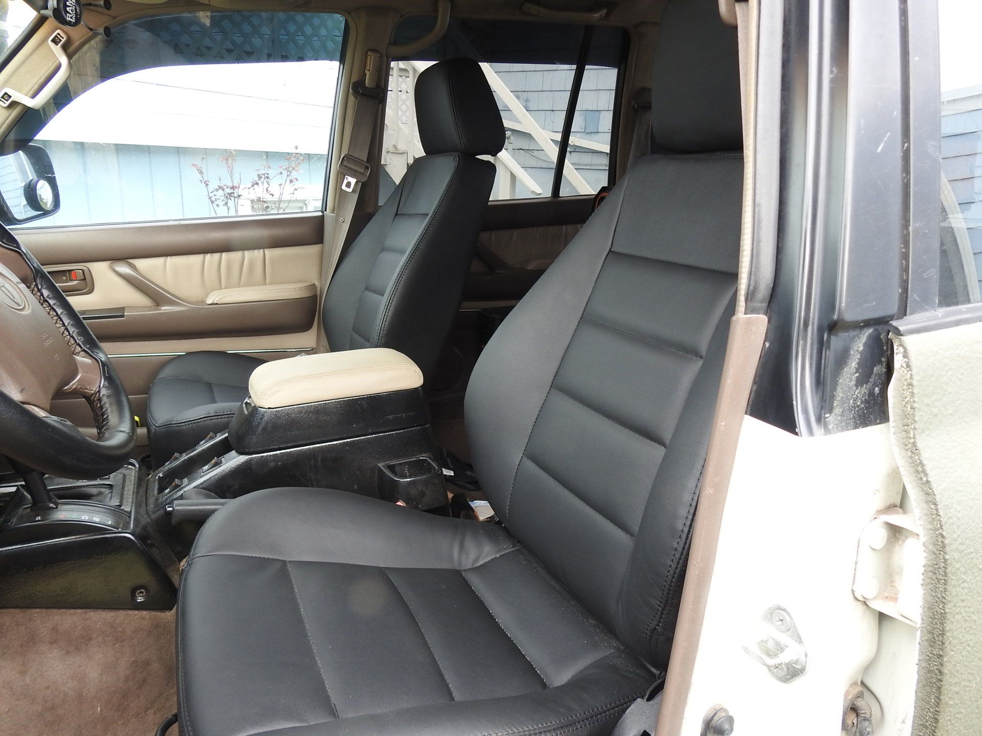

BMW E46 Seats
Installing BMW E46 Front Seats

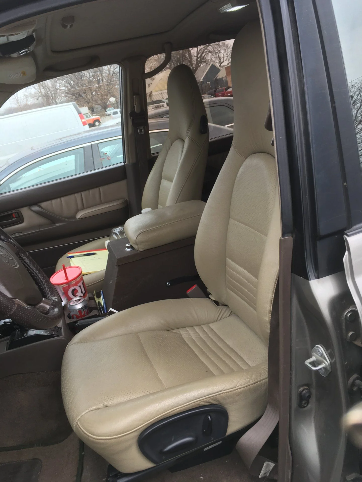

Porsche Boxster Seat
imageuploadedbyih8mud-forum1438109270-646309-jpg.1113087
BMW E90 Seats
resized_20171220_142631-jpeg.1595184

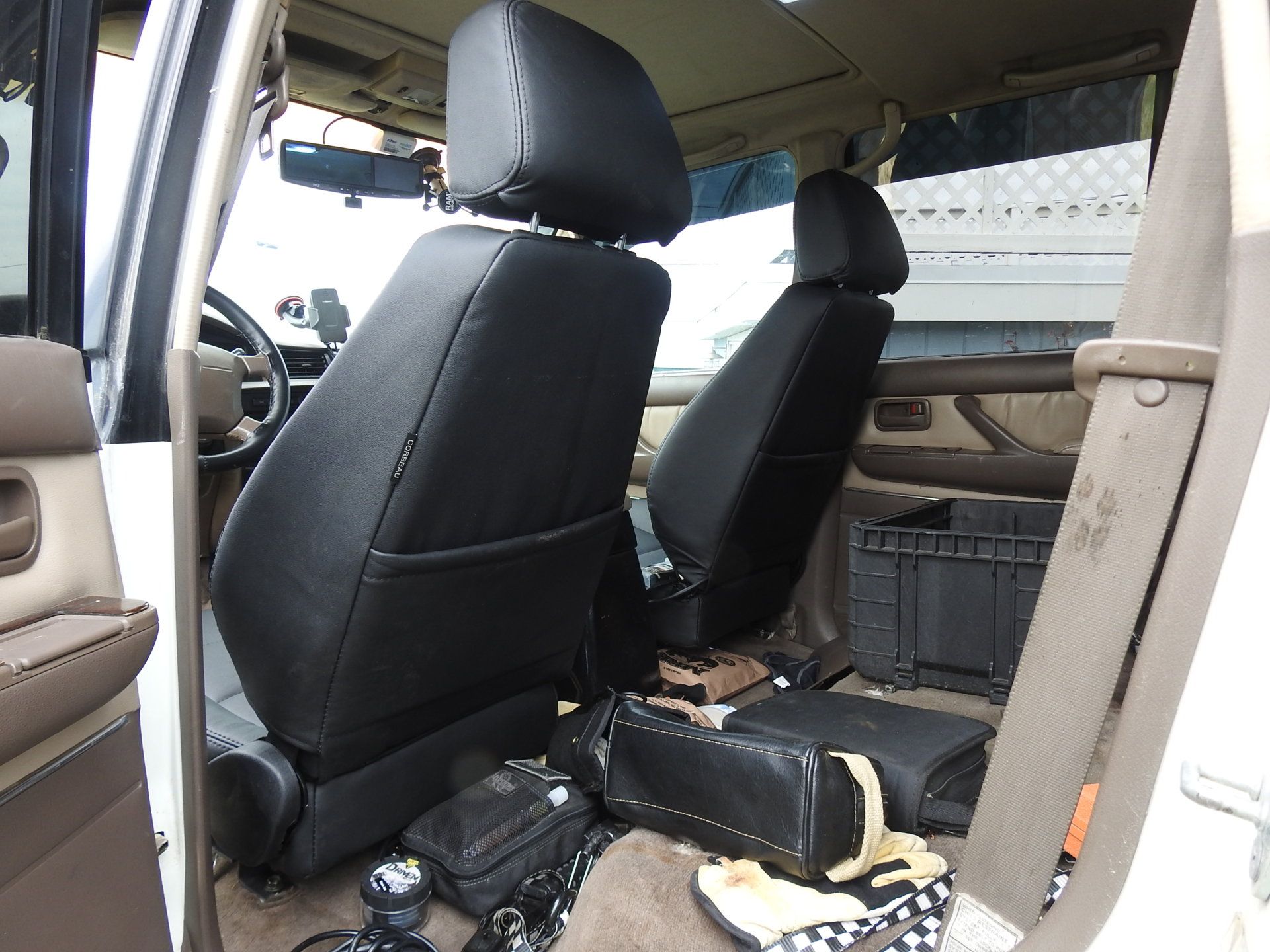

Subaru WRX Seats
img_1762-jpg.1043912
how to install WRX seats / sort of !!
Land Rover Disco II Seats
20160515_193143-jpg.1259040
Any idea what year disco seat??
Found some pictures of the porsche seats out of a Boxster after I recovered them.
