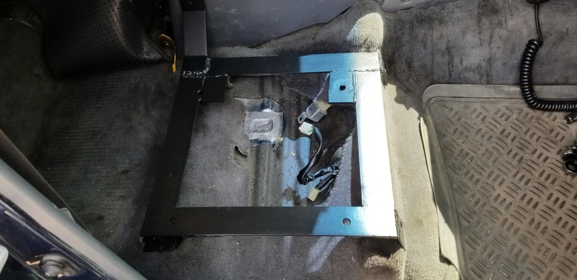

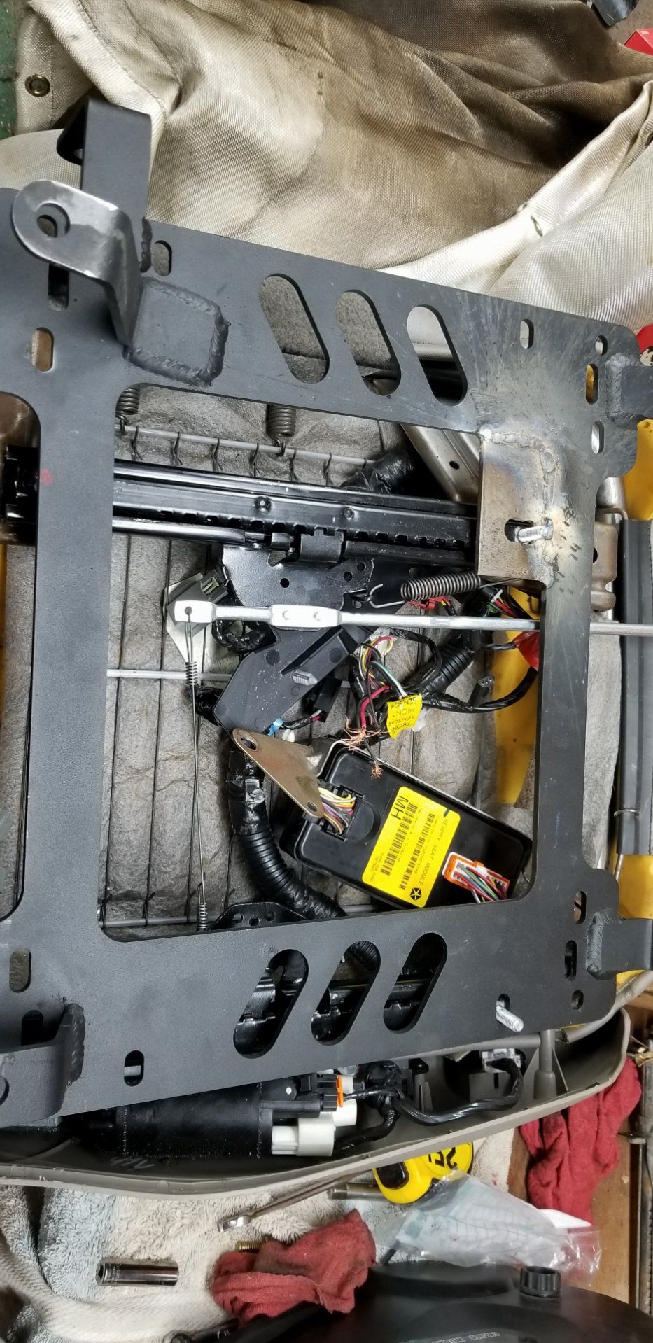

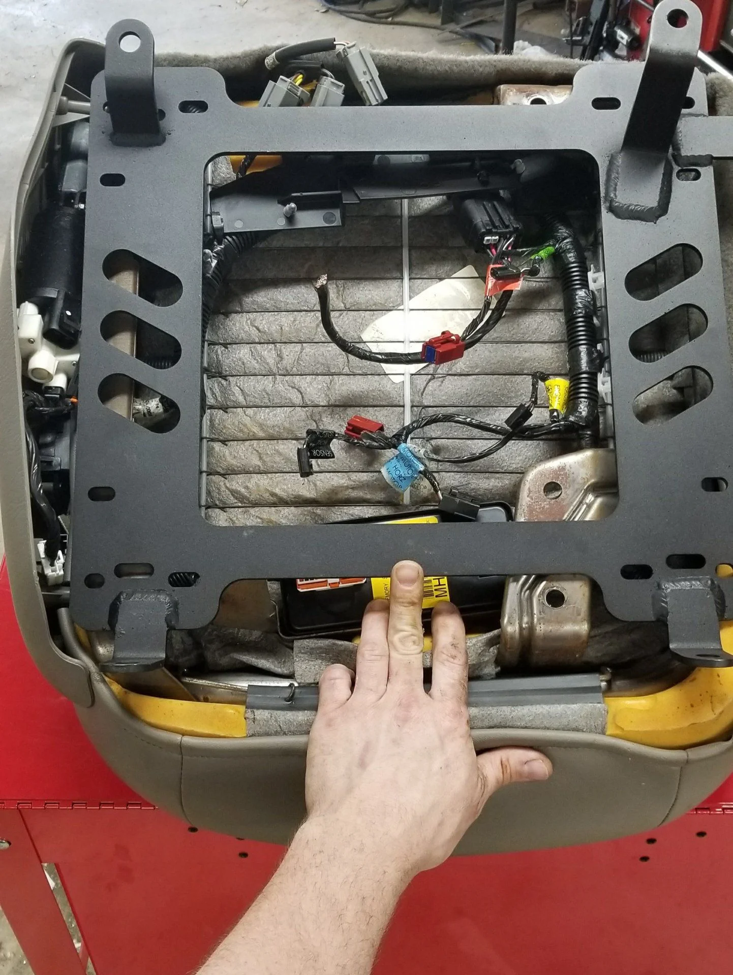

I put some jeep grand cherokee seats on planted brackets with manual sliders in mine. The factory electric seat slide from the jeep wouldn't fit the 80 and the 80 factory bracket didn't fit the jeep seats. The jeep seats are offset by about 4 inches which makes it a real pain to match any other seat design. I had to modify the planted brakes just to work and by that time I figured I might as well make my own bracket for the passenger side. Luckily I only bought the ds at first. It was more work than I expected and it kind of sucks to not have power seats for the slide portion, but the lumbar and tilt are still power. But I am happy with the end result, they're WAY more comfortable than the brick hard stock seats.

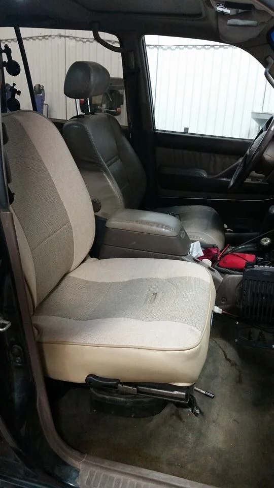

I swapped in the factory cloth out of a 93-94. They're much more comfortable than the leather ones, but I'm currently considering a suspension seat since I drive the truck on dirt so much.

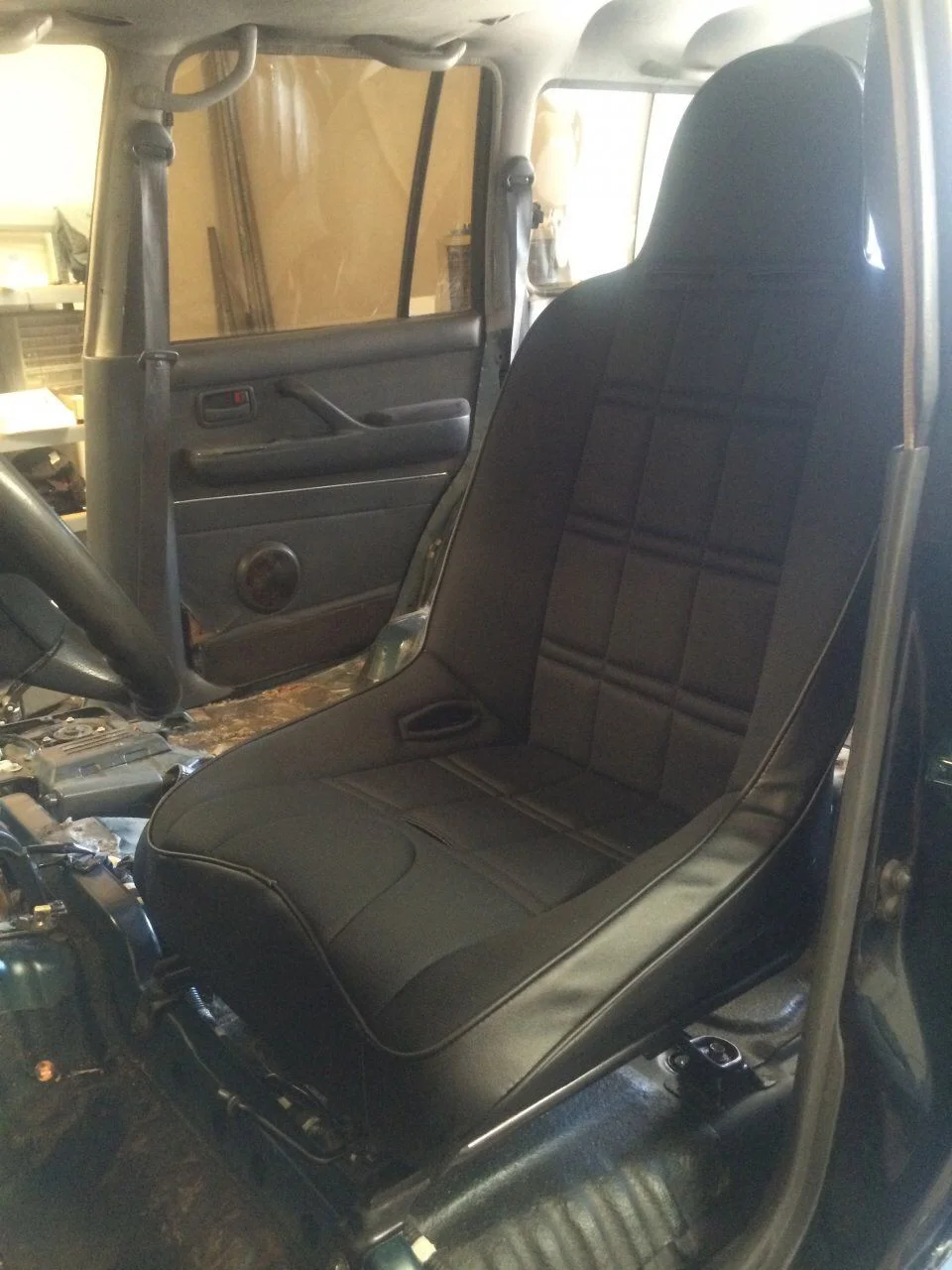

The PRP daily driver looks good in an 80:
But I will probably go with the Nomad from Mastercraft. At $200 per seat it's hard to beat that price. The only real concern I have about these is getting them lower. I like that my cloth seats sit lower than the leather ones and I would want to keep that.
I installed some old Recaros on Wedge sliding brackets. They bolted up without any modifications to the bracket or seats. Gave me approximately 6" more leg room and 6" more head room. I'm 6'4" so this worked out great for me but would definitely recommend a higher sitting seat for anyone under 6' or with a short torso.
Toyota Landcruiser FJ80 90-97 Seat Brackets

Anyone tried remounting stock seats on brackets w/ sliders, like
or
Toyota Landcruiser FJ80 90-97 Seat Brackets - Corbeau Racing Seats
