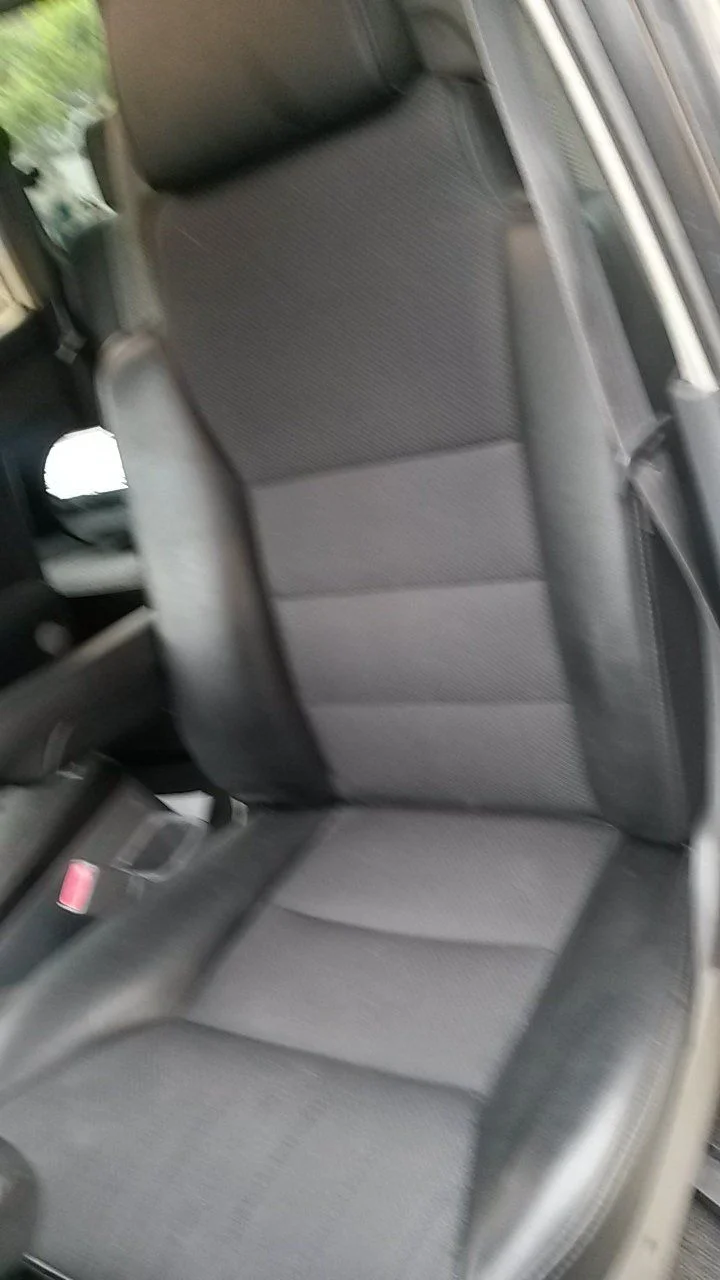

I looked into junkyard seats. Anything that looked nice was the same cost (around $500 a pair) as new aftermarket seats. Everything affordable looked like someone died in them. The ones in the pics below are $600 a pair.
600 a PAIR? why not include the info on those pictured...
