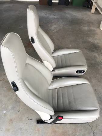

@2fpower what brackets did you use? I have a line on a pair of '90 911 seats for nottalottamoney....Planted?
(I'll prob pay more for planted brackets than these if I buy them)
These have the slides.
Were you able to bolt on female seatbelt buckle? Assume they wired up fine?
They look great. Hope you like them installed!
I put the female side of seatbelt from stock seats onto these seats.
I used the sliders from the porsche seats and welded or bolted them to brakets I made to mount to the stock locations.
Mine were not power, so only wire I did was for the seatbelt on driver seat. I did add seat heaters; however that is totally different.
I should point out that the new way I do seats is to cutoff the two rear mounts from the old seats, bolt those in the car, then put a 1/4 steel between these two points. That will give you a very flat even surface to then set your seat on, then make a front mount and do similar with it. Then see if the seat is at the angle you want it. you can raise or lower the rear as needed. The front should be as low as possible.
Also, every seat that I have installed you have to beat the everlasting crud out of the seat structure "hump" near the tranny tunnel. I typically pull the battery terminal off so I don't set off the airbag. YES that much damage needed with 5 lb sledge.

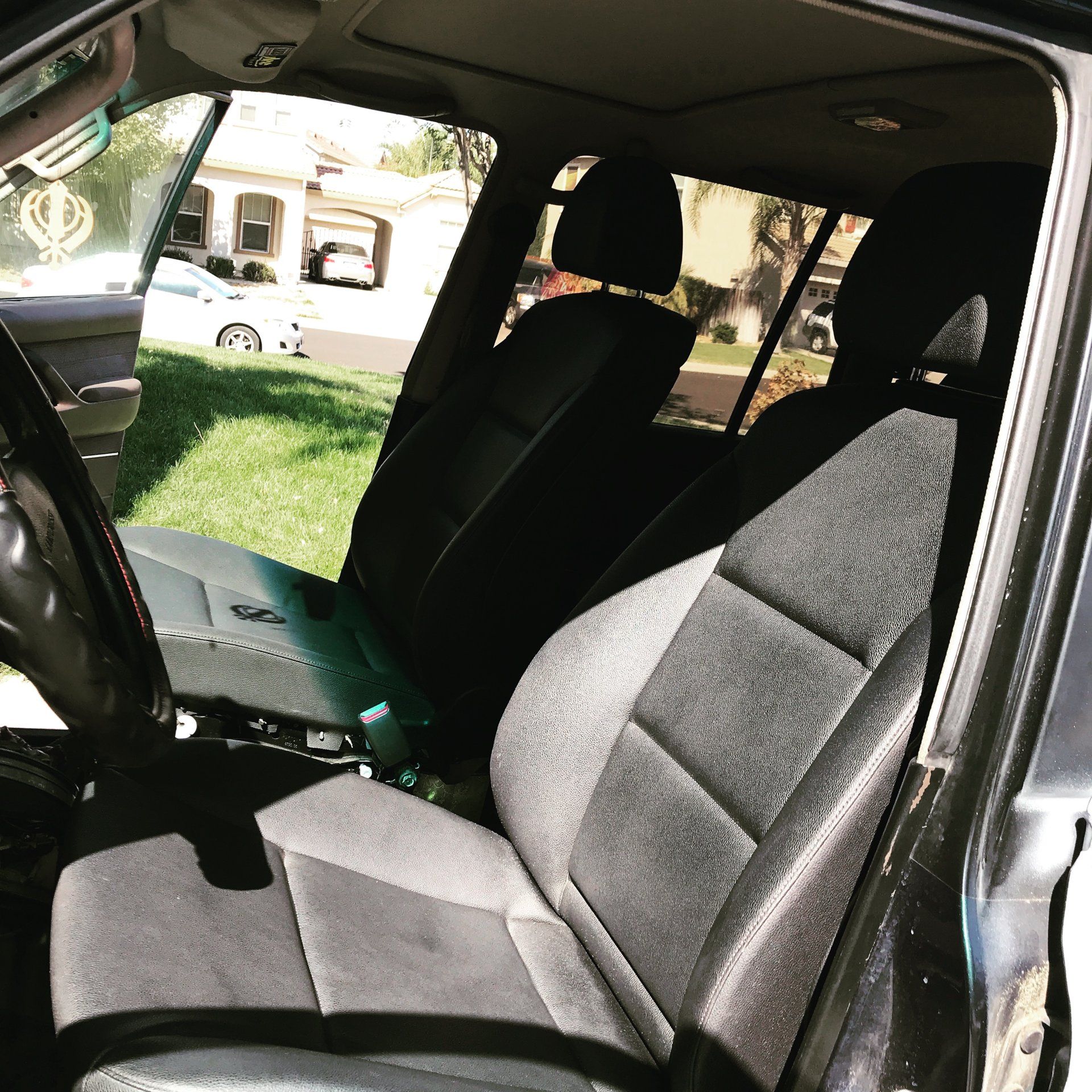

Picked up seats out of a 2005 Acura TSX about a year ago. Leather, Power, and Heated added switches for em today. Welded up a frame for mounting them. They are a bit a bit wide, they do fit. I am 6'4 they feel great, have taken them out for some long trips.

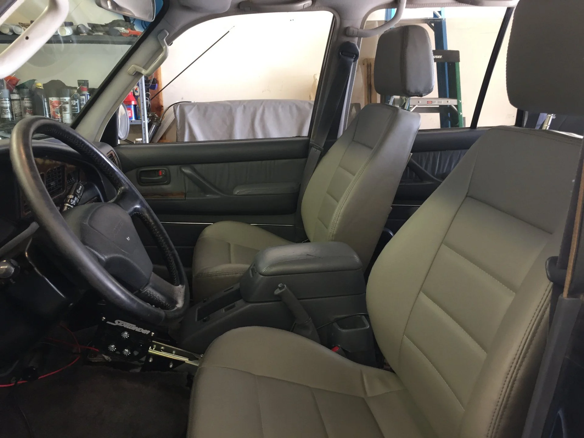

Figured I would add my contribution. 2009 Subaru WRX seats. Picked them up for $200 from the local auto dismantlers. A bit dirty but in great shape.
Rear legs from the OEM seats were cut off and welded to the rails of the WRX seats.
New mounting points made for the front.
The Subaru belt buckles won't fit the Land Cruiser seat belts but you can easily swap in the OEM buckles. But they are very short compared to where the WRX buckles sit. So I cut off the WRX buckle and welded them OEM buckle to the mount. Now they sit at the right height.
