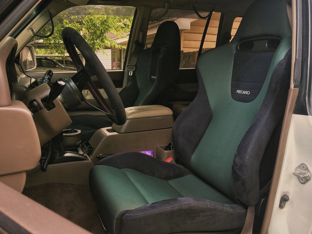

Older Recaro seats on Wedge Brackets
full

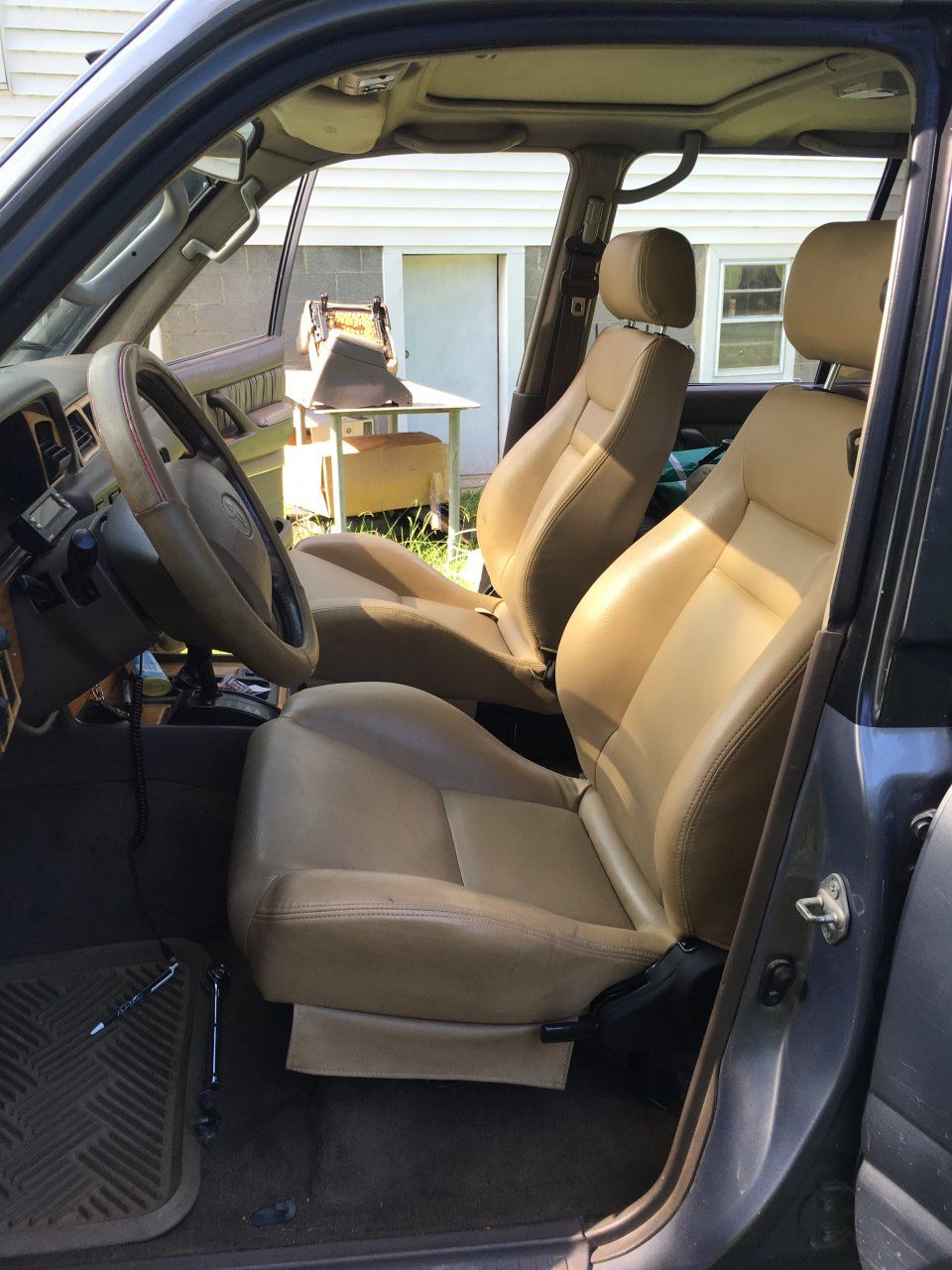

Land Rover Disco Seats
20160830_120018-jpg.1314010

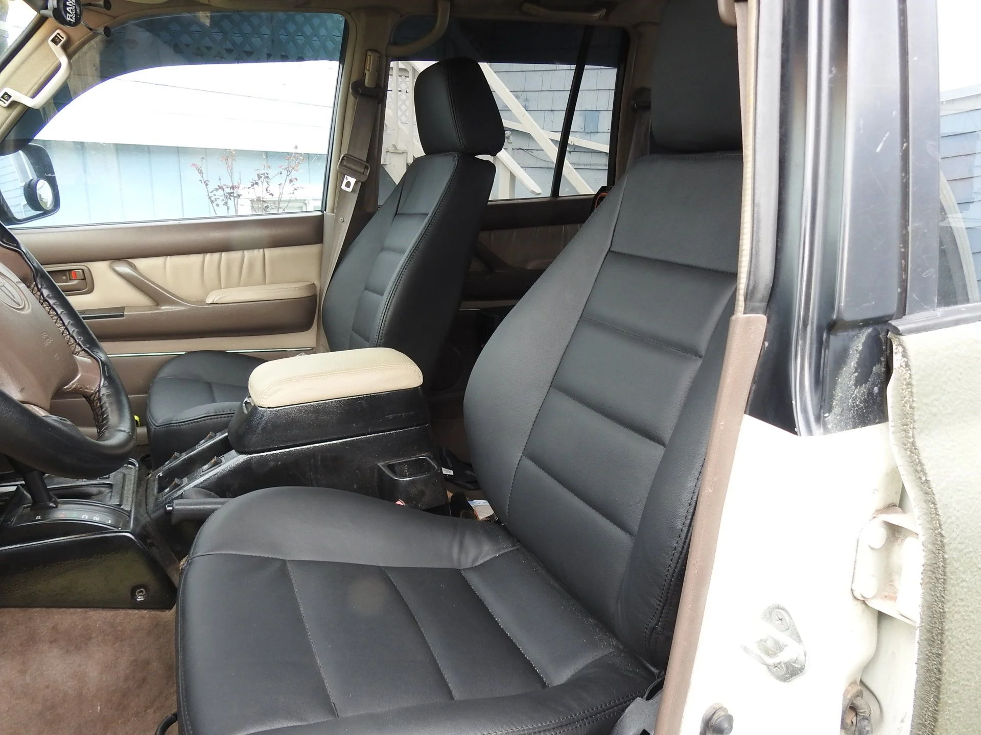

BMW E46 Seats
Installing BMW E46 Front Seats

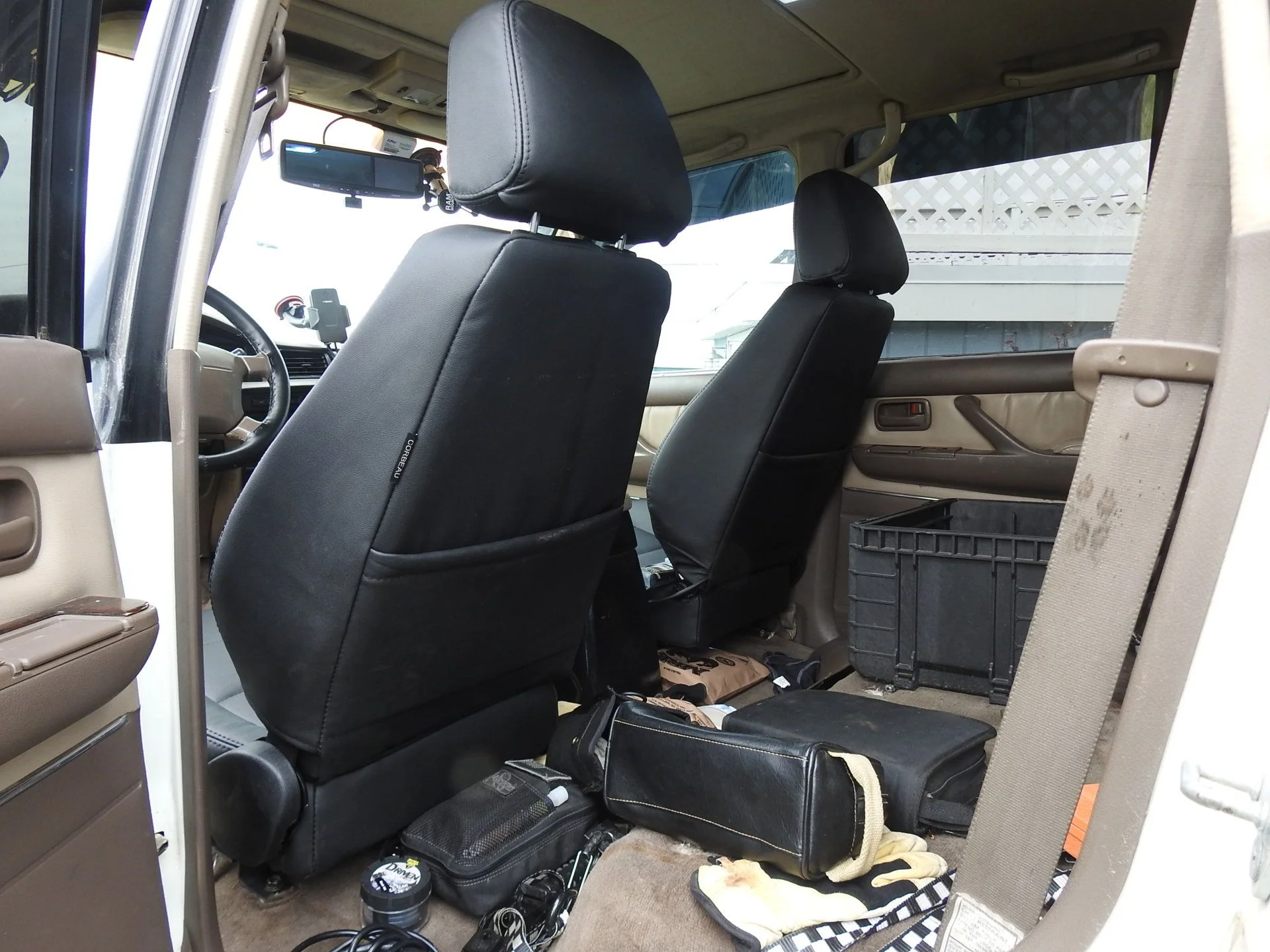

BMW E90 Seats
resized_20171220_142631-jpeg.1595184

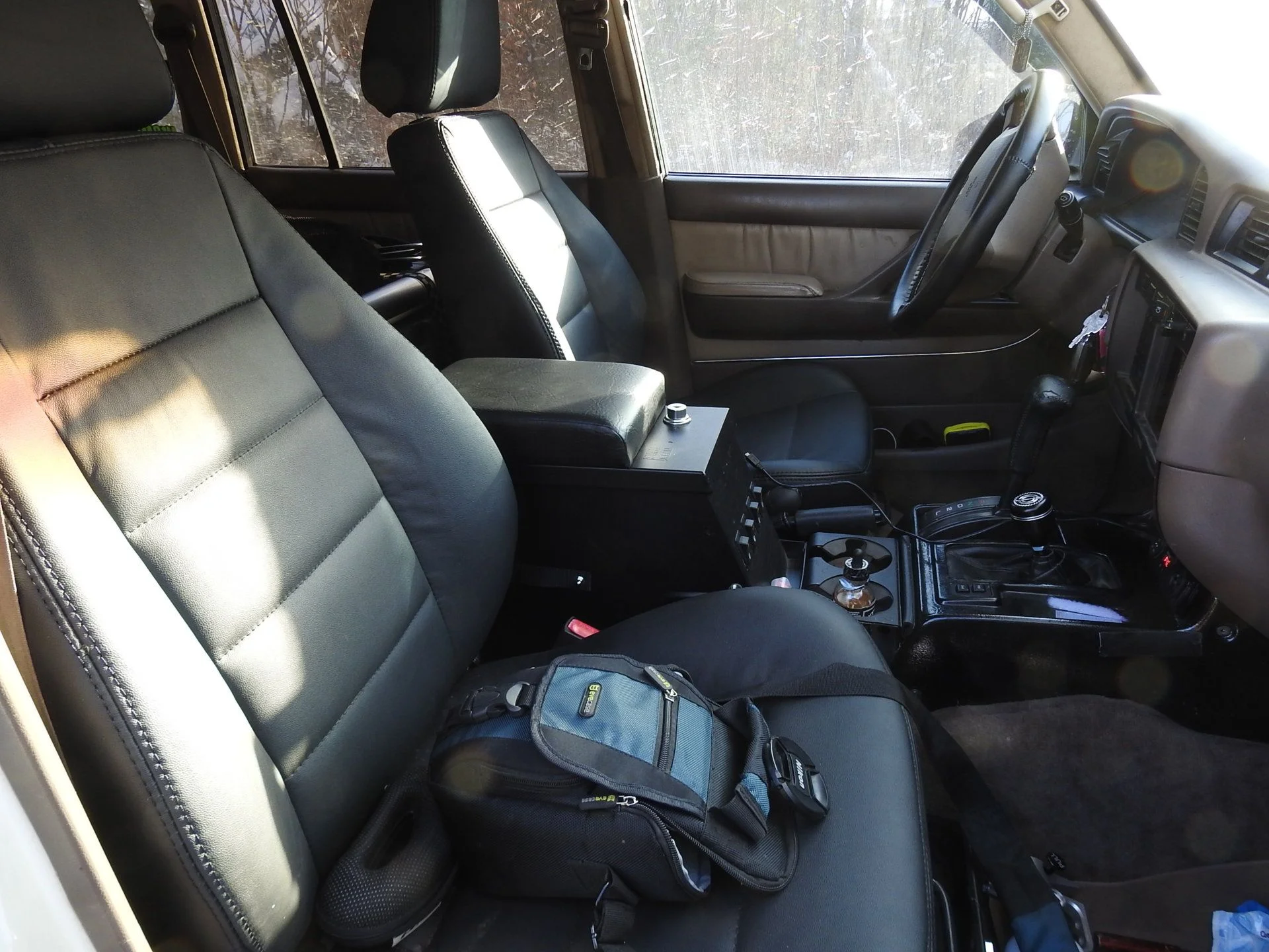

I’m planning on giving BMW 3 series seats a shot here in a few weeks. If anyone has tried this or has any info it would be greatly appreciated.
Corbeau Sport black leather pre and post tuffy console swap mod. On modified corbeau double slider seat brackets.
Very cool!!!!
Granted I’m too lazy so I put LC cloth seats in instead. However I tried few peoole’s Seat swap and they all ended up with the bottom cushion higher than factory and my head hitting the roof.
