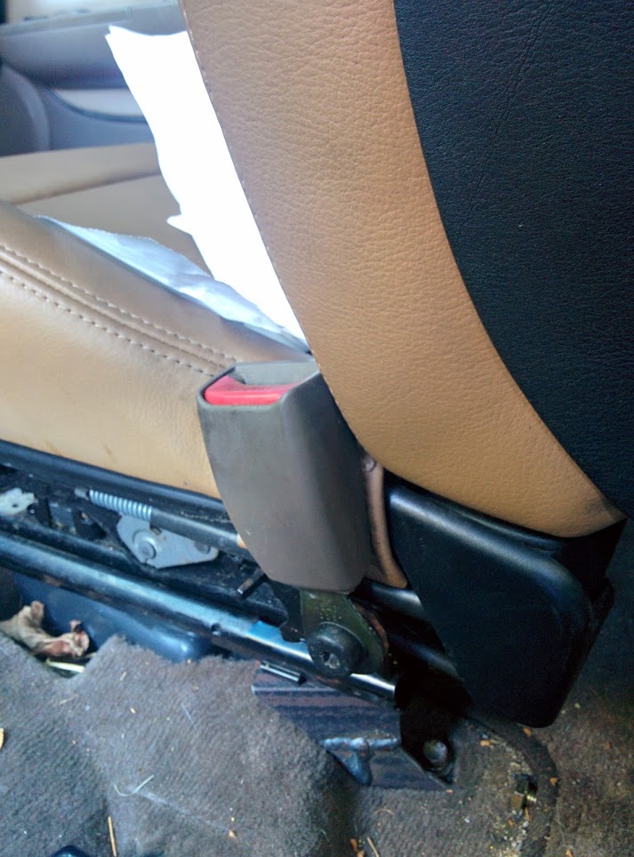

Finally, the seat belt latch is integrated into the seat on the BMW seat just like the stock seat. It just so happens the Toyota buckle from the second or third row seat belts fits perfectly. The front row does not. Why exactly Toyota would use two different size belt buckles is beyond me, but they did.

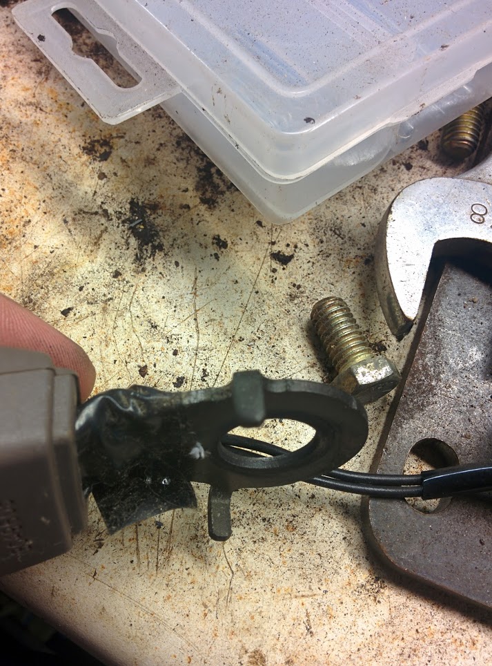

Final update on this install. Finished up the passenger side brackets this weekend. I also did away with the BMW seat latches and installed the Toyota latches in their place. I was having troubles with the retractor using the 3rd row belt. As it turns out, the loop at the very end of each belt is different. The pin that goes through the belt is also different. I managed to install the front pin in the third row belt, but it would not seat completely in the retractor. Most of the time things would work just fine, but other times the belt would not feed out. The retractor would be locked.
Slight mods were required to the Toyota latch. There are two tabs with prevent rotation on the stock seat. They were removed:

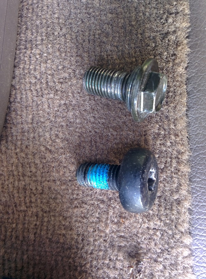

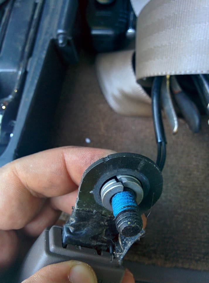

The Toyota bolt is larger than the BMW bolt, and has a even larger shoulder:
_Ar6be1p5AjdZJ0JN0xxj5M6ja59aBTPuT3OK9MeCRsd=w714-h964-no
As it works out, a 3/8" lock washer matches the shoulder on the Toyota bolt:
Wl17iF9hiwPRJilrxvoMDa6ogOwbfvF2NPWFInwNsB-i=w714-h964-no
All bolted up:

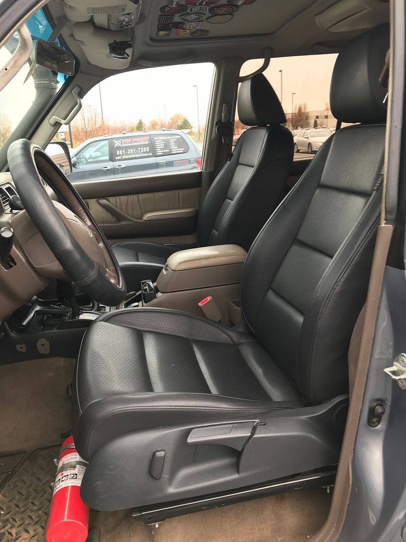

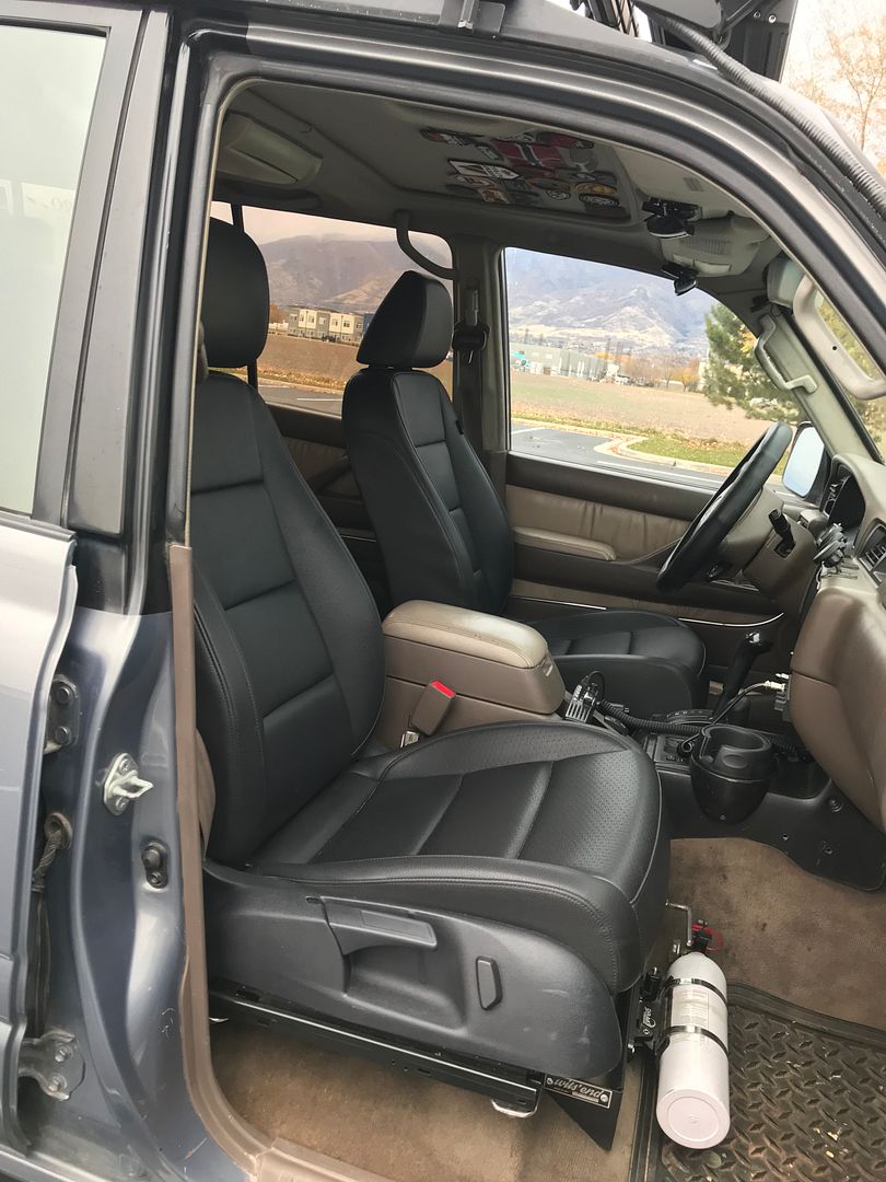

I had a similar install with the 2013 VW Jetta seats that I recently swapped in. Leather, heated. Manual slide/power recline. The rails on these are wider than stock so like the OP I had to modify the floor in the same way. This was necessary to get the seat centered but also inboard enough so the door would shut. The stock door pockets do make contact with the outside rails of the seats and push in the top of the pocket a little bit but it works and doesn't bother me. I should also note that using these VW seats will require removal of the rear heater under the passenger seat. I never used mine anyway so no big deal and now I have room to stash stuff under the seat.
